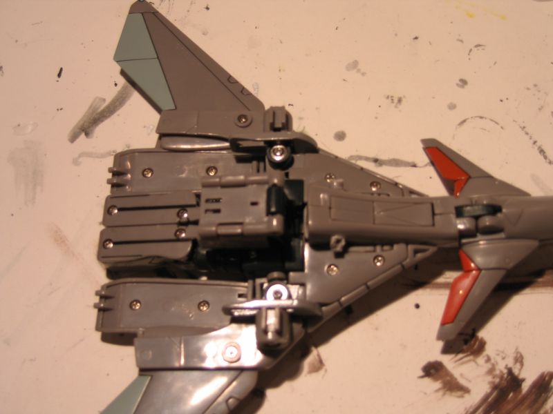

dafunguy Posted February 5, 2006 Posted February 5, 2006 So how did you get the legs back on for this thing. Super glue didn't work... which I bought today, along with a stand for my Elintseeker. Again, I want to stress that I really don't care about transforming this, so fighter mode is fine. I just want the legs back on, that's all I care about now. 366878[/snapback] I recently got a VF-11B off ebay with both hip joints broken. The previous owner stated that one hip joint was broken, so I guess the other hip joint broke during shipping! Anyways, it's a pretty easy fix. The hard part is finding the right size replacement screw. I lucked out and found the correct size screws in one of my gundam model kits. Maybe other board members can recommend where to get screws. Take the pieces apart, replace the "short original silver screw" with a "longer black replacement screw" (see picture), put it back together, and you're done. You will still see the cracks where it was broken, but once you transform it into fighter mode, the cracks will be hidden under the plane. Hope this helps and good luck.

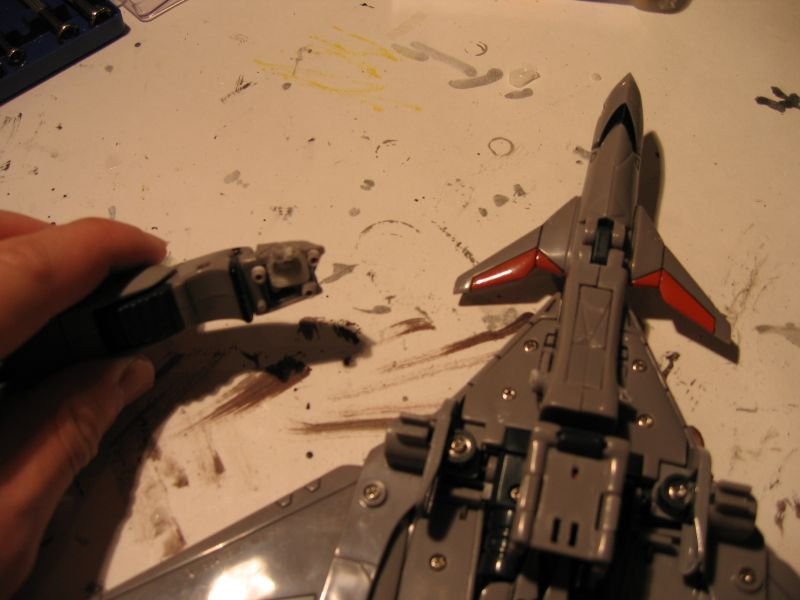

Spatula Posted February 5, 2006 Author Posted February 5, 2006 (edited) What's that white piece there? Where did you get it? Why do you need a replacement screw? Let me post pics of what I have going on here. Edited February 5, 2006 by Spatula
dafunguy Posted February 5, 2006 Posted February 5, 2006 What's that white piece there? Where did you get it?Why do you need a replacement screw? Let me post pics of what I have going on here. 366905[/snapback] The white piece holds the hip joints and comes with the toy. The replacement screw is longer because the original screw is too short. The longer the screw, the more metal reinforcment you have.

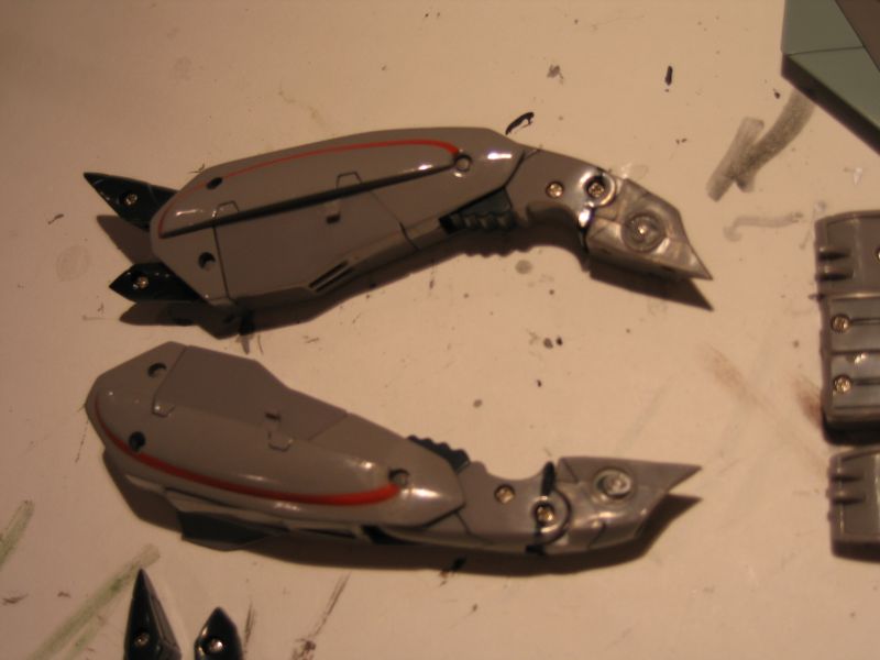

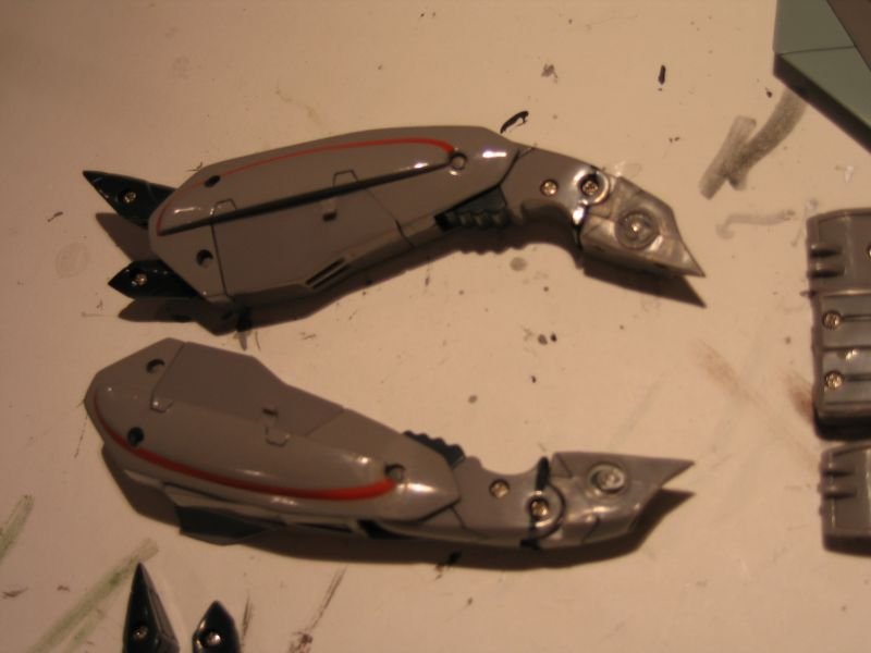

Spatula Posted February 5, 2006 Author Posted February 5, 2006 (edited) What the hell, your joint came right off but mine snapped. Look at that white part. LOL @ ATTACHMENTS. What a stupid looking thing. Edited February 5, 2006 by Spatula
