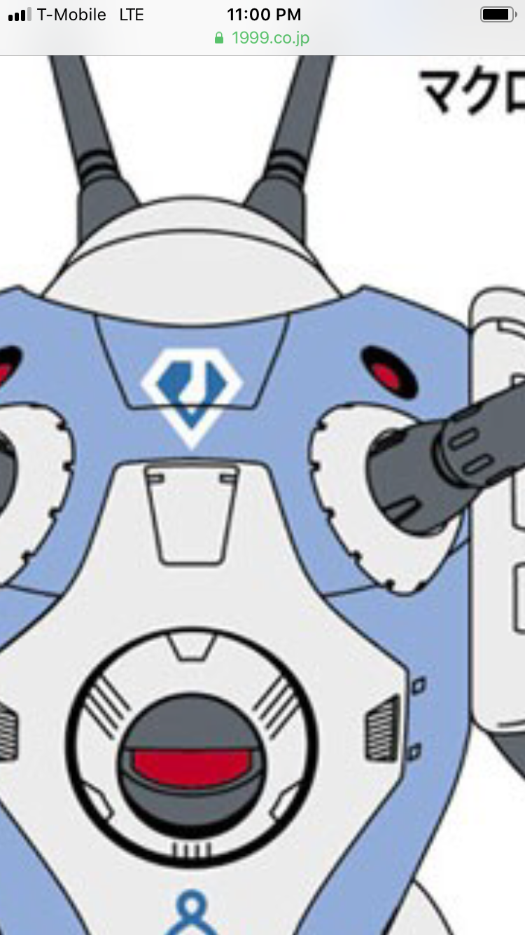

Darth Mingus Posted March 7, 2022 Posted March 7, 2022 I don't have the kit yet, but looking at the instructions: https://www.1999.co.jp/eng/image/10837544 Legs seem to be assembled using Polycaps so the items in step 1 to 8 can all be assembled, seam lines removed and painted prior to assembly Upper leg, apply G2 after finishing the grey parts. Annoyingly, there is a decal that you will need to match colours with Lower leg will be a bit more difficult to deal with, probably the hardest part of the kit. You can modify the parts (white vs. grey) and remove the pins on the white parts, fix seam lines, paint and the glue them together. For the main body, step 14 has a grouping of sub assemblies. The outer body parts in step 12 can be painted before attaching because it looks like it follows the colour separation. The seams on the blue parts are in the line art, so you can either leave them as is or remove them. I don't think masking the completed body would be that difficult and that would be the approach I would take. You can deal with the seams between parts A3 and A5. All the guns and greebles attach via polycaps so you can paint those first and attach them later. The part in step 15 requires a choice to use the stand or not but that piece uses polycaps so you can deal with seam line easily All-in-all, the kits looks pretty well engineered and fairly straight forward to paint. Looking forward to seeing your work.
Big s Posted March 8, 2022 Posted March 8, 2022 I am currently building it and as mentioned there are a lot of seam lines. I don’t think it’s necessarily Hasegawa’s fault, but more of the way things are designed. The majority of the nubs are undergated, so you won’t be damaging the surface during cleanup. But you wanna get those nubs sanded pretty well for a better fit. I couldn’t find it mentioned in the instructions, but someone here mentioned that if you want to use the included smaller sensors, then you have to drill out the ones molded in the body to replace them. as far as the decal issue mentioned above, when looking at a lot of images the Zentraedi seem to use a brighter white and even a darker blue on their writing and emblems, so you shouldn’t have to match the blue and white to the actual model.

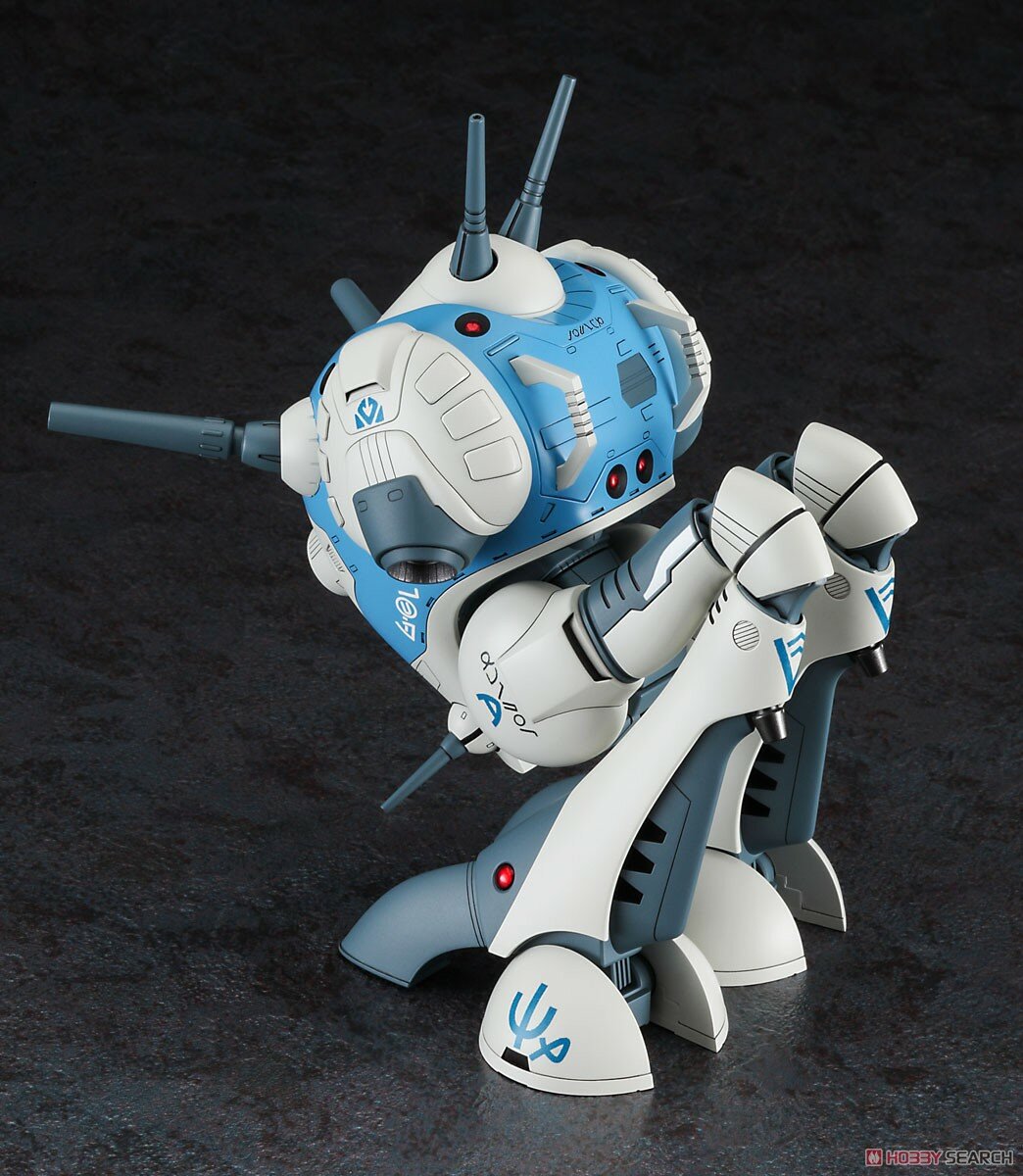

Big s Posted March 8, 2022 Posted March 8, 2022 The colors vary quite a bit here and there, but even the hasegawa pro built kit for the box has a more gray white and lighter blue than the decals, so I don’t think it’s too important to match the decal colors at all. C87ECE8F-C8E3-49A3-9A24-A87920D15C90.jp2
