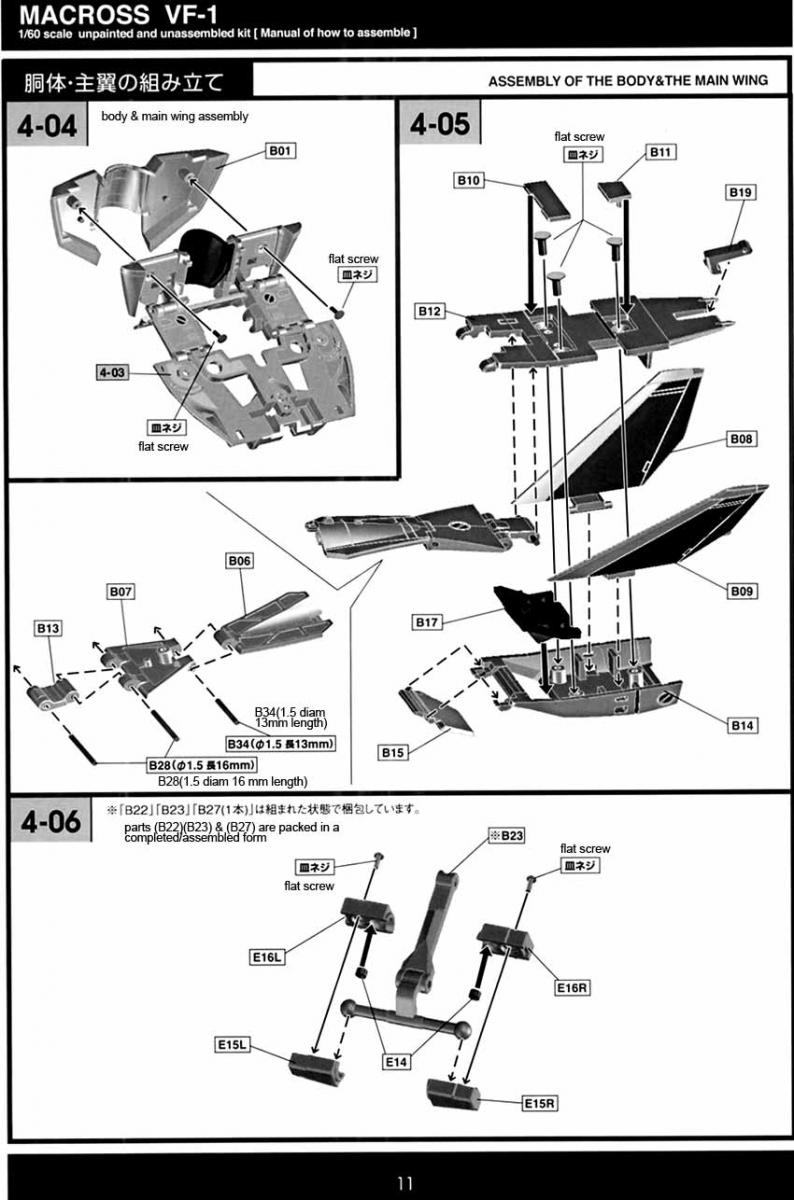

jvmacross Posted April 29, 2013 Posted April 29, 2013 (edited) not sure if this belongs here or in the "Workshop" thread.... anyway.....has anyone ever encountered an issue with the backpack hinge being loose...basically not locking in place as shown in this pic... If so, what did you do to resolve it....or what would you suggest? Thanks! Edited April 29, 2013 by jvmacross
Valkyrie addict Posted April 30, 2013 Posted April 30, 2013 Nope but you can pull it out, it's held by some small taps, add a dab of nail polish on one of the tabs or anything to increase friction (that's safe with plastic) to make it tighter. Good luck
jvmacross Posted April 30, 2013 Author Posted April 30, 2013 Thanks for the tip.... Anyone have a scan of the 1/60 kit showing the assembly of this particular part? Want to make sure I do not break it when trying to pull it off of the tail assembly.....thanks!
Ignacio Ocamica Posted April 30, 2013 Posted April 30, 2013 Hope this helps! (Scans courtesy from www.mech9.com)
jvmacross Posted April 30, 2013 Author Posted April 30, 2013 Hope this helps! (Scans courtesy from www.mech9.com) Thanks!!! That is exactly what I needed..... Curse you B19!!!!
