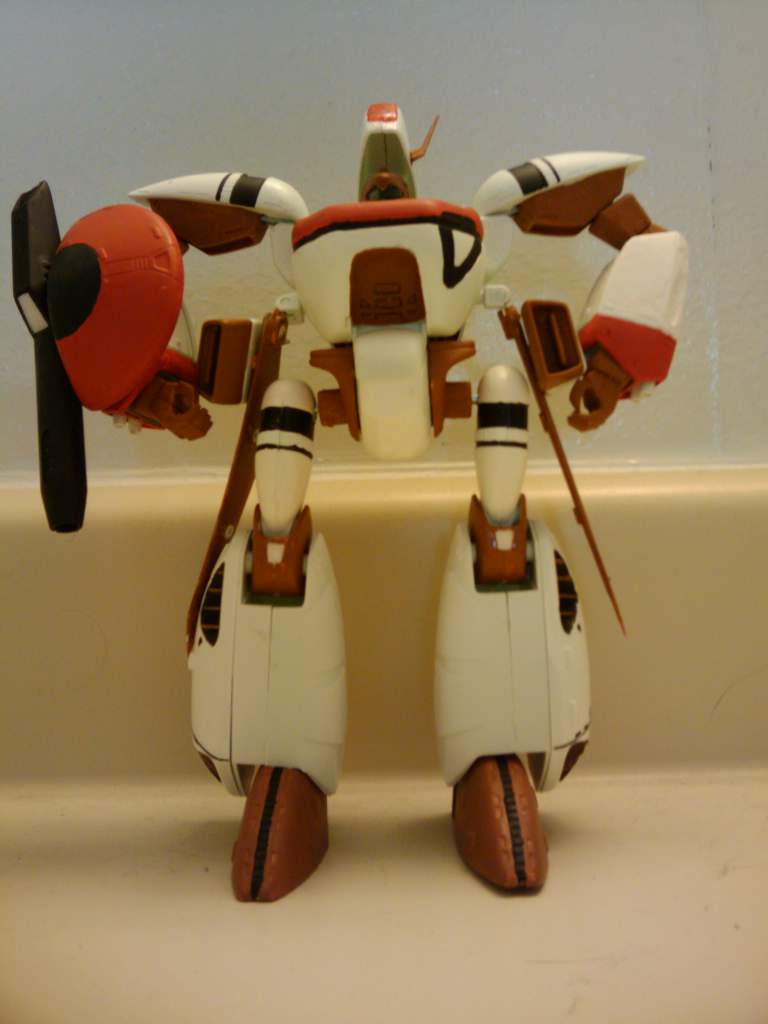

SpaceCowboy Posted January 24, 2011 Posted January 24, 2011 So, I've always known that you need to prime models to prevent them from flaking, but I've never had first hand experience with it (since I generally prime). Well, you know how they say experience is the best teacher?...yeah... So I have this Orguss Orgoid I've painted. I spray painted it with a white paint (not primer), and now the brown parts are flaking off with too much contact. I don't suppose there is any way to seal this after the fact? I think I'm pretty much screwed, but thought I'd ask.

SpaceCowboy Posted January 24, 2011 Author Posted January 24, 2011 I have a sealer, so maybe that will be enough. Here he is, before the tolls of flaking are taken upon him. I'm happy with him, but I don't consider myself a very good painter either. I did this without buying any paints...just used what i had on hand. I could have gotten better results if I had actually taken the time on it - but I just got a couple of the toys, so that got my Orguss fix in - this is more for work desk display. And here is to show how Orguss is still on topic in a Macross forum. http://www.xs4all.nl/~ptn/new.images/Veritech/FOAorguss.jpg
nightmareB4macross Posted January 24, 2011 Posted January 24, 2011 Looks good. If you're just handling the model and it flakes off, well I hate to tell you this, but a topcoat of clear will not help. It's missing adhesion between the paint and the plastic surfaces. The only cure would be to start over. Remove all the paint. Clean it. Prime it well. Then repaint it. Live and learn, wether we like it or not, [sometimes] it's the only way.
captain america Posted January 24, 2011 Posted January 24, 2011 So, I've always known that you need to prime models to prevent them from flaking, but I've never had first hand experience with it (since I generally prime). Well, you know how they say experience is the best teacher?...yeah... So I have this Orguss Orgoid I've painted. I spray painted it with a white paint (not primer), and now the brown parts are flaking off with too much contact. I don't suppose there is any way to seal this after the fact? I think I'm pretty much screwed, but thought I'd ask. There could be several causes for poor paint adhesion. What kind of paint are you using? If you're using hobby paint directly on styrene, you don't even need primer assuming that your plastic was either washed with mild detergent or rubbing alcohol. Greasy fingers? Incompatible paint? Improperly mixed paint? Residue on the part surface? High humidity? These are just some of the potential causes, but as nightmare mentioned, no overcoat/sealant will help to fix flaking paint; the core problem needs to be assessed.

thegunny Posted January 25, 2011 Posted January 25, 2011 There could be several causes for poor paint adhesion. What kind of paint are you using? If you're using hobby paint directly on styrene, you don't even need primer assuming that your plastic was either washed with mild detergent or rubbing alcohol. Greasy fingers? Incompatible paint? Improperly mixed paint? Residue on the part surface? High humidity? These are just some of the potential causes, but as nightmare mentioned, no overcoat/sealant will help to fix flaking paint; the core problem needs to be assessed. +1 for The Captain. I've been making plastic models for well over 30 years and have NEVER primed one. Proper surface preparation is the key. I've used all sorts of paints from el cheapo $2 spray cans, automotive spray cans and purpose made hobby paints and have never had flaking. I use etch primer on metal table top figures as they tend to get a bit knocked around during the game, in transit and from people who have to look with their fingers
SpaceCowboy Posted January 25, 2011 Author Posted January 25, 2011 Interesting - yeah, I don't believe I washed it, but thought the lack of priming is what did it. Is water enough, or should I use hand detergent? I've washed models before, but only by running water over them, and always wondered how much it mattered.
Vifam7 Posted January 25, 2011 Posted January 25, 2011 (edited) Interesting - yeah, I don't believe I washed it, but thought the lack of priming is what did it. Is water enough, or should I use hand detergent? I've washed models before, but only by running water over them, and always wondered how much it mattered. If the plastic feels a little slick, that's left-over mold release. That left-over mold release will cause paint to not stick to the plastic. I usually just wipe the parts with rubbing alcohol before I paint. Also, what kind of paints are you using? Some paints don't go well together. Edited January 25, 2011 by Vifam7
SpaceCowboy Posted January 26, 2011 Author Posted January 26, 2011 Spray painted with Design Master Flat White. Then all other colors were Testors paints.
