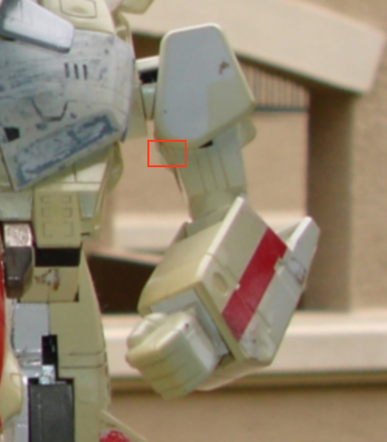

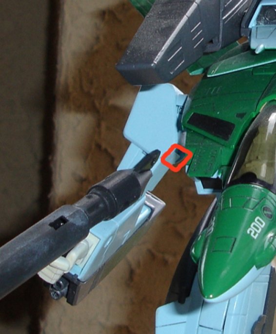

Has anyone taken this little notch out of the inside of a Bandai 1/55 arm to allow it to move closer to the body?
I am trying to recreate the Max "A" pose and the arm doesn't reach the gunpod as the bevel in the upper arm keeps it from reaching the gunpod.

to answer the question, I sand the arm notches completely off of every 1/55 custom I do. It does look much better, and and after I add my special ball jointed arm mod, and wrist mod, these 1/55s can do almost anyhting with their arms.

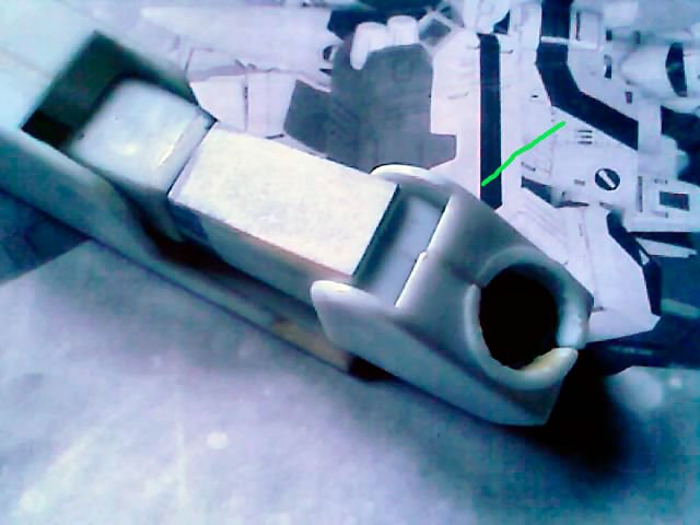

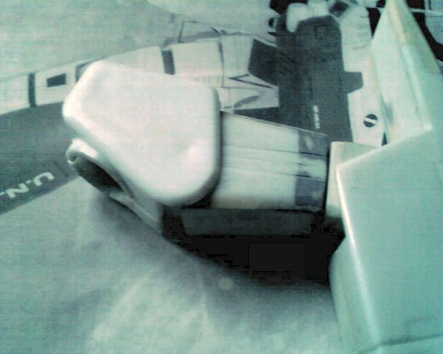

Got some pictures of the arm mod unfortunately I cant find the before I covered it all in filler pictures so here go`s with what I have with some explanations too help.
In the first picture you can see the arm with mod and a thin 1mm strip of styrene glued and filled over the top. I was going for a more Yamato looking forearm. The green line (was supposed to be an arrow) is where I recon you could slice off some plastic to give the arm even more bend ablilty, It wouldnt show as its hidden by the body mostly.
The second one gives a kinda side on profile of the moded bit including an un moded shoulder (apart from ball joint).
