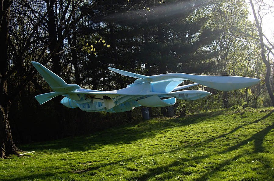

Thought you guys would appreciate these... 1/12th scale, 3.5 lb estimated AUW... Getting closer to flight-testing, but still a good few months out. ~Luke

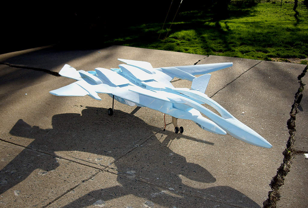

You're right, keep in mind the tops of the nacelles are not fitted/glued in place yet, so the slit intakes will be lower profile when all is said and done. They're only about 3/8"" deep, when everything is fitted down correctly. (I based my CAD model on the colored schematic you posted, with modifications up front to turn it back into a UCAV.) The connector between the TARPS pod and the nose isn't installed yet, but will be there. I'd estimate I'm a good 2-3 months away from a the maiden flight, so there's a lot of stuff left to do. Like I said, this is the UCAV (FRX-99 RAFE)... Thus the curved channel thingy. I figured an RC model of a UCAV had a certain novelty/irony to it... Maybe I'll even drop a TWOG autopilot in it, and actually make it a UAV. ~Luke

No worries, Sean, this is definitely a one-off. It's actually not the ram-intake variant, which would have the two additional inlets above the top slit intakes, as well as flatter nacelles. I'm going for the 'vanilla' FRX-99; note the curved front intake channel, as opposed to the squared-off one the FRX-00 has. Also, it's a prop-job, I'm after strong vertical performance, so EDFs were out. I know, I know.... But come on, 5' long, custom retracts, 1:1 thrust/weight, and no vertical stabilizer... I had to cut corners somewhere! ~Luke

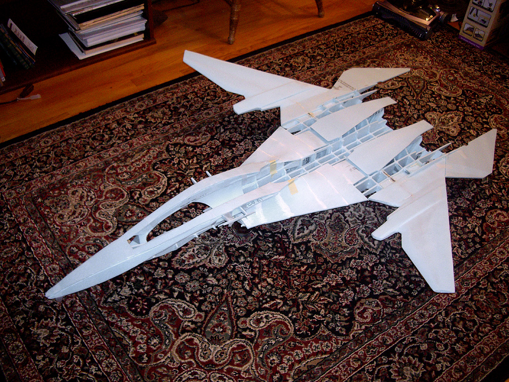

As promised. 63" long, and going as planned. (Except for a minor issue where the nose connects to the fuselage; small error in the CAD file.) No glue yet, just trial-fitting the parts. ~Luke

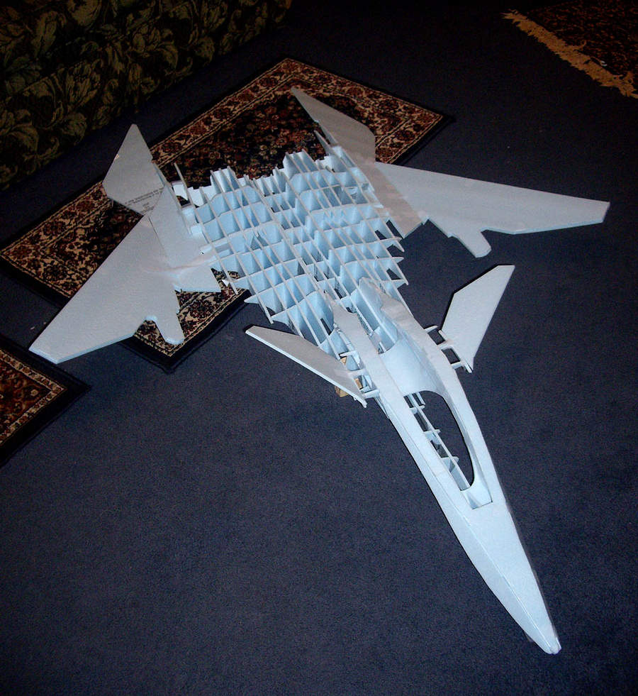

Just an update, the main fuselage is framed up, waiting to be glued. I'll post pictures later today. (Going to try and get the nose done for the first photos.) ~Luke

Well, months later... Guess what, I'm not building either... I'm going to break ground (cut foam, what have you) tomorrow on a 63" long FRX-99 RAFE (Yukikaze, obviously.) It's a prop-jet, nothing fancy there, but it is going to use a different construction technique than I used on the SVs, which should produce lighter airframes that are still reasonably strong. (This was a major reason the big SV never moved forwards, I wasn't satisfied with the projected thrust/weight ratios with the ducted fans.) The framework will be assembled and covered with 0.2" thick sheet foam. This should also minimize the amount of carving I have to do, too, which is a bonus. I'm thinking it could also be a little quicker, which is always a good thing. Obviously, should it work out, SVs/VFs are in the lineup, since I have the surface models I need to get the cross-sections. ~Luke
