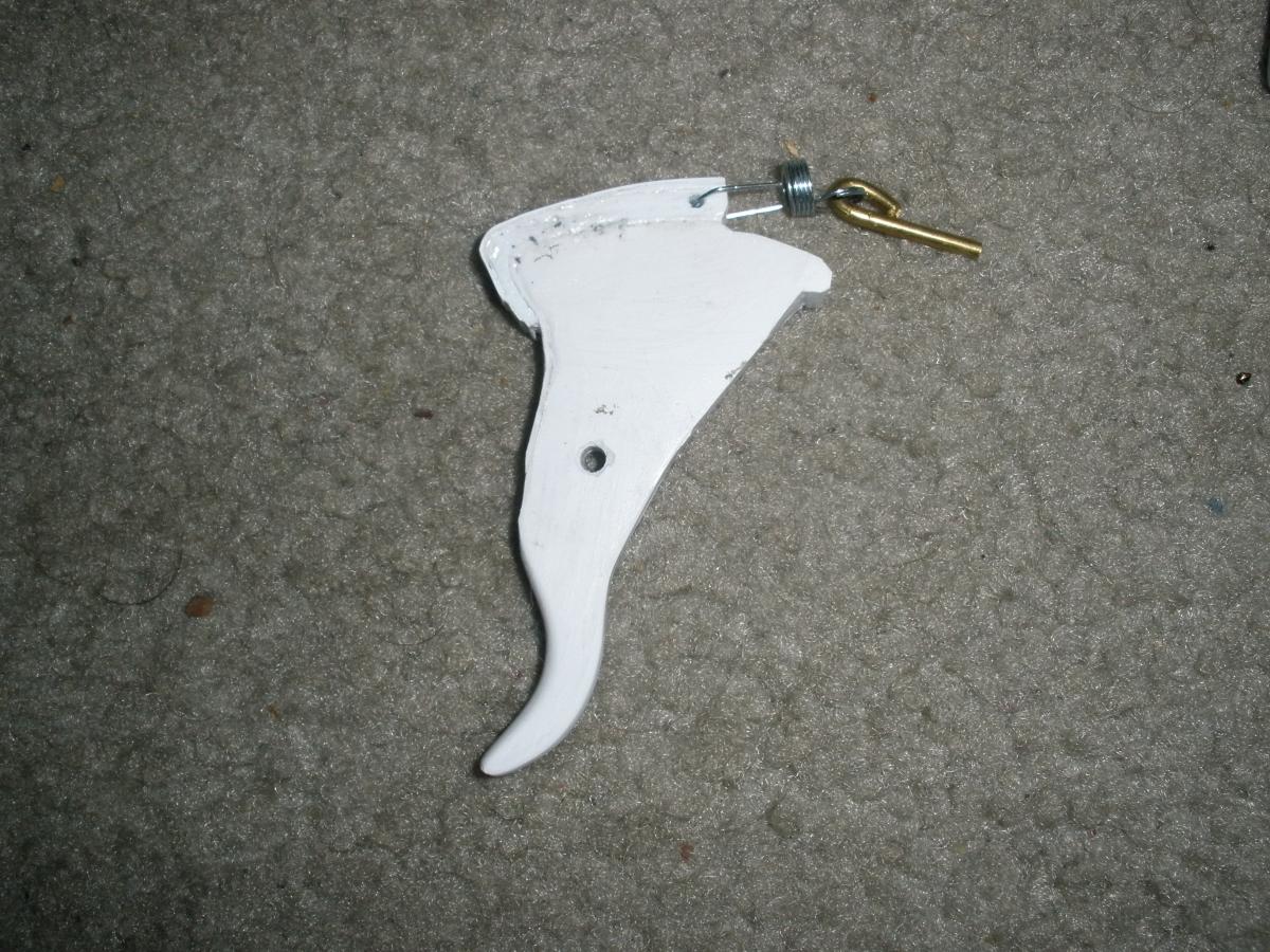

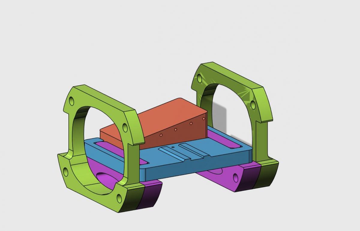

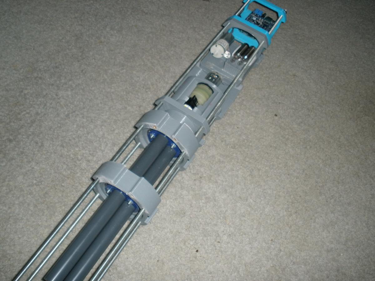

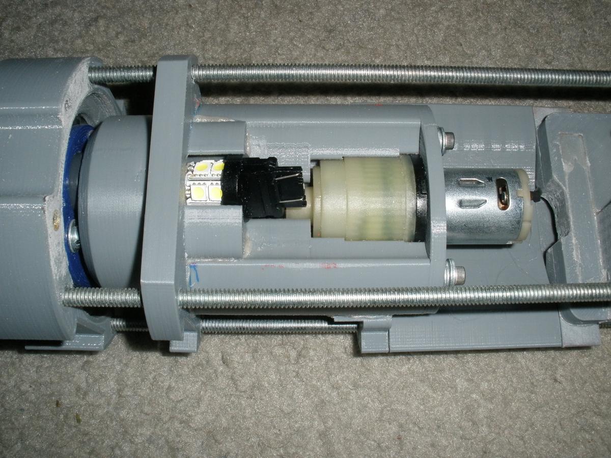

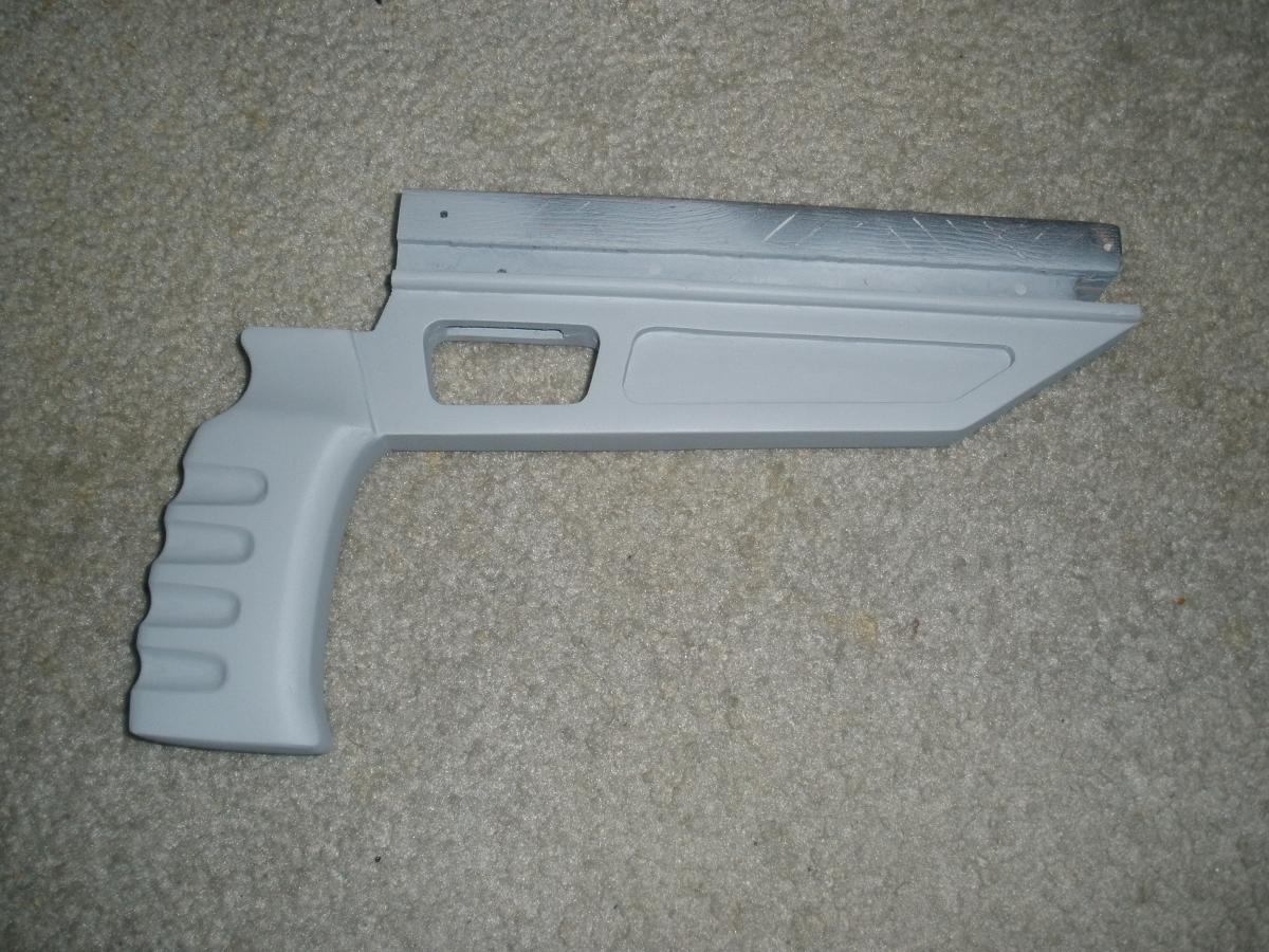

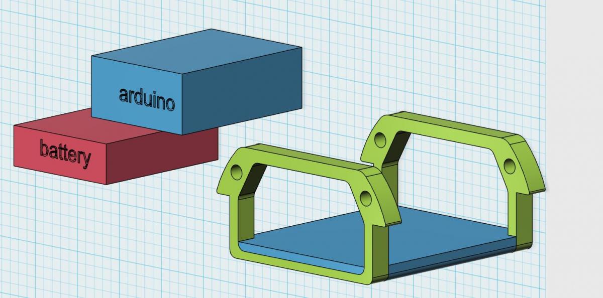

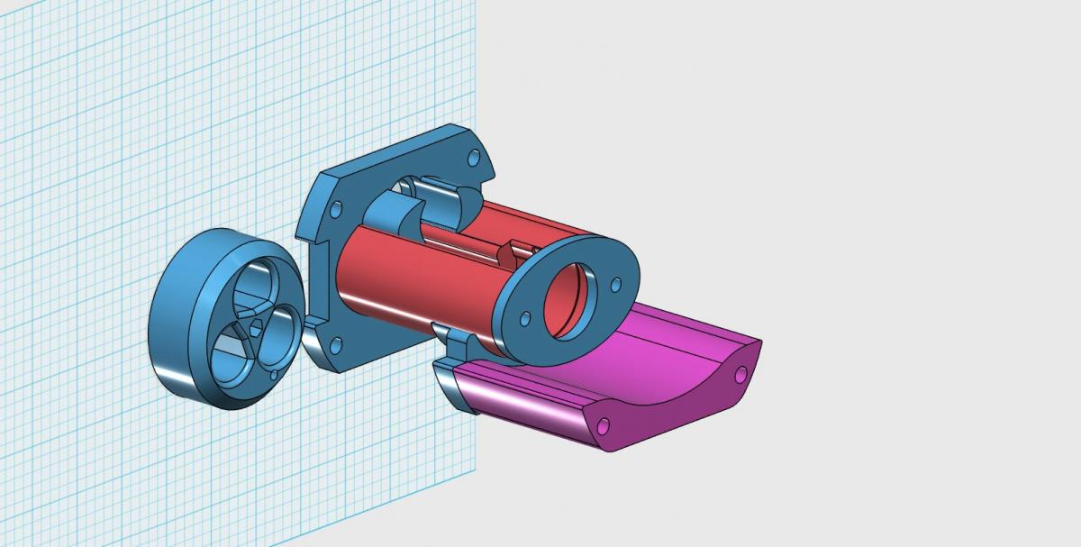

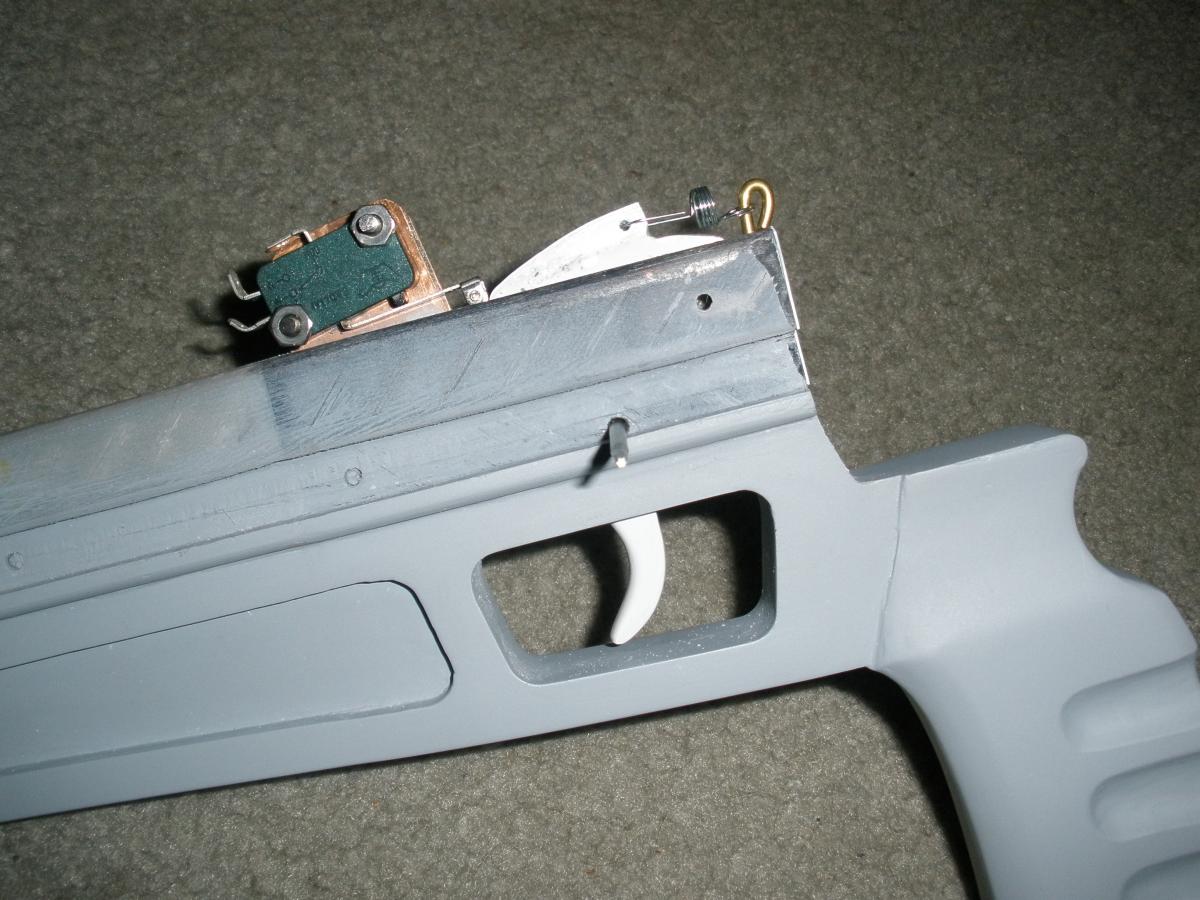

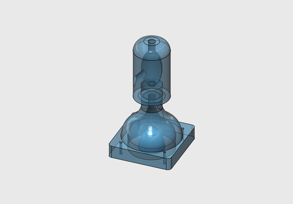

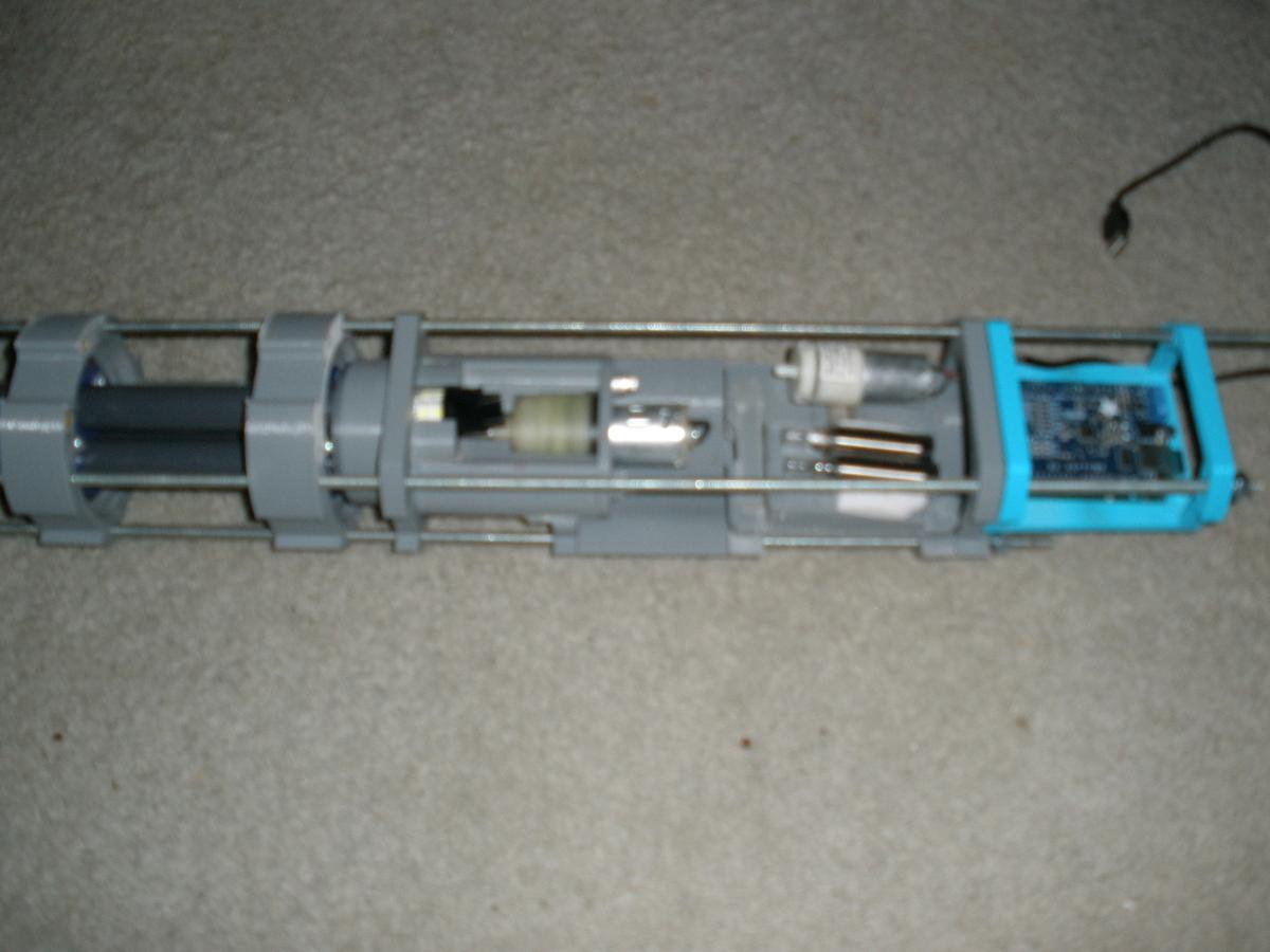

  1. Been a while since my last update, Been tinkering, finally found a motor that works for the smoke generator, But it literally was on the slow boat from China. (I didn't look at the sellers location before I ordered it) The CADS for the guts. They will just stack up on 1/4" threaded rod Motor/ light mount, Smoke generator Arduino section All mocked up, Using a spare LED brake light, and a motor/gearbox from a cordless screw driver, 1 or 2 Vape pens running of a 12 air pump, and the arduino with sound shield( still needs mounting brackets) Also got the trigger setup, Made a quick 3d print to get a close template then make the actual thing out of layered styrene to get the shape of the cam for the micro switch right Got the micro switch mounted int the grip. I cut a wide grove in the grip on used a doubled up copper plate and back filled it with epoxy putty.

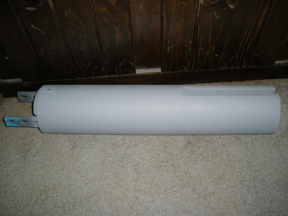

  2. Well got all the electronics in this week. Good think i watched some youtube vids on arduino. Everything i want to run off the boards exceeds the current limits for all the pins. But quickly solved, got a pack of transistors on order. The CPU fan and duct idea for the smoke generator however is a total fail. I was hoping it would act like a airbrush and siphon smoke from the e-cig tip, but with 1/4 airline tubing it just builds back pressure and blows the smoke out the wrong side of the e-cig.

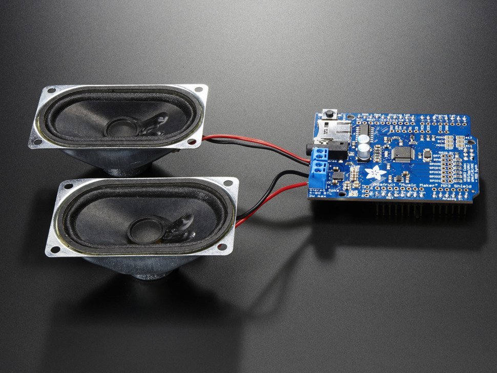

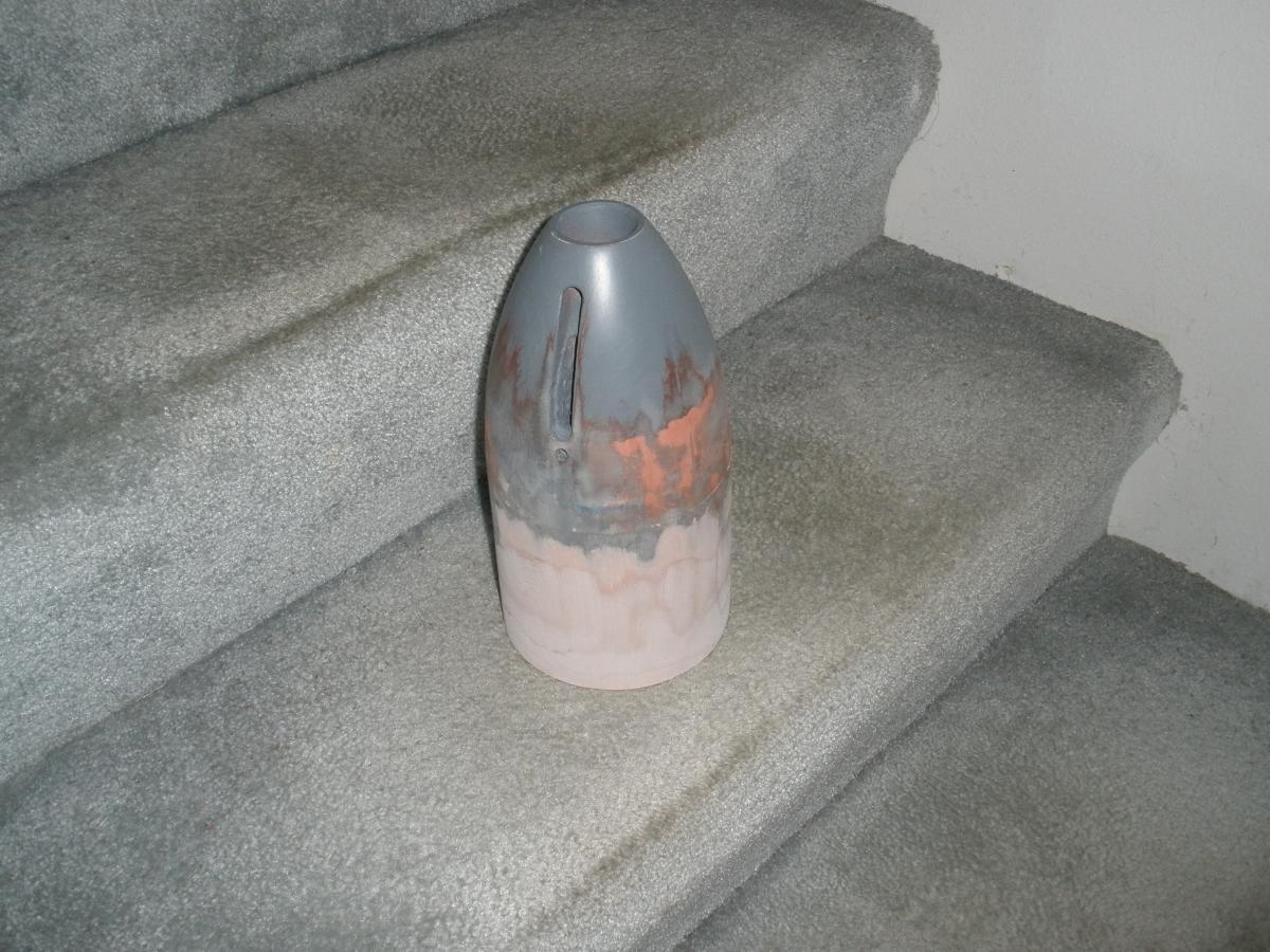

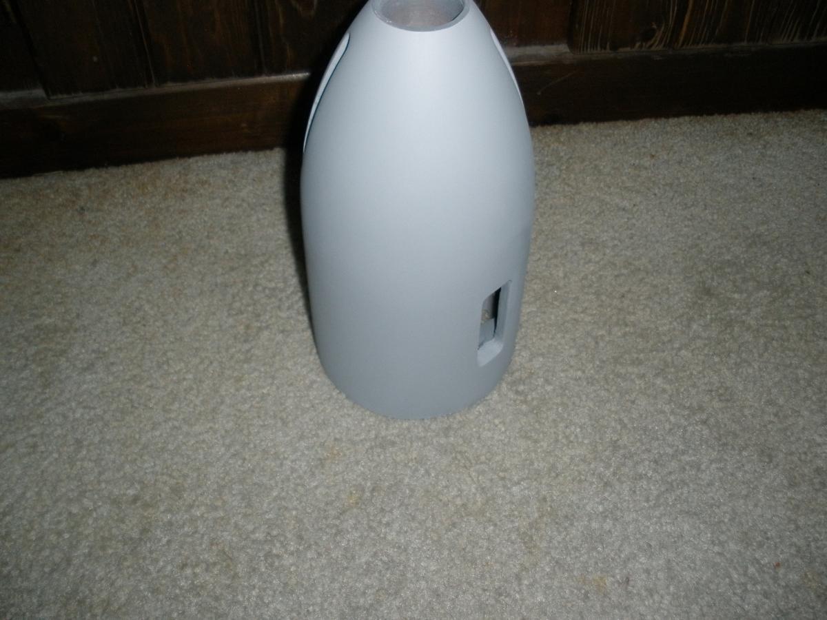

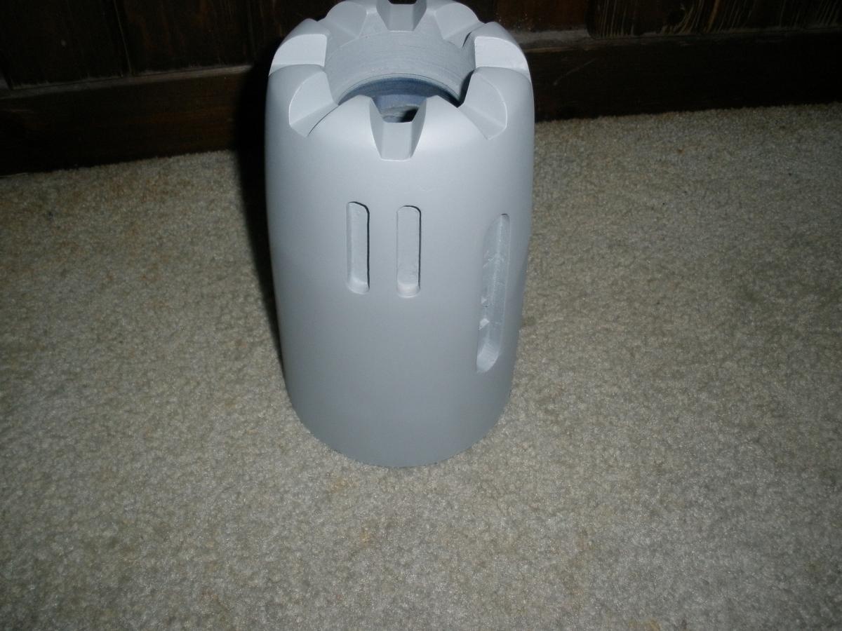

  5. Both buttstock pieces are full assembled. I think ill leave it as a 2 piece assembly. The friction fit between the two is pretty snug and secure. The lower (sling mounting) fin is also bolted on for extra strength. All the body pieces are now primed. I had to do some re-work on the buttstock. I use some bandage wrap with epoxy coating to bulk up the outer diameter, faster. which worked great....... as long as I don't leave the thing out in the Florida heat. In some areas it hasn't reacted well and softened the epoxy so I had to cut out and bondo the soft spots, and re-prime. Also bought most of the electronics. Its all gonna run on a Arduino Uno & MP3 Shield, and a couple of E-Cigs for smoke generators. Along with some extra components. But 200 dollars worth of stuff total.

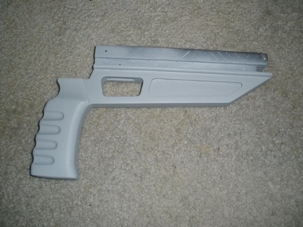

  6. Before After priming Needs a few more coats to get rid of that porous texture Bondo leaves. Also using Dulpi-color primer now.

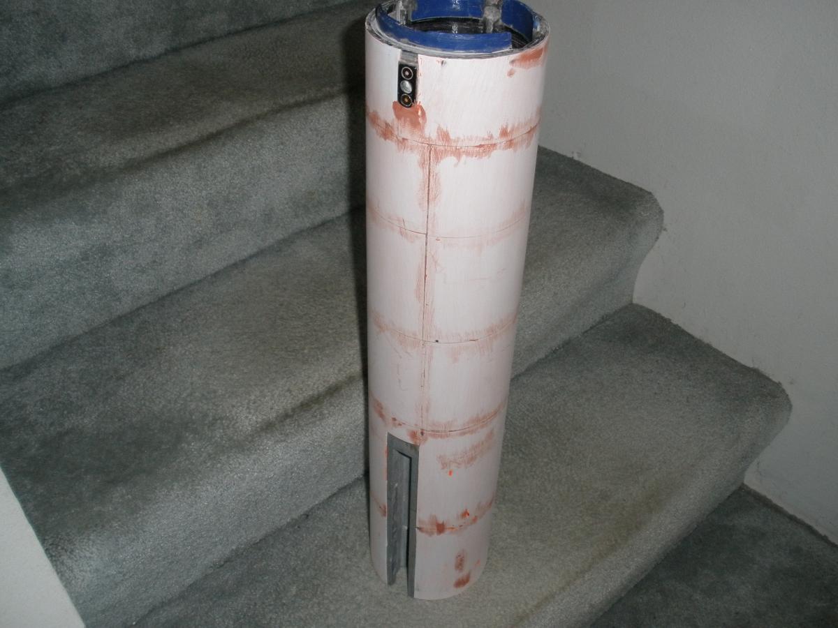

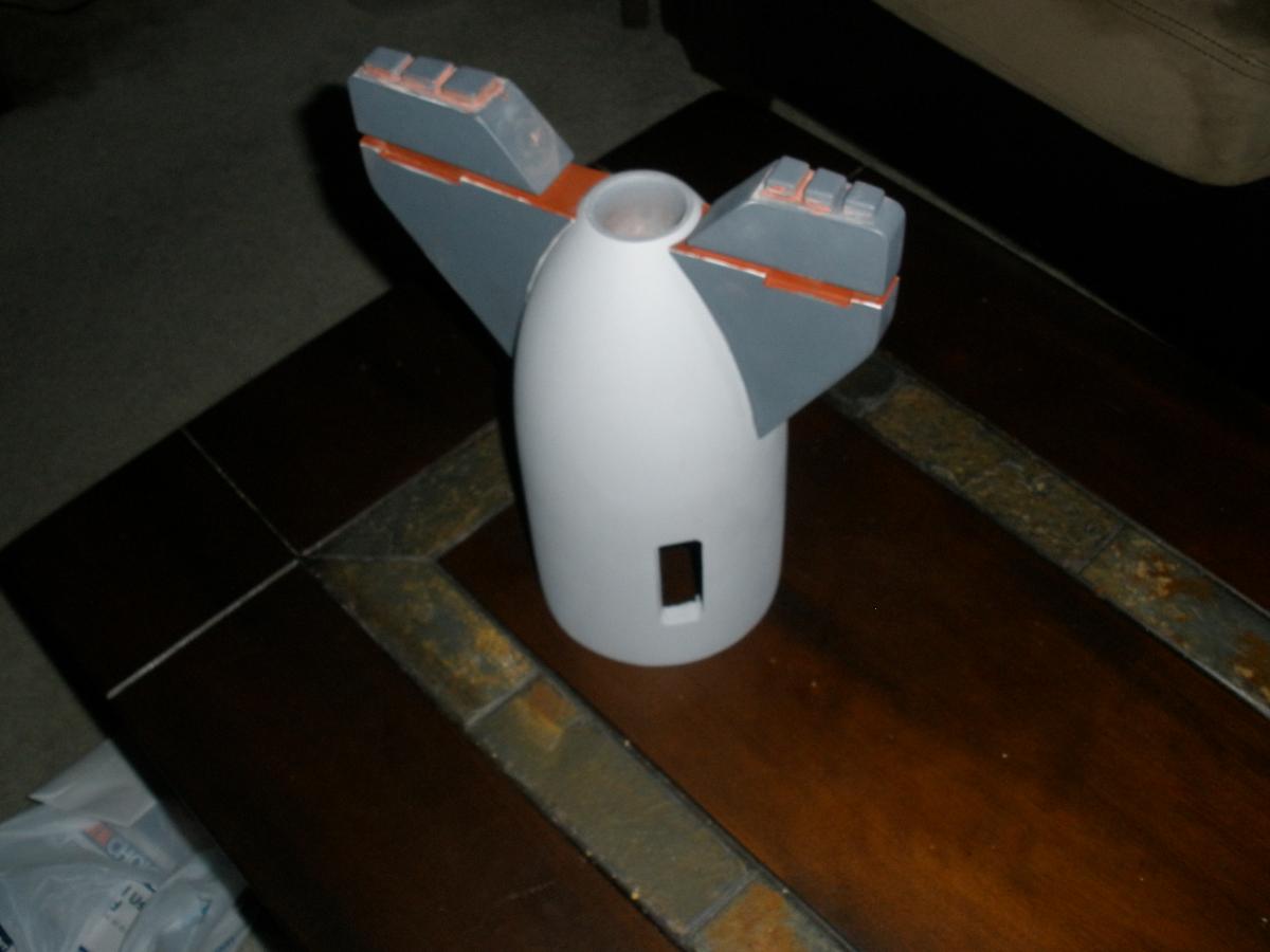

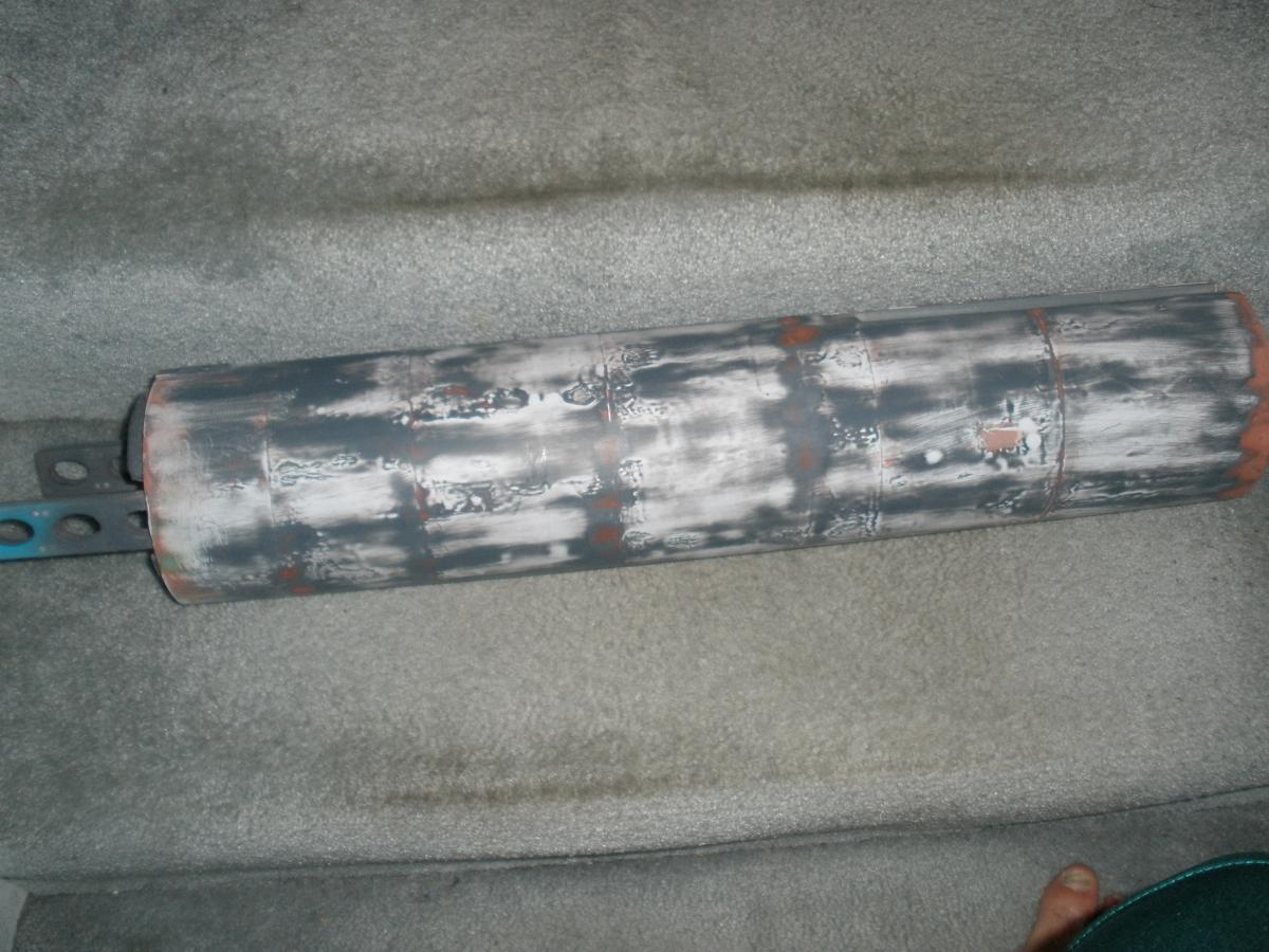

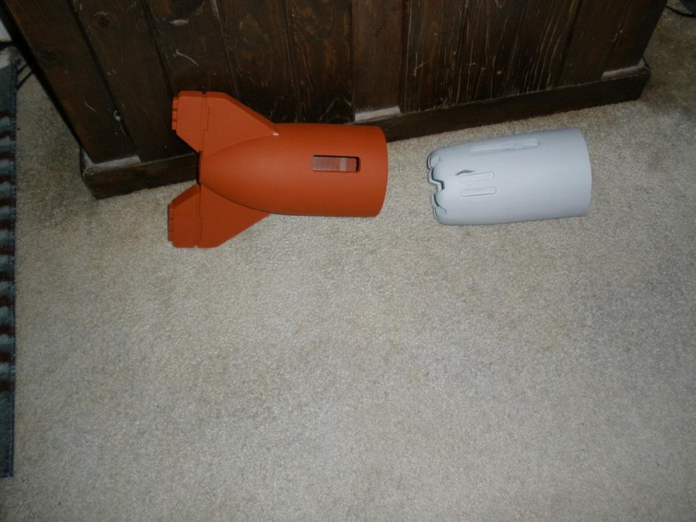

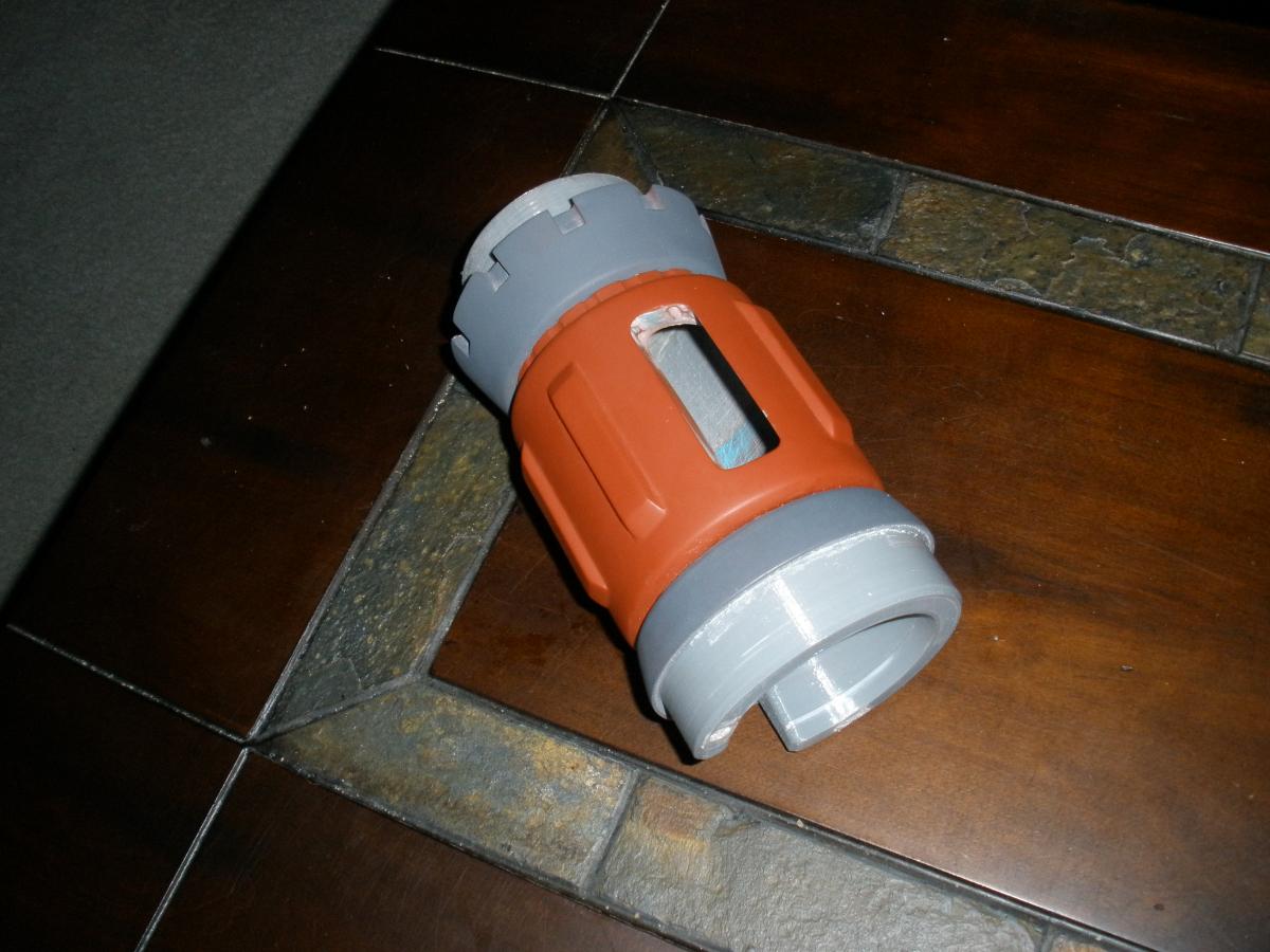

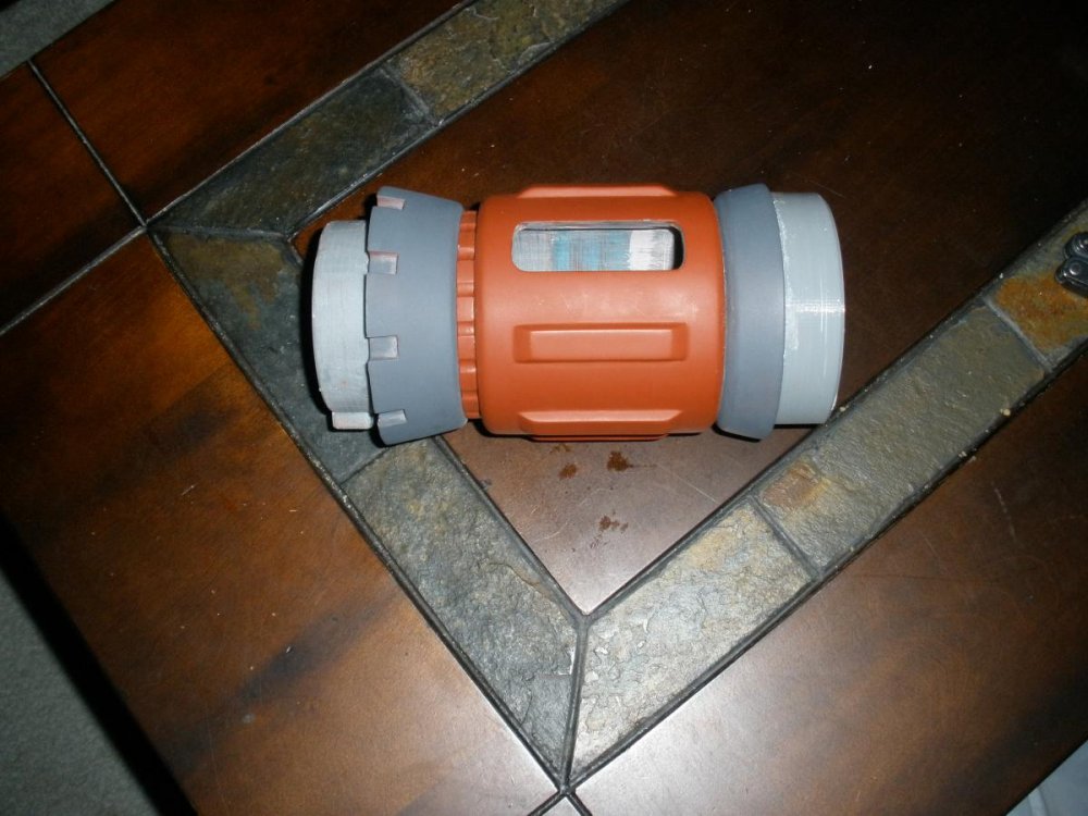

  7. Thing is starting to look like a cannon now. Kinda stuck in the vicious " Prime, Fill, Sand....... Repeat " cycle at the moment. Note NEVER use rustoleum filler primer. That crap is garbage.

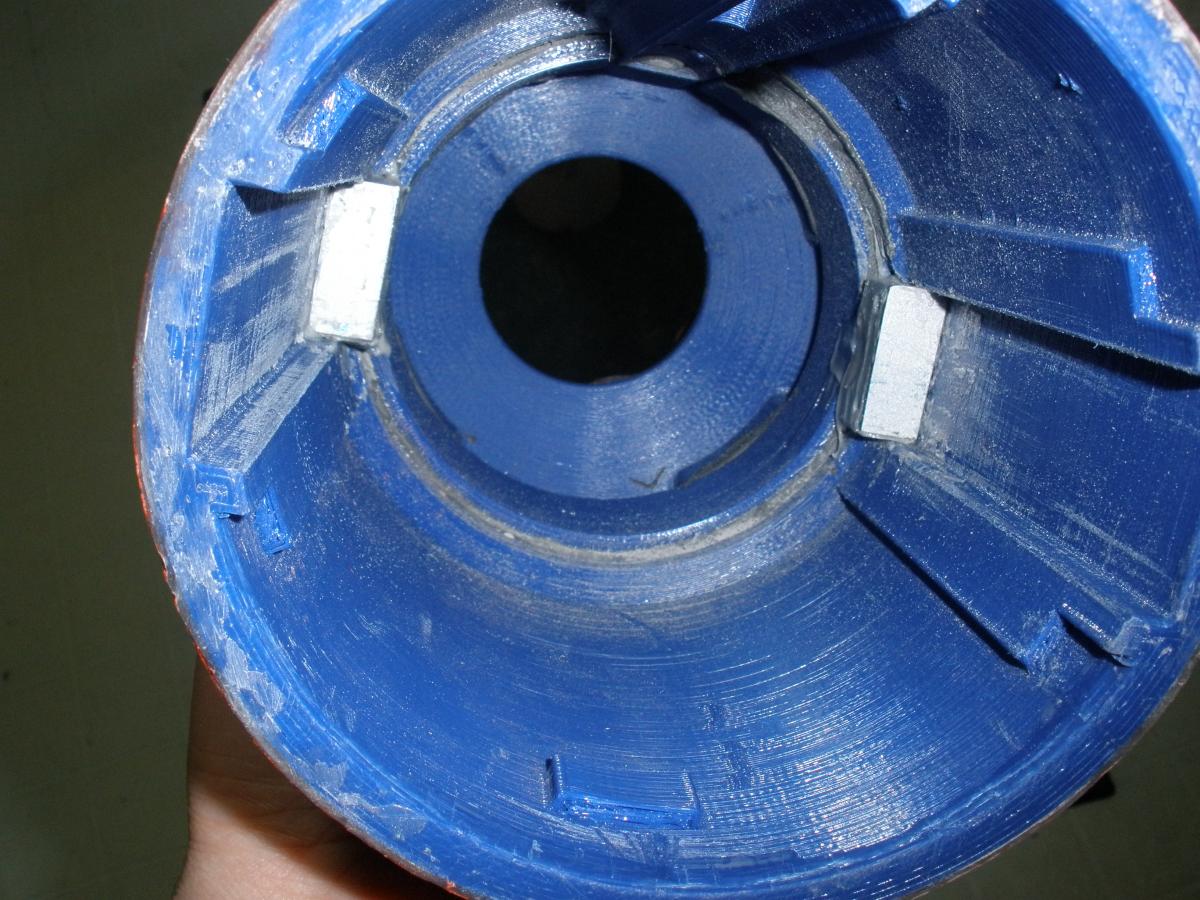

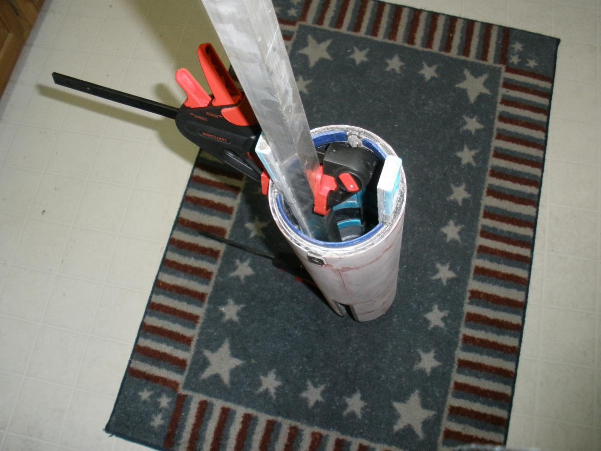

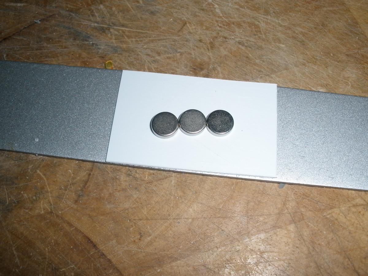

  8. Got the chassis rails installed. Added magnets to each end and stops inside the muzzle to help hold it secure. Might be a bit over kill friction alone might be good enough to hole it on, got to use my feet to hold the body to pull it apart. Glad I still had some aluminum square tube hanging around. made for a perfect clamp.

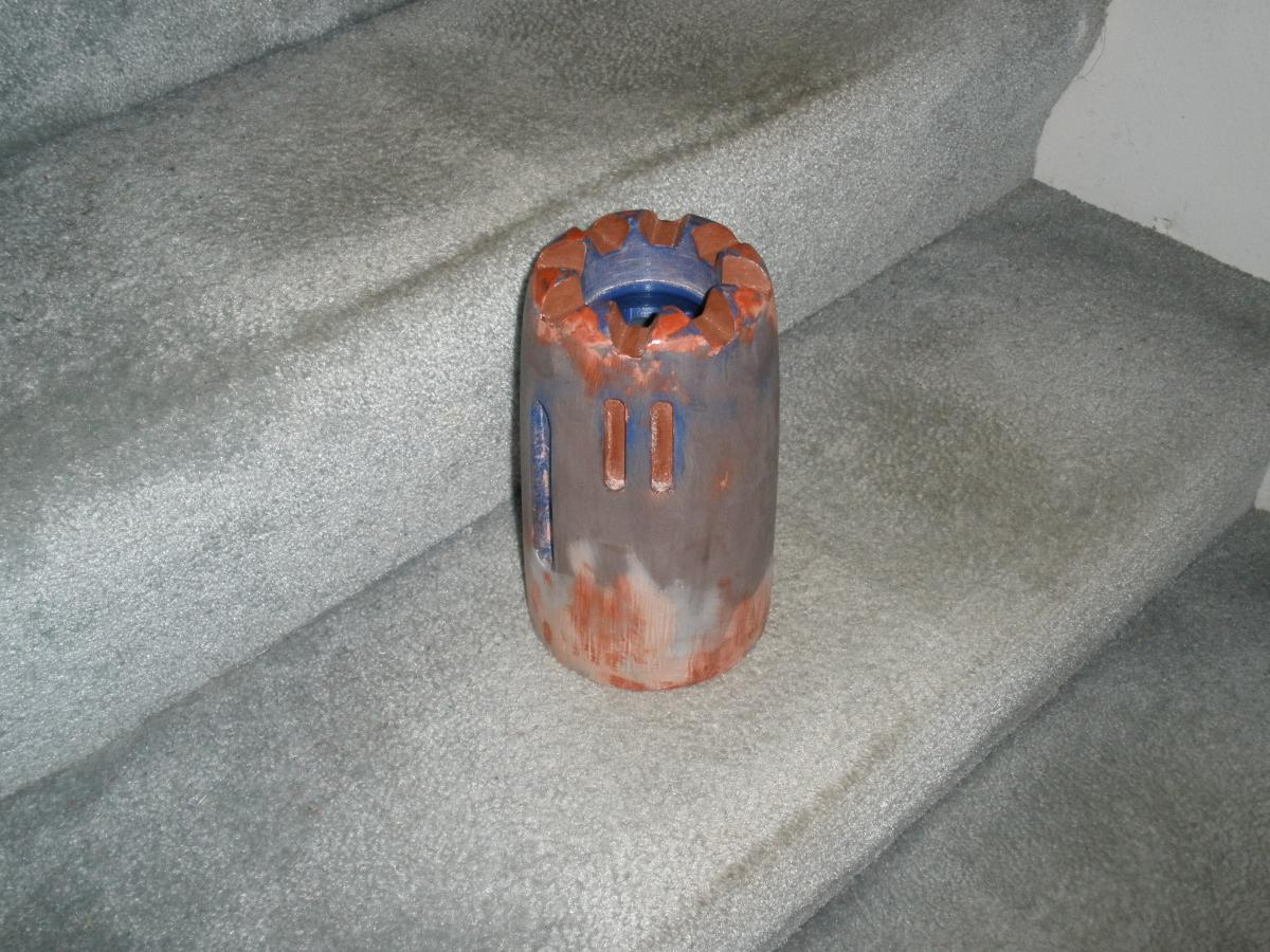

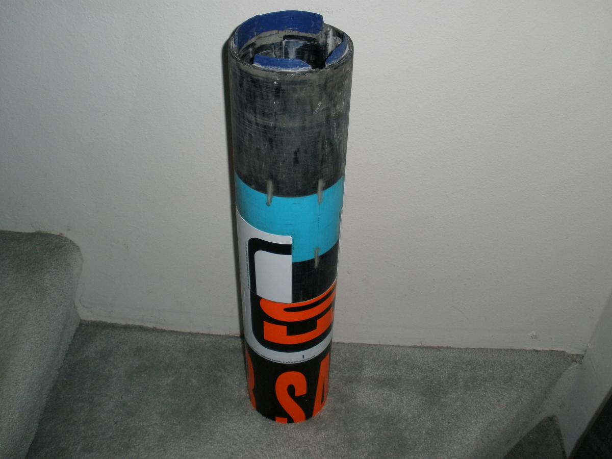

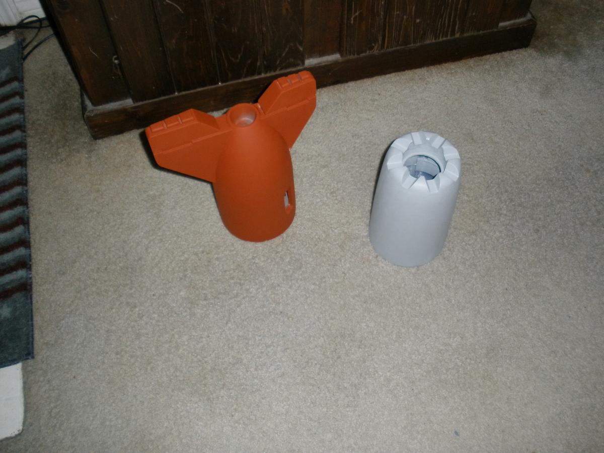

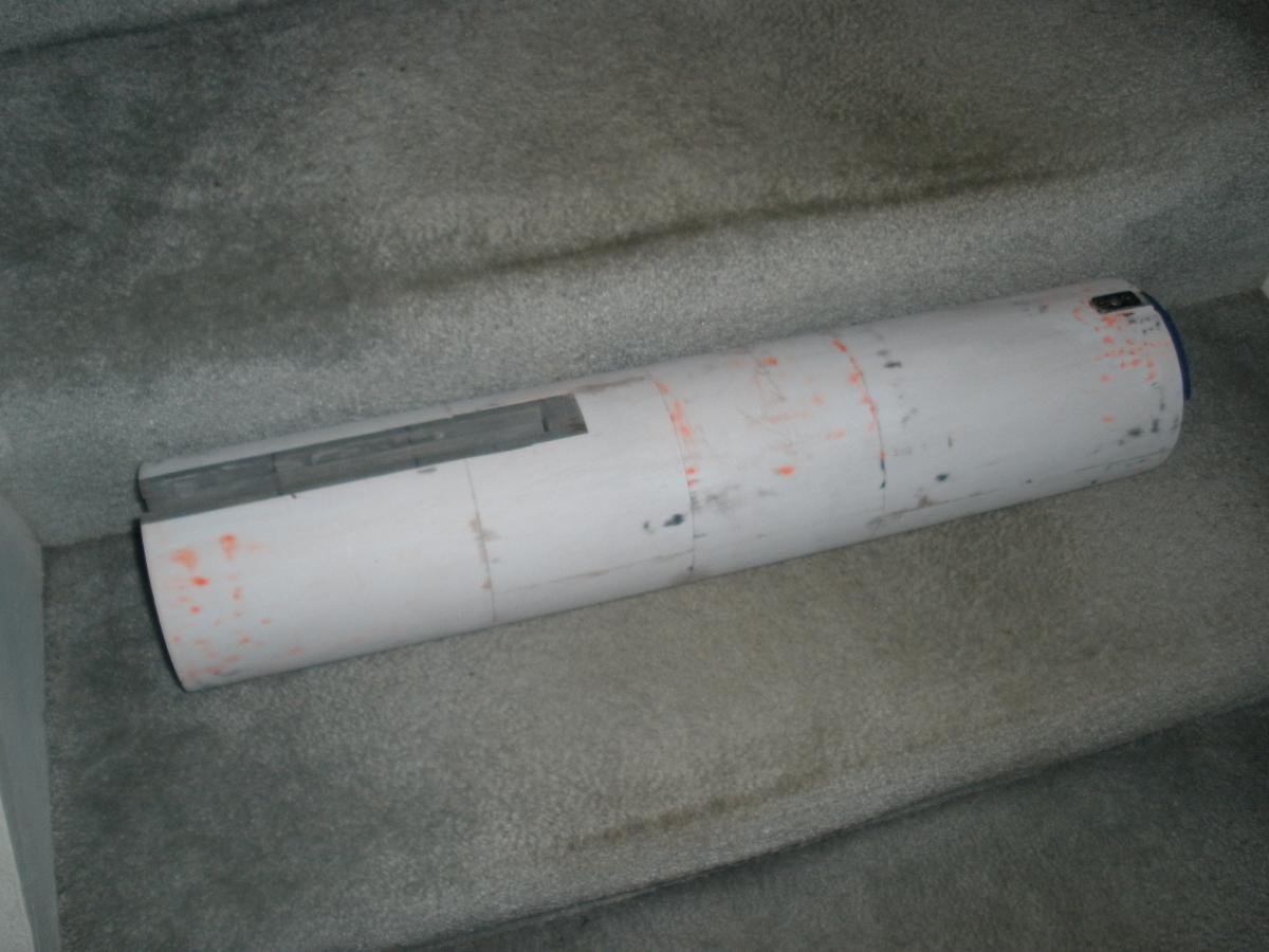

  9. So. Learned a valuable lesson. When using signs for a source of styrene. Remove the printing first then glue. It took forever for the solvents to off gas. But it gave me a chance to add more epoxy layers to the front and back cone so the all have about the same outer diameter. Now lots lots more sanding Yeaaaa. First layer glued with contact cement second layer glued on with testors glue end caps thickened

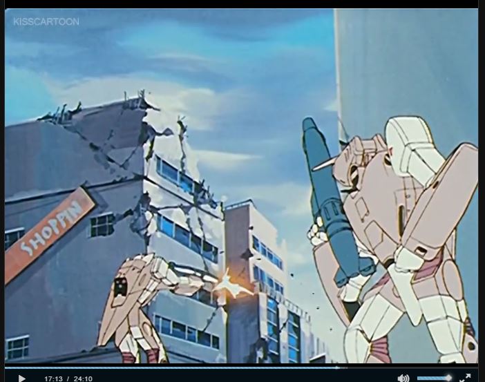

  10. Crappy screen cap but you can see the arch of spent cases from the 1A on the left. (just a series pf black specks)

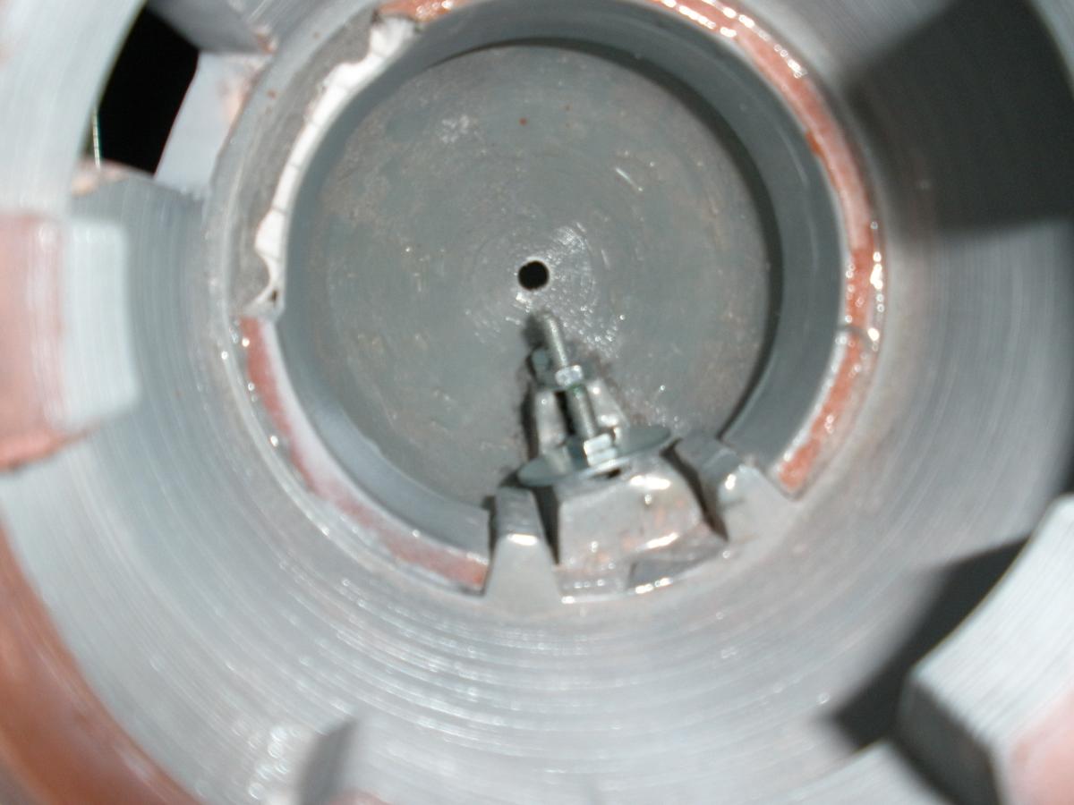

  11. Not quite big enough for a complete .308, Which It should be big enough for a complete round. It is however big enough for a .50 Beowulf. I thought about making it eject spent cases, but it just would have used up too much space to make a magazine and something to force out the cases. Maybe next time.

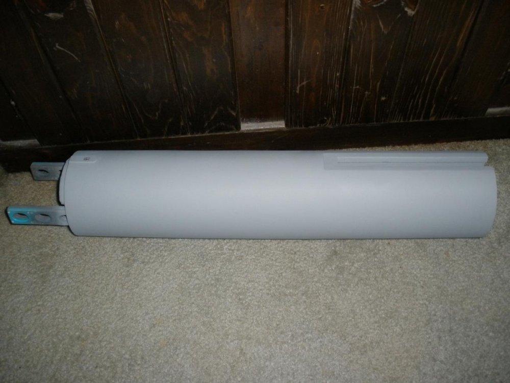

  12. Success!! It would appear that contact cement loves to bind to PLA. Not quite so much to styrene. But more than strong enough for my needs. I need to make a run to Walmart and pick up more. The small craft bottle did not go quite as far as I thought it would. Ignore the fact it's covered in "For Sale" signs...... Just a cheap source for large styrene sheets.

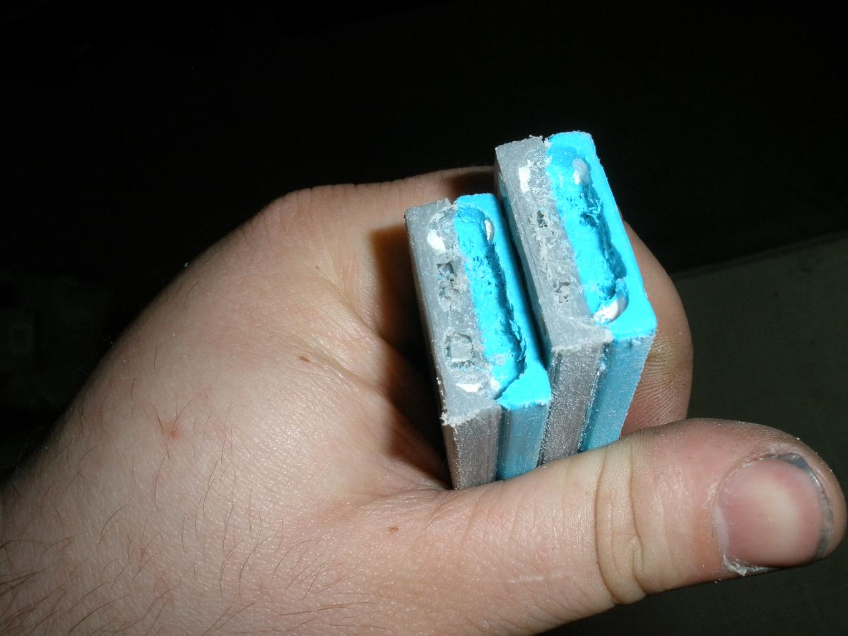

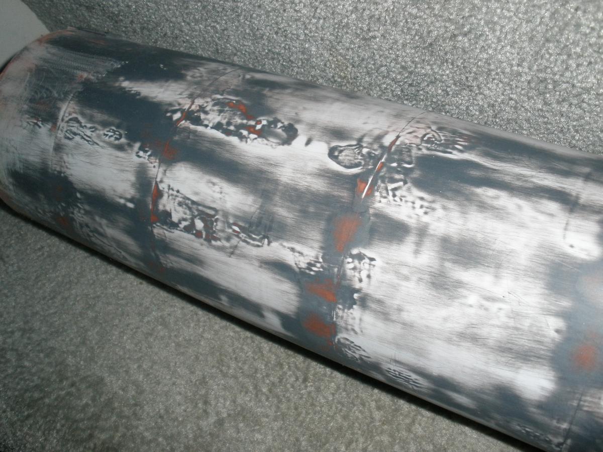

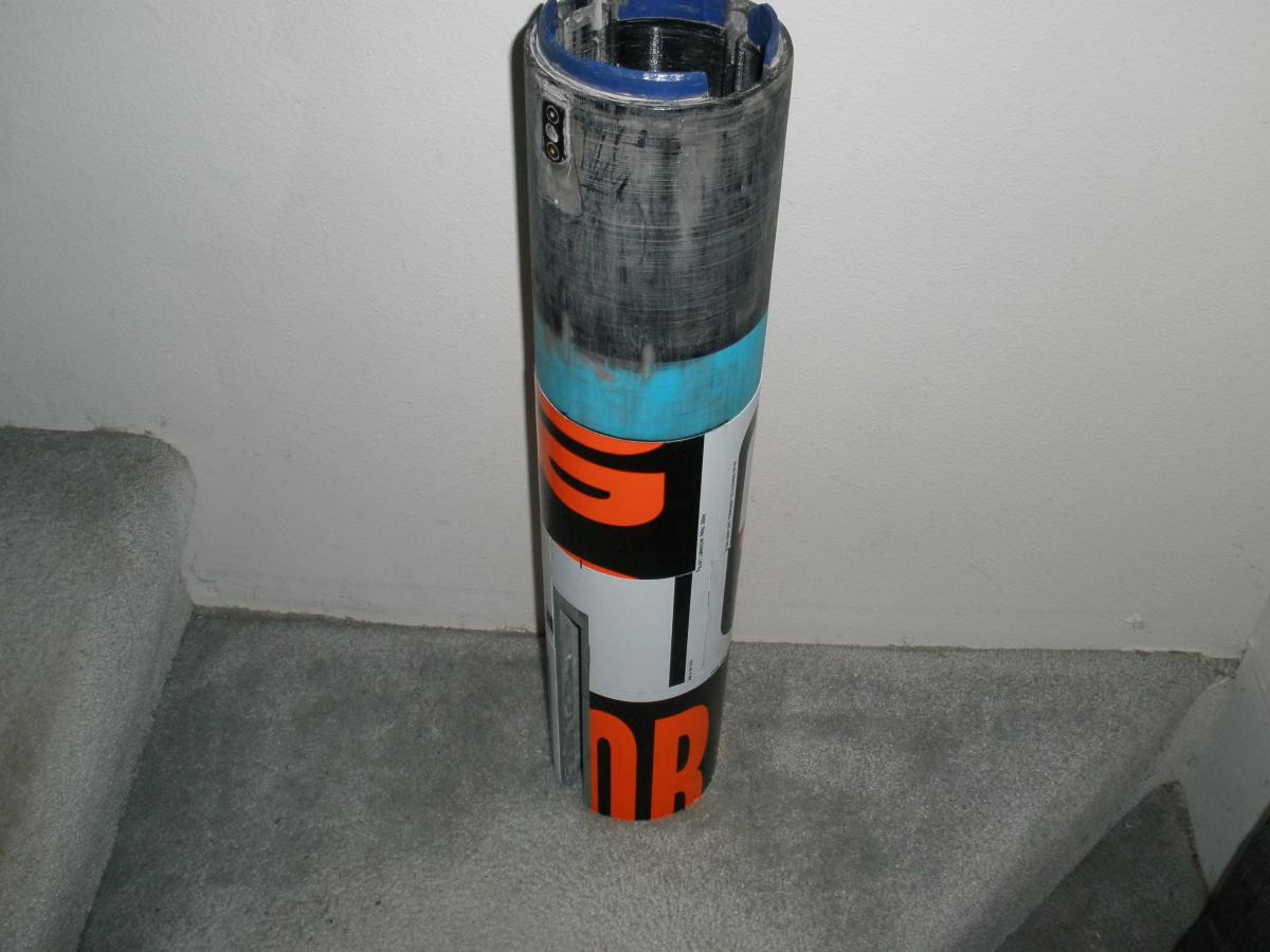

  14. Ok soooo. After many, many, many hours of sanding( I put that JB-weld on way to thick). Finally got the point were I was ready to start skinning the main tube. I did a couple test with failed prints, and superglue worked awesome on the test pieces. Tried it in the main tube for real and not so much. Big Time Fail. Pieces are just too Big to do with super glue. Leaves too many air pockets and no bond areas. Peeled all that off, re-sanded and went with Plan B, Lock-tite brand spray Contact Cement. Sooo. fail number 2, (that crap doesn't bond to anything and it just makes a gummy mess like that crap they use to glue on address labels to magazines.) So I'm on plan C, Dap Weldwood. So far so good. i doesnt just peel off PLA or styrene when its dry. So got some test pieces glued up and gonna let them cure a while.
