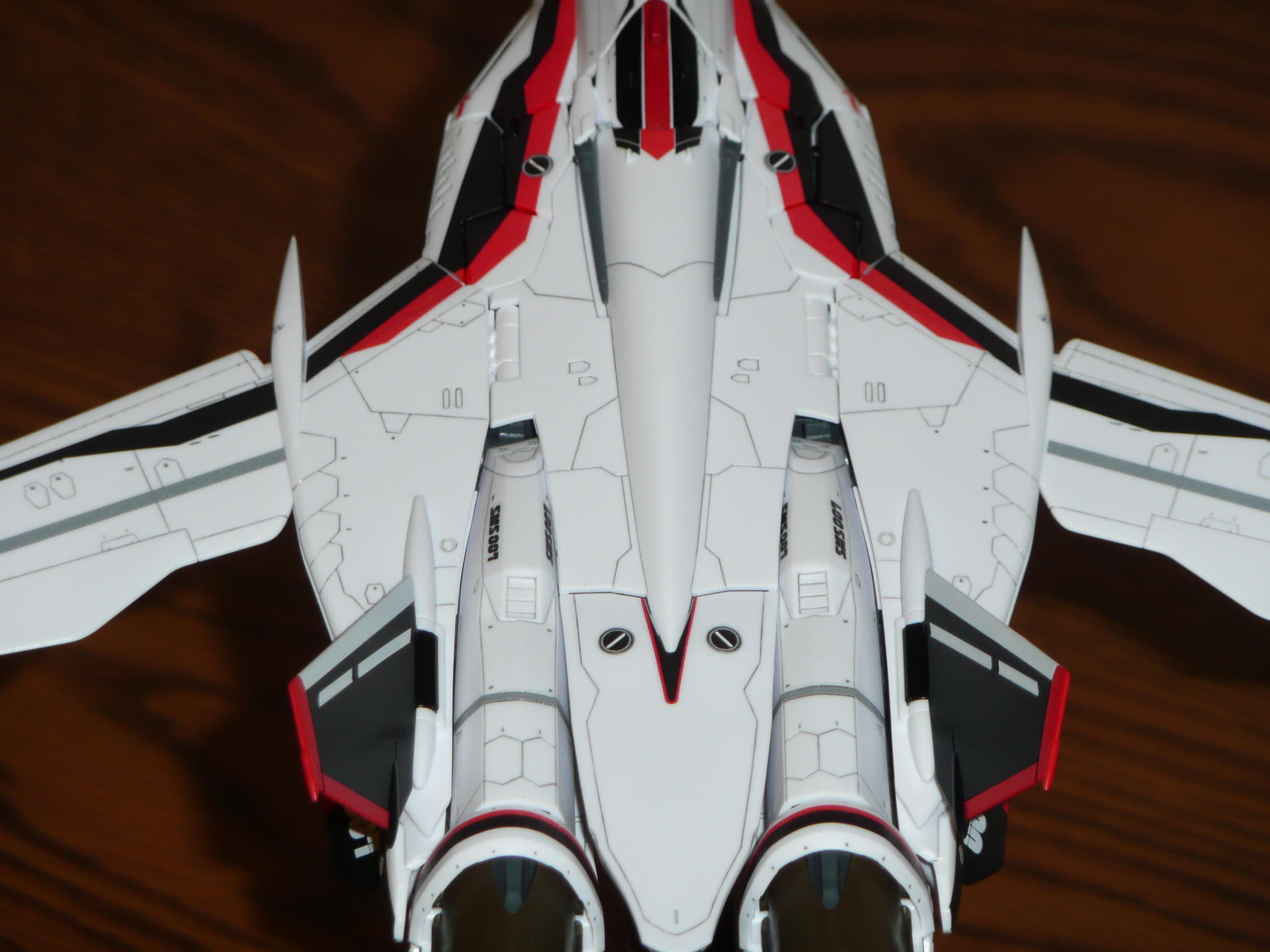

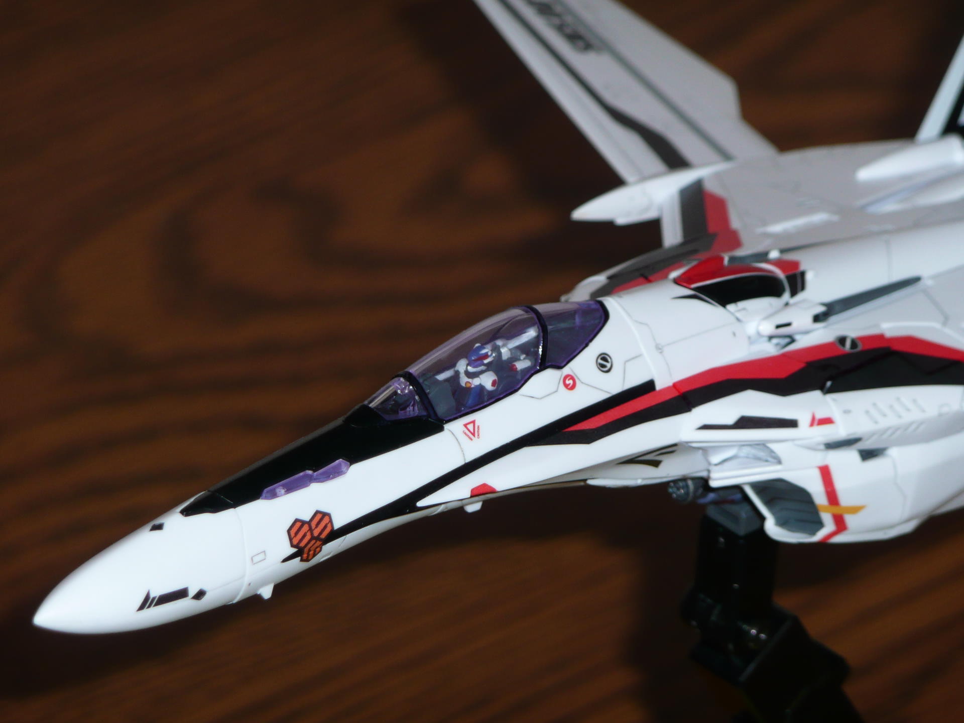

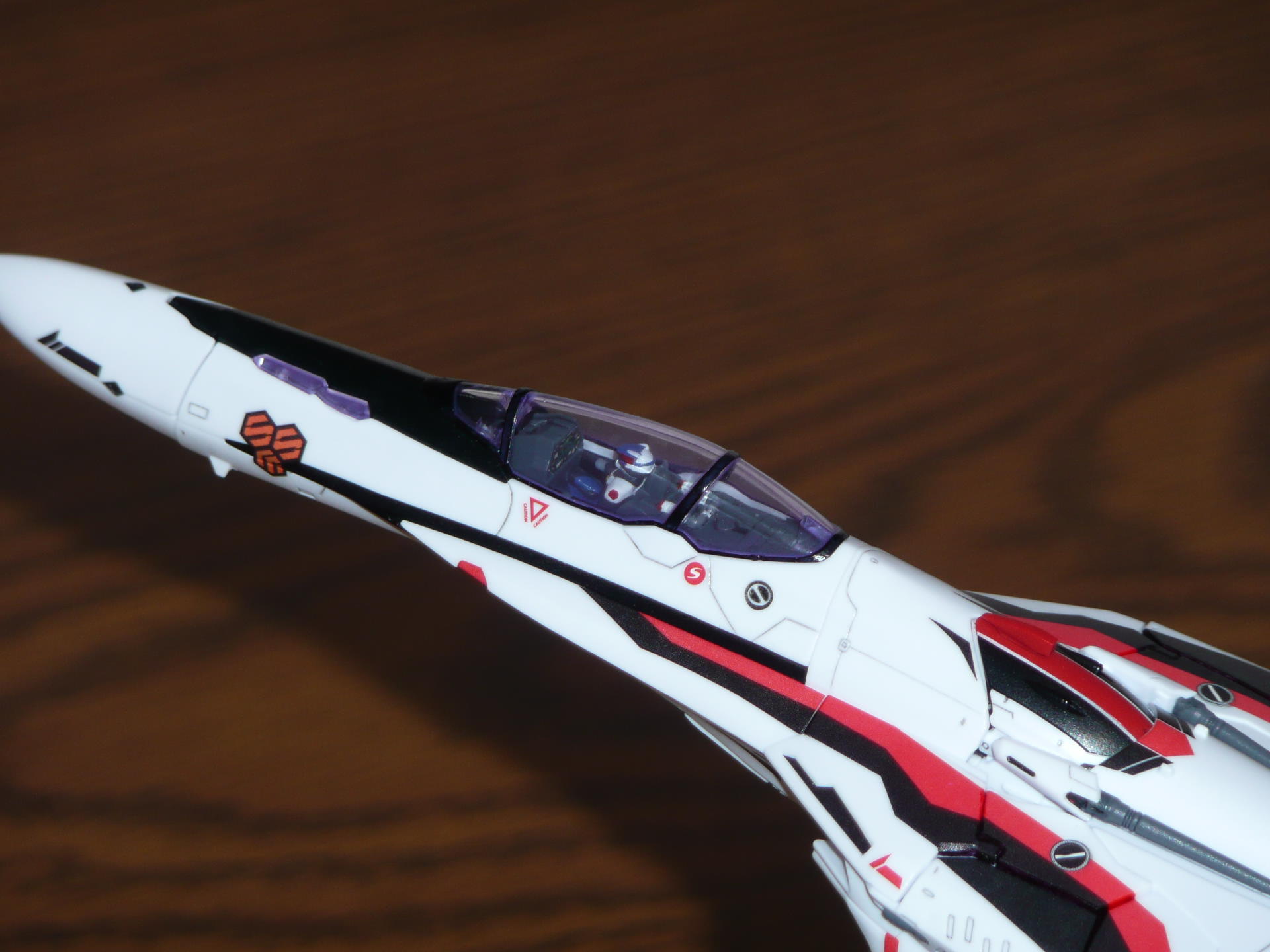

Here's some pics of the rough assembled model (ignore the folded down tailfins, I don't remember why I was playing with that...) and the canopy progress:
Apologies for the lousy quality - what looks good on the disply of a reasonable camera phone (Nokia E-71) looks terrible on a computer monitor.
I left the extra bits of sprue as a means of grasping the canopy. I later realised they were getting in the way and the built in tabs were a better option.

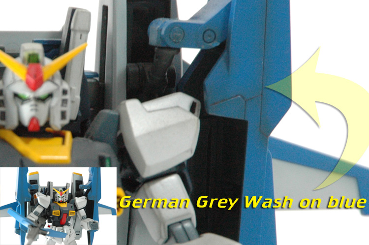

Hi mickyG! nice work on the vf-25G. I would suggest a darker grey wash on the blue. German Grey perhaps is the best color for that type of blue.
Heres a pic of my old super gundam with german grey wash.
Just my teo cents. :)
Nick
Thanks Nick. I like the look of that. I was thinking of black but it would likely be too stark a contrast for what I'm going for. I'll see what I can mix up from my artist oils.

Finally had the model, camera and time to work on it all together today. So I figured I'd put a quick black artist oil wash on the leg. I love the results! Not sure if the pics really do it justice but the bright metalic finish that looked a bit fake before is gone. It's been replaced by what, in my opinion, looks much more realistic.
Flash, no flash. No flash, flash. Amazing what the flash brings out that your eye doesn't see in normal light.
The inner framework is all done now - painted and black oil washed. I"m pretty happy with how it looks. I'll spray a semigloss clearcoat on it to seal it all in after I've made sure all the joints are tight and there are no more breaks or cracks that need fixing. The last one I found was the neck piece with the ball on it for the head - Had a crack right on the pivot joint. No idea how I managed to break that but it's safe to say the joints on this thing are fragile and care must be taken during any movement to prevent unexpected breaks.

Hey Micky, not to steal your thread or anything, but I wanted to post a few pictures, even though I have a terrible camera, of some of the work that I've done thus far, mostly inspired by your experiences written here.
I basically painted every single piece for this build, and took a little bit of liberty in my choices of color. I darkened and flattened the standard blue of the 25G, and then coated it twice (thus far) with a mixture of Tamiya Flat Base and Future.
Fins, painted this time. Was a pain. I work in a pretty messy area, so I need to find a better way to cover my projects overnight.. As you can see, dust and white speckles eventually stick back to the fins. Although its not permanent, I still have to dust off everything before working on it again the next day.
I recolored the entire gunpod in a mix of flat black and gun metal and coated it thrice with a flat clear coat. Its pretty stiff in the joints now, which is good, since it holds in poses great now. I still plan to dismantle it and paint the inner tines a green-yellow. I also plan to not use the pinkish decals that are provided, and instead paint a new red color in their place. The pink just doesnt go well with the black of the gun.
On the front of the instruction manual, you can see that the front tines are green, but the rear ones are not painted at all. While I think that the show did not have hollowed out rear tines like the model kit does, I would like to at least match the show's color. At some point, I would also like to paint in the lens on the end of the scope of the rifle.
I painted the thrusters in a metallic grey, applied a semi-gloss coat, then brushed on a rough flat soot-like layer of flat black and gun metal around the rear edges.
Here I followed what you did, and masked and repainted the underbelly sections blue/white. Off to the right, you'll notice that I repainted the darker blue pieces as well. Everything will be recoated with at least two more layers of flat clear coat. Its already very flat, although the pics dont show that well, but I'm concerned about the decals rubbing off like they did on my 25F.
