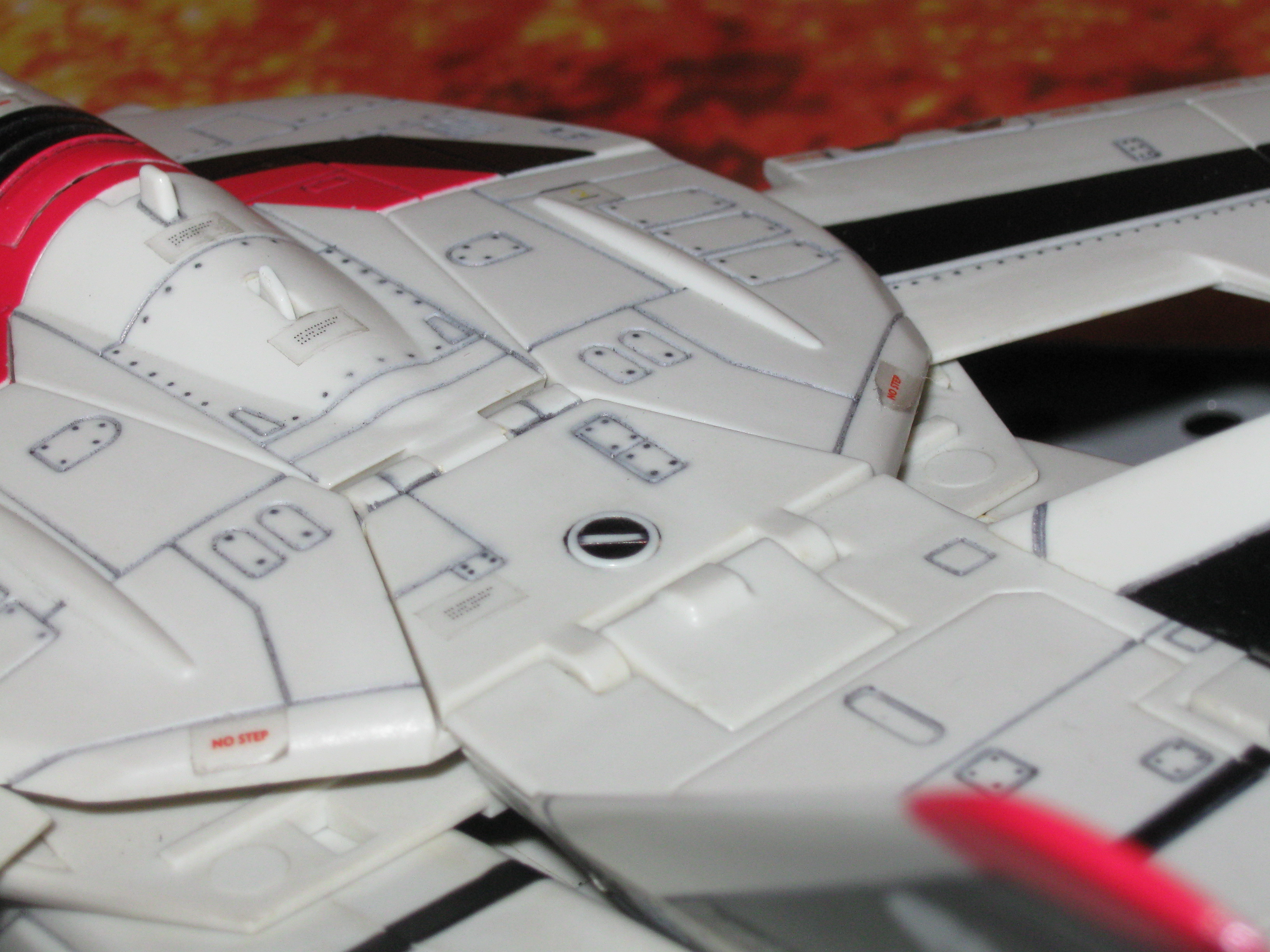

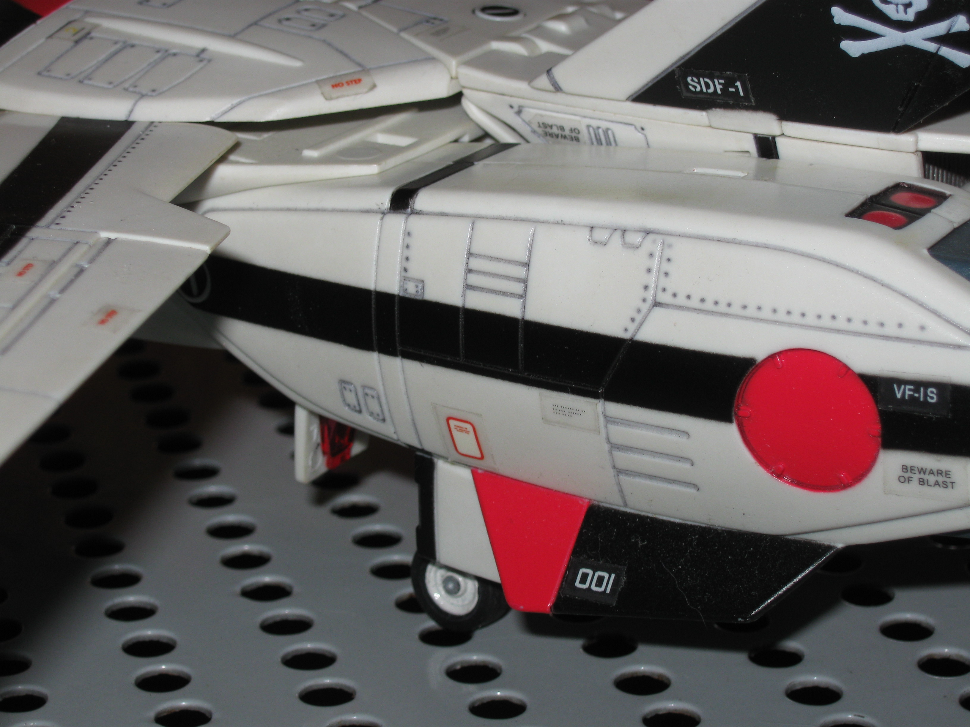

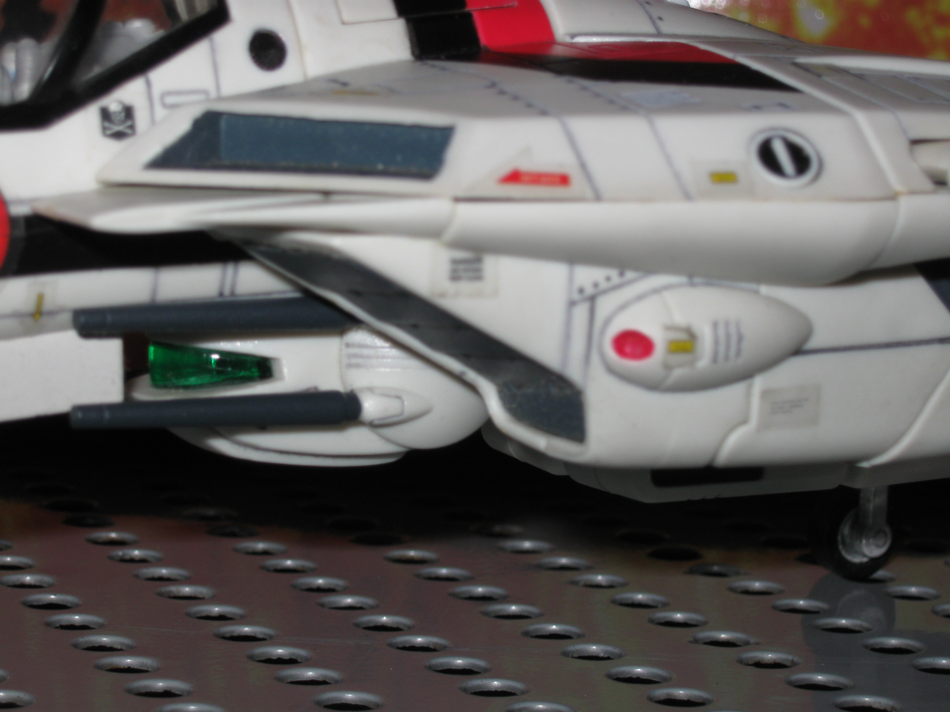

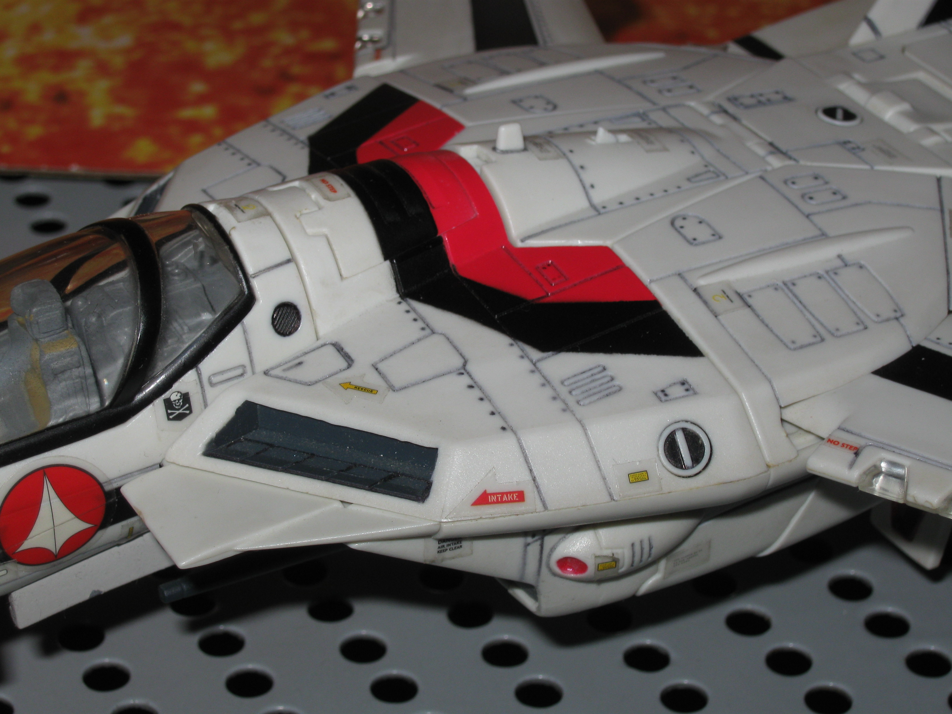

I finally decided to do some panel lining & got carried away.
the Hasegawa kit was great reference material, especially for the sticker placement.

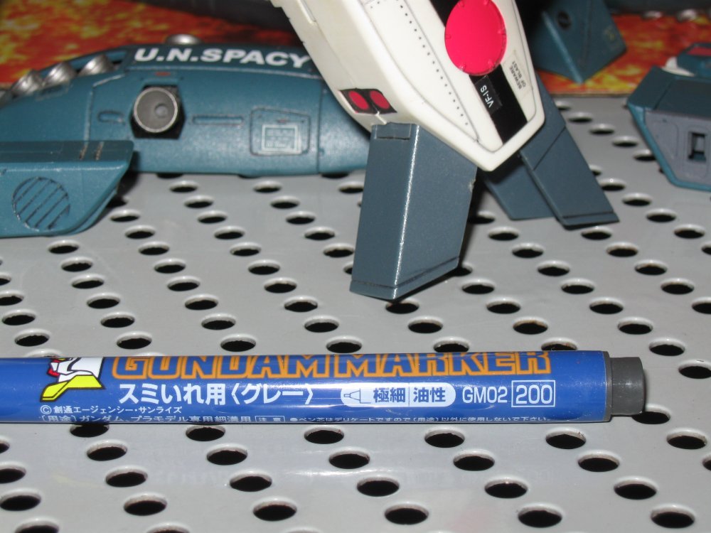

it was all done with this:
*not recommended for the v2.0 1/60, there are reports of the plastic reacting unpleasantly w/ the marker ink.
(can anybody confirm/debunk this?)
Thanks ^_^
How did you get the rivets so evenly spaced? Did you use a precalculated temlate? I like to use a .005 drill bit by hand very small so I have to be careful or the bit will snap.
Would you believe it's all done freehand?
i started with one side, while counting the rivets i draw, then try to match the other side.
Other times, i drew the rivets from opposite sides of a particular panel one at a time until i reached the middle.
If i worked fast enough, i could erase the rivets & start over. other times, i ran out of time/space & the rivet would be ridiculously close to the edge of the panel.
The straight lines though, were drawn in w/ the help of an erasing shield.
i thought about using drilling the rivets in too, but it would've gotten tedious real fast & can't be undone.
The marker approach on the other hand, was quick & painless.
