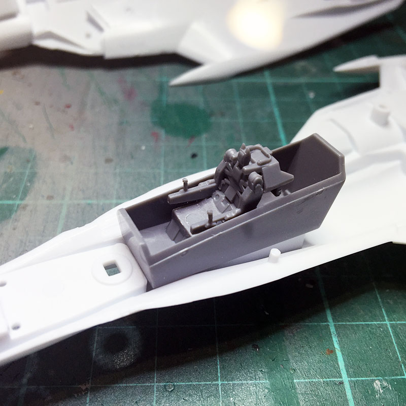

Mintox Posted April 20, 2016 Author Posted April 20, 2016 Finally made a start. The cockpit is a bit bland for such a lovely kit but I guess once the two body halves are glued together most of this wont be seen plus the hud? is added on later and the rear covered over.

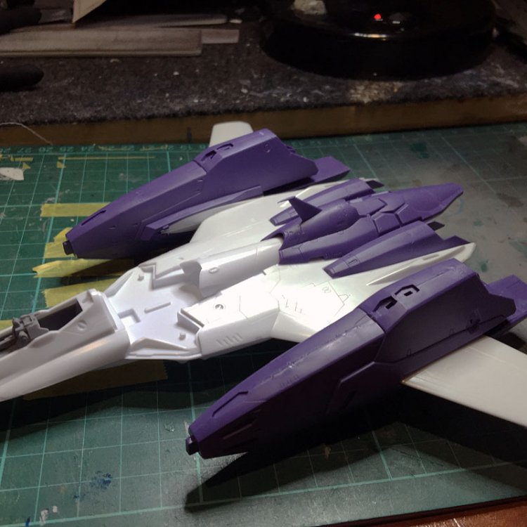

Mintox Posted May 4, 2016 Author Posted May 4, 2016 Test fitting the booster and body parts. I love this kit. It has some of the sharpest and finest details for a 1/72 kit. I also just got a RVF-25 which I would love to add the extra armour and boosters to so I'm off to purchase another VF25S Super to steal the boosters.

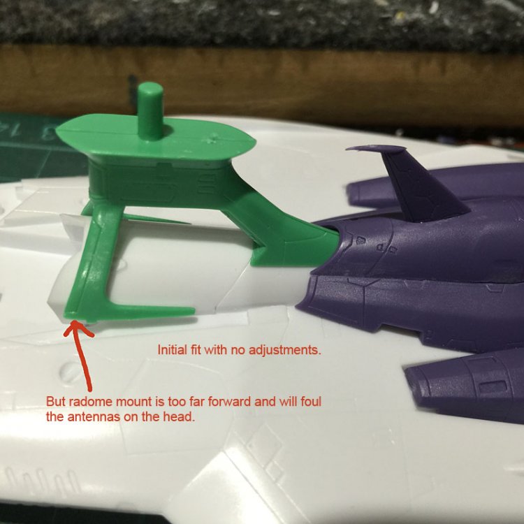

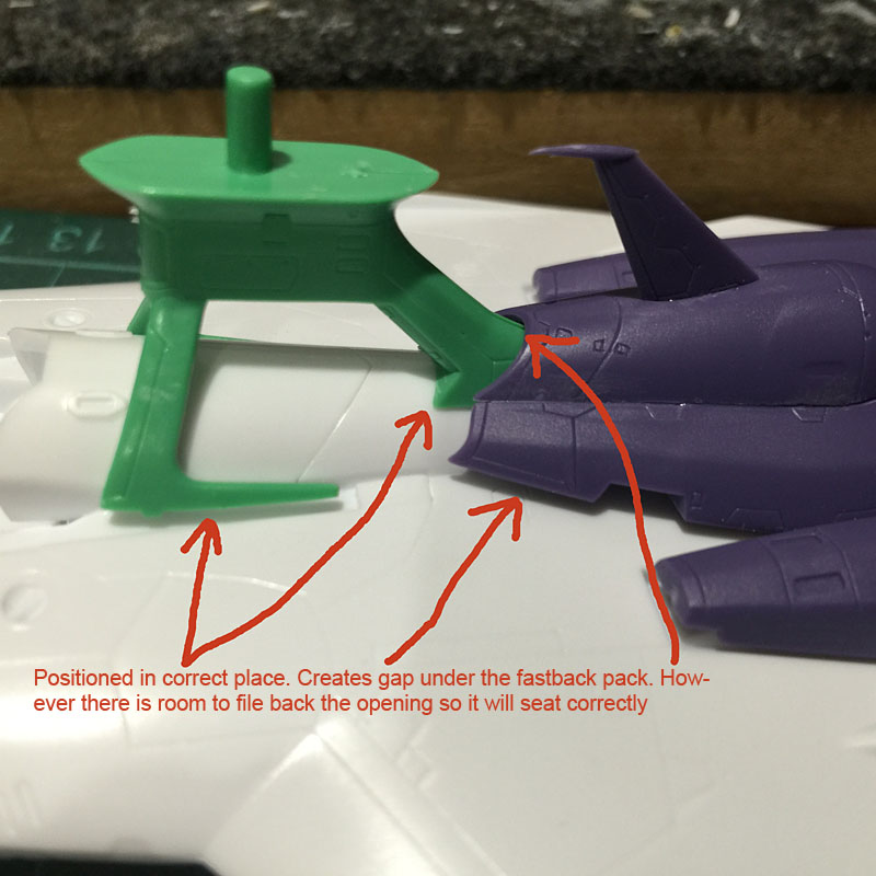

mickyg Posted May 5, 2016 Posted May 5, 2016 I'd love to know how you go with the fit of the boosters on the RVF - specifically the backpack part. The DX toy actually uses a modified part here, as the spine on the RVF has the third leg of the radome mount here. It may foul on the backpack but should be easy to sort out with a file.
Mintox Posted May 5, 2016 Author Posted May 5, 2016 (edited) I'd love to know how you go with the fit of the boosters on the RVF - specifically the backpack part. The DX toy actually uses a modified part here, as the spine on the RVF has the third leg of the radome mount here. It may foul on the backpack but should be easy to sort out with a file. Ok a quick fit of the radome mount seems to me it will work. A little filing of the opening on the fastback pack and it'll fit sweet. On second thoughts maybe filing the top of the radome mount rear mounting leg might be a better option. Edited May 5, 2016 by Mintox
