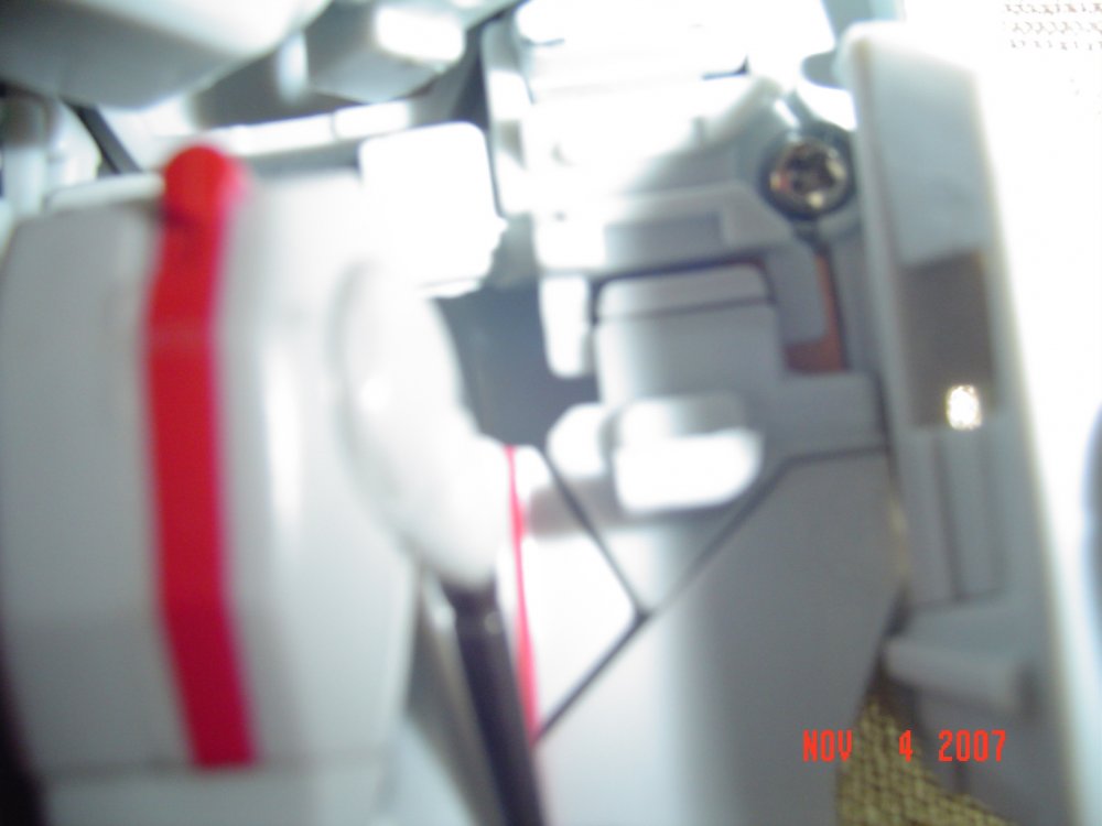

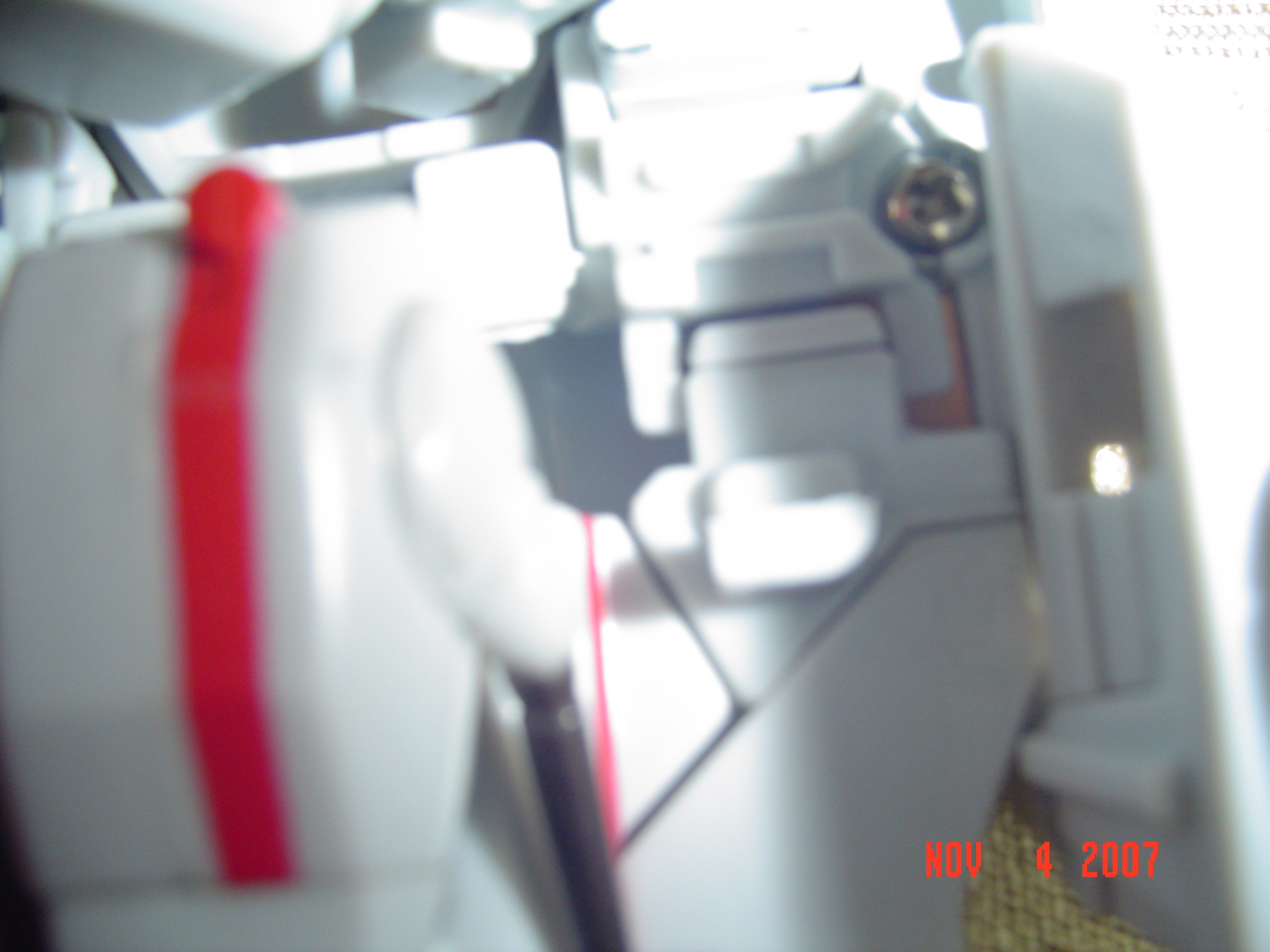

drkstar00 Posted November 4, 2007 Posted November 4, 2007 I just drooped my 1/60 and the tab which lock the legs onto the main body broke off. Any idea what glue will fix this so it will once again hold the heavy metal leg part?
VF-19 Posted November 4, 2007 Posted November 4, 2007 I just drooped my 1/60 and the tab which lock the legs onto the main body broke off. Any idea what glue will fix this so it will once again hold the heavy metal leg part? Superglue will do the trick, but you'll need to insert pins in order to get maximum strength. Just drill a hole into the broken part, insert a small piece of wire (a paper clip will do), then, you match up where the pin is in relation to the part's location, and drill a hole there too. Glue the pin to the broken part and the valk, and it should hold.
drkstar00 Posted November 5, 2007 Author Posted November 5, 2007 Thanks; will do. I had the thing in Gerwalk mode with arms still underneath with gunpod, and put it on the edge of my bed while I fracking studied. Where was my brain? I normally treat these toys with the utmost of care. grrrrrr...
