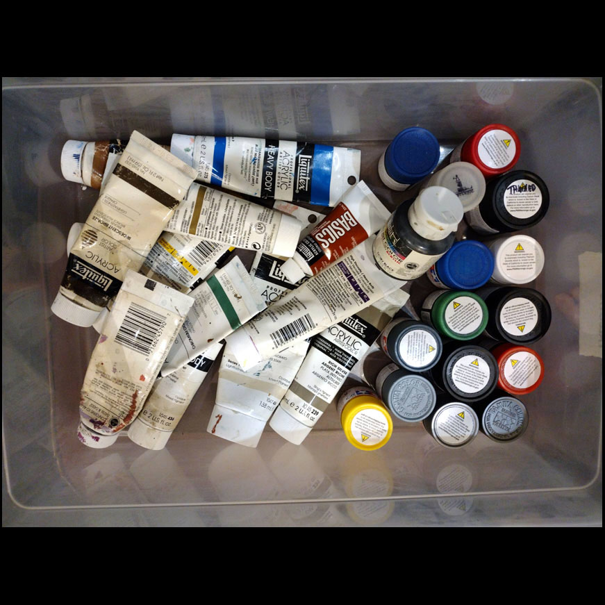

  4. Here are all the materials I used. If you have any questions just ask. Some final detailing touches.

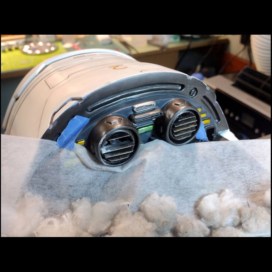

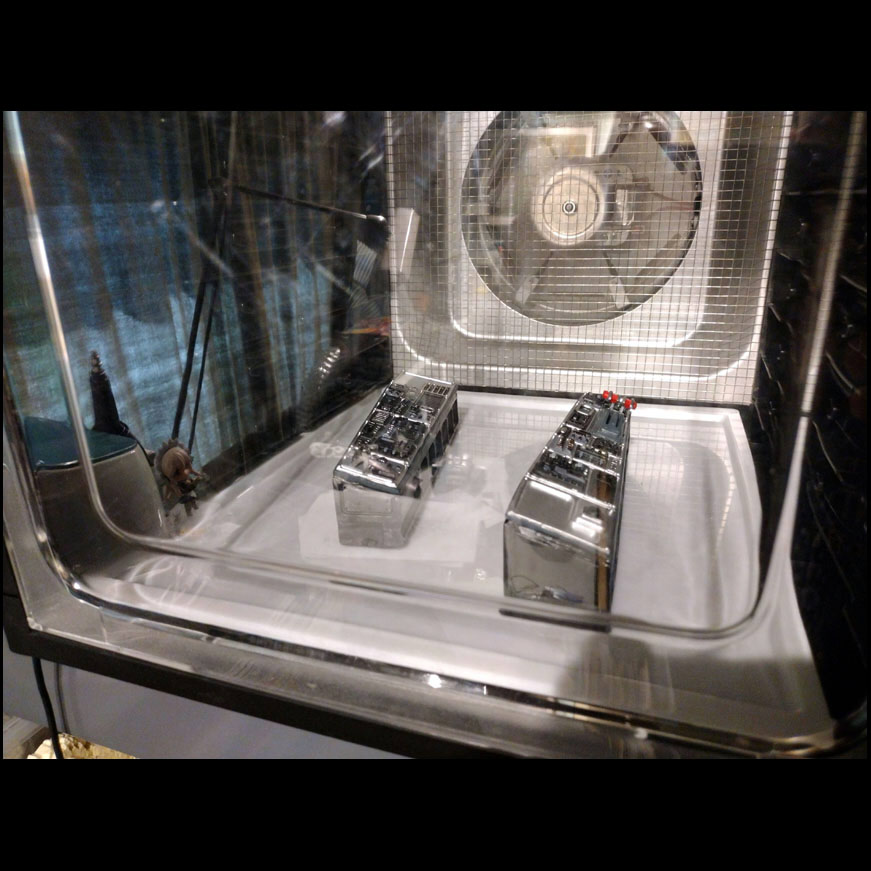

  8. If you don't yet have some Musou Black GET IT. Stupid web stunts aside it is an incredibly unique and valuable modeling tool. Unlike any other black paint it is both dark AND flat. Meaning you can use it to literally paint shadows. So in the case of these little exhaust vents that don't have recessed holes, a little Musou Black makes it very convincing. Similarly the far depths of the thruster now have more depth. I put the model into my dehydrator after clearing but didn't turn it on, just used it as a dust shield. I cleared it twice. Finished base painting Rick. Unmasked after clearing. Test fitting Rick. Then I had to fix the red area behind the canopy that was partially covered by the mask. I did this by brush, thinning the Tamiya a little with Mr, Color leveling thinner. The gap of the canopy hinge will be painted Rubber Black later. Detailing Rick, weathering looks a little heavy up close but reads well at normal viewing distance. More Musou black for the engine and radiatior intakes. Rick is now glued in place.

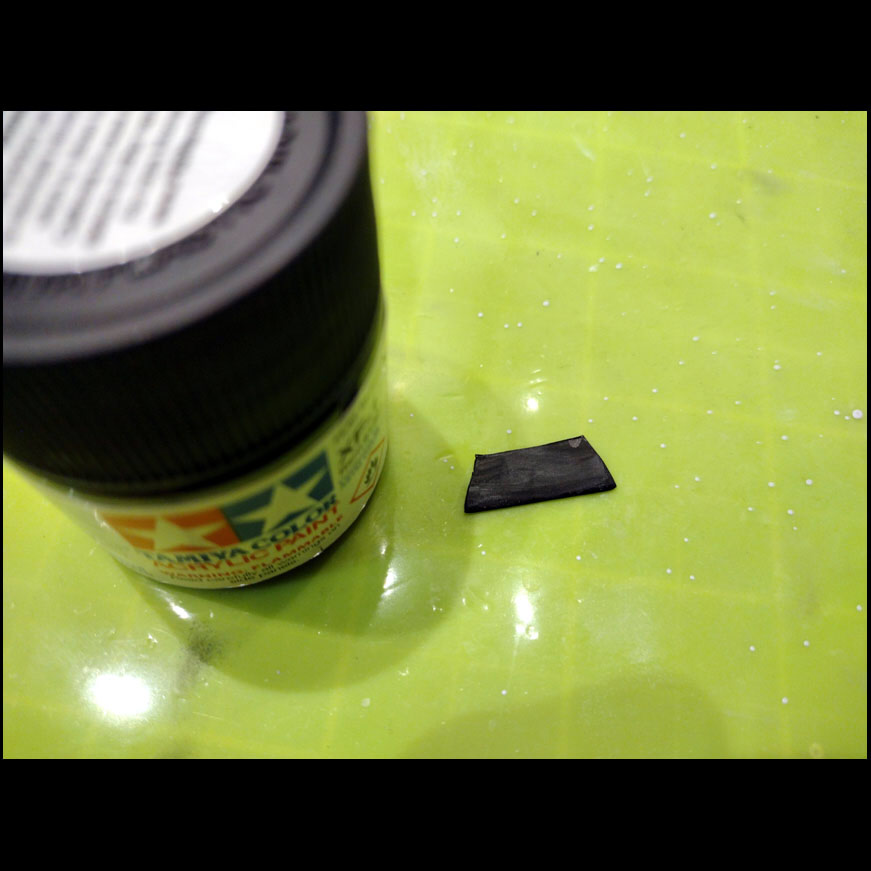

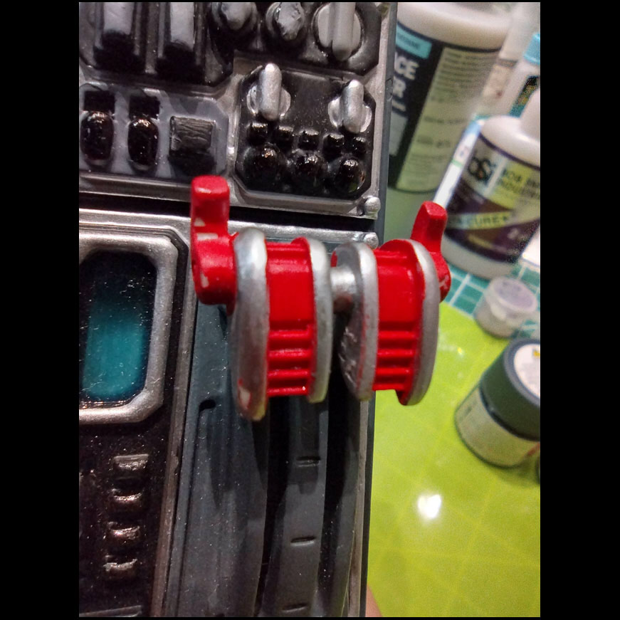

  12. I will point out that there are factory errors with this model. One is that the pilot's hands are both on side console controls but there is supposed to be a center control stick. And also the rear landing gear doors were scribed but not the fronts! I wanted to keep this a strict "what's in the box" build, so no scratch built bits. I used a few layered drops of Tamiya Clear Blue to build up thickness and give the impression of gauges. I dipped the cockpit in Future. and then lined the underside lip with Tamiya's Rubber Black to represent a seal. And then with the cockpit and canopy finished I joined the fuselage halves. Very annoyingly the center seam goes right through the cockpit cowl. Which means I needed to fill and sand there, and then repaint without overspray onto the cockpit or canopy.
  13. I base painted Rick and the cockpit, based on screen shots from Macross. The colors are not consistent, nor is the lineart, so it's open to interpretation. Then I thought the green was too green and so I desaturated it a bit, lightened the lighter green-gray, and repainted the cockpit. I used Molotow Chrome for the gauge bezels and two details that look like latches behind the seat. Then distressed the leather seat with thinned acrylic glazes. I still through the cockpit looked a little plain. Since the colors changed from shot to shot in the show I thought that maybe a little interference blue over the top of the lighter green would give it a subtle accent to catch the eye.

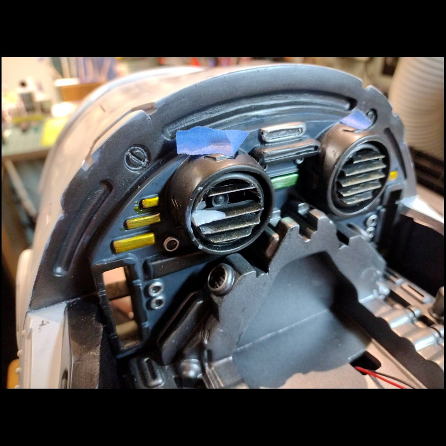

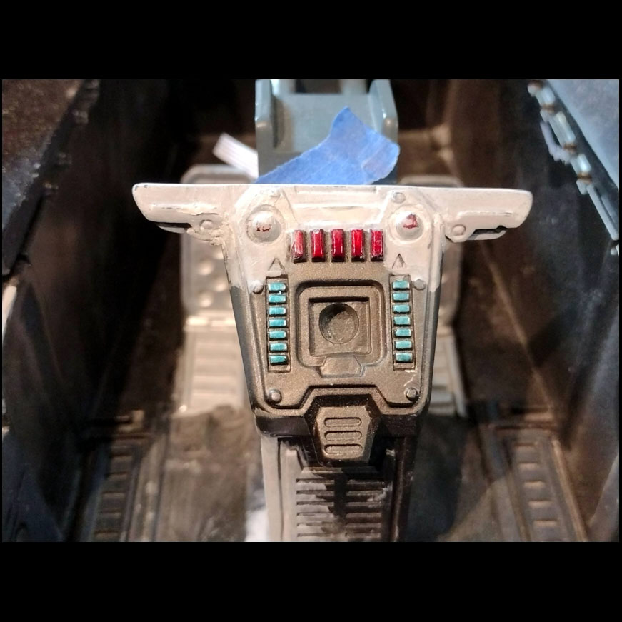

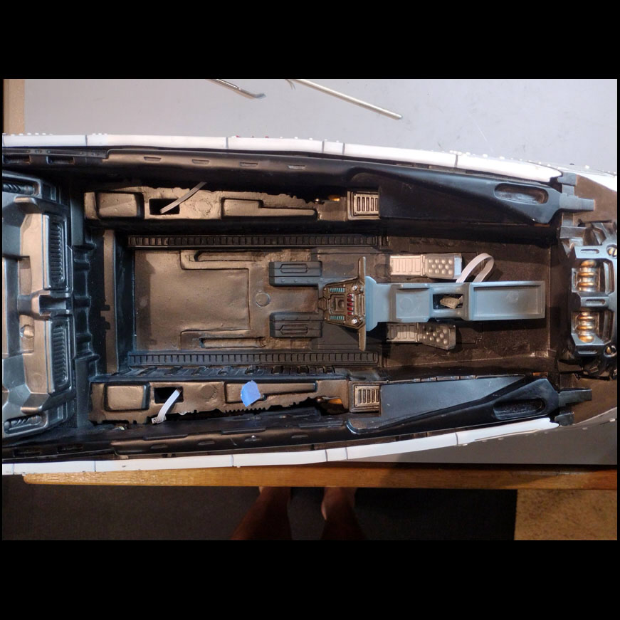

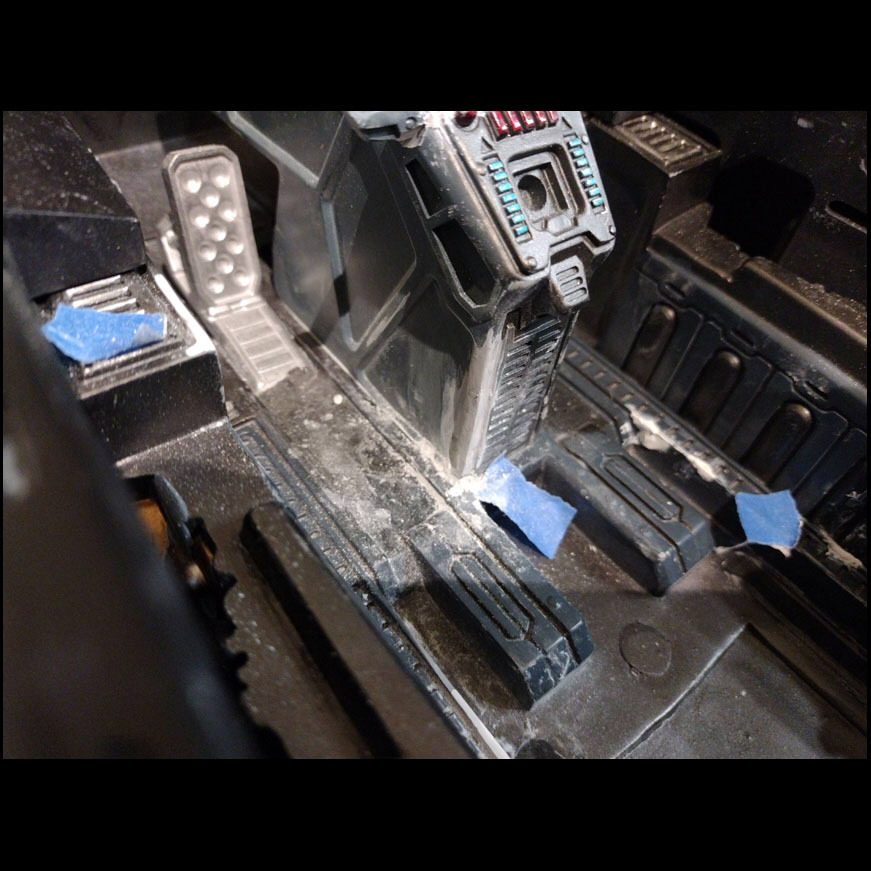

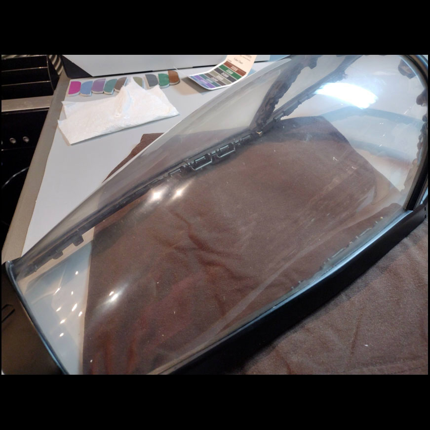

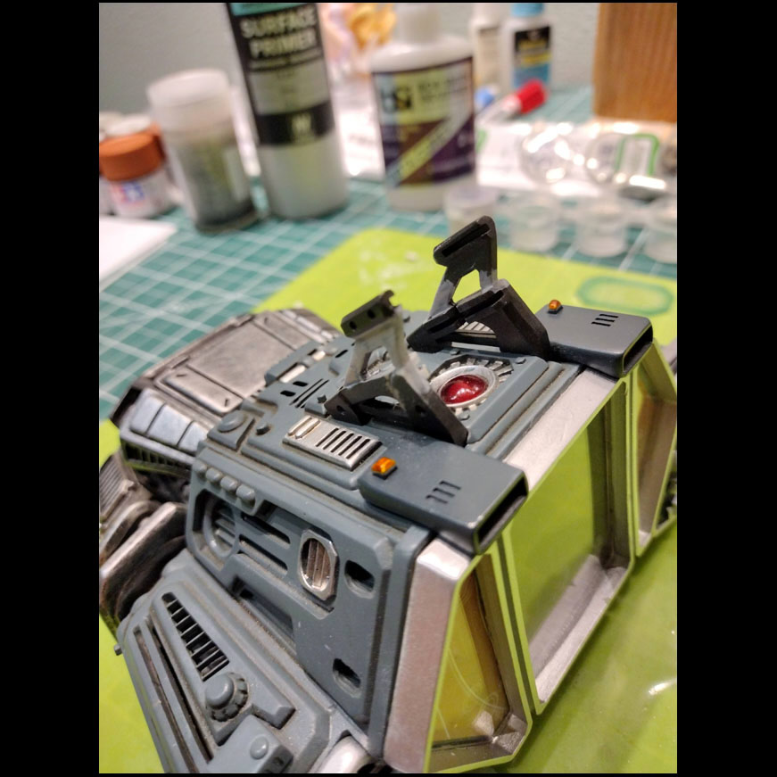

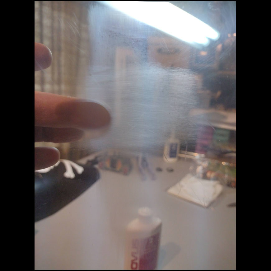

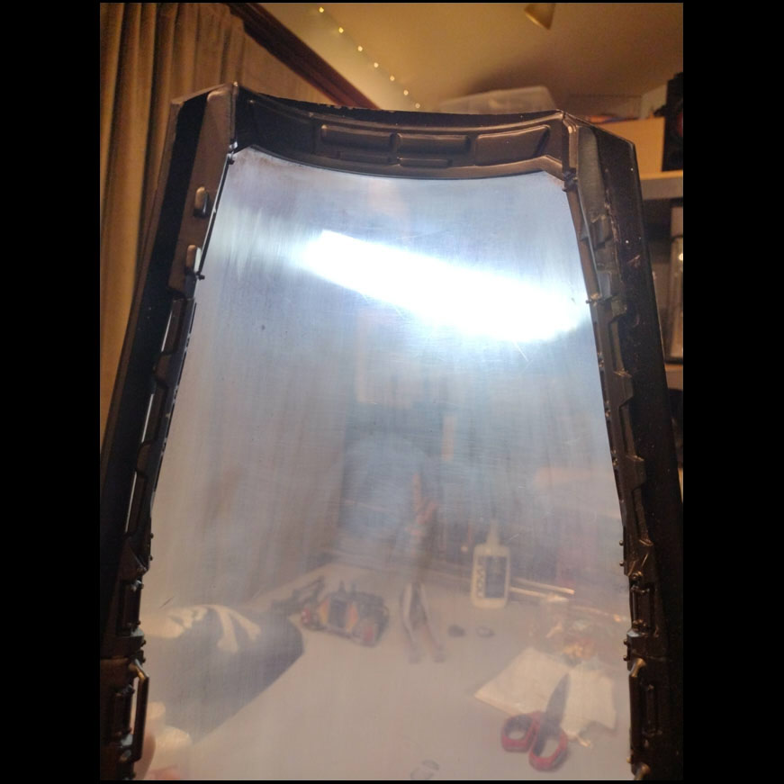

  15. 06-29-22 This, even though it looks pretty bad, is actually a big improvement over the previous sanding rounds (go ahead, scroll back up). And I improved it further. Mostly by...doing more. Sanding more, polishing more. Done with polishing. It's not perfect, actually far from perfect, but it looks ok. And it didn't. As long as it isn't a distraction to the cockpit detail below then I will call that mission completed. There were little chips in the frame's interior, which needed painting. Thankfully no filling/sanding was required. More chips up front, which were also fixed. DONE! And ready for pickup.

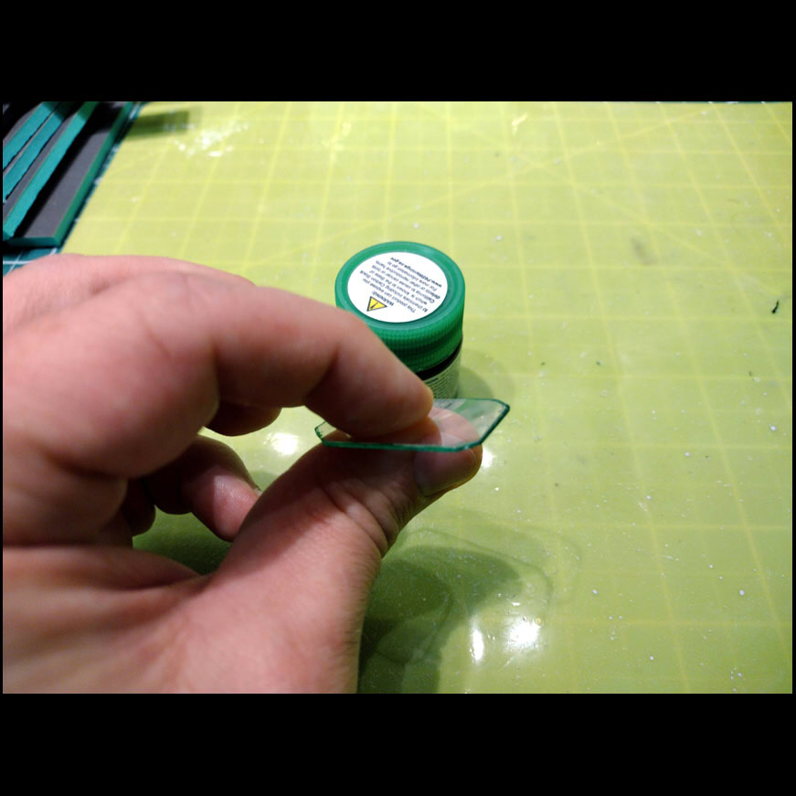

  16. 06-20-22 Another week+ of sanding and polishing, trying new techniques or variations of techniques. I can't really show these differences clearly via photo. Suffice it to say that I kept a log and of the 80 hours the project took, 17 of those hours were sanding and polishing this damn canopy. Which would have been FAR easier (on my wrist) if it hadn't been so thin, and concave. Looking better still.
  17. 06-08-22 Much time, few pics. Because polishing! Yeah it pretty much looks the same. But it doesn't. Not in person. Note the time jump, a full round of sanding many grits and then full polishing led to this marginal improvement. Still a bit of haze, although it looks pretty good from this angle.

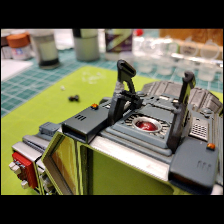

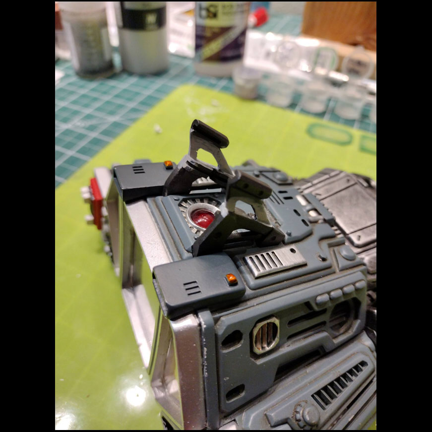

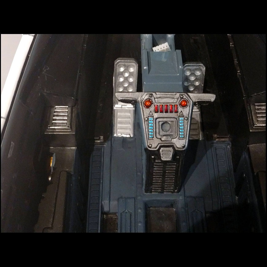

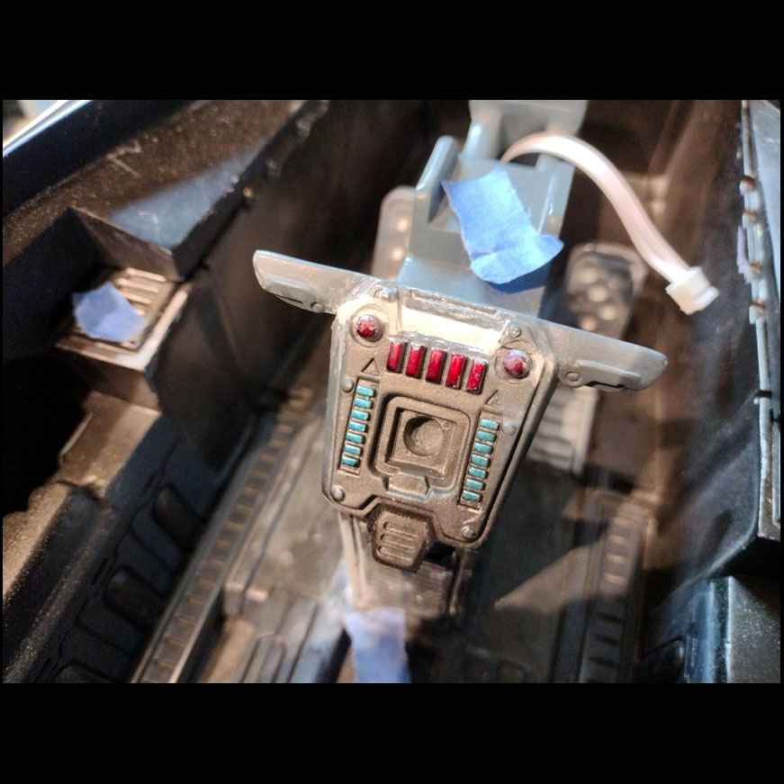

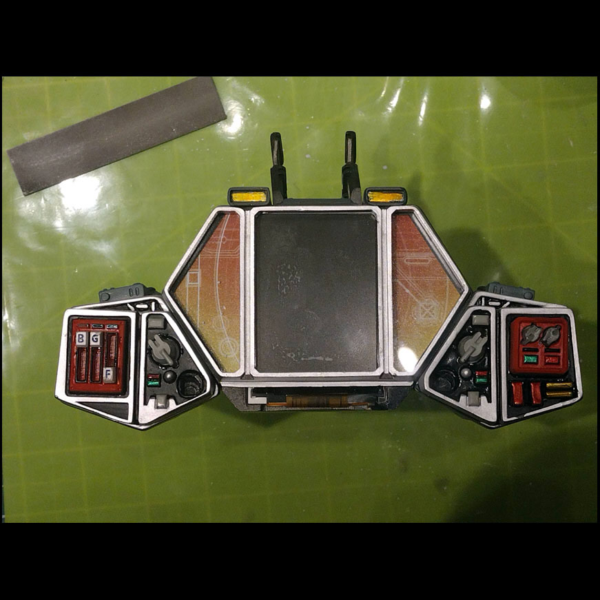

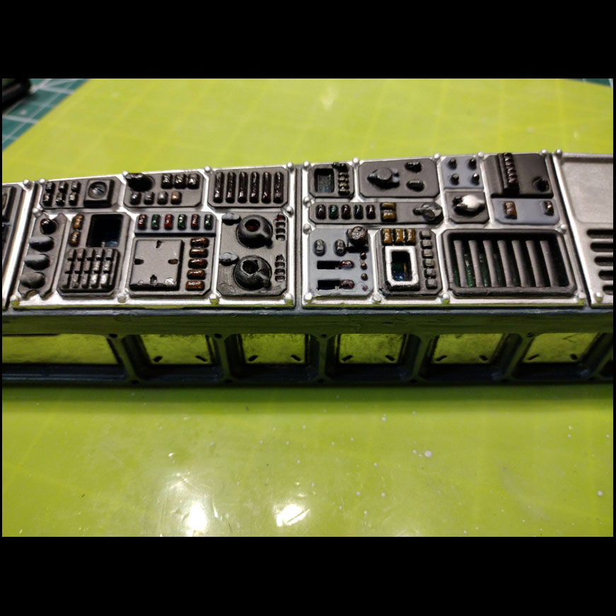

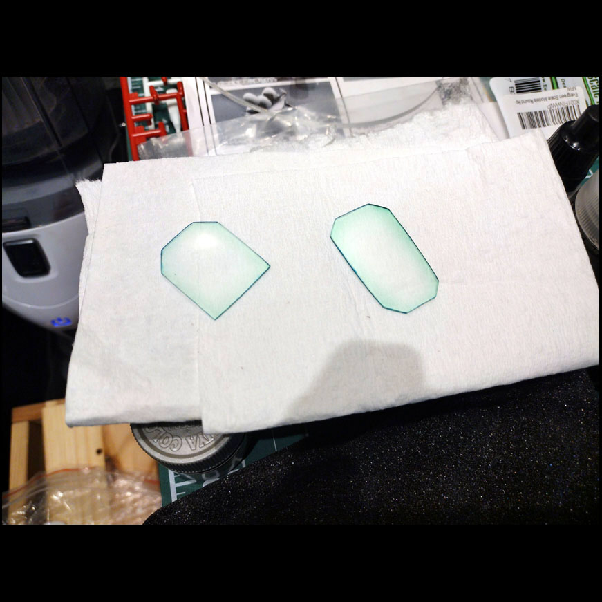

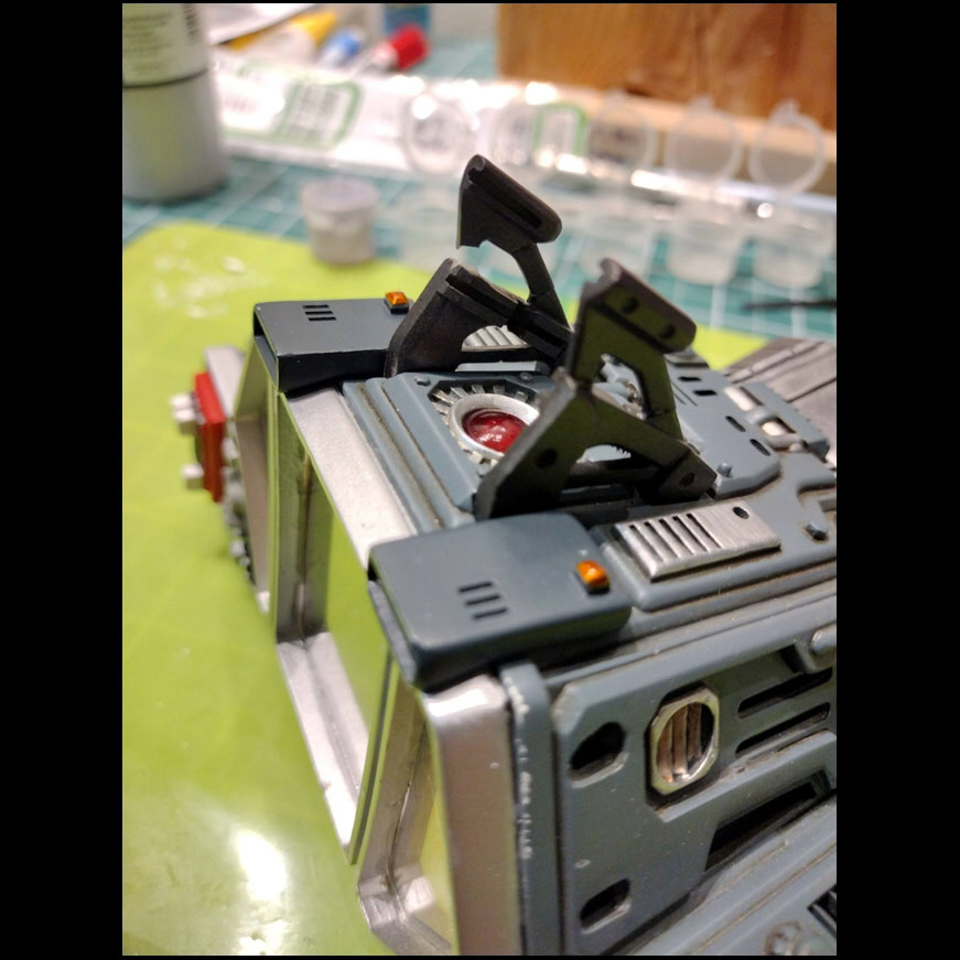

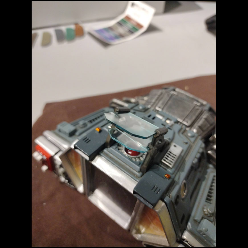

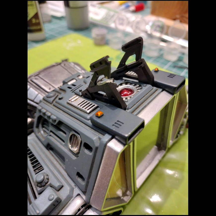

  21. 05-26-22 The new HUD panels, 1 polished the other only cleared. Both polished. Clarity sample. The new HUD panels, fitted to the upper console. Other angle.

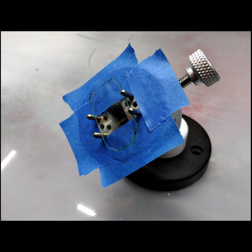

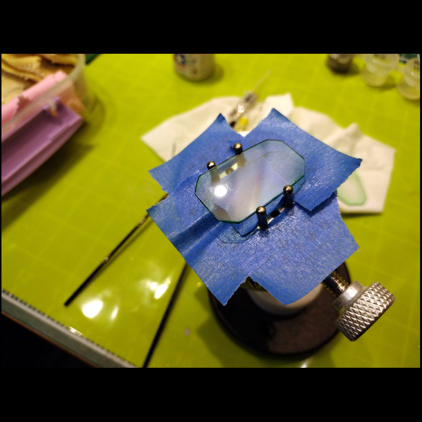

  22. 05-25-22 To finish the panels I first brush painted the edges with Tamiya clear green. In my mind I wanted the end result to look like tempered glass. In hindsight, I'm not sure HUD panels are made with tempered glass. But these looked cool when they were done, so...it's ok? Clamping them by the edges to then airbrush a ghost edge around the perimeter. Also using Tamiya clear green. Painting finished. Then I clearcoated them with Tamiya gloss, because I knew I wanted to polish them and the polish would immediately dissolve the paint. Speaking of paint, these are all the paints used in this restoration. If you want more details, just ask.

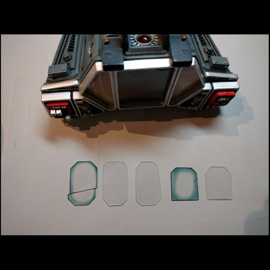

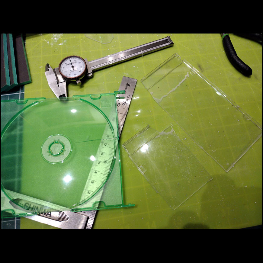

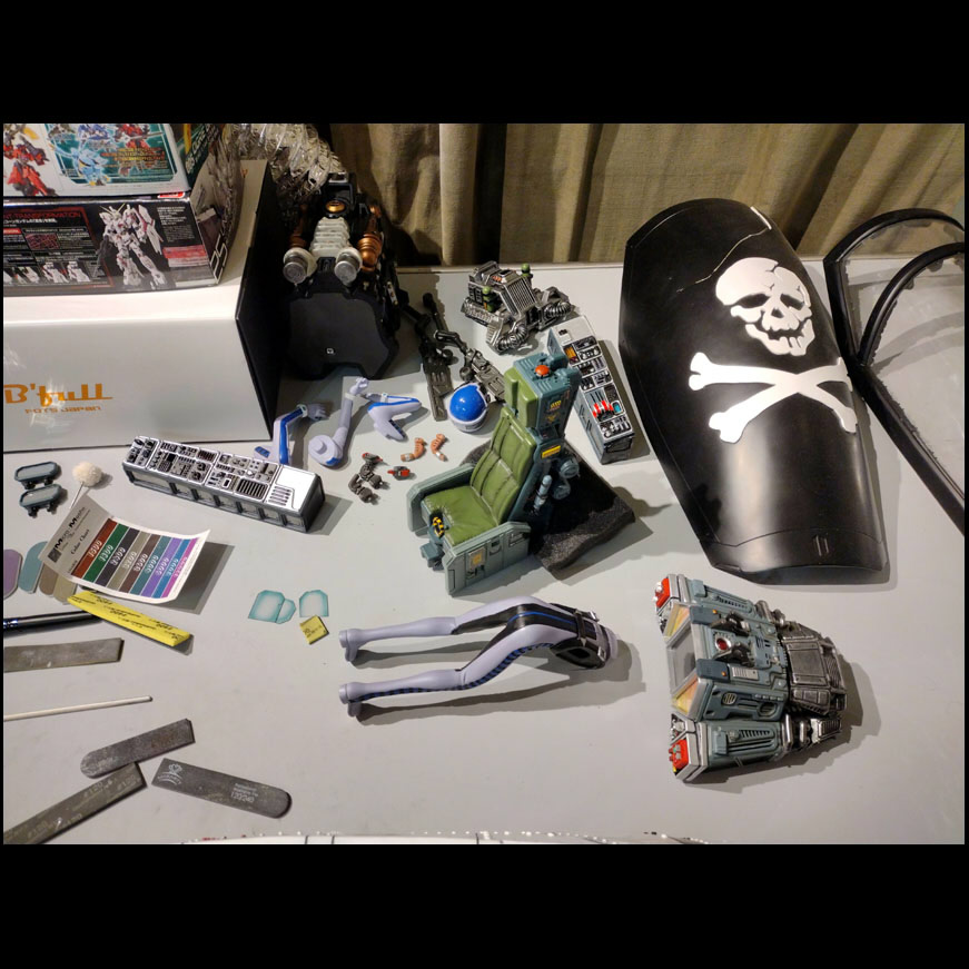

  23. 05-24-22 The repaired HUD panels, fitted. From this one angle, the crack isn't quite so obvious. But overall, the repair option sucked. So I got an old CD case that was the same thickness as the Kidslogic HUD panels and cut new panels. The first one wasn't quite the right shape, so I used it for testing other steps. Here are the 3 I cut and the 2 original, damaged ones.

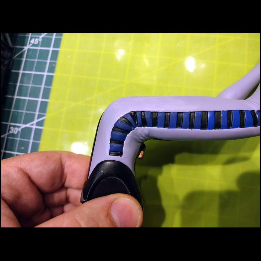

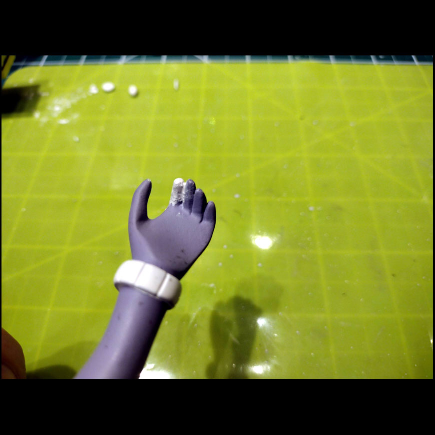

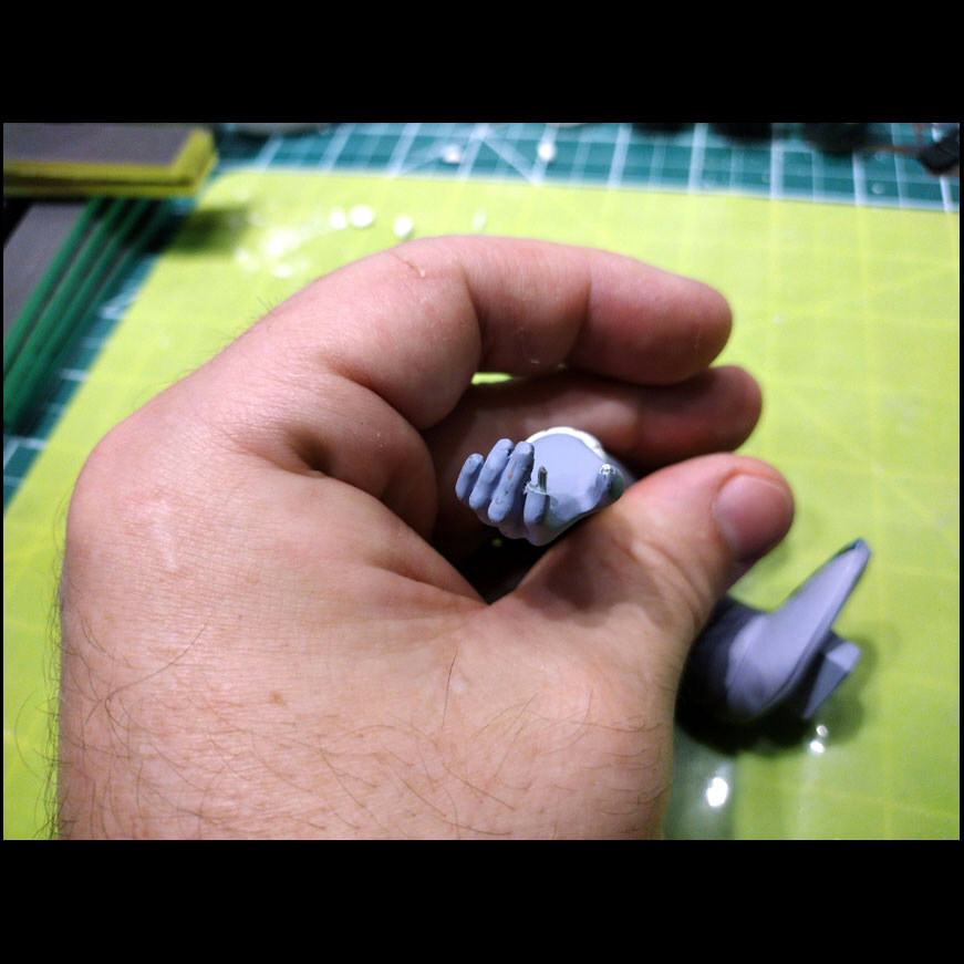

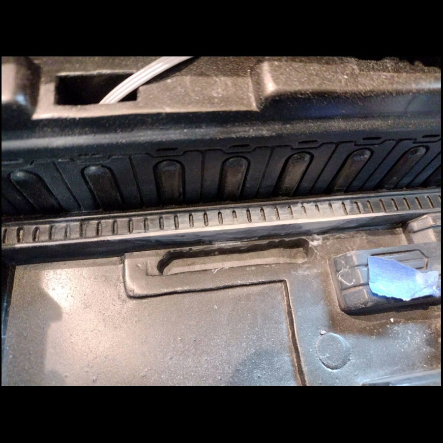

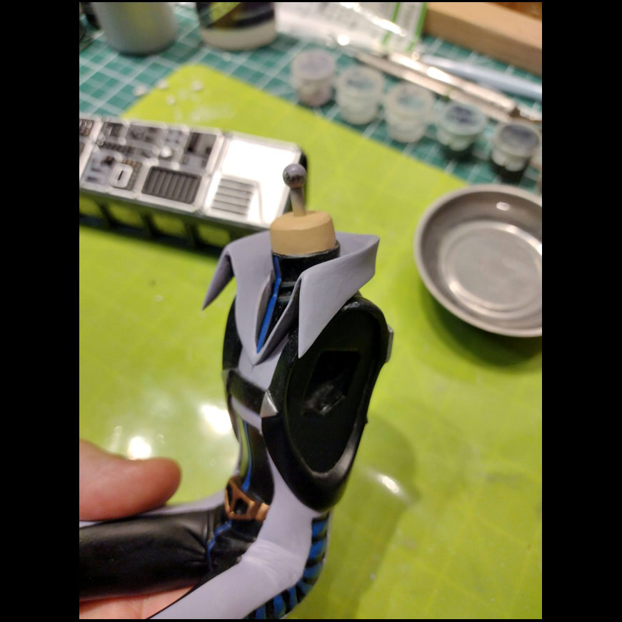

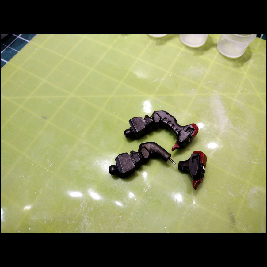

  24. 05-23-22 So I thought at this point I was done with repairing parts, needing only to fix the canopy and shield. However in packing the parts in the styrofoam I discovered this other arm, and its missing finger. So, like the thumb before, I drilled and pinned... ...then used Apoxie Sculpt to form a new finger. While that cured I turned my attention to the canopy. Essentially starting over after bumping into Frank Ippolito at a Propstore event and asking his advice. I switched from the foam-backed sandpaper pads I used before to sanding sponges. And I went with a much more aggressive grit to do my best to completely remove the deeper scratches. I did have to be very very careful though, because the canopy itself is VERY thin, and the frame is VERY weak. So whenever I sanded I had to support the opposing side with my hand. You can see here I got it to a fairly uniform haze. This is the whole canopy done with that grit. Then I polished it, as a quick test, and while the polish is still wet it looks damn good. The same, after the polishing compounds solvents evaporate. They acted like a temporary clearcoat, making it look clearer than it really was. However, as you can see here the polish did actually do a good job against very extreme sanding... ...such that there no longer are scratches deep enough to cast shadows! So, to that end this was a success. However there is still a clearly visible haze to the canopy and that needs to be dealt with. The new finger, sanded, primed and painted.

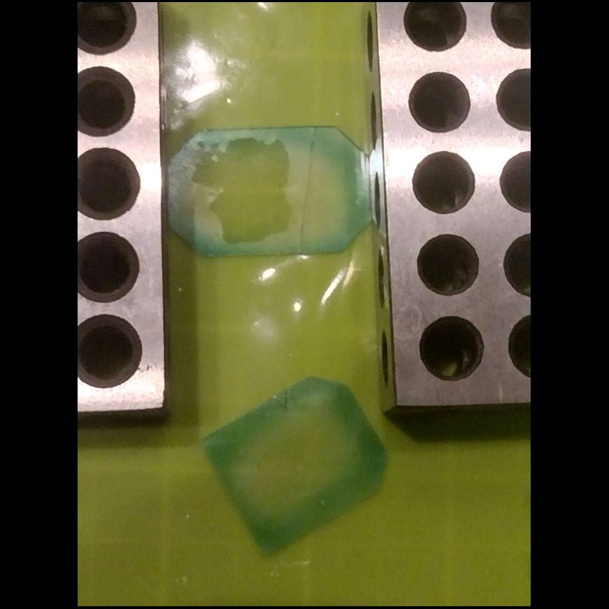

  25. Thanks guys! 05-21-22 My first attempt to fix the broken HUD panel. Using clear PVA (so as to not fog the acrylic), the pieces were laid on a silicone mat and clamped gently with 1-2-3 blocks. The idea was that the clear glue and clearcoat after would fill the crack and make it much less obvious. In short: This idea would fail.
