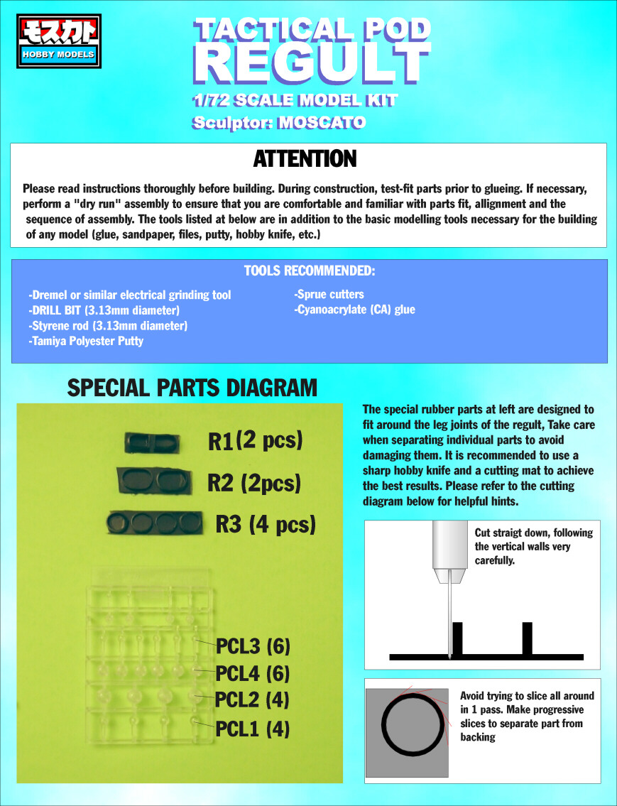

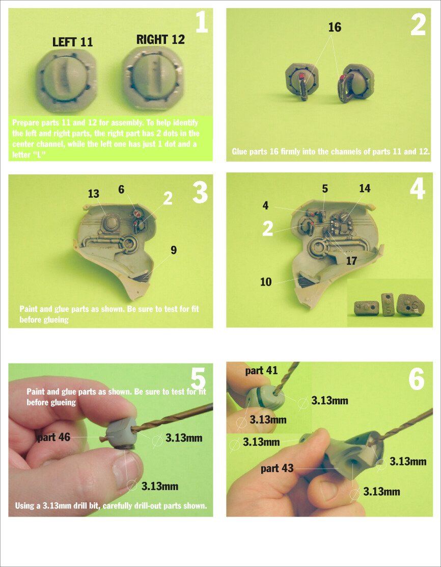

captain america Posted May 25, 2005 Share Posted May 25, 2005 For all of you who have purchased models, here are the instructions for your kit(s). Quote Link to comment Share on other sites More sharing options...

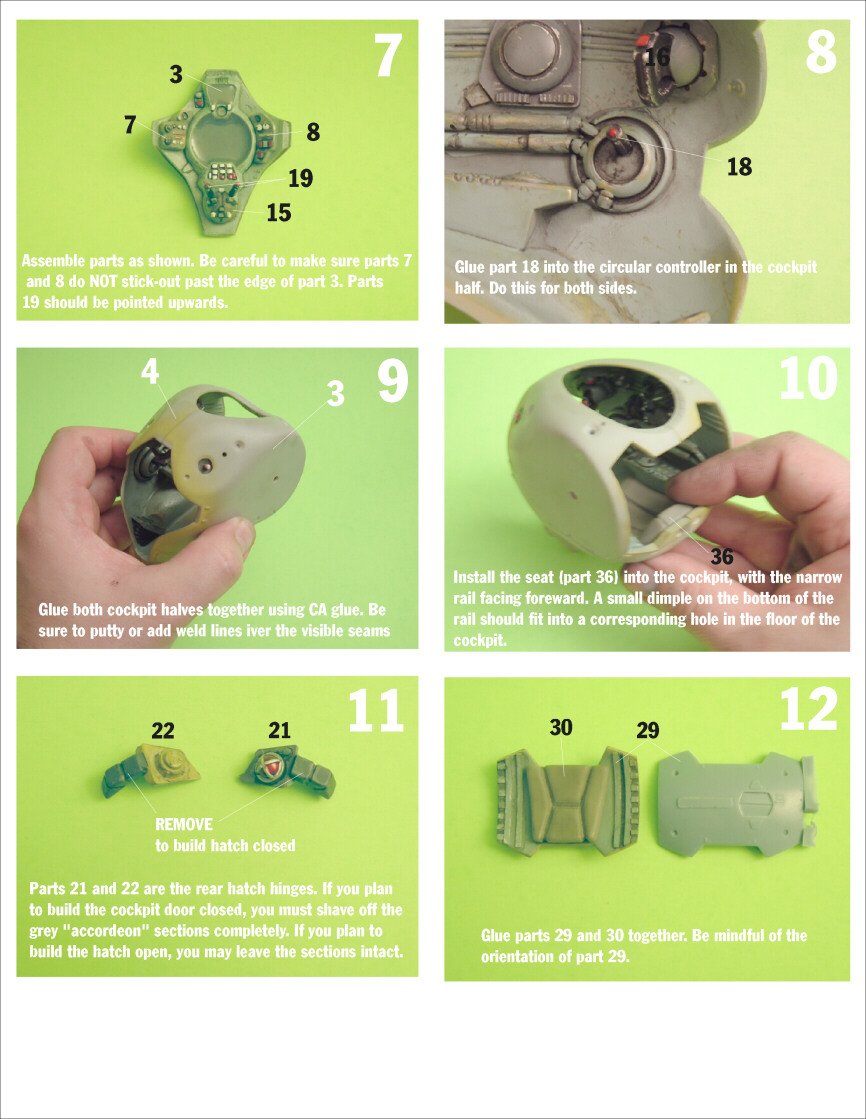

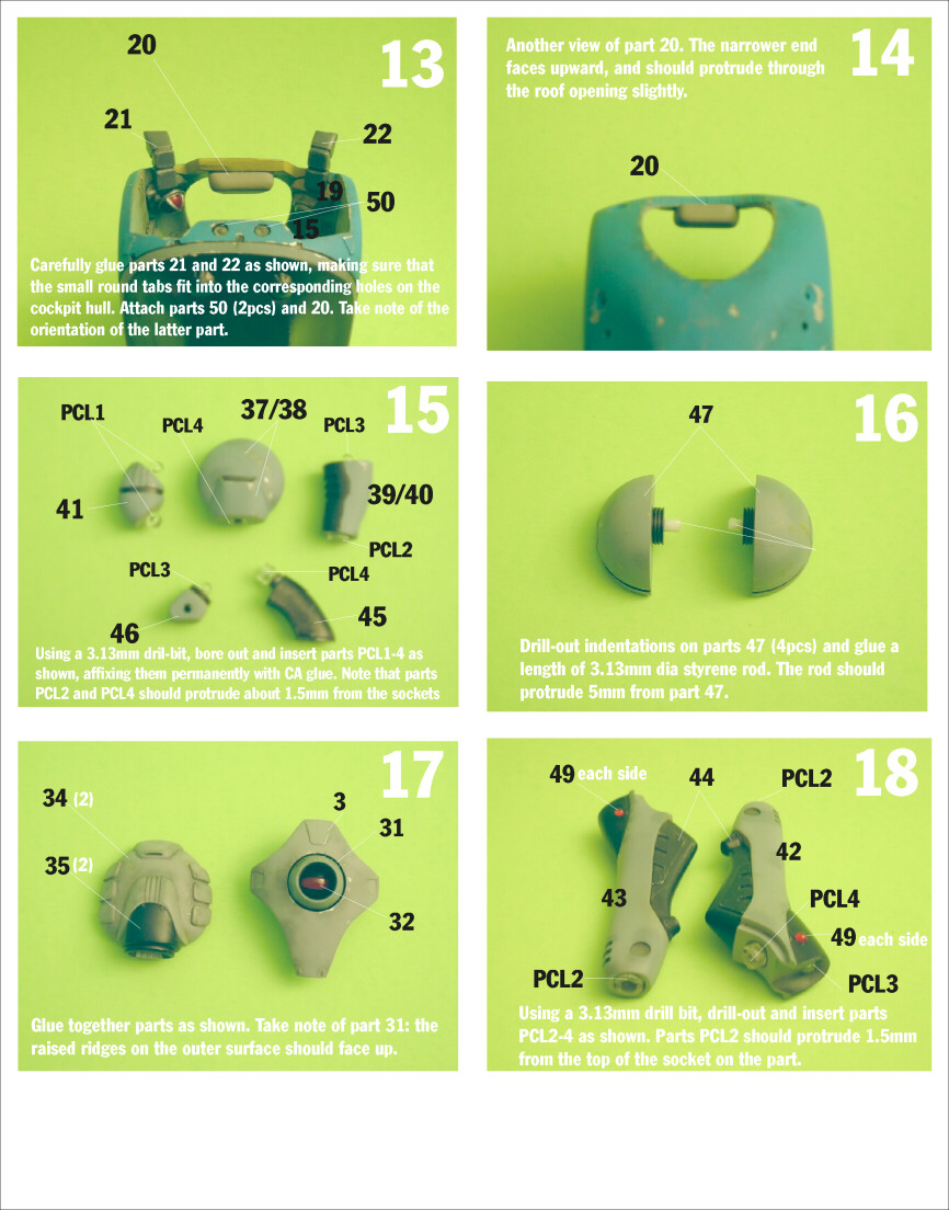

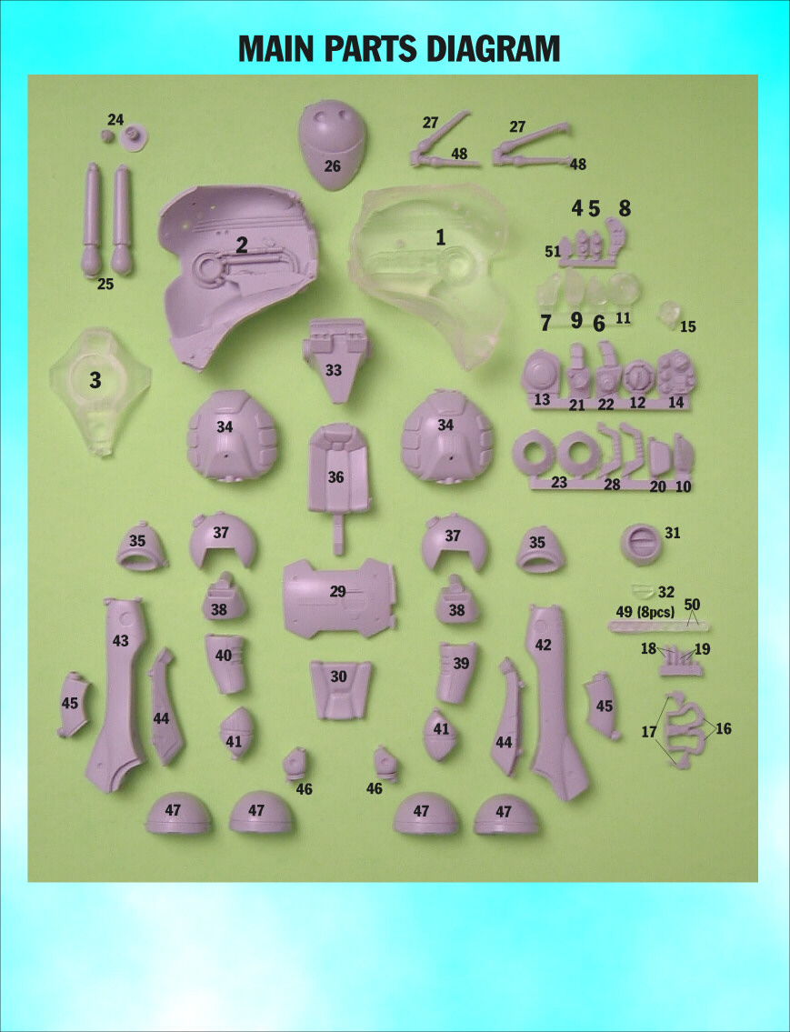

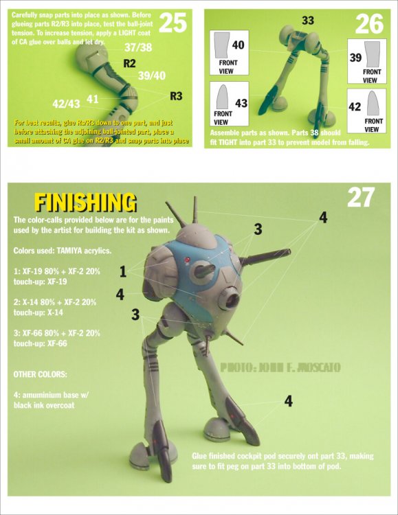

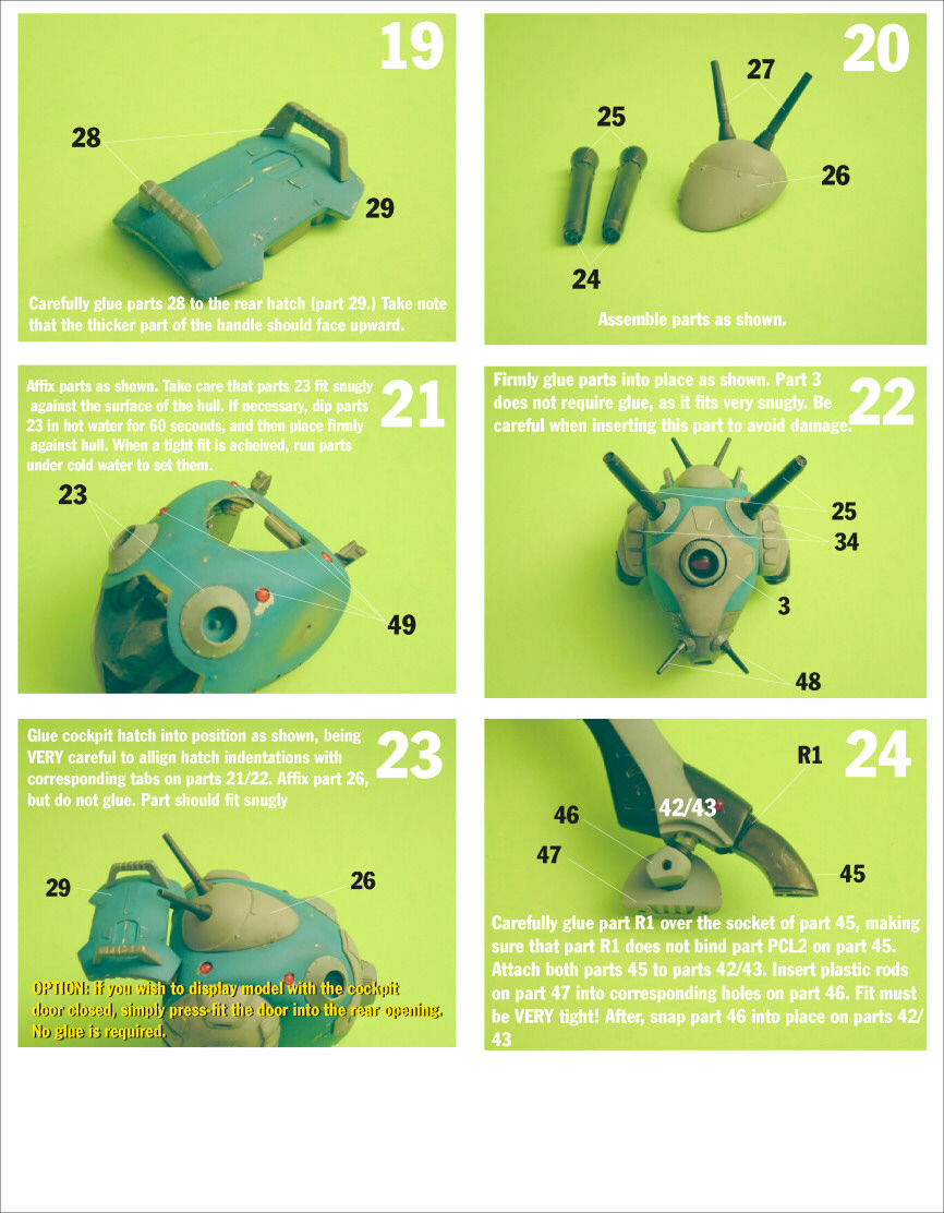

captain america Posted May 25, 2005 Author Share Posted May 25, 2005 page 2 Quote Link to comment Share on other sites More sharing options...
captain america Posted May 25, 2005 Author Share Posted May 25, 2005 page 3 Quote Link to comment Share on other sites More sharing options...
captain america Posted May 25, 2005 Author Share Posted May 25, 2005 page 4 Quote Link to comment Share on other sites More sharing options...
captain america Posted May 25, 2005 Author Share Posted May 25, 2005 page 5 Quote Link to comment Share on other sites More sharing options...
captain america Posted May 25, 2005 Author Share Posted May 25, 2005 page 6 Quote Link to comment Share on other sites More sharing options...
captain america Posted May 25, 2005 Author Share Posted May 25, 2005 final page Quote Link to comment Share on other sites More sharing options...

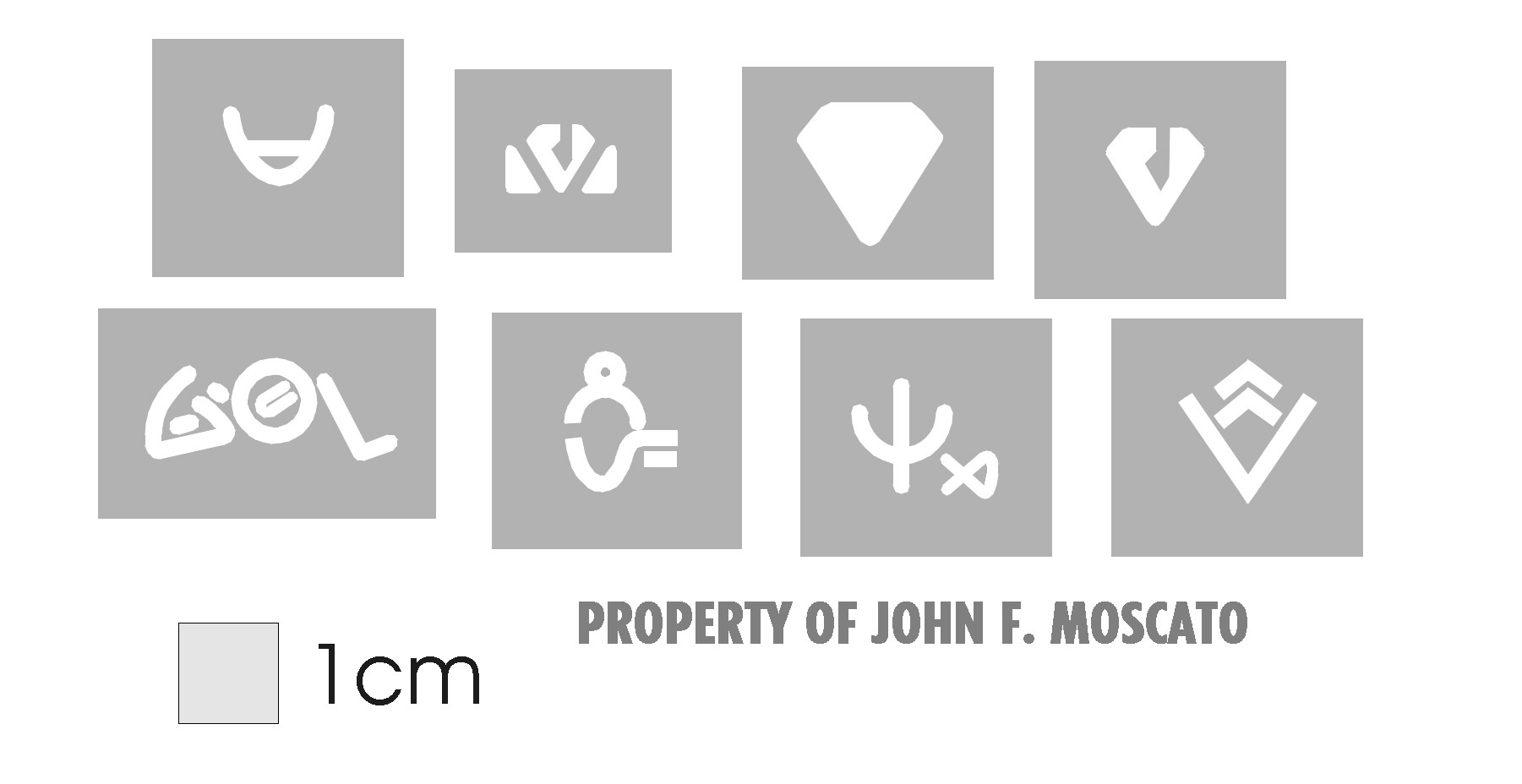

captain america Posted May 31, 2005 Author Share Posted May 31, 2005 Here are the painting stencils for the large markings. Quote Link to comment Share on other sites More sharing options...
Stamen0083 Posted June 1, 2005 Share Posted June 1, 2005 3.13mm is a rather odd size. I'm curious as to why you decided to use 3.13mm instead of, say, 3.0mm? Quote Link to comment Share on other sites More sharing options...
captain america Posted June 1, 2005 Author Share Posted June 1, 2005 Hi Stamen. Umm... Cos that was the only drill bit I had handy at the time Actually, it's cos a 3mm hole would just plain be too tight to push the ball-joint pins into. This way, the hole is just a hair's breath larger than the pins, and the extra slack can easily be made-up with a bit of CA glue. The reason it's such an odd size is that it's probably a bit in an imperial measurement. I simply converted it over to metric for ease of use. Quote Link to comment Share on other sites More sharing options...
