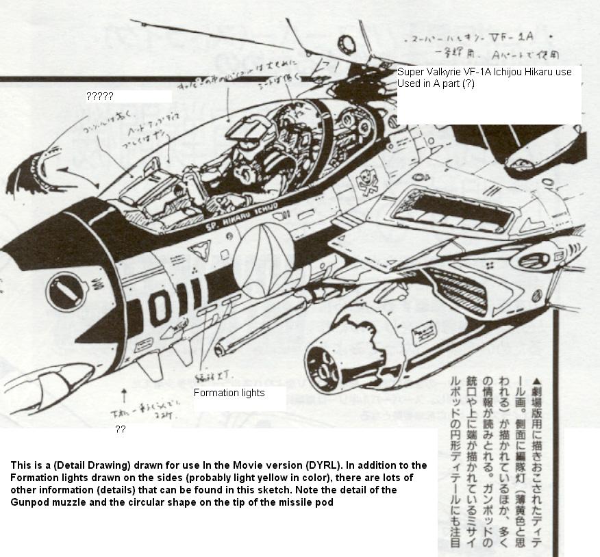

stphpo2 Posted January 4, 2005 Posted January 4, 2005 Are there 3 small gun barrels in the Vf-1's gun pod. I thought that I had seen a picture of that somewhere. Please let me know. And if they are there does anyone know what size of tubing to put in the end of a 1/72 scale pod. Thanks

stphpo2 Posted January 4, 2005 Author Posted January 4, 2005 I can't remember what picture I saw that in. Has anyone out there got a picture with that in it? I would like to make my VF-1's as accurate as possible, if I can find tubing that small.
Gerwalker Posted January 4, 2005 Posted January 4, 2005 From Macross Compendium (this is the site you should check first for everything related to Macross): Compendium VF-1 specs ....Standard external 55 mm Howard GU-11 three-barrel gatling gun pod...
whytwolf Posted January 4, 2005 Posted January 4, 2005 I can't remember what picture I saw that in. Has anyone out there got a picture with that in it? I would like to make my VF-1's as accurate as possible, if I can find tubing that small. The Hasegawa kits actually mold the three barels inside the muzzle of the GU-11. If you want to accurize them, simply drill out the barels with a pin vice (as I did). Much easier than trying to find small diameter styrene tubing. HTH Sean
