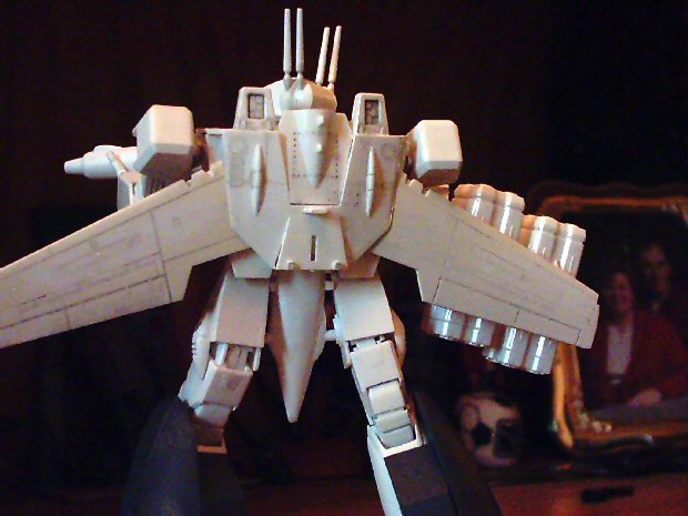

HWR MKII Posted January 14, 2005 Author Posted January 14, 2005 ok heres the solution front left with no missile pods. there will be though you can see how i lowered the wings just enough that it doesnt interfere with the shoulder. this was inspired by the anime magic of DYRL? i just didnt go as low as the animation did it looked too weird.

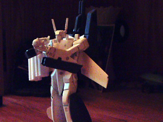

HWR MKII Posted January 14, 2005 Author Posted January 14, 2005 front right. again the change is not too noticeable from the front. especially with the missile pods on the wing.

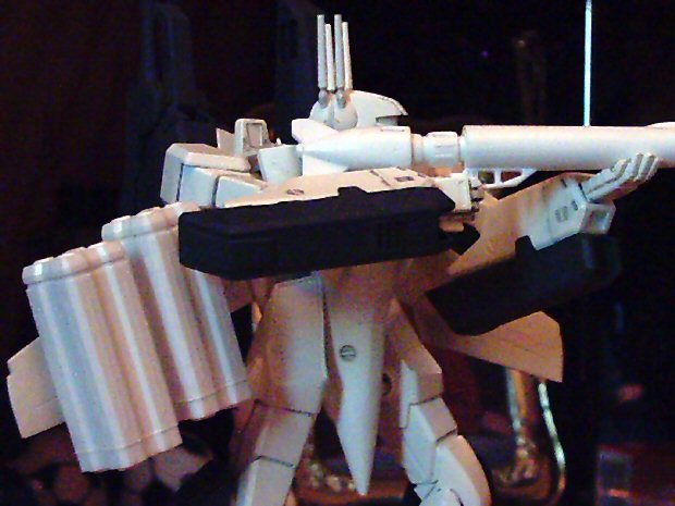

HWR MKII Posted January 14, 2005 Author Posted January 14, 2005 (edited) ok last one. this one is without te backpack so you can see how far down the wings are placed in case anyone wants to use this idea. the wings are just glued in place but thats ok since with the missiles on there the wings wont be able to fold anyway. to use the wings just snap the pivots off the fighter mode kit wings and glue the wings in place below the pivot mount for the battroid mode wings. this also allows me to have the formation lights on the wings. the kit wings didnt allow that. Edited January 14, 2005 by HWR MKII
Myersjessee Posted January 14, 2005 Posted January 14, 2005 Looks good! Hardly noticable (at first glance) from the front. More noticable from the back, but still good.
HWR MKII Posted January 14, 2005 Author Posted January 14, 2005 thanks jessee once the backpack pieces are installed you cant tell. i took the pic with them off to just show what i had done
