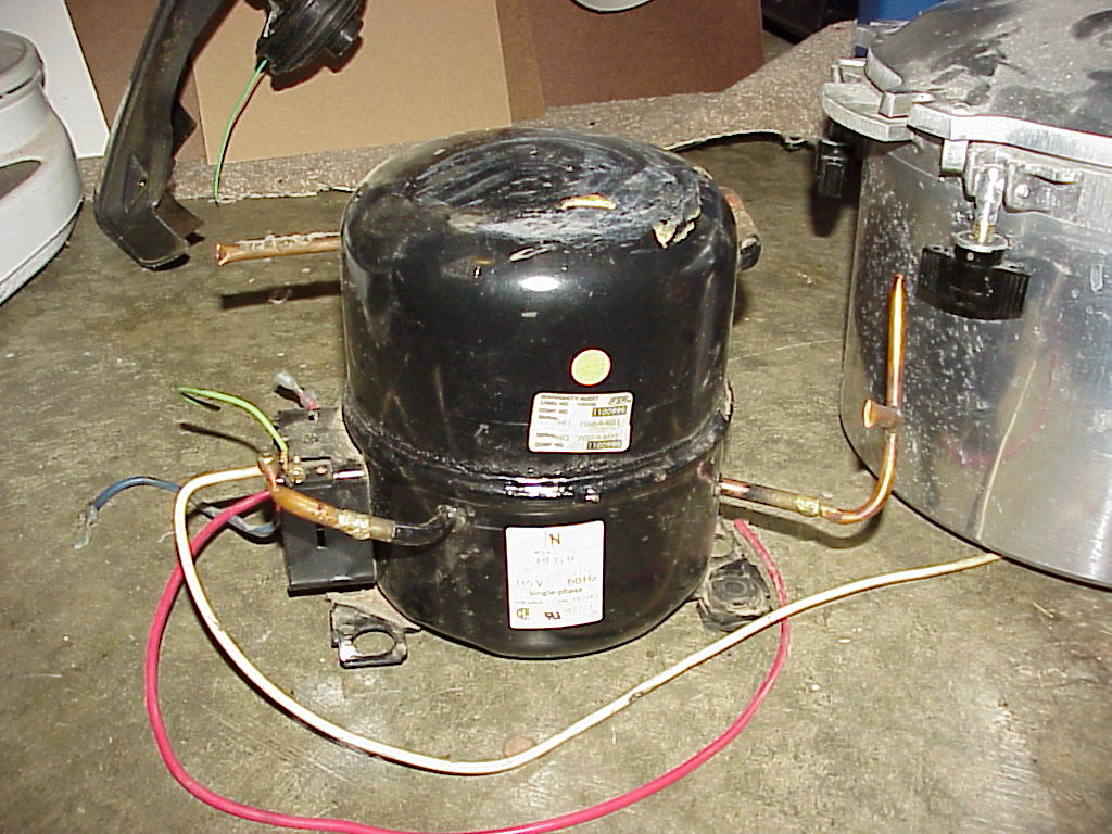

B-52 GUNNER Posted August 16, 2004 Author Posted August 16, 2004 Here's a close-up of the compressor. The tube on the lower left is sealed with solder. So I beleave the long tube curving around on the top and the short tube on the lower right are the ones in question? Which one is the intake tube? I may plug the holes in the lid and drill and tap a new hole in the side of the pot so it would be easier to open the lid. Scot
Valkyrie Posted August 16, 2004 Posted August 16, 2004 Valkyrie,OK, Here's the REAL IMPORTANT QUESTION!! Which tube is which? You'll just have to power it up and find out
B-52 GUNNER Posted August 16, 2004 Author Posted August 16, 2004 Now I'm worried If you don't hear back from me... It was nice knowing you Will anything come out of the other pipe? Scot
Valkyrie Posted August 16, 2004 Posted August 16, 2004 Well, I've never used a refrigerator compressor, so I'm just making educated guesses here. But it seems pretty safe to say that one tube will be spitting out air, just like any other compressor. The other will be the intake, wich will give you the suction you need for it to act as a vacuum pump. And I'm guessing that the third, sealed off tube is is what was used to add refrigerant to the system. But you won't have to worry about that one.
B-52 GUNNER Posted August 16, 2004 Author Posted August 16, 2004 I'M STILL ALIVE!!!! It was the one on the top that is the intake It does leak oil from the exhaust. I wonder if the oil can be left to leak or does the compressor need it? What I need to do is to create a reservware to containt the oil and it should seep back into the compressor. Scot
B-52 GUNNER Posted August 17, 2004 Author Posted August 17, 2004 Valkyrie and Cobywan, I attached the PIAB vacuum gauge to the compressor and I got 28 inches of mercury. Is that enough to degas resin? Scot
Valkyrie Posted August 17, 2004 Posted August 17, 2004 Yep 28 is pretty good. It should do the job. I'd be worried if it loses too much oil though. Those things need to stay well lubed.
B-52 GUNNER Posted August 17, 2004 Author Posted August 17, 2004 Thanks for the help Valkyrie. Now I'm going to find a gasket and the fittings to mount the two together. So it may be a few days before I post any progress. Scot Man this is COOL!

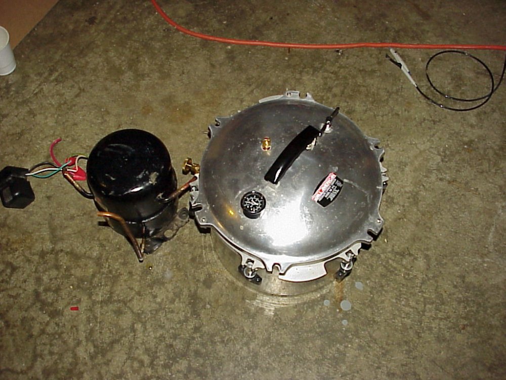

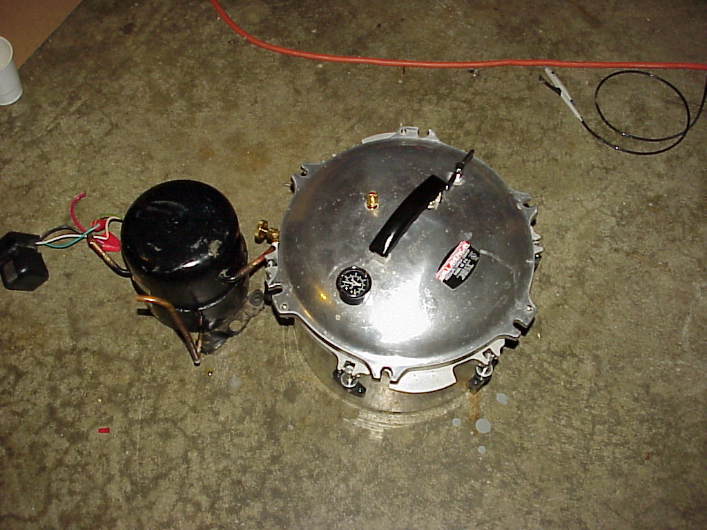

B-52 GUNNER Posted August 21, 2004 Author Posted August 21, 2004 Valkyrie or Cobywan, Would you think I can drill a hole through the side of the pressure cooker pot in order to attach the compressor to the side? Otherwise I would have to attach it to the lid. Scot

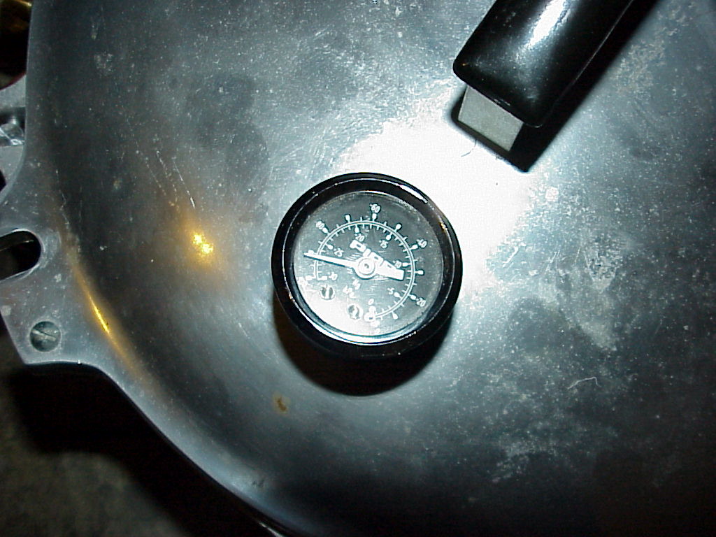

B-52 GUNNER Posted August 30, 2004 Author Posted August 30, 2004 OK, Guys Here it is. I got the two together and can get it to 28 inches of mercury. However it has a very slow leak. How do you find the leak and it there a easy way to stop it? Scot
B-52 GUNNER Posted August 30, 2004 Author Posted August 30, 2004 Here's the gauge at 27 inches of mercury
