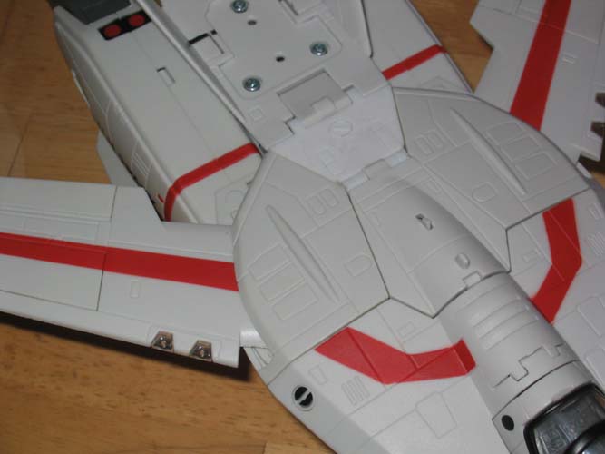

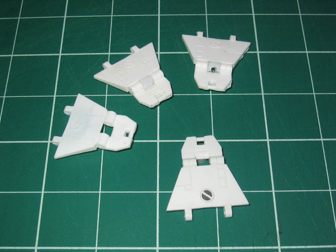

I recently had this piece break on a friends VF-1J. After recieving no help through the official chanels ( HLJ said "Yamato is out of stock on this piece with no plans to reproduce it in the near future"), we decided to take matters into our own hands. Some silicone, resin, and a few weeks latter the end result can be seen belowe installed on the VF-1J. The part is pretty nice, its very close to the size of the original, installs easily, and holds better than the super glue many of us have probably been using. Load it up with some FAST packs thought and the fact that it is resin and not plastic becomes aparent. Still, it's better than nothing. The piece shown installed in the photo is one of the first shots, no paint. I'm having trouble getting one or two stuborn bubbles out of the finished piece. They appear near the circular detail and can be easily fixed with some filler.
Which brings me to the point of this topic. Would anyone else be interested in one of these pieces?

it becomes aparent in that the piece flexes a little bit. It's actualy pretty strong. I droped the back pack w/FAST packs while transforming and the piece held strong, of course you would have to be more carefull than if the original piece was in place.
I also thought about making one out of cast aluminum, but the process of casting a wax piece, investing it, and then vac casting the metal is sort of complex and time consuming. Maybe someday. . . <_<

To those who expressed interest in these parts: I have been hard at work producing some nice examples of the hinge. I still need to make a jig to accurately drill the holes in the finished pieces. That will probably get done a work sometime this week. I will be out of town next week, so expect a little more time before the finished pices are ready to go. Thanks. :)

Anyway, I just got back from rafting the Tuolomne river yesterday (a class 5, hard on personnel and gear). As soon as all the cuts and bruises heal I will be back in the shop compleating the first run of replacement parts (probably Monday). I am a little bit hesitant to take people's money untill the part if well sorted and ready to ship, but that could be very soon, end of the week maybe.So don't worry, I'm on it.
