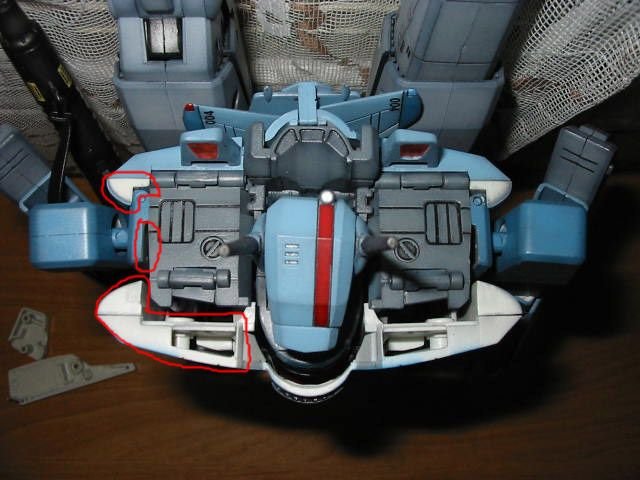

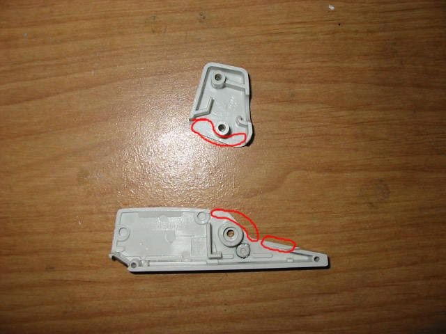

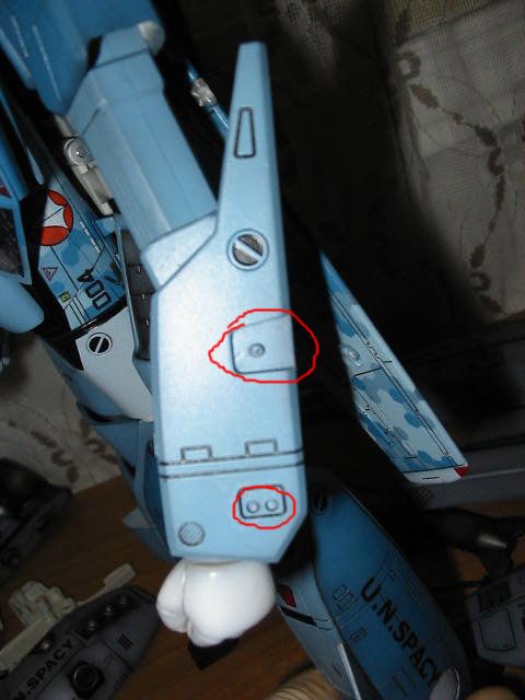

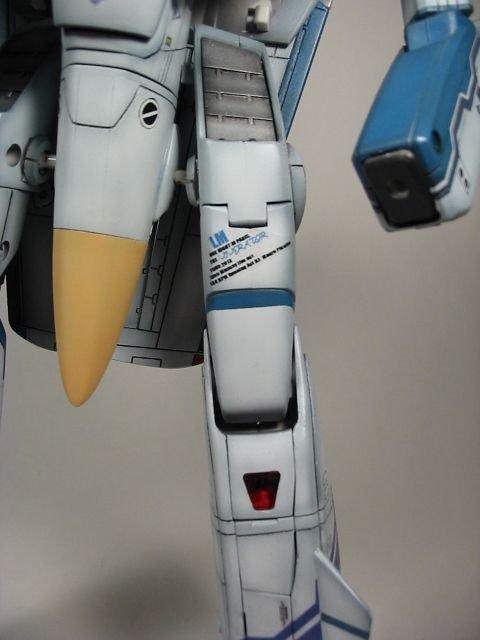

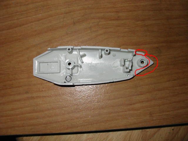

This might be slow, I'm watching the basketball game as I do this :p
Again, there's no looseness to the joints in any of this, all the joints are either peg and hole joints or springy ratchet joints, don't touch these!
arms:
Circled areas are sanded down to avoid the rubbing of the middle arm pice..
Link to comment

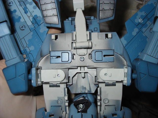

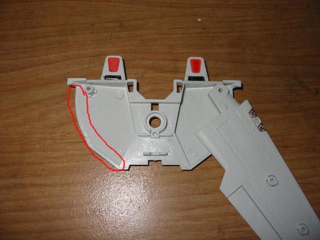

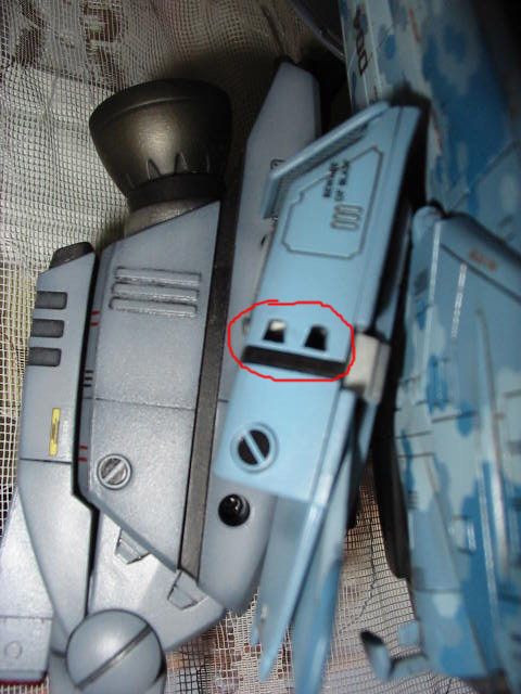

The backpack: the area that the boosters lock into place will eventually have some paint chip off, should be relatively minor, big chunks of paint shouldn't be chiping off.
Also note, NEVER push down the tail fins together tighly, don't "grind" them against one another when folded, always keep this in mind when transforming and removing the boosters.
Link to comment
Share on other sites

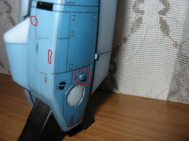

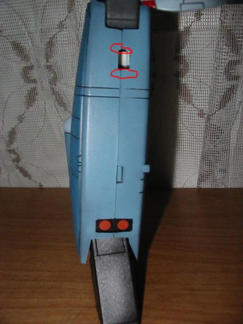

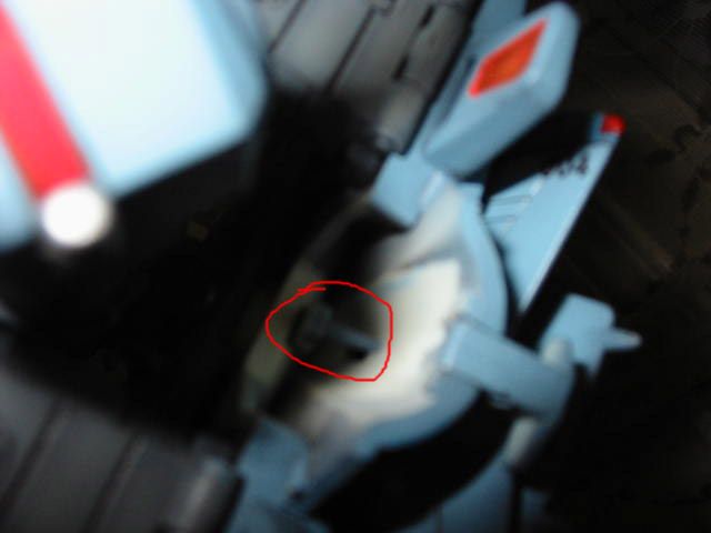

the leg peg that locks the arms in fighter mode will have paint wear, also circled areas at the landing gear doors will chip off, it's the design of the doors, again should be very minor without big chunks of paint chipping off.
Link to comment

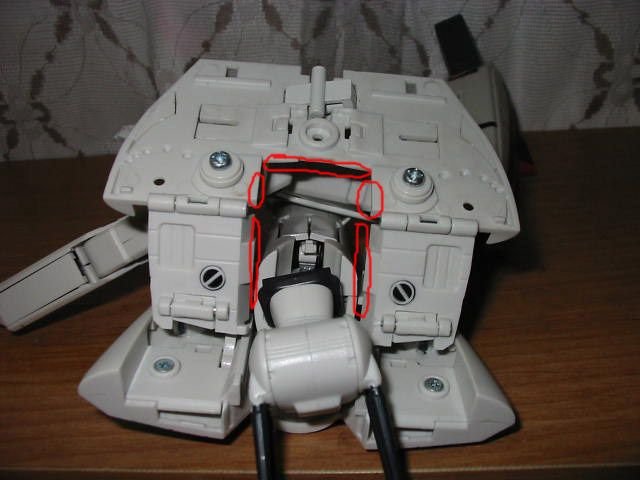

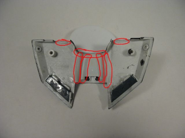

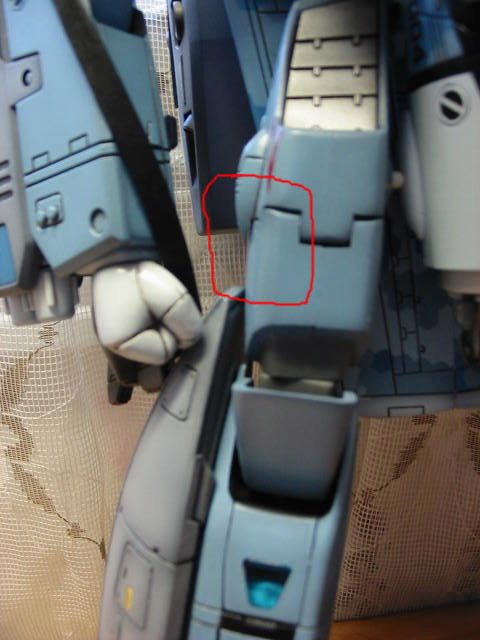

I stopped painting the top of the chest plate and the backplate, can't sand these down since they should fit tightly together in fighter mode, and hence rub against each other.
Also note, I sand a bit off the shoulder mount (look at circled area than uncirled), this is to avoid rubbing against the thigh in gerwalk mode. The shoulder mount holds the arms up without having to rest on the thigh in gerwalk.
Link to comment
I think that should cover it. Big tip, keep your grubby finger nails trimmed :D
Looks like we sand down pretty much the same stuff, Jung. The few exceptions are that I sand down the hinge sections of the landing gear doors for the legs so they don't scrape, I sand the chestplate and backplate pieces you leave unpainted just enough so they don't scrape after painting, and I also thin down the swivel sections on the legs and arms just a little. I'll post pictures of what I'm talking about later this weekend as I start work on a custom for xstoys. You can leave the DYRL-style hands on a custom 1/48 during transformation if you're careful, but removing them is never a bad idea.
