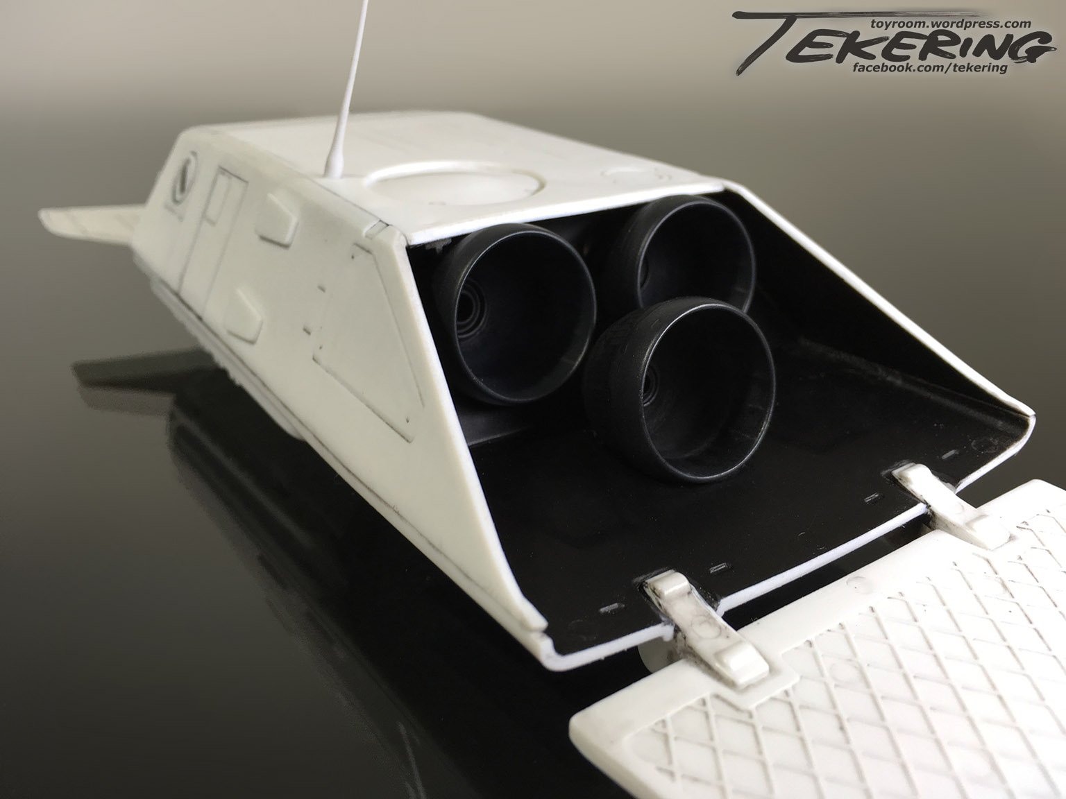

21 hours ago, GMK said:

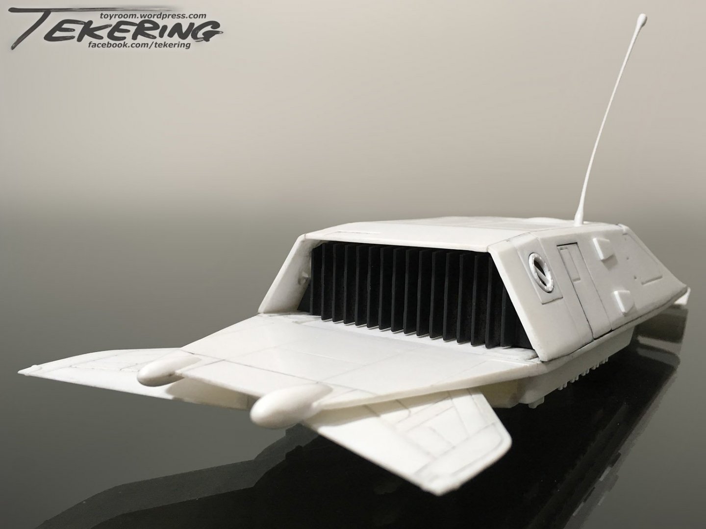

@tekeringBtw, apart from the nozzles & antenna, did you do anything else to the backpack to improve the look?
A great deal, yes.  What came as two separate pieces I cut into ten, and selectively removed edges (mostly cutting along sculpted panel lines) to create a smaller, more trapezoidal shape once the surfaces were glued back together.
I also made a thinner, more detailed antenna than my earlier attempt, built a special mounting plate to support the thrusters, and added those ubiquitous triangular shapes on either side (the most consistently seen panel detail on any drawing, toy or model, and the one Max Factory neglected to put there).  <_<
The folded wingtips and trapezoidal panel above them were both removed and turned upside-down, so the sculpted detail on the panel lines would be visible.  :hi:
Now I can move onto the next challenge -- getting the legs and feet into a position that supports the model without requiring the stand...

3 hours ago, tekering said:
I make it 38mm in diameter, 382mm in length.
I doubt that.  The backpack pieces (including the folded wing flaps) are on a single sprue, and the panel that stick out the back would prevent it from fitting into fighter mode.
The shape is accurate, and I think it's a good model to emulate.  The detailing is all wrong, though.  <_<

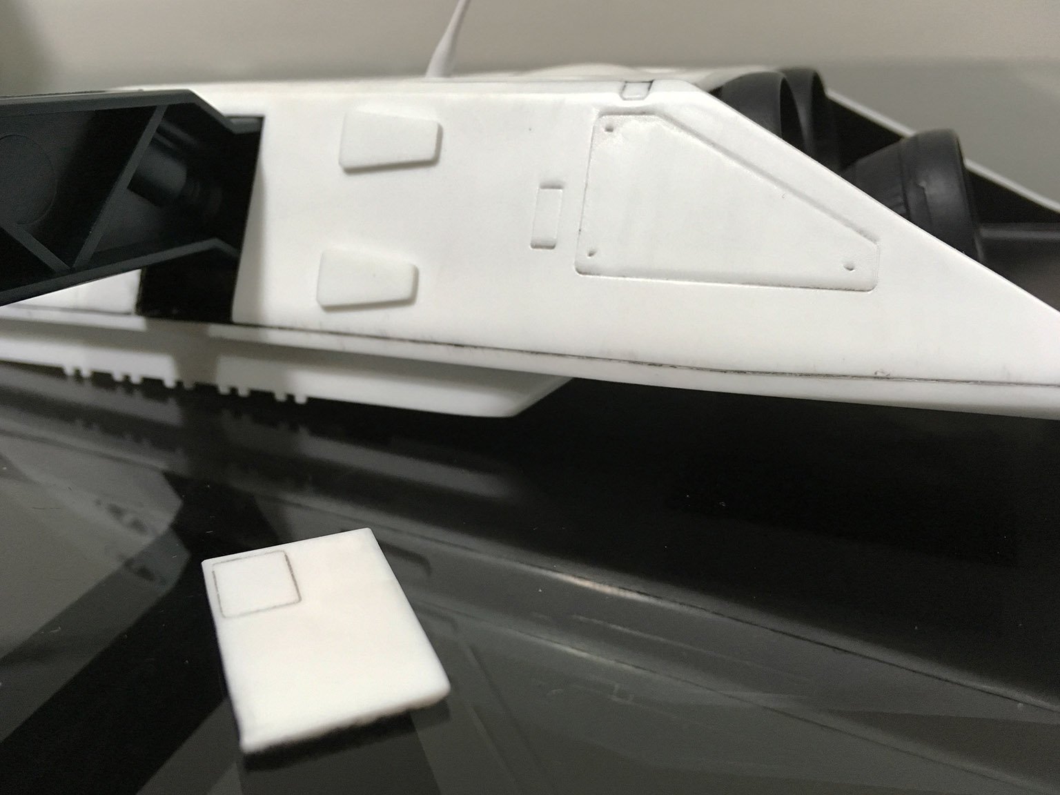

12 hours ago, Mr Jones said:

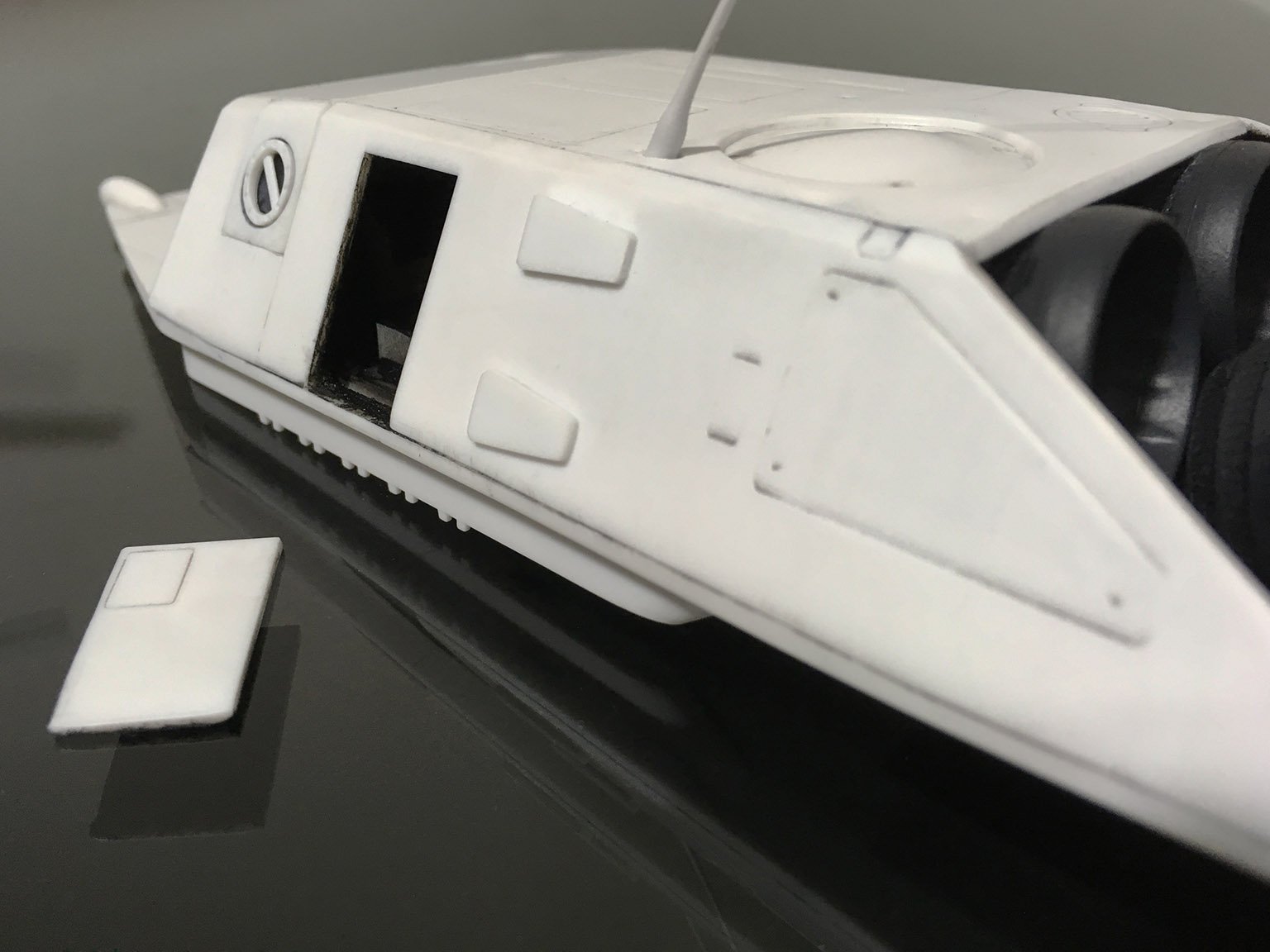

I'm assuming at this point that you're not putting in the Fast Packs / Super parts?
I'm keeping the option open... which is why these panels are removable:

13 hours ago, electric indigo said:
Adding the recessed band should also get you closer to the iconic look of the backpack.
It should be recessed, I know, but it would seriously compromise the integrity of the booster mounts... at least, as Max Factory designed 'em.
Maybe I can come up with a secure method that doesn't require linking the boosters together...  :huh:

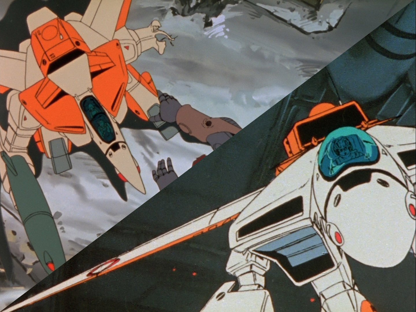

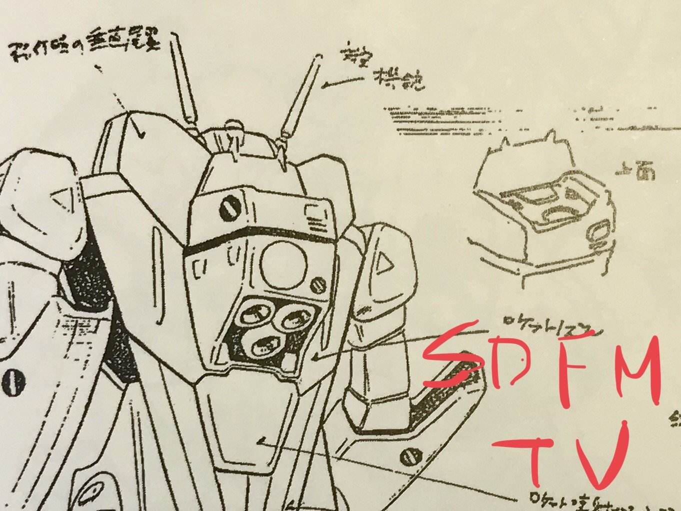

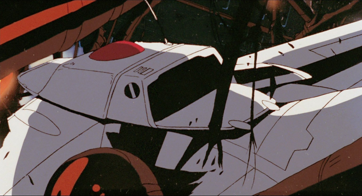

Is the intake grill canon?
Technically, no.  As depicted in the line art and the animation, nothing should actually be visible there.  :p
Even the extreme close-up in DYRL is stubbornly featureless:
When it comes to official products and packaging, however, there is no consistency whatsoever!  :crazy:
The more research I do, the more confusing it becomes.  :unknw:

I hope these help alleviate the ambiguity. They come straight from the source.

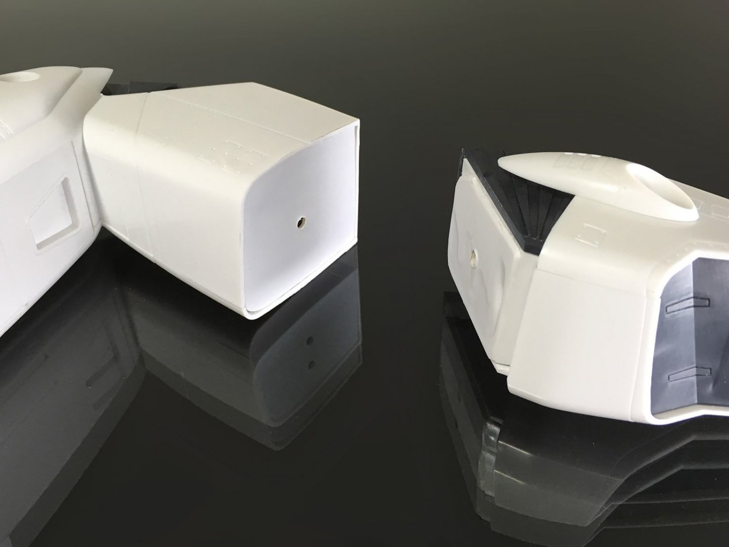

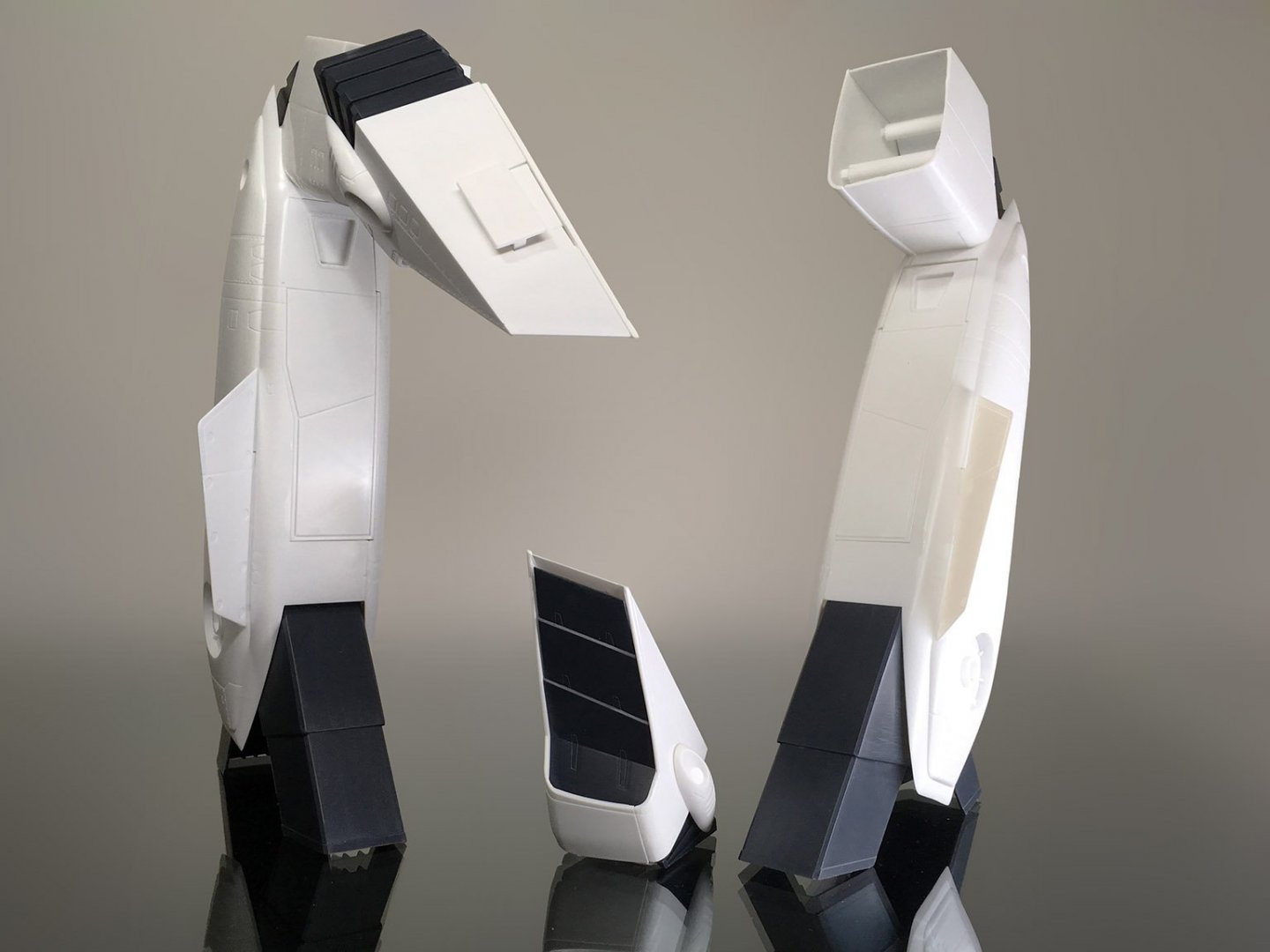

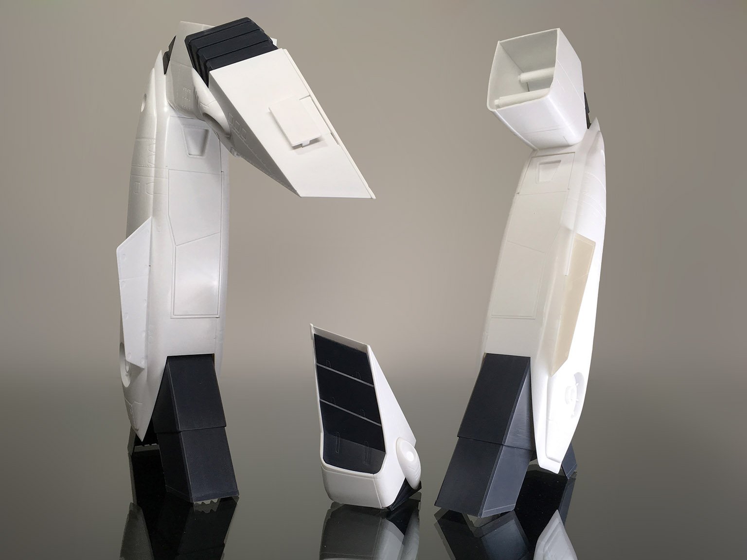

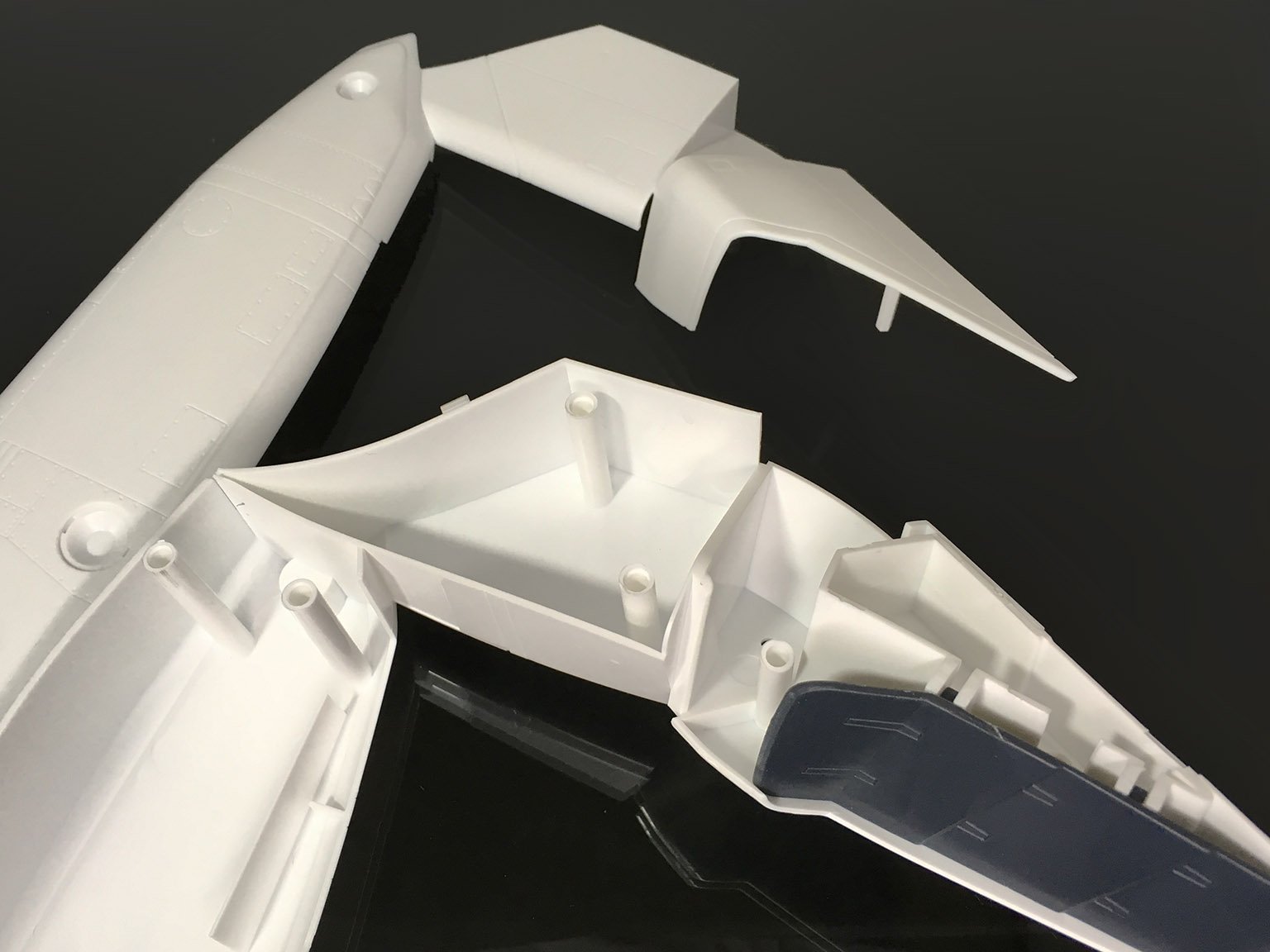

So, to modify the legs so the gerwalk can stand, these pieces will have to be cut apart to reposition the joints:
On the left you see the unmodified leg.  The position of the feet are the biggest problem...
On the right, the leg I've modified.
762151634_toarticulateornottoarticulate.thumb.jpg.9132257929f18c920f5fba477479cbf4.jpg
Cutting off the intake segment is necessary to straighten out the legs, so they aren't canted at such a dramatic angle.
I'm not sure how I'll go about articulating that joint, or even just reattaching it in the required position...
Thanks!  It's nice to see additional model sheets, even if they contradict each other... or screw up the proportions, like the above illustration.  That backpack is MASSIVE!
And for some reason, the pilot is sitting above the cockpit, rather than in it...  :huh:
Thanks for keeping us all updated on your build.
With a layout structured like that, it looks like closed intake covers are the only practical option! Shame. Now to find some SDFM artwork of a Gerwalk operating in-atmosphere with intake covers closed.

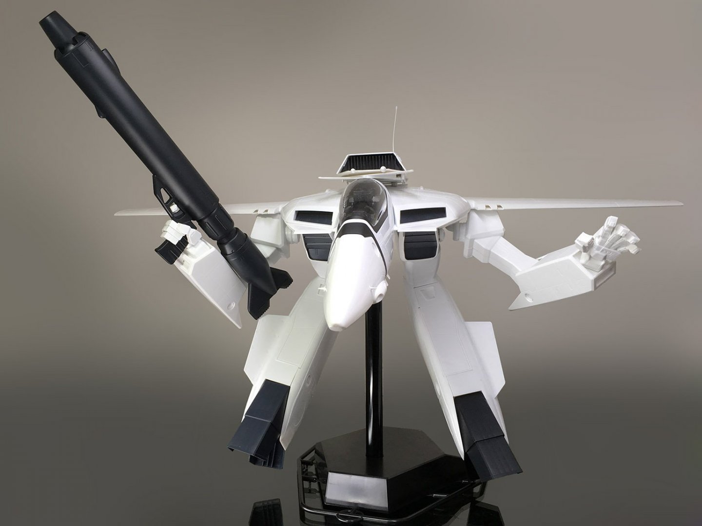

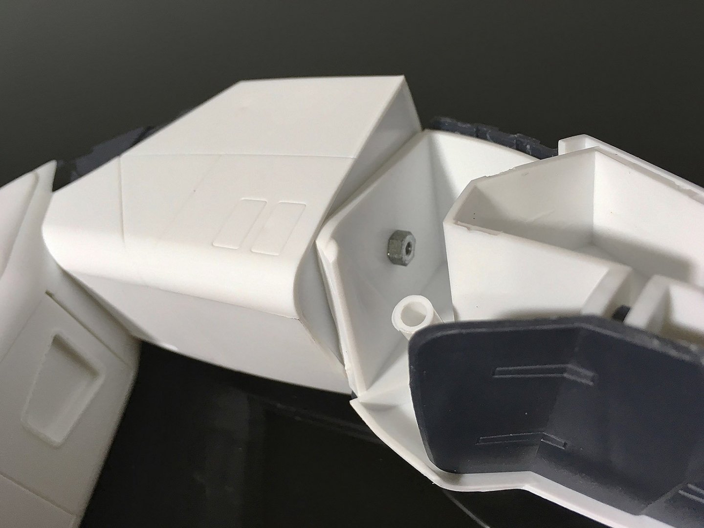

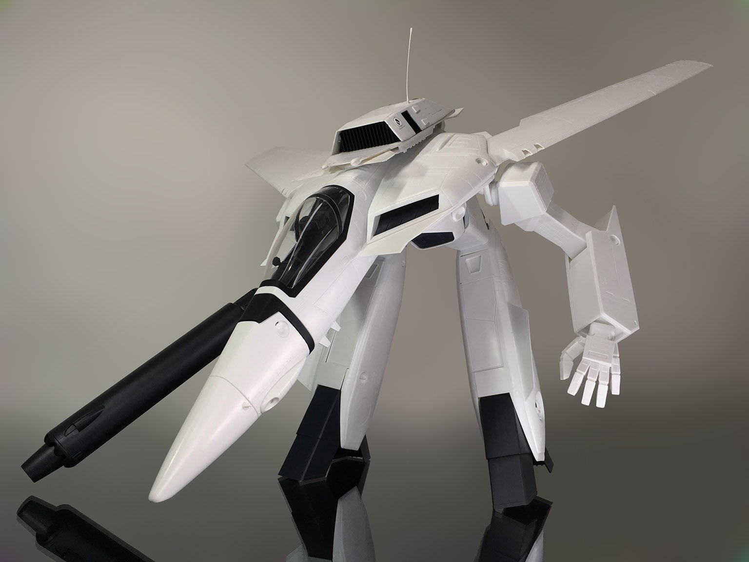

Look Ma, no stand!  :D
It'll look a lot better with scratch-built feet for a bolder Gerwalk stance, but at least I've proved it can stand using the existing parts... after significant modification, of course.  :p

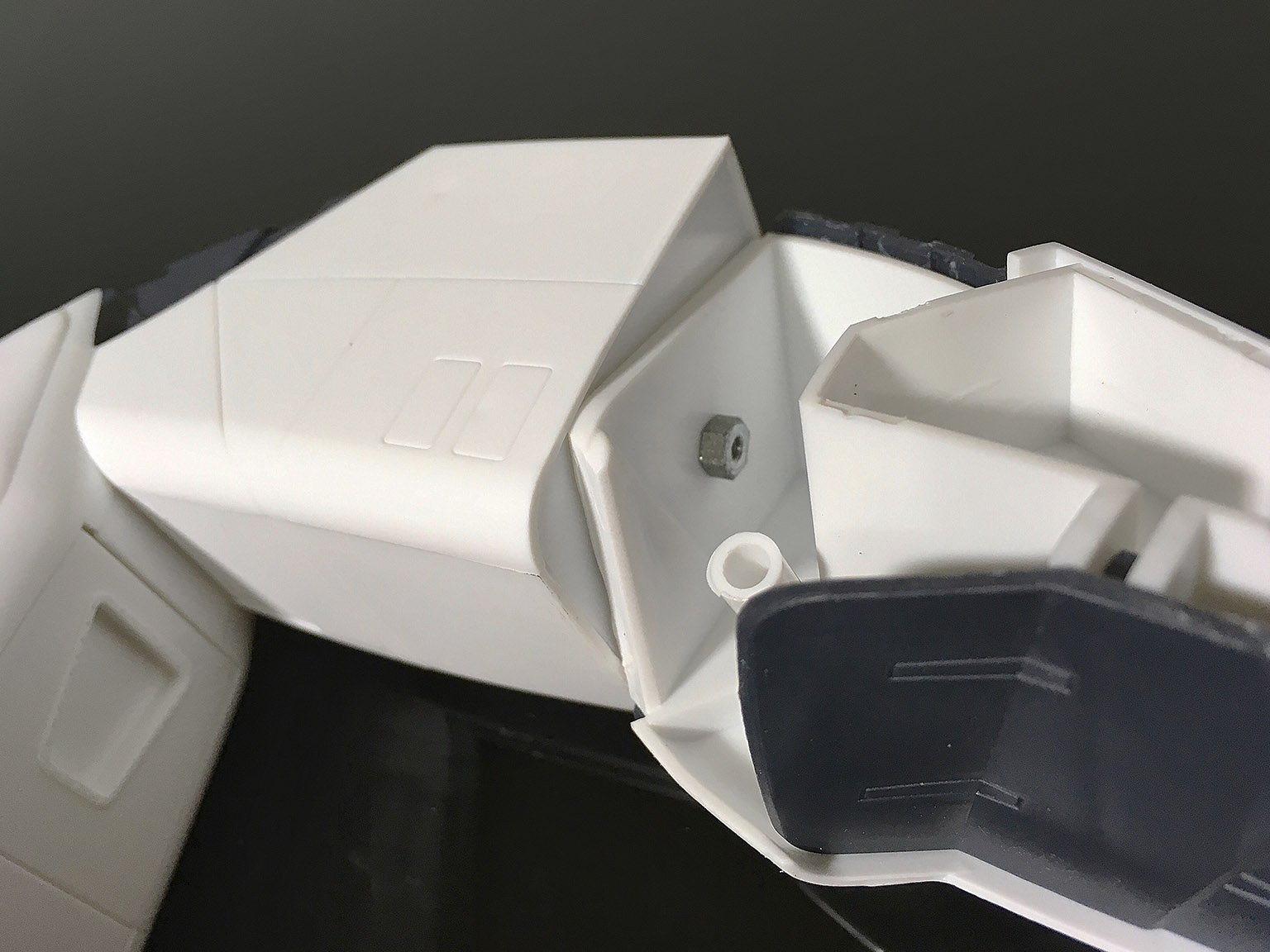

I came up with a pretty simple solution for articulating the intake joint.  After cutting a piece of styrene to fill the gap in the thigh, I drilled a hole in the center, and a matching hole centered behind the intake:
I then threaded a nut through the holes and bolted them together, leaving just enough tension to be able to rotate the parts.
Now the legs can be also be repositioned for a dramatic flight pose, as Max Factory intended.

I was going to ask, are you planning to reinforce those joints at all?  If the plastic is thick enough it might not need it, but a large washer on either side of the bolt would help distribute the load, and keep that nut from stretching and breaking through the plastic.

On 12/8/2018 at 12:41 PM, Hiriyu said:
Repeated posing might conceivably loosen the nut over time if it's not fixed in place somehow.
Thanks, guys.  That's good advice.  :good:
