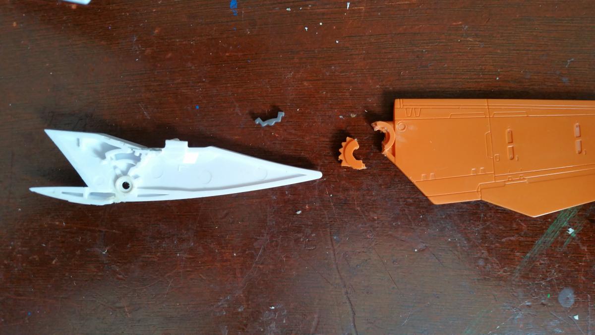

GabrielV Posted February 2, 2016 Share Posted February 2, 2016 My part arrived, so I was finally able to use it in the repair. My VF-0A has been in jet mode since the incident. My first step was to get it out of jet mode so I could disassemble the leg again. I reported previously that the leg had been holding on after my first repair without the part. That was definitely no longer the case, as the leg fell off as soon as I separated it from the transformation pegs holding it on in jet mode. I got the leg disassembled the second time with no difficulty. The new part is just a little half sphere which fits on the square metal peg at the end of the leg bar. There didn't seem to be any glue involved in the process according to the video, so I didn't bother gluing the piece onto the peg. This caused some minor frustration as it kept on falling off as I was trying to get everything placed in the proper assemblies, but eventually I got everything back together. The video suggests spraying some polish on the joint to tighten it. I didn't do this. My final result? The leg seems to be staying on. It's still VERY loose, but not as bad as when it was literally hanging on by a prayer. There is a little bit of tension on the joint, just not much. I've performed one transformation with the new joint and have held the figure in battloid mode sideways. Although the leg flopped all around due to it's weight, it did not fall off. The figure also stands a bit easier now without so much of me needing to carefully balance it, although there is still a little bit of that. I haven't tried any semi-fancy poses yet, just a standard valkyrie narrow A stance. I agree with the video that this isn't something you want to do to your VF-0A unless the leg joint has already failed. This is definitely a patch, not an upgrade. So far, I think it's a good patch because it has rescued my new toy. Quote Link to comment Share on other sites More sharing options...
Scyla Posted February 2, 2016 Share Posted February 2, 2016 I have a question for jenius about is video on the fix of the issue. You didn't use any glue in the process but the leg is still attached to the leg. This leads me to the question why the leg came of in the first place. Was it not seated correctly inside the ball socket or where the two halves of the ball socket not closed all the way. I ask because if the leg stays attached without gluing it to the metal rot of the hip joint something had to be wrongly assembled. I should take a close look at my VF-0 toys to get a better idea what is causing this issue. Quote Link to comment Share on other sites More sharing options...
Tavus Posted February 2, 2016 Share Posted February 2, 2016 As for fixing the damage yourself, DO NOT use super glue, it'll likely make a mess and it will not work. If the landing gear is made of plastic (ABS), use liquid plastic weld (TENAX, Abroid Pro Weld, etc.). I found a local restorer who is willing to fix my vf0 but he says he is going to use super glue. He is a professional and i trust him. I'am just concerned with what Mechanic said super glue isn't good. Should i insist and tell him not to use super glue? Plastic weld is a little harder to get. Is plastic weld much better than super glue? Is it like Tamiya glue? Quote Link to comment Share on other sites More sharing options...
ChaoticYeti Posted February 2, 2016 Share Posted February 2, 2016 Super Glue: PLASTIC===|SUPERGLUE|===PLASTIC Plastic Weld: PLASTIC=================PLASTIC Quote Link to comment Share on other sites More sharing options...
wmkjr Posted February 2, 2016 Share Posted February 2, 2016 (edited) I wonder if the landing gear is ABS and you're brave enough, you can use a drop of acetone to melt the tips of the broken sections together? Edit: Nvm, I thought it works instantly but looks like you need to let it sit. People would drop ABS bits mixed with acetone to make a slurry then use that to repair. I've used Plastruct Bondene to join the wing ratchet for my YF-25 back together after I accidentally dropped it and snapped the wing off. Edited February 2, 2016 by wmkjr Quote Link to comment Share on other sites More sharing options...
