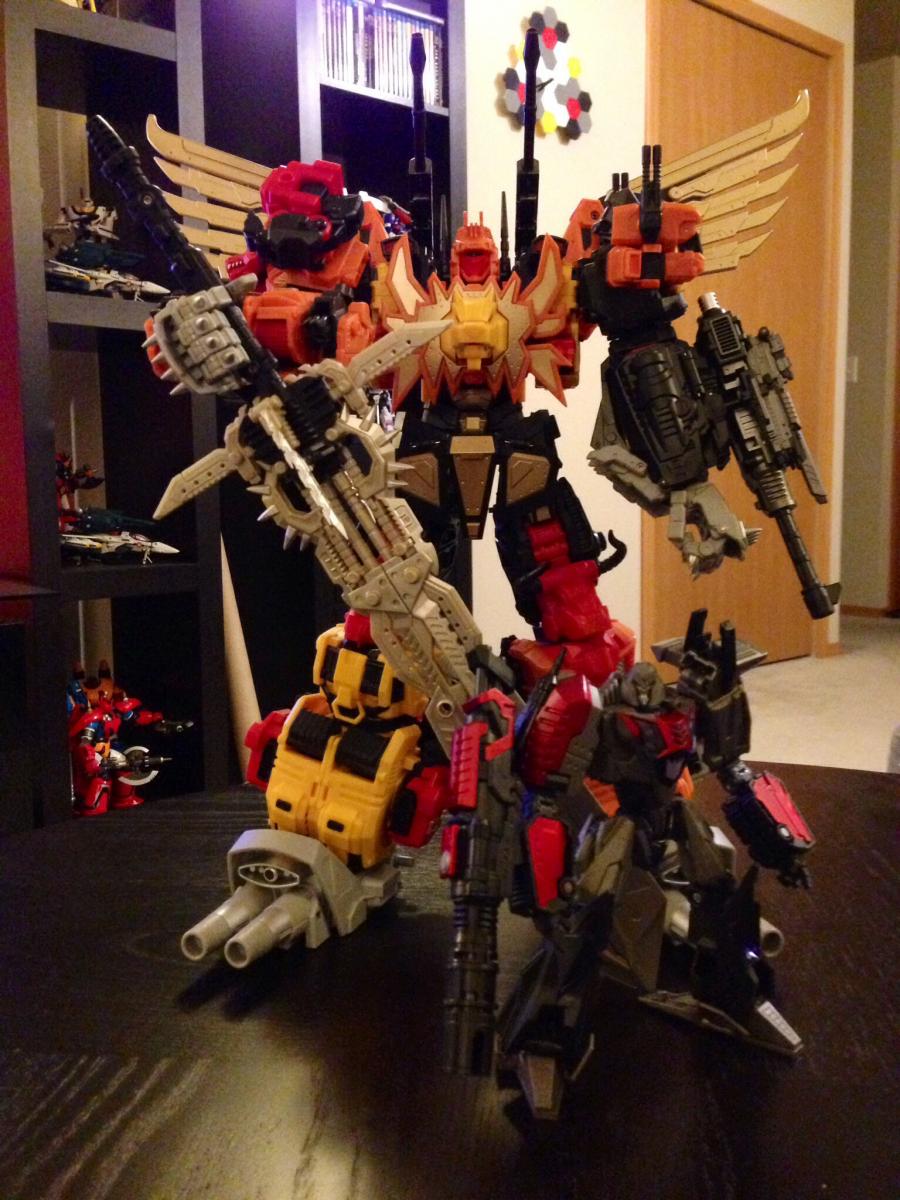

Thanks, I'll have studio pics of Feral Rex aka Predaking soon. I used to collect TFs but I stopped collecting TFs and sold a vast majority of my TF collection to focus on Macross instead. I still collect 3P Combiners. :)
The articulations for FR in gestalt mode is not bad. The arms don't have much range of motion due to the sheet size of his forearms and shoulders. The legs are pretty good, you can pose him in some dynamic stances. FR is something to see in person, he is massive. I haven't placed him next to the other Decepticon Combiners because he doesn't fit on the shelf where the others are located. I'll post pics of all them together on my flickr and facebook page. :)
