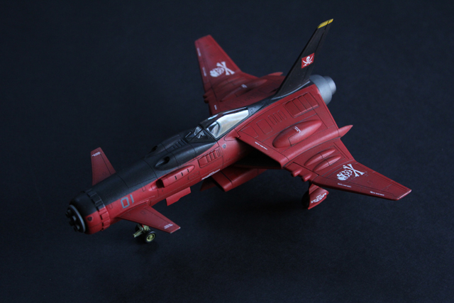

In case any of you were watching this build, I have some progress to report:
I have decal work done and pictures to show you. One caveat though; I am using a 40" LED tv as my monitor at the moment due to a sudden necessary change in hardware... therefore it is very hard for me to audit my photography for quality. If the images are crap, I apologize.

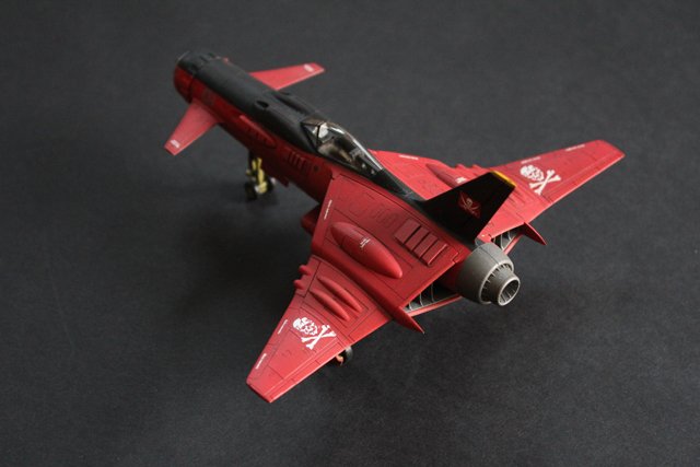

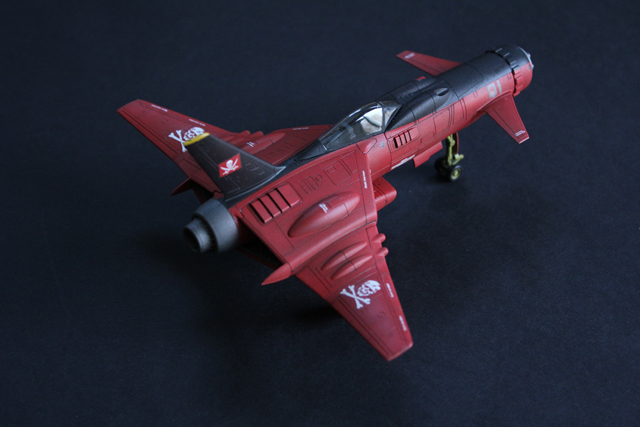

I wanted to use as much common iconography as possible to bridge the gap between the Macross World and Captain Harlock. I used only decals supplied with the kit, luckily there were some that I think did the trick.
Nothing major here except an alternate view.
Detailing with washes turned out to be difficult and not all that convincing. I usually have pretty decent luck with said process, but I think I applied too much of the Tamiya flat red to get the coverage I needed. Lesson learned I guess. I'll have to resort to pencil lining in lieu of promodeller wash this time around. If anyone has any different ideas about what I can try then please don't be shy! :)
modelglue
Edited by modelglue
Link to comment
Share on other sites
For panel lines, you can use various different techniques. First, protect the existing paint with either a gloss, or flat finish. Then you can proceed to either do a wash on the panel lines, or paint them in by hand. I prefer a wash. Much easier, and it is more convincing than the perfect look of inked panel lines.

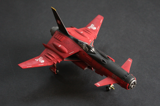

I ended up getting time to work on my spacewolf macross-over project:
I used a bummy grey primer which left a terrible grain on the model. It was a bit of a head banging experience but at least I know now that the primer I used belongs in the garbage.
I used a variety of panel lining techniques to experiment and cope with stubbly surface texture, which didn't settle down after sanding lightly or future coats. I used wash, tech pen, and finally a small graphic pen. I'm trying out some different photographic methods so don't judge me too harshly on the quality please!

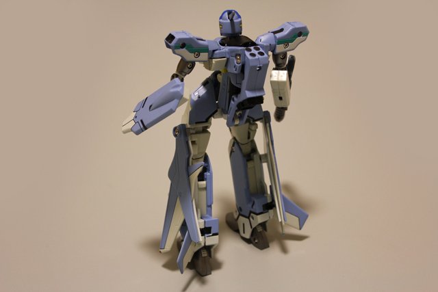

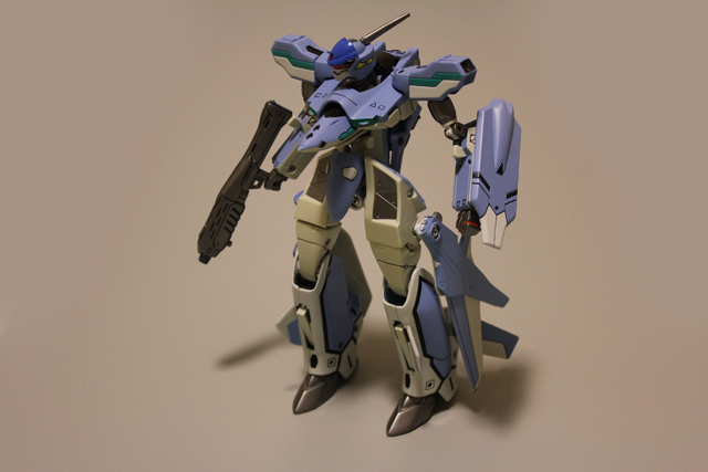

I'll duly post better pics of this when my wife shows me how to operate her camera properly, and I will be posting my progress with my VF-27 Beta which I started this afternoon. Boy is it a new experience, my first Bandai kit of this style.

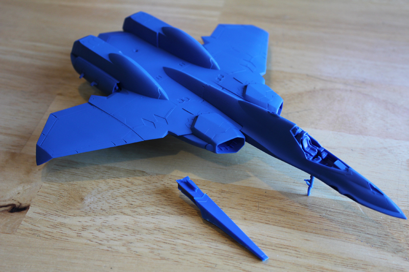

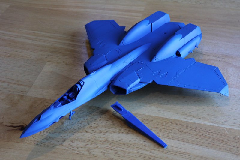

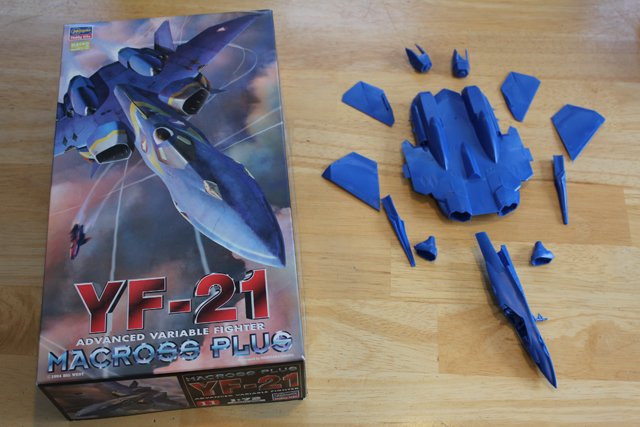

I started Bowman's YF-21 from the 1/72 Hasegawa kit, which I think I'll paint as a Max version. I really like the idea of the grey scheme used in the moon shooters release but I feel like it makes for a pretty boring battroid when you plunk it next to VF-11's and other low-viz examples (which I prefer to the demonstrators).
So here is my progress on a VF-22:

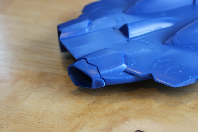

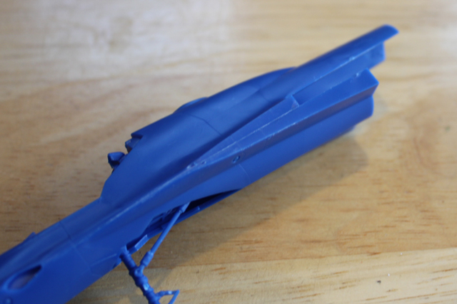

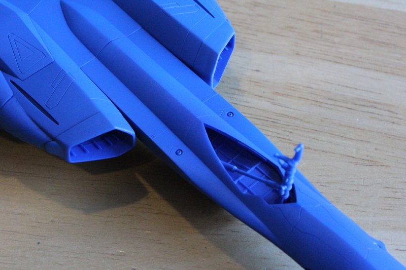

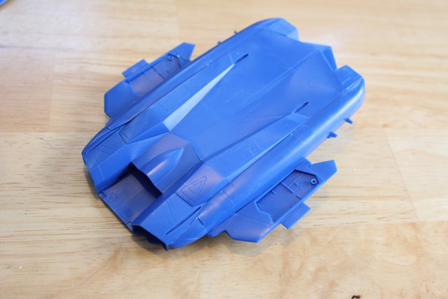

The only real major seam to clean up in on the exposed fuselage ahead of where the inlet is.

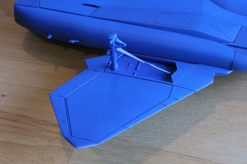

The port inlet is just sitting there, but you can see that gap behind where the wing root (fast pack?) meets the inlet.
Overall this kit pretty well fell together, not too many fit issues considering the somewhat unorthodox construction process. The subassemblies are heaven sent though, being able to paint them separately is nice. :)

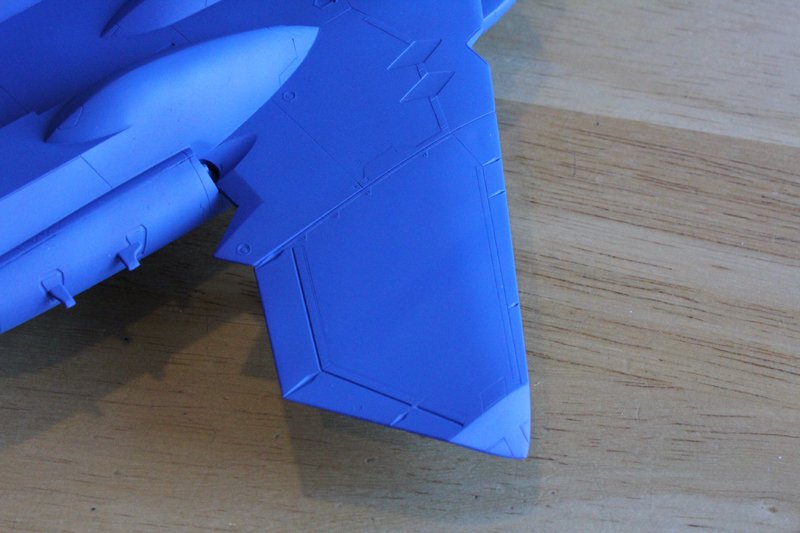

If you're going to use the clear pieces for the wingtip lights on the -21, be sure to cut out the space while holding the clear part on the wing. If you cut by going with the lines already marked on the part, you're going to end up with a space about twice the size of the clear part.
Personal experience here.
Link to comment
Thanks guys for the moral support.
If you're going to use the clear pieces for the wingtip lights on the -21, be sure to cut out the space while holding the clear part on the wing...
Thanks for the heads up, Jefuemon. :) I think I'm going to take the easy way out and paint them with a coating of window making glue.

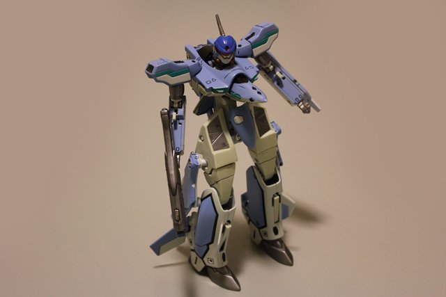

Guys... just got this in the mail yesterday from a fellow in-Province. I am pretty pumped as this is my first 'toy' purchase. I am well aware that this isn't really in the same class as lets say... the Arcadia 1/60 VF-19P but it is still exciting as I have some naughty plans for this and a Hasegawa YF-19... want to do a custom model and paint it in the Bird of Prey scheme. :ohmy:
Thanks for tuning in! I'll try and post updates as I go, but sometimes it's hard to capture progress in an organic situation like a mod of this magnitude!
