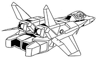

What about the secondary engines? They seem to be able of thrust vectoring?
Besides, the tail fins are most definitely NOT vertical but diagonal (see cutaway diagram). That doesn't solve the problem of missing horizontal fins, but it could help...
Here, I provided a rear view of the Legioss...
Edited by Burn

Burn--those count as verticals. Look at an F-22 or F-18. They're angled just as much as the Legioss, but are still the vertical stab, and still require full-size horizontals. F-14 has moderately canted stabs, likely the VF-1's inspiration. (While common nowadays, F-14 was pretty revolutionary for a jet in having two fins, canted outwards) A canted vertical stab does almost nothing, control-wise. If you pull both rudders inward, you can gain a moderate pitch-up when combined with the elevators. But nothing more, no actual pitch control. Works almost exactly like adding nose-up trim. (Good for carrier takeoffs, but not in combat)
YF-23 is one of the few planes with true "flying tails" that can do anything and everything, and it has an utterly unique control system. (Also, its stabs are SO out-canted, they are actually more like horizontals that have been bent up---yaw control is B-2 style, from the ailerons) And of course, YF-23 uses the WHOLE tail to move, not just control surfaces on the trailing edges.

The spare engines could indeed be a possibility, but it is really hard to see where their thrust goes and whether/how it might be vectored.
Also, I just realized that that picture shows a "protoculture storage compartment". So goodness knows if it represents the original intent of the Mospeada mecha designers.
The original MOSPEADA units used hydrogen fusion. Fuel came in standardized H2 cartridges.
If I'm not mistaken, the storage compartment is the MOSPEADA "fuel tank", for lack of a better word.
Those engines up top are a joke, sad to say. Mainly beause there's a hand right behind the nozzle.
Not sure what pic you're talking about, but ...
This pic shows a hydrogen storage comaprtment. HBT is hydrogen something or other.

The bottom-most pic posted by Burn looks the most do-able, but still too "everything" that I mentioned. (Tail-heavy, lack of wing, etc).
