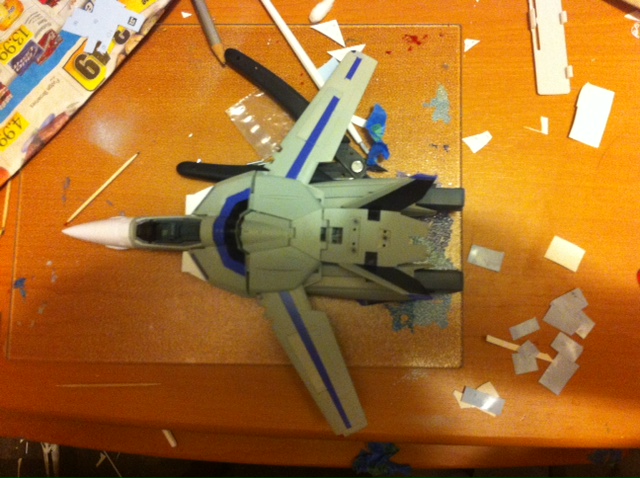

Most of the blue striping is done. The nose of the plane is still outside drying before I call it a night. The stripes on the wings and legs will need some touching up of gray once they've dried. I'll need to re-primer those areas then lightly touch up with royal gray once it's dried. You can kind of see where I tried to touch it up already and it came out a lil grayish purple.
The black for the chest portion came out really well, and very pleased. Next step is to let it cure over night and then tape that area up nice and snug so I can get the blue on the final portion.
After that I'll have the lower leg wings, and tail to go which is under another coat of black right at this time and will have to all it quits for the night, done or not.

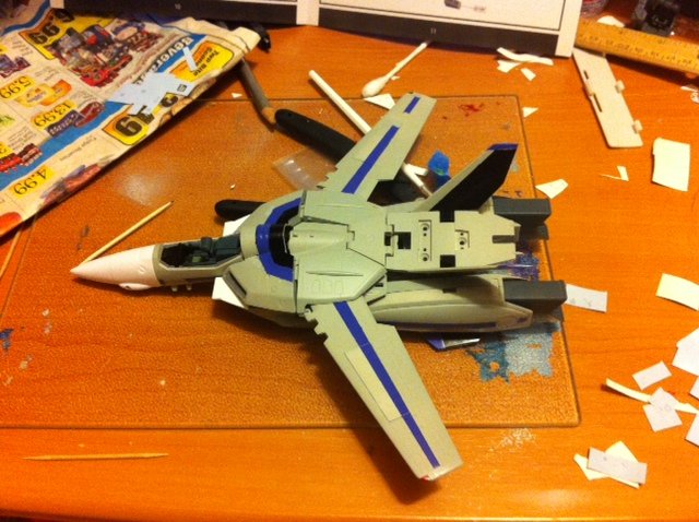

image7.jpg There was a ton of touching up. Painters tape was not my friend through any of this venture. It's a little hard to see it, but if you focus on some areas of the parts you'll see lil marks that I had to touch up with royal light gray to fix the over spill of paint into portions of the panel lines.
Still, none the less the paint job did turn out good, and I think the color mix is excellent.
One thing does bug me, the right thigh didn't want to snap correctly and is leaving a gap. Anyone had any slight gap or odd part fits with their kits?

Paint is holding up really nicely. I've been doing a scratch "test" with my finger nails and what not. If I leave it alone for a day or two, it cures nicely. Which is why you don't see much of anything unless it's internal being assembled.
I built the head as my final bit for the day, I feel like it could use a little blue violet or something on it instead of 2 shades of gray for the turrets and head unit itself. There's a very faint clear green on the visor, but just enough to make it stand out as something was there. That bit came out nicely.

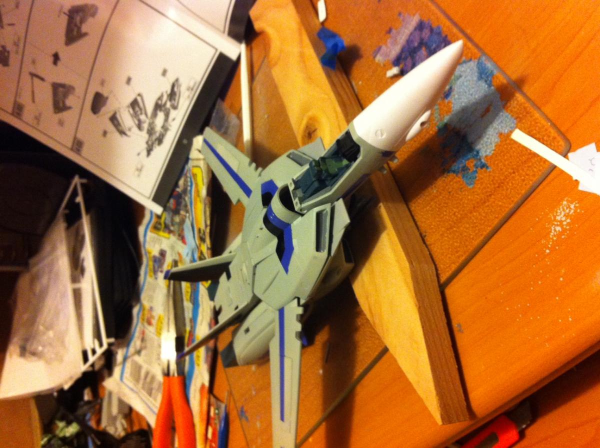

Well I decided it wouldn't be fair to show you guys what was done, so here it is. It's a test fit so nothing holds together. I ended up screwing it up big time for something that to me should of seemed just so straight forward.
So lemme give you guys a lil advice. becareful with the hinges, I couldn't figure out which hinge went where cause they're all different shapes and sizes. You might think one second you got the right one, but then you realize it might not of been. These instructions were just a big ass joke and I think Yamato outta go back to the drawing board on that.
it's also easy to miss a ton of parts. I was going to trade pilot figures but sadly I lost the main body but got the limbs and arms, I'm so damn embarassed after putting in so much effort into it.
I also lost the neck piece to attach the head unit, and I screwed up the left hand by doing it in reverse and didn't even realize it till it was to late.
All in all, if I could of assembled it, and made corrections, it would of been a real nice completed kit.

final update for the night. I did another test fit, determined that you should NEVER paint the diecast part that's between the main body and intake legs. NEVER EVER EVER, never saw so much paint scrapping off in my life time!
I have 4 pins left, 2 go on a set of little swing bars inside the chest piece that helps it swing into locking position. These tiny lil 6mm pins will NOT go into the diecast piece part. They got the little crowns on them, and they're the only ones that seem like they'd fit, so I dunno why they wont. I've even taken pliers to them but they just wont budge.
The other 2 pins, I think they're 11's are doing the same thing. They connect the two square pieces that bridge the front and rear portions of the plane that form the torso as well. The pins will go into the bridge portions, but that same damn diecast piece wont let them slide into position. if I can get these four pieces into their position then this damn VF-1 will be mostly finished minor superficial stuff like the neck joint, and repainting and priming the shoulder bits and leg square that plug into the intakes.
