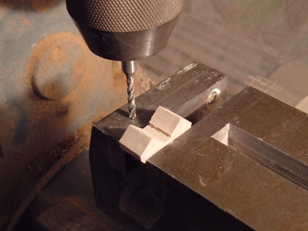

Pic 2: once the diagrams have been cut and placed on the modelling board, the real fun begins as I start to get my hands dirty. In this particular pic, I have to start by evening-out the master block to get the necessary plat planes.
Pic 3: some back-and-forth between the mill and the band saw is quite common: the latter allows me to separate and chop off excess material quickly.
Pic 4: Back to the mill yet again. This particular part will comprise the upper main hull, and is the single largest part of an otherwise small-scale ship.
Pics 5 and 6: the main hull parts crudely assembled. There is obviously still a lot of work left to get it looking like the line-art, but it's progressing nicely and will take shape gradually. More to come in the following week ;)

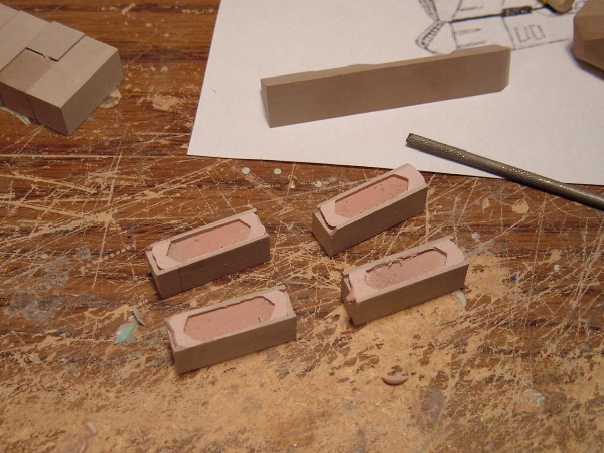

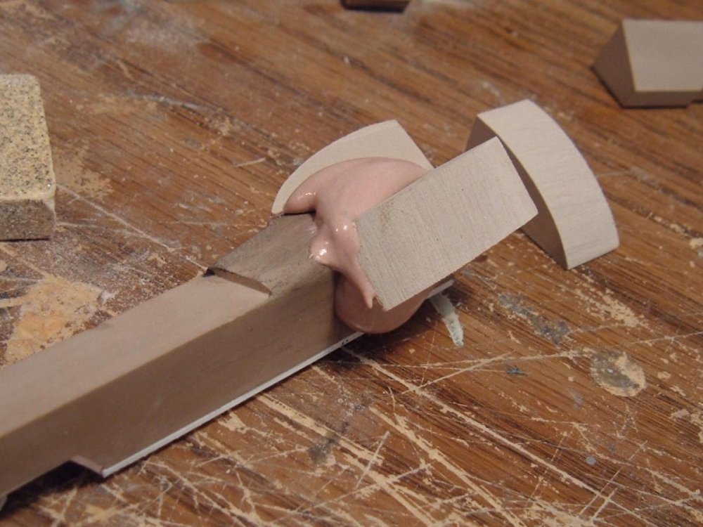

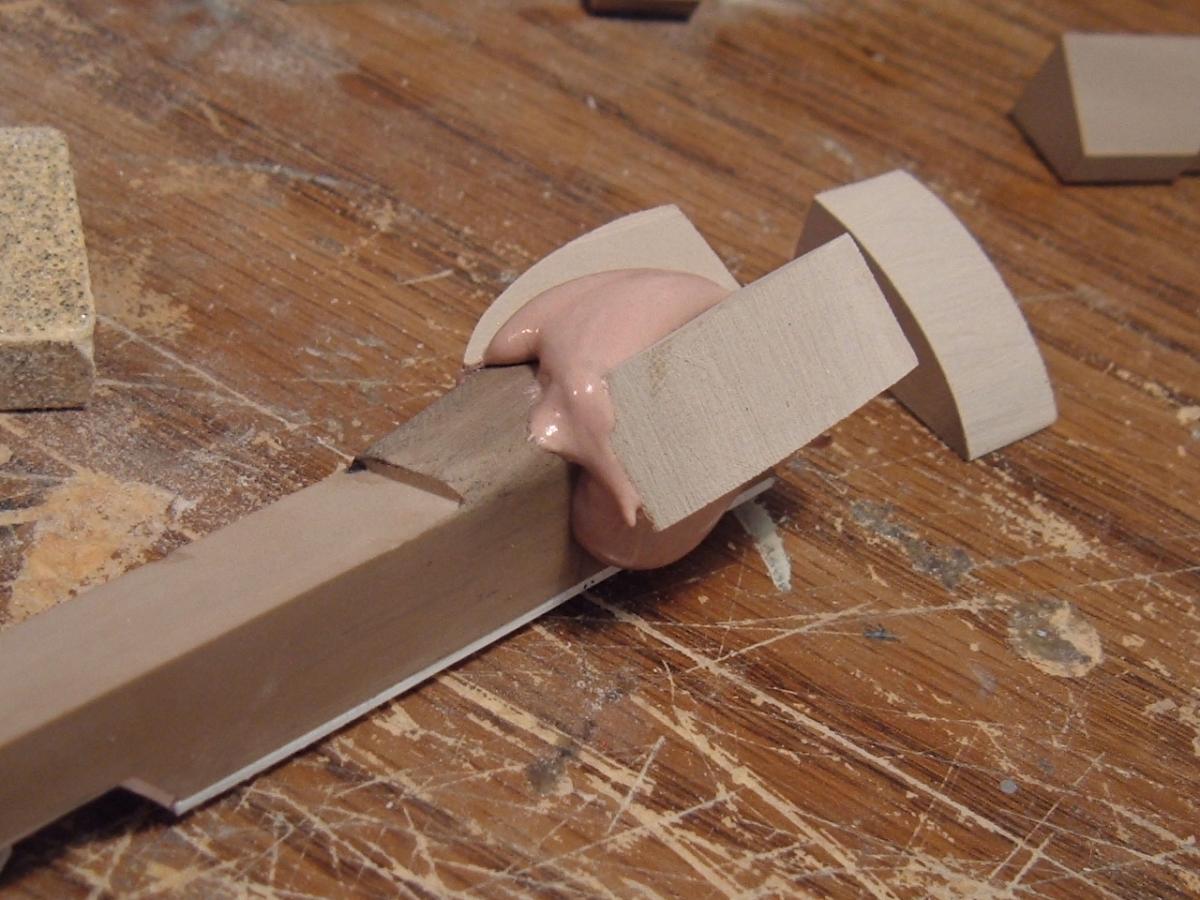

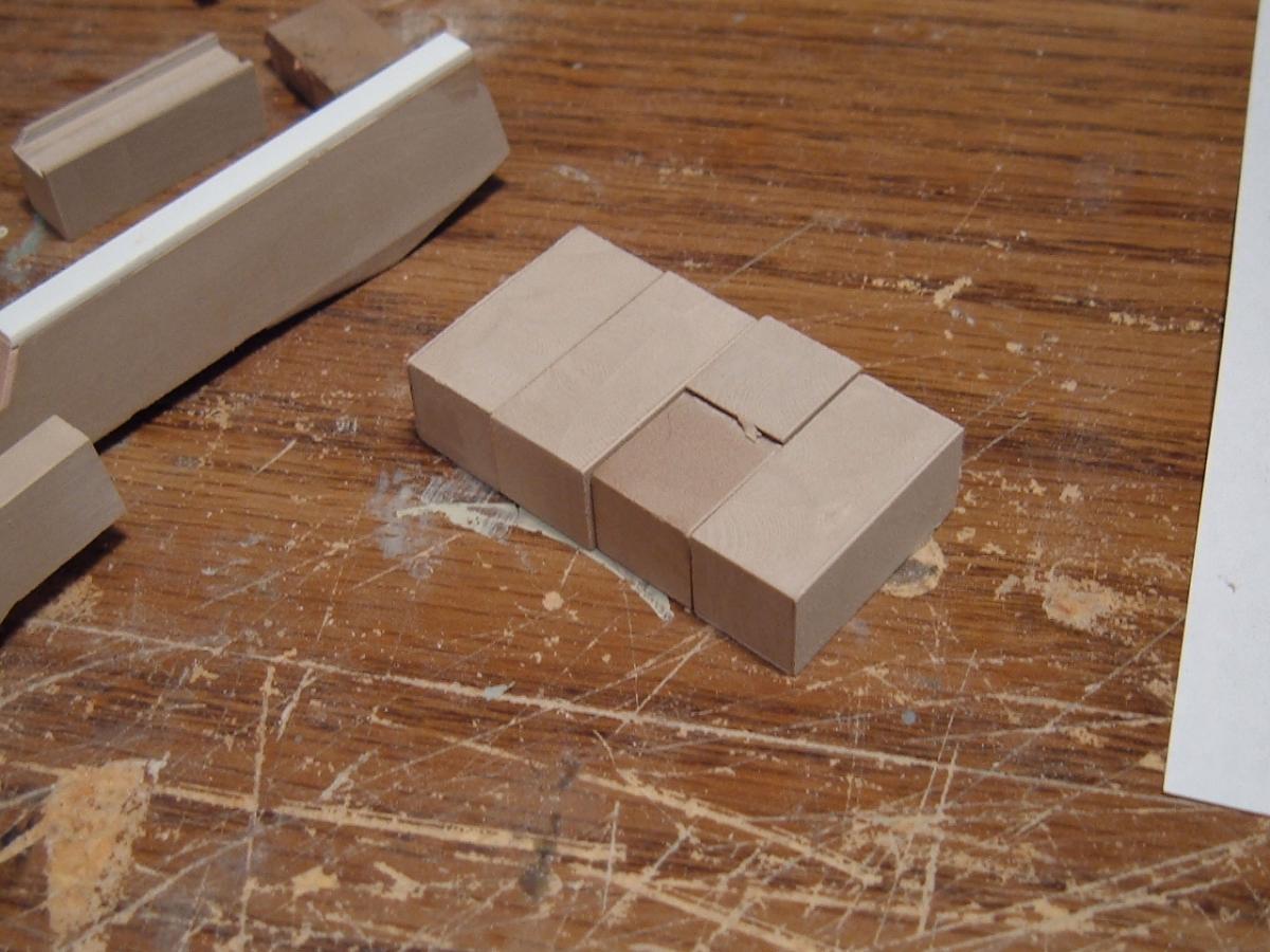

I'm happy to report that things are progressing nicely with the ship. In pics 1 and 2, we see the launch bays in their crude form: the parts on the left in pic 1 are the bucks used to obtain the uniform shape of the bay doors, while the parts on the right are the housings. With a little bit of putty, we end up with the parts in pic 2, which will later be reshaped further.

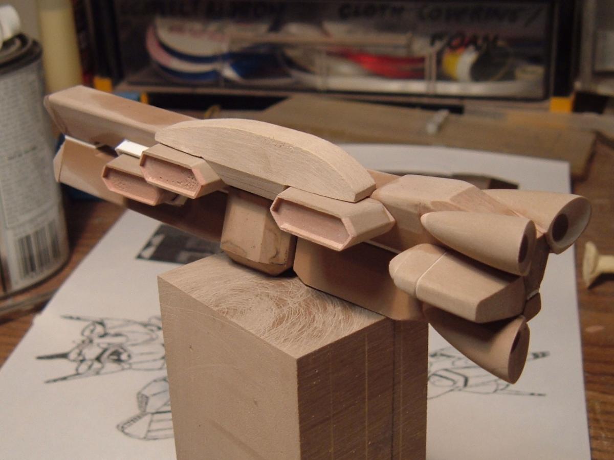

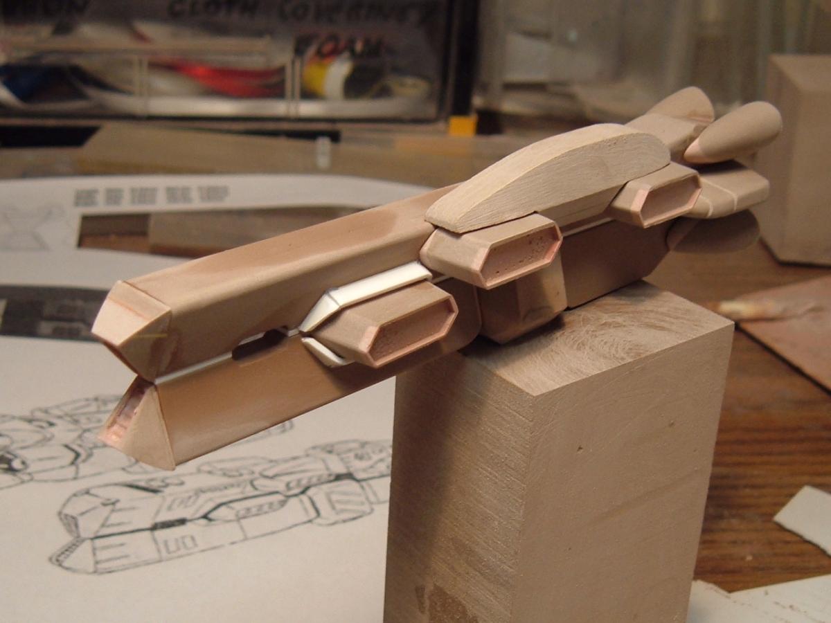

Pic 3: these little blocks will form the aft engine nacelles, even though it doesn't show right now.

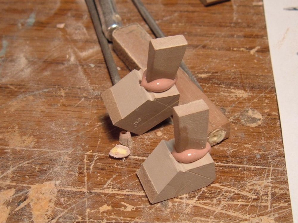

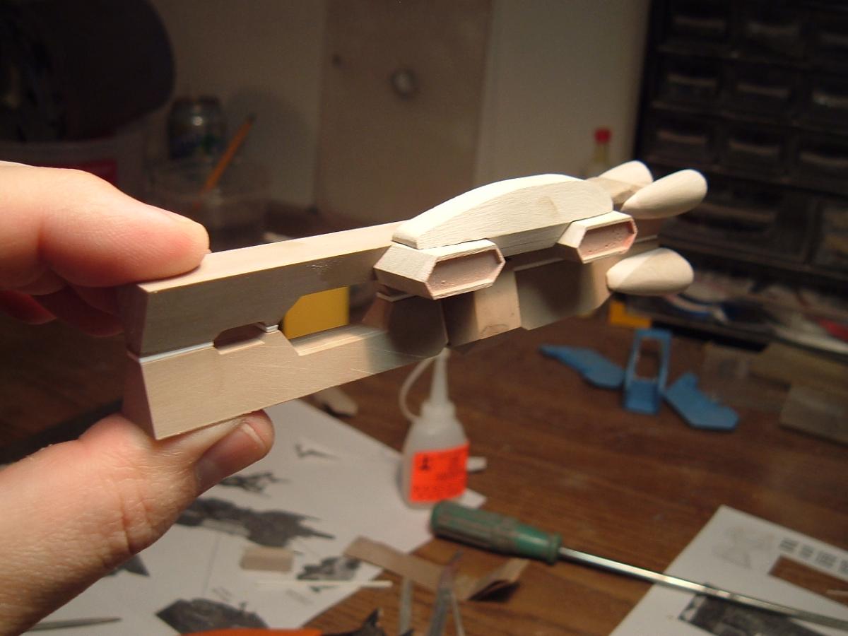

Pic 4: two of those same blocks have been smutted into place with some putty to obtain a glove-like fit on the main hull.

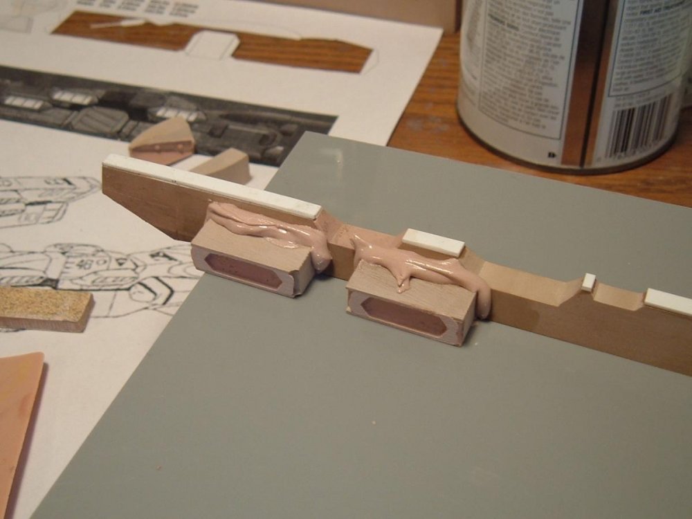

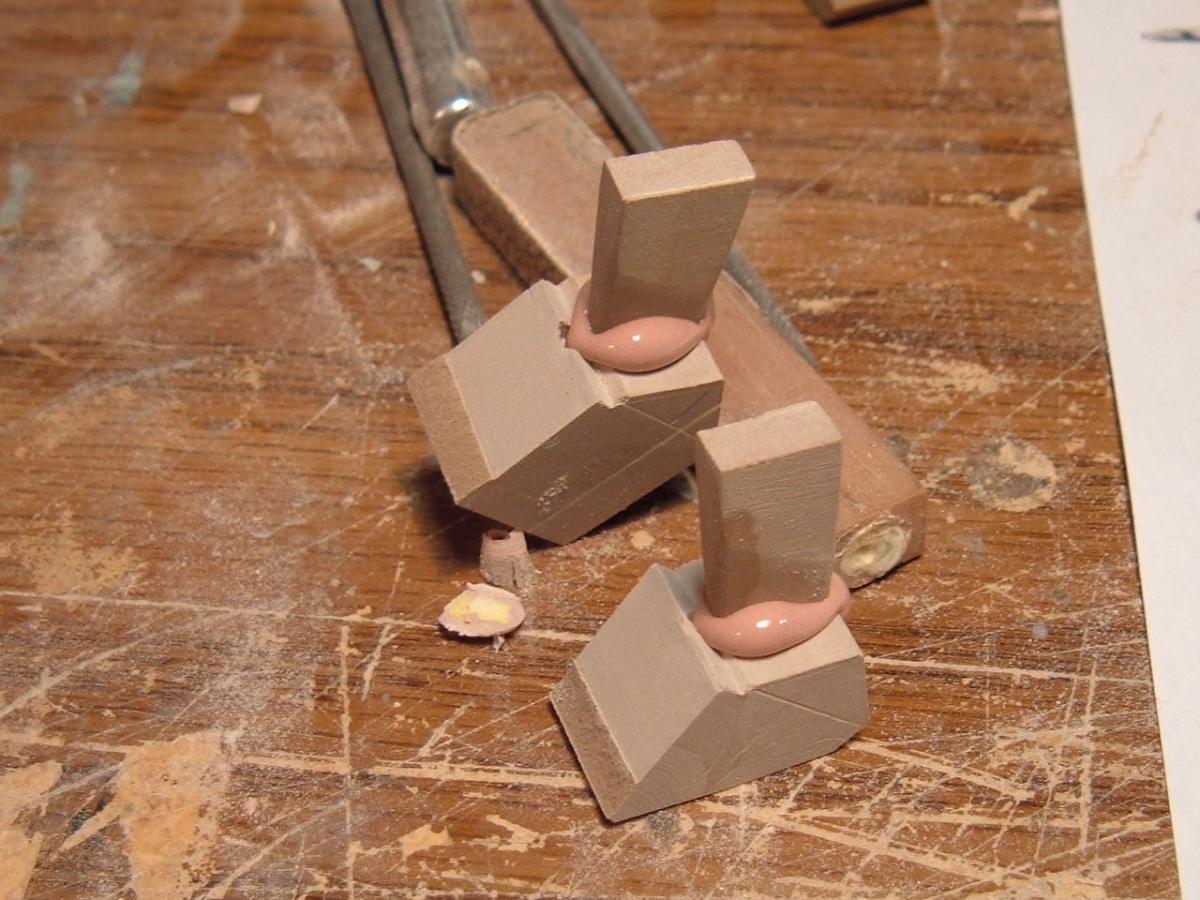

Pic 5: the same procedure is used to get the tapered shape of the launch bays against the main hull. It looks messy and imprecise, but I swear by it!

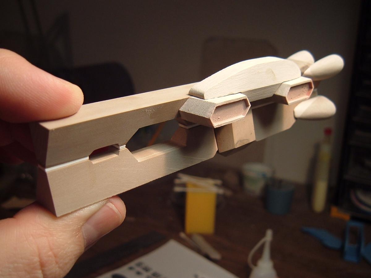

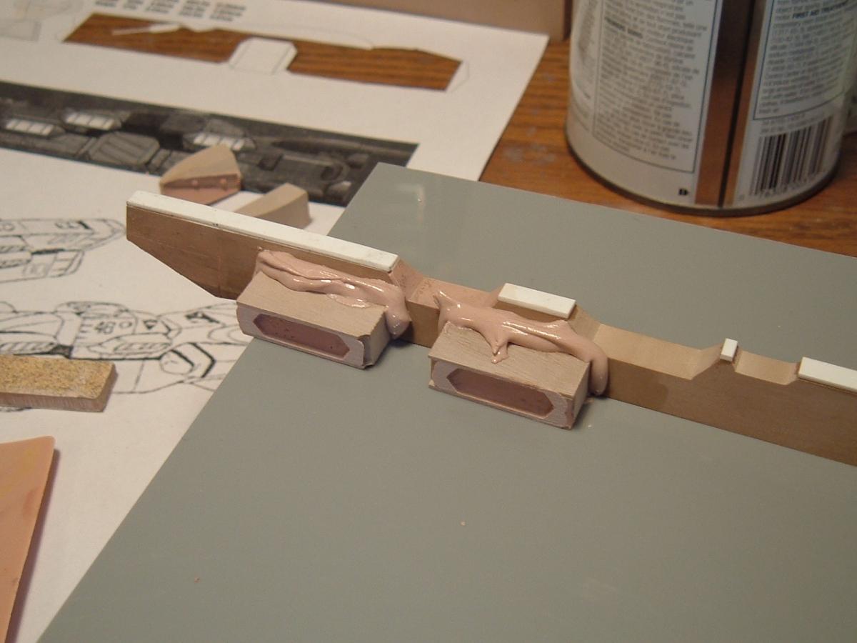

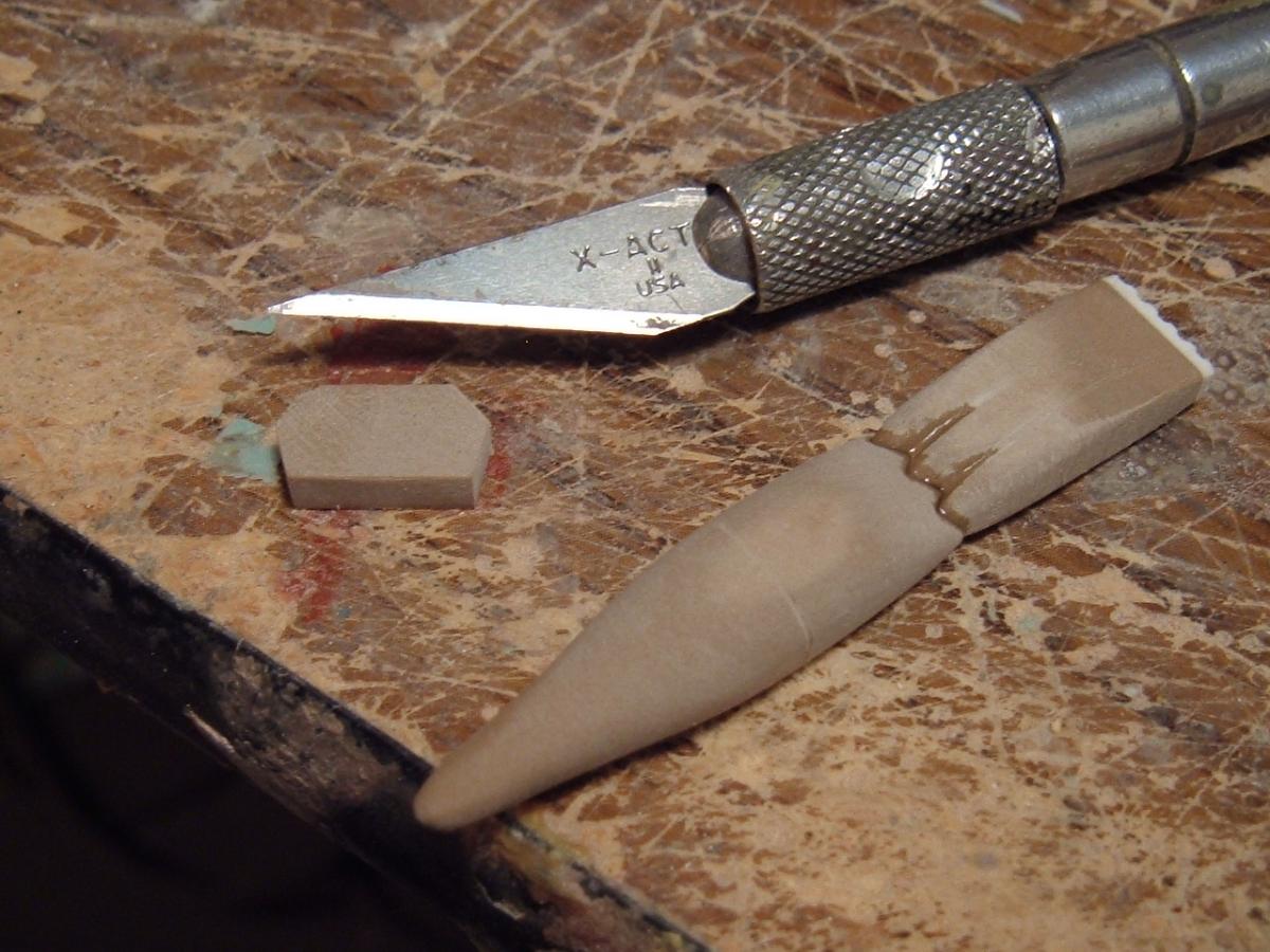

Pic 6: the crudely puttied parts are now starting to take shape. The engine nacelles were Dremeled and then manually sanded to their desired curvature; a job requiring anobscene amount of work and attention, I might add.

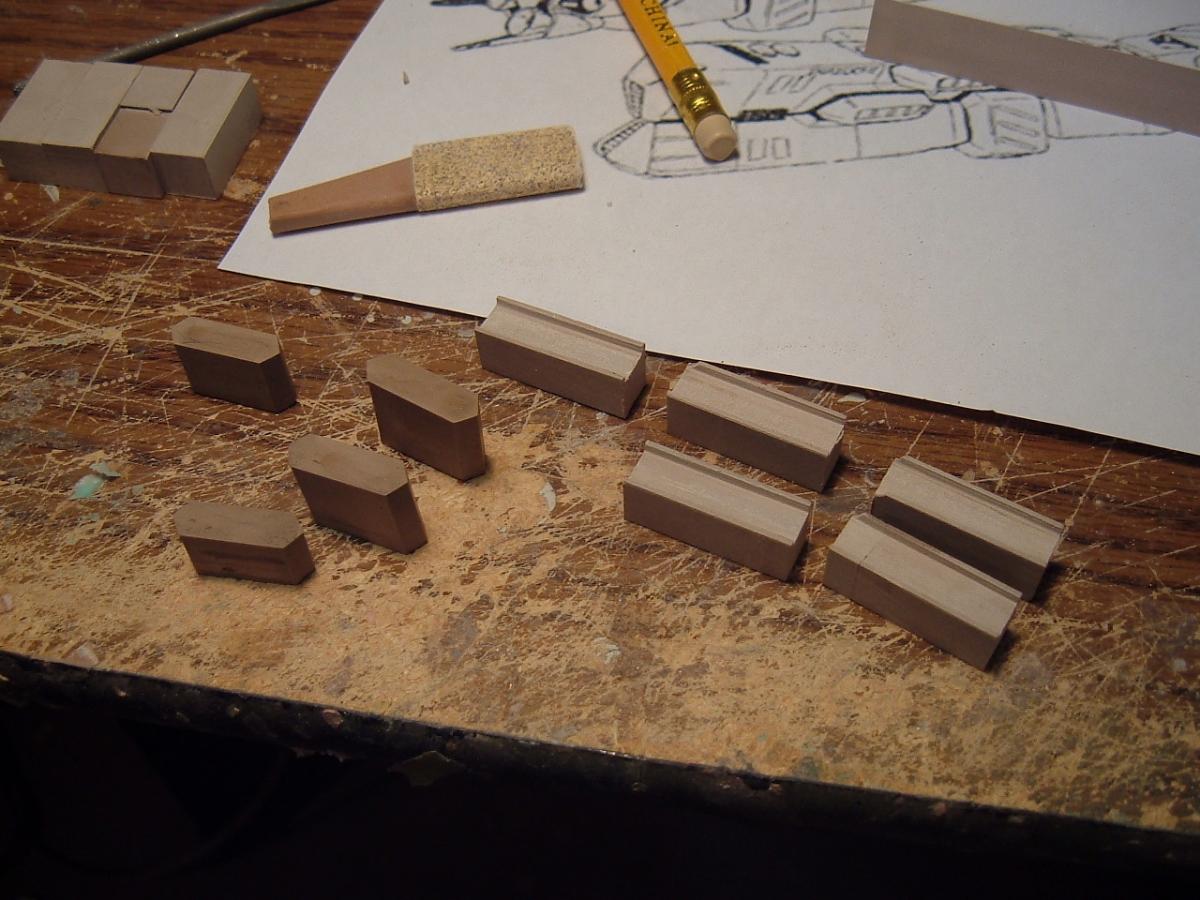

Pic 8: the forward hull "caps" in their infancy. The parts are initially machined to maintain close tolerances…
Pic 9: and then the same putty smash technique is employed to get the grilled opening. The positive bucks were hand-shaped and carefully coated with mold release.

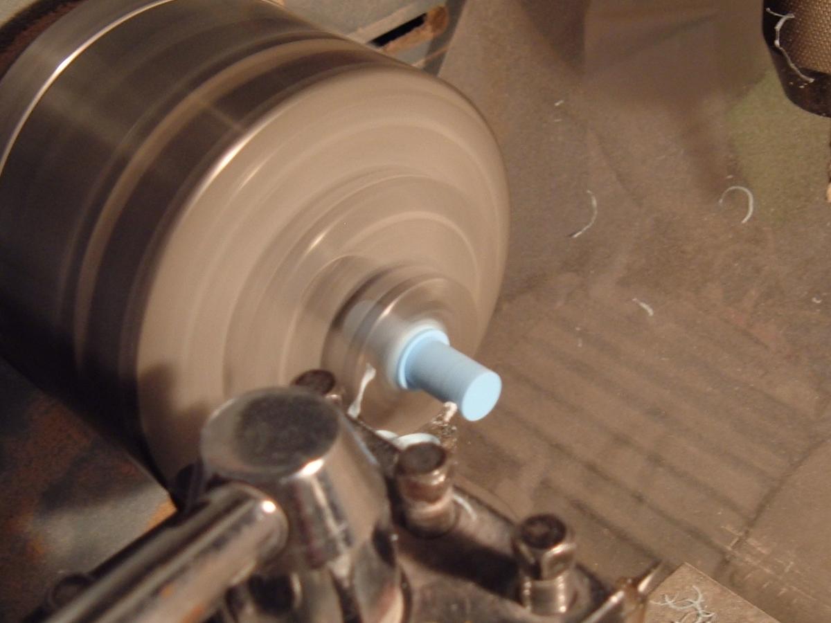

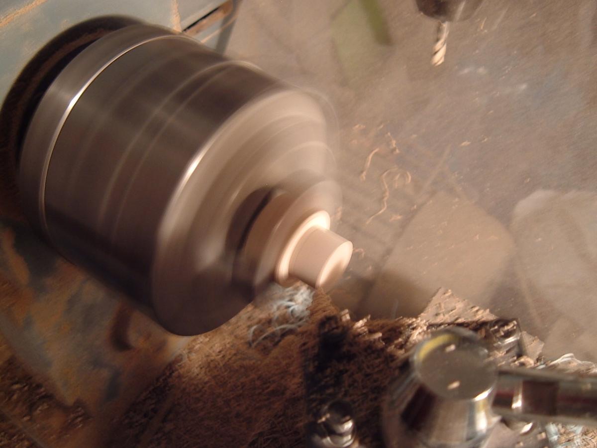

Pic 10: the engine nozzles taking shape on the lathe.

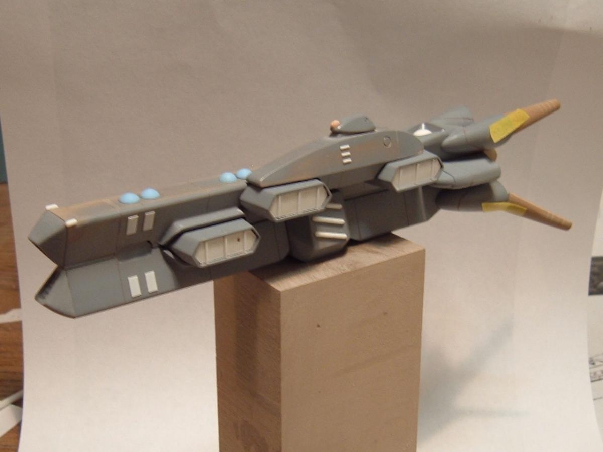

Pics 11 and 12: it's finally starting to look like an Ikazuchi! Much of the hard work is done, and from here my job will consist of refining the shapes and adding the more minute details. The ship masters should be complete by the next update, so stay tuned!

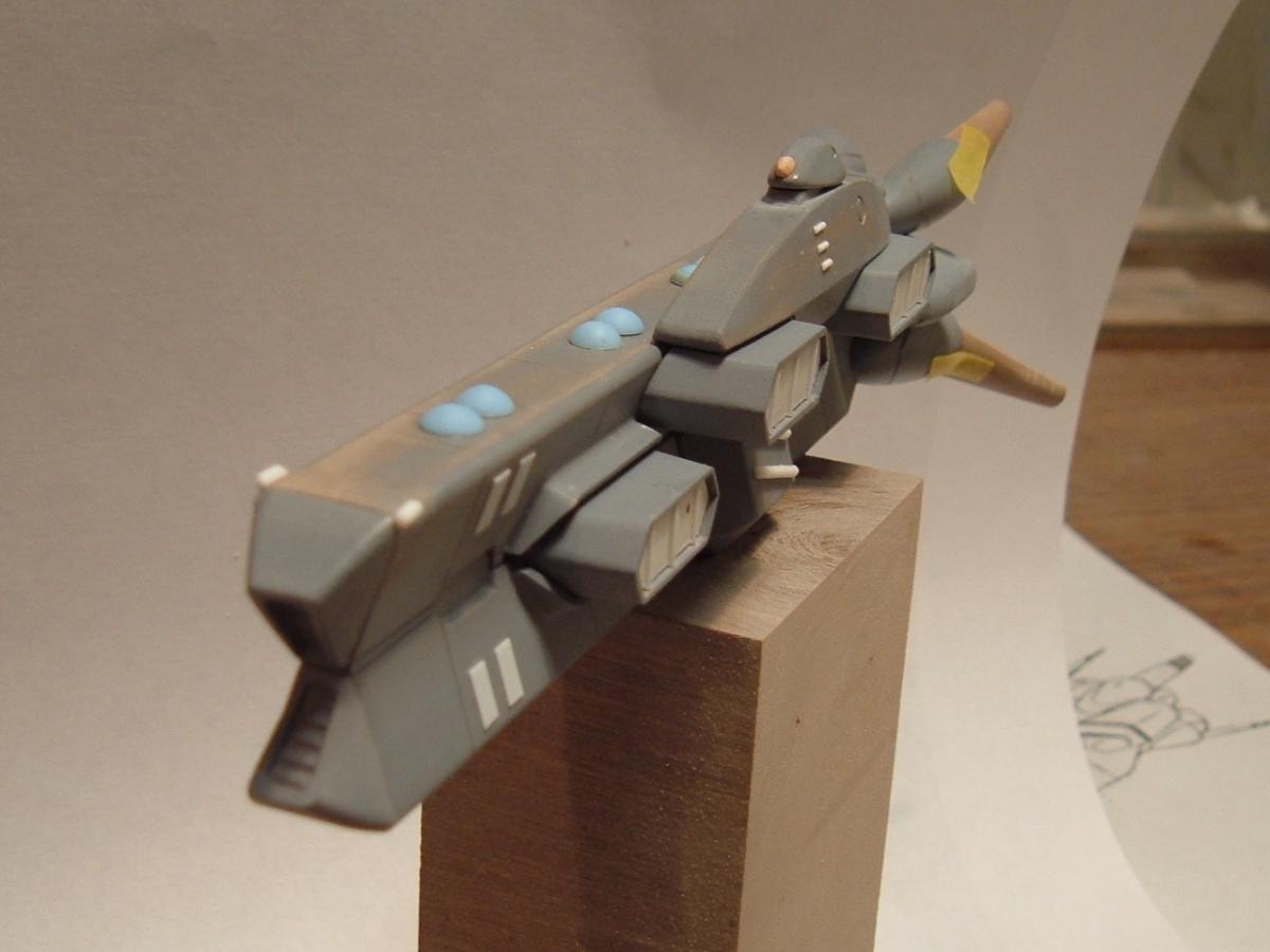

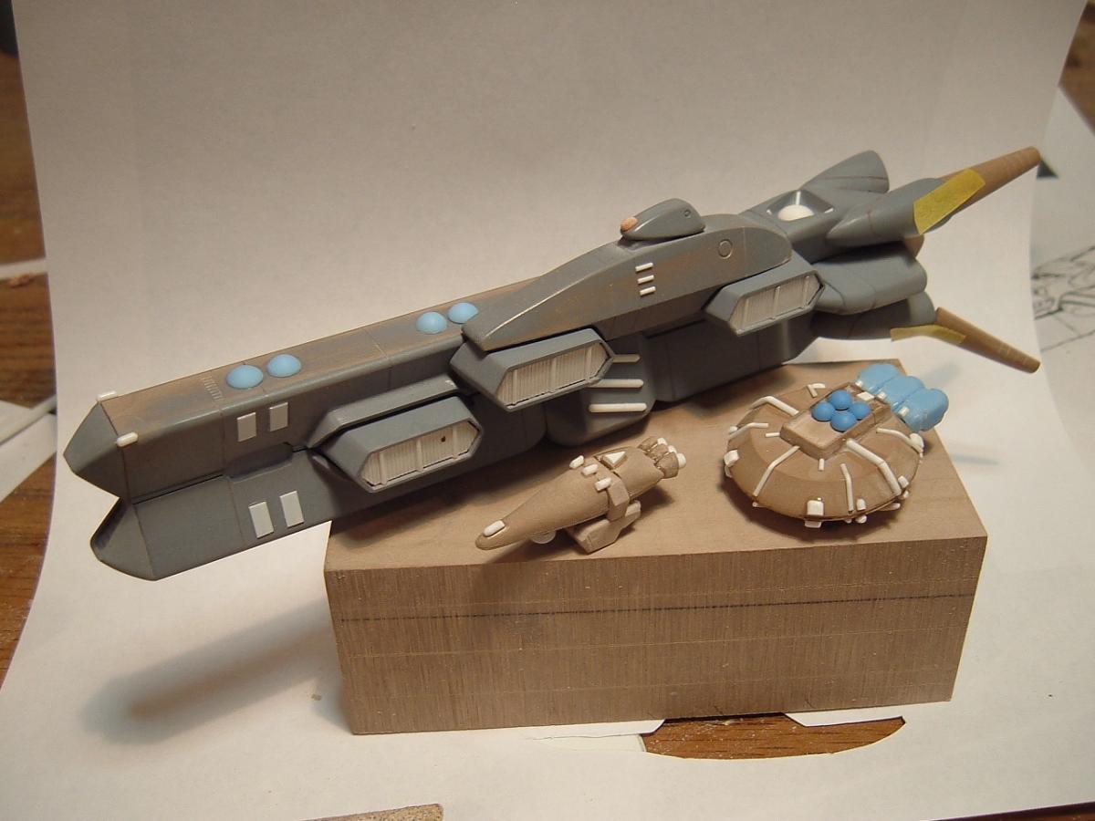

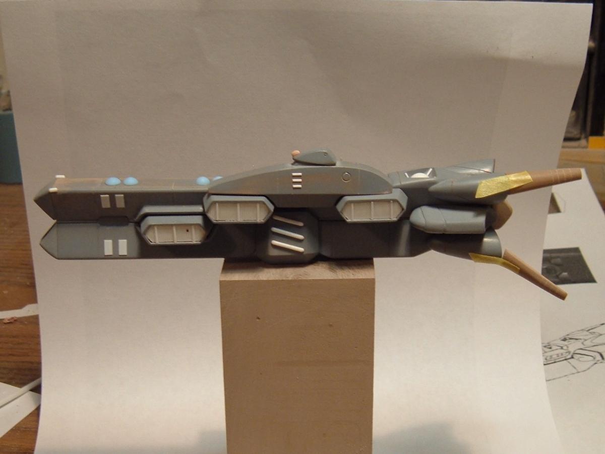

Captain's Log, stardate: Wednesday evening. Almost supper time.

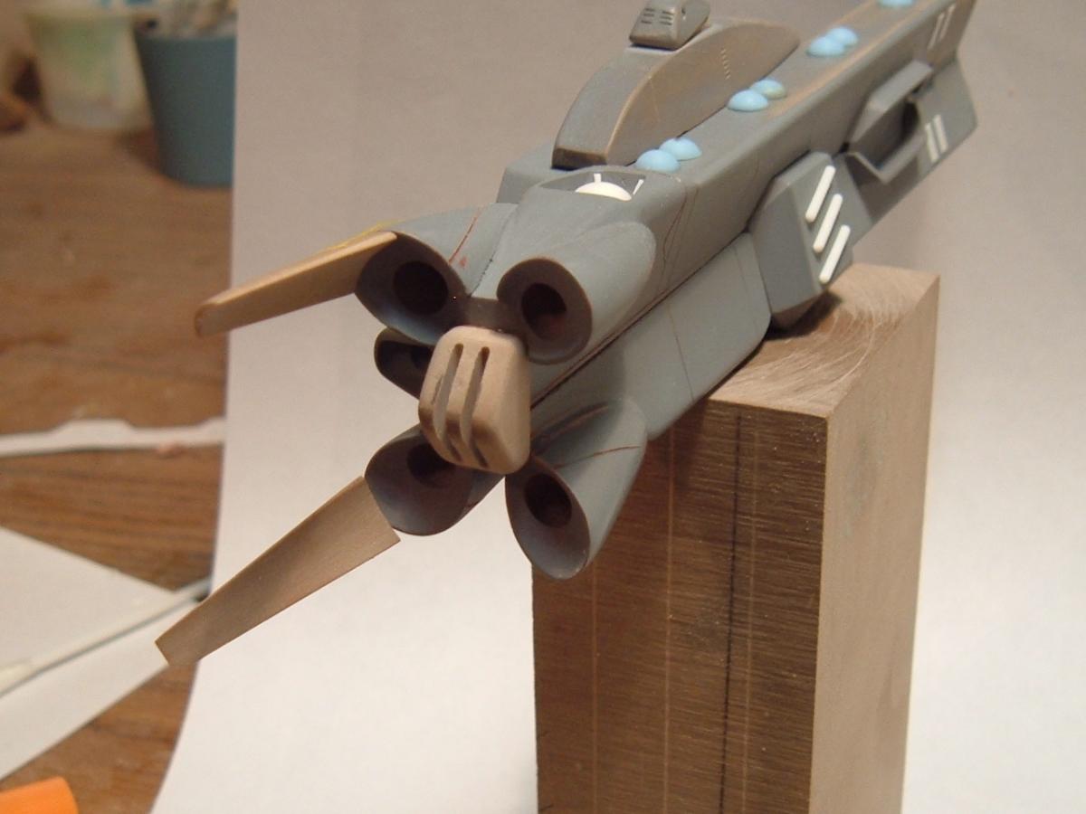

Guess what??? I'm just about done! Save for a few little details here and there, the patterns are essentially finished! Pictures 1 through 4 are beauty shots of the masters. The main thrust nozzles are done too, they just wouldn't stay on for the photo shoot… Pics of these a little later...
Pics 5-7 are of umm… A teeny little surprise!
Since the Ikazuchi is in 1/5000 scale, I figured that it could use a little bit of company, so I started toiling-away on my machines and cracked my knuckles for a little bit of small-scale surgery… And voila! 1/5000 Garsish and Inbit clam! I think that those 2 little ships had me on-edge and cursing more than any project in recent memory, especially the clam: it looks really simple, but it's not!
Alas, I will now be starting mold prep on the parts; should be a fairly drama-free procedure, but you never know… Be sure to check-in next week for more of my model-making shenanigans!

Whoa John, you must have more than two hands...... That was fast :) and great to see the smaller ships for size comparison.
(in Homer Simpson voice) Ummmmm.........Inbit
