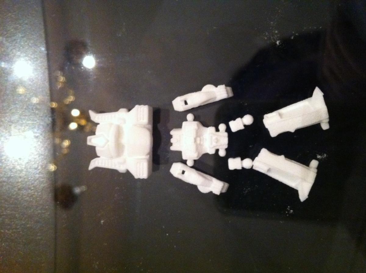

I just got my shapeway order. It came out super grainy and needs a ton of sanding. but there's so mnuch residue on it that I'm soaking it for an hour in a bleach solution to eat away the loose particles. I've tried it before with a custom paint job I did on a Rodimus figure some yaers back. And it worked WONDERS.
