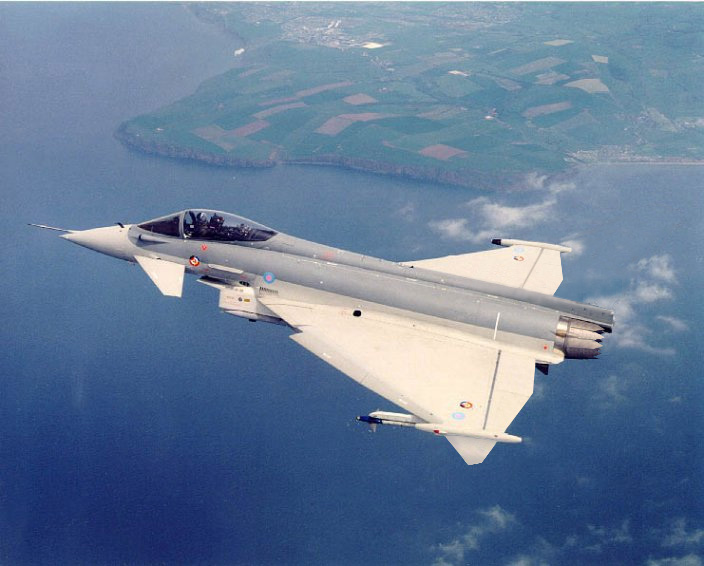

Interesting... If I'm thinking right, the lack of a vertical fin allows for a better stealth profile.
However, a plane doesn't "need" a rudder to fly. It will still work, just don't get yourself into spins and stalls...

EF2000 thrust vectoring will look like this:
http://www.eurofighter.starstreak.net/Euro...er/engines.html (very nifty design, better than an ACTIVE nozzle)
Also, if you want a tail-less plane, it better be a flying wing. You need a WHOLLY different control system. Vectoring isn't used for yaw. Pitch-yes, roll-yes, yaw-no. It CAN be used for supplemental yaw, usually combined with pitch and or roll. But no plane uses vectoring for yaw alone, not yet. Yaw is just plain different than other forces on a plane. Don't know why, just always has been. There's a difference between yaw control and yaw stability. Vectoring can replace control (but it hasn't yet) but it'll never replace stability. (Not until we have like Star Trek level of tech) If you plan to remove the v.stab, you better attach some massive ventral fins. (Unless you've got a flying wing and are using split-style elevons--flying wings are SO stable and so un-influenced by yaw they can be tail-less---but a normal plane cannot have the stab removed) Normal planes simply need X amount of vertical surface. Check out early F-14, F-15, and F-16 designs. You'll see plenty of swapping between "ventral fins+1 stab" versus "no ventral and 2 stabs". (And even the "2 small stabs with 2 small ventrals to make up for the shortened stabs"---looked kind of cool on the F-15).
YF-23's get away with it by having MASSIVE tails, to counteract their low angle. (Plus they do have B-2 style split ailerons for yaw control--a YF-23 does fly like a flying wing, even if it doesn't look like one--it uses opposing ailerons for drag-based yaw control) (A YF-23's tail still has no technical name AFAIK--it is not a ruddervator, nor a taileron---it is simply "an all-moving canted tail surface"---Pelikan tail has come up as a rejected F-32 tail, but it's not quite the same, but still obviously based on the -23's tail)
