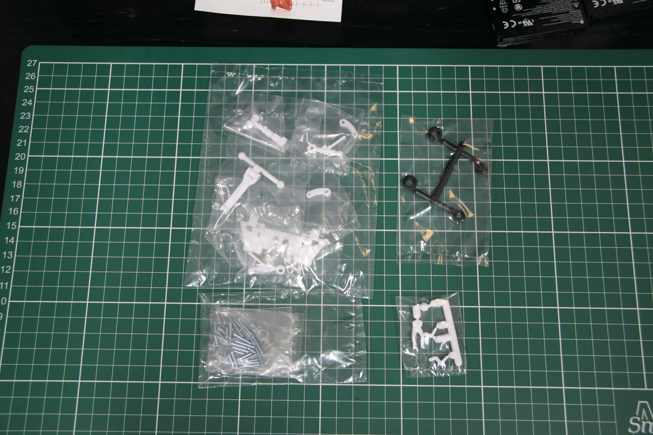

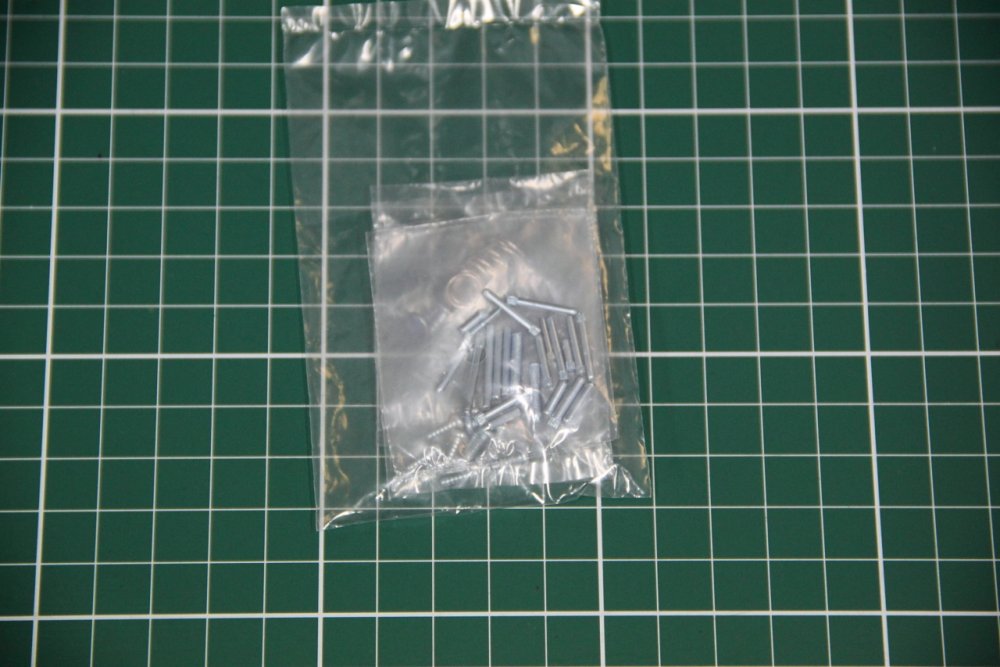

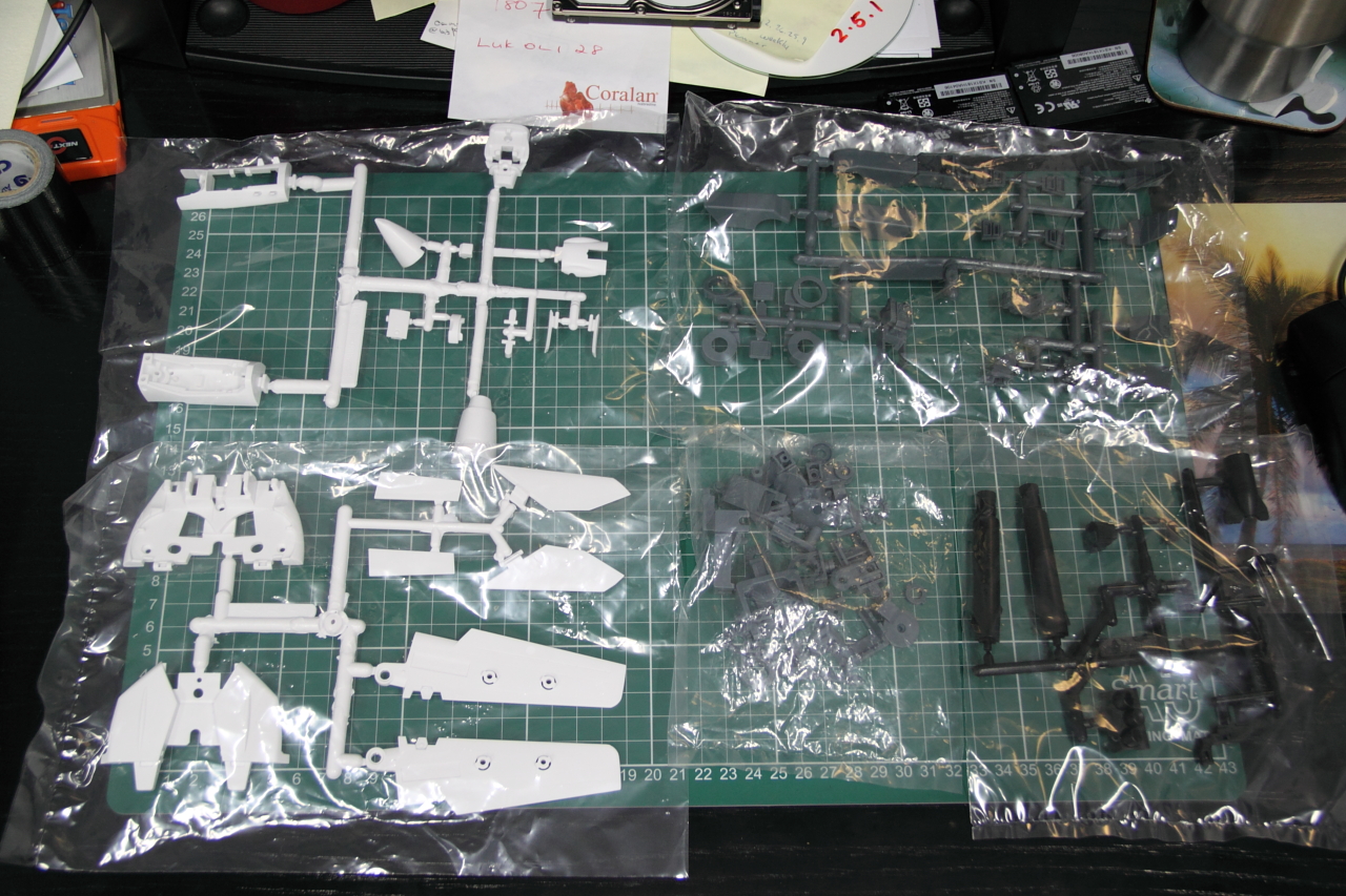

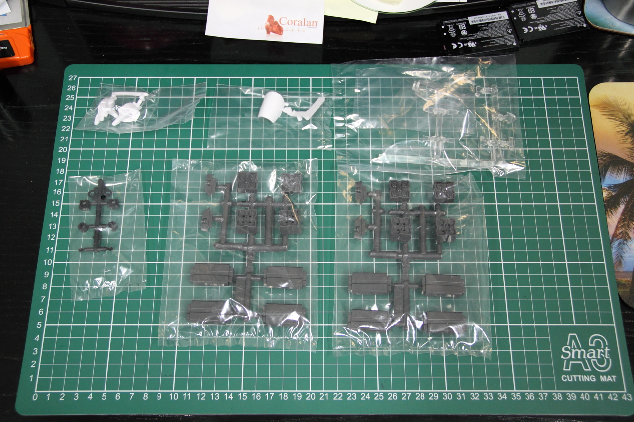

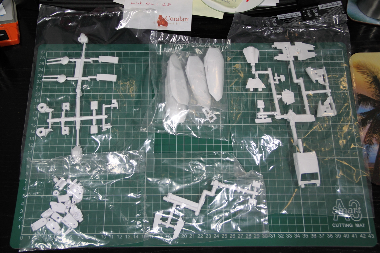

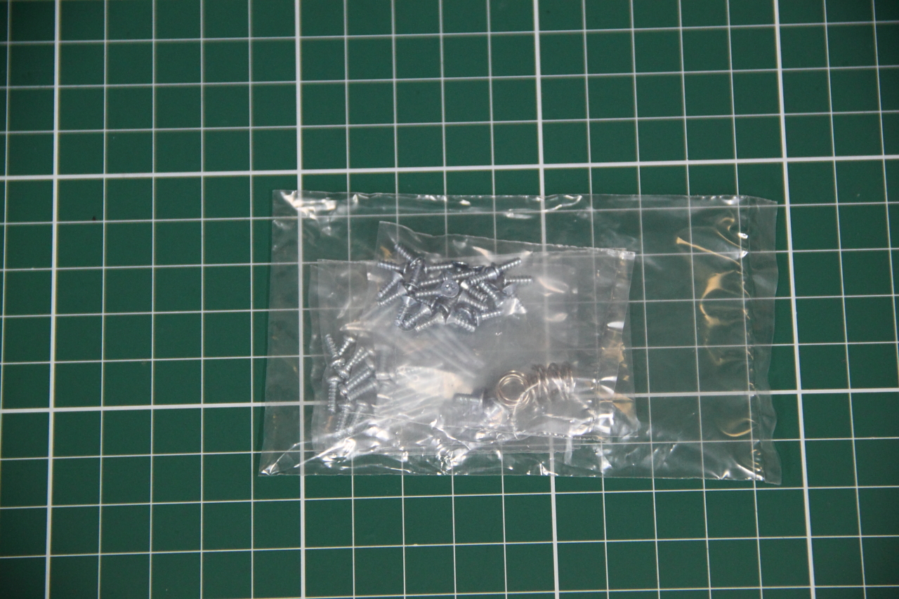

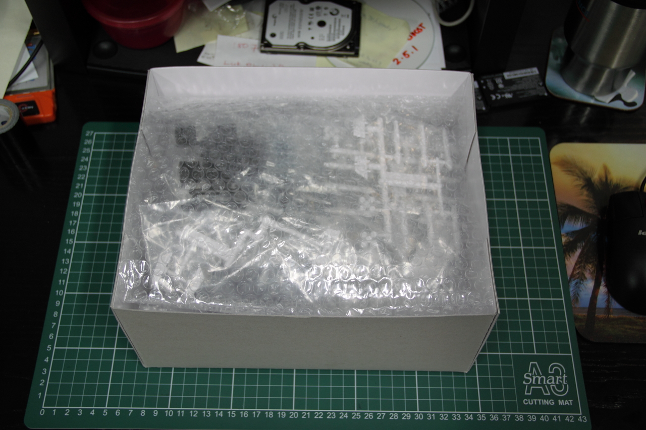

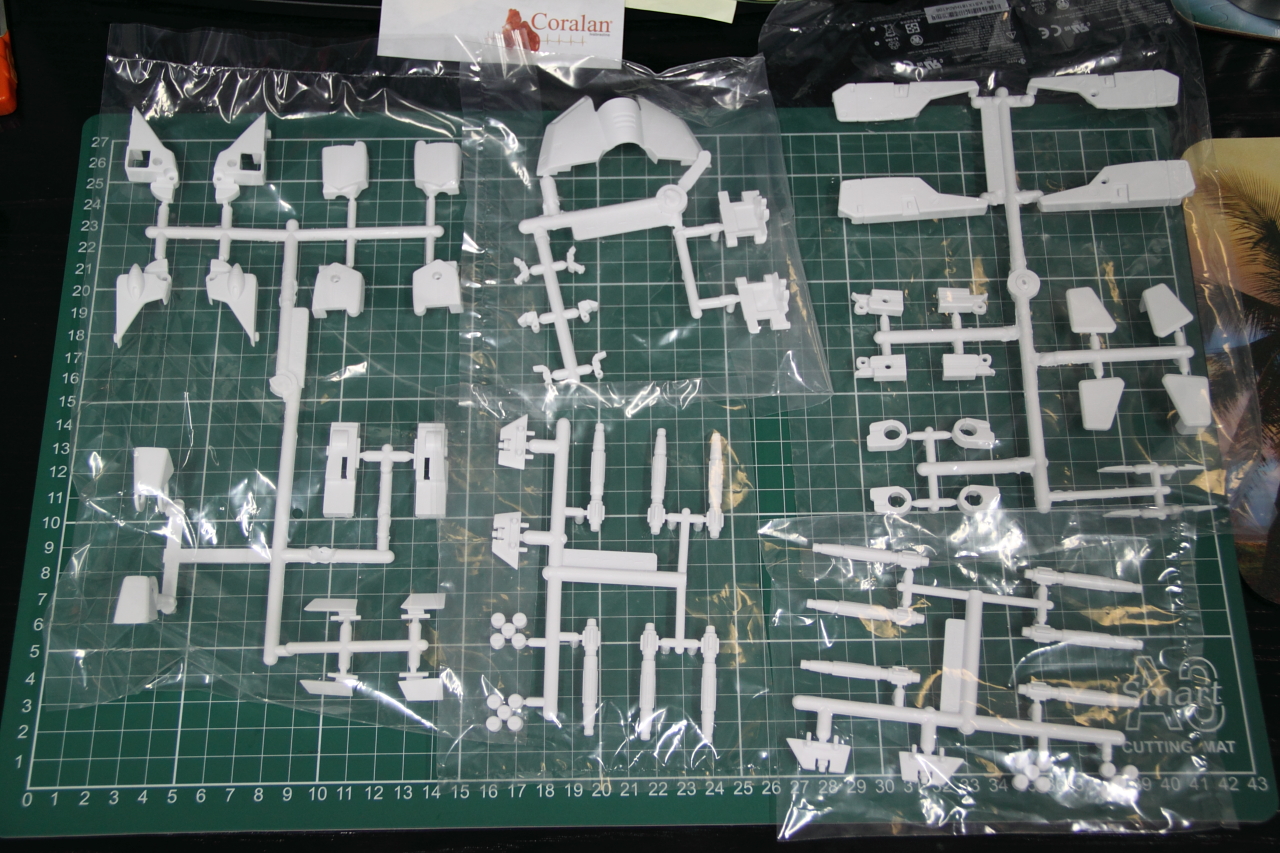

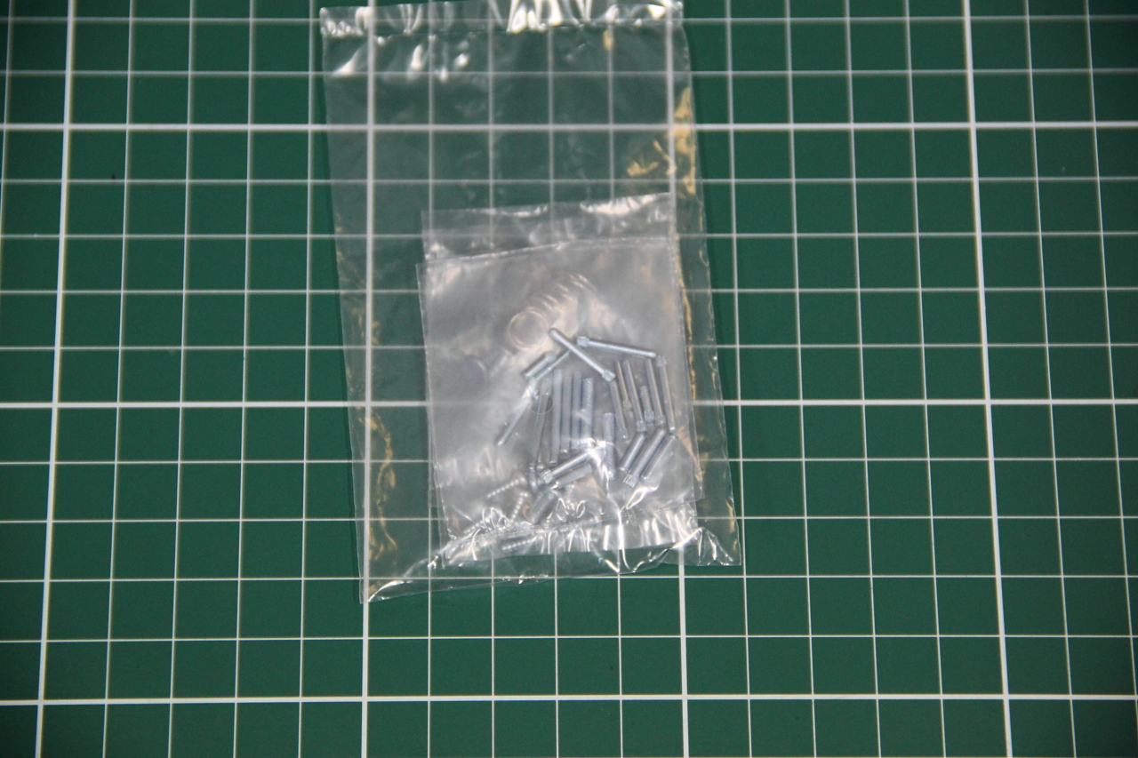

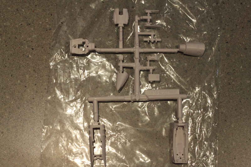

Pics 1, 2 - Unboxing (sort of - I'd already taken stuff out prior to the photos so the arrangement of the markings and instructions probably isn't right)
Pics 3, 4 - Decals, stickers and two instructions - one for assembly, and a standard valk transformation guide. The blue sheets are the decals. As you can see, I didn't get stickers for the smaller sheet. I'm not sure if this is a mistake in packaging or if that's just the way it is. I'm not too concerned as I'd planned on using the decals anyway. Not really visible in the pics, but the instrument panel is DYRL style. So again, it's not clear if this is meant to be a TV or DYRL style Valk.
Pic 5 - everything is packed in layers and then bubble wrap around it all. Not over the top packaging but certainly adequate. I only found a few parts that had come off the sprue but nothing broken.

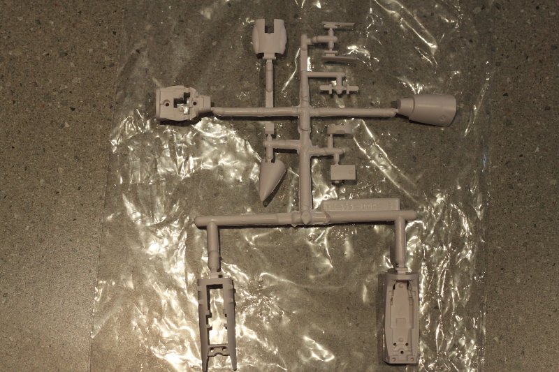

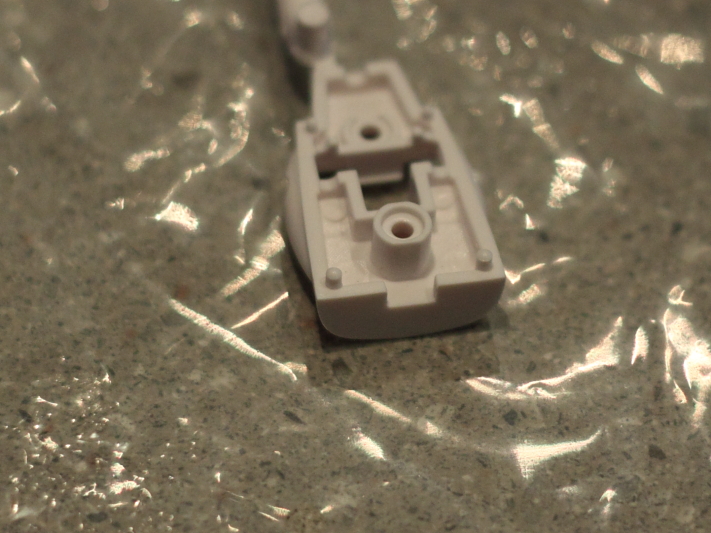

Pics 6-12 - all the individual bags. Not sure if you can make it out but in pic 9, look at the bottom left bag: these are the parts that are a bit purple hued. Like it's a different grade of plastic. I'll be painting the whole thing so I'm not terribly concerned but if you were going for a standard white scheme, this could look a bit off. The screws and pins bag shows all the little parts and my previous comment about screws doesn't seem to be so bad after all - looks like they're all one type of screw except for one exception.
Pic 13 - just playing with my new lens! ;)

OK, scratch that. I started on the intakes (top of the thigh). The parts are very sturdy and very cleverly designed. I've never liked the "turbine blades are outragiously close to the intake opening" comprimise of any of the valks out there, but there's just no other way to do it. You couldn't move them back even if you wanted to. There's just too much reinforcement in the area behind the turbine plate. And once you put the ratcheting mechanism together, you can understand why. Sorry, no pics today. Will get some soon though and post what I'm talking about.
I didn't finish the upper thigh because it calls for a pin. I can't read which type though and there are many to choose from. Is it knurled, straight, taper ended, rough? I don't know. All it shows is 11mm. Perhaps there's only one that length. Also, there are two types of screws in the kit but I don't know which is which. The CG instructions seem to show both used interchangeably with the Japanese for either type. Again, I'll take some pics to explain what I mean.

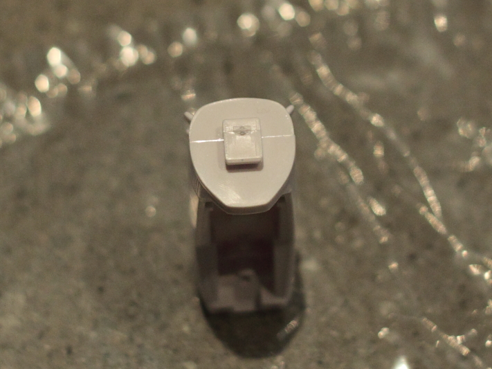

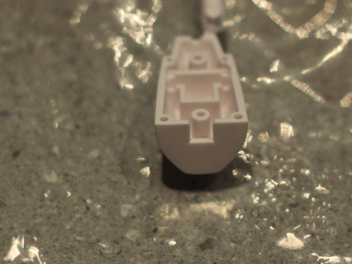

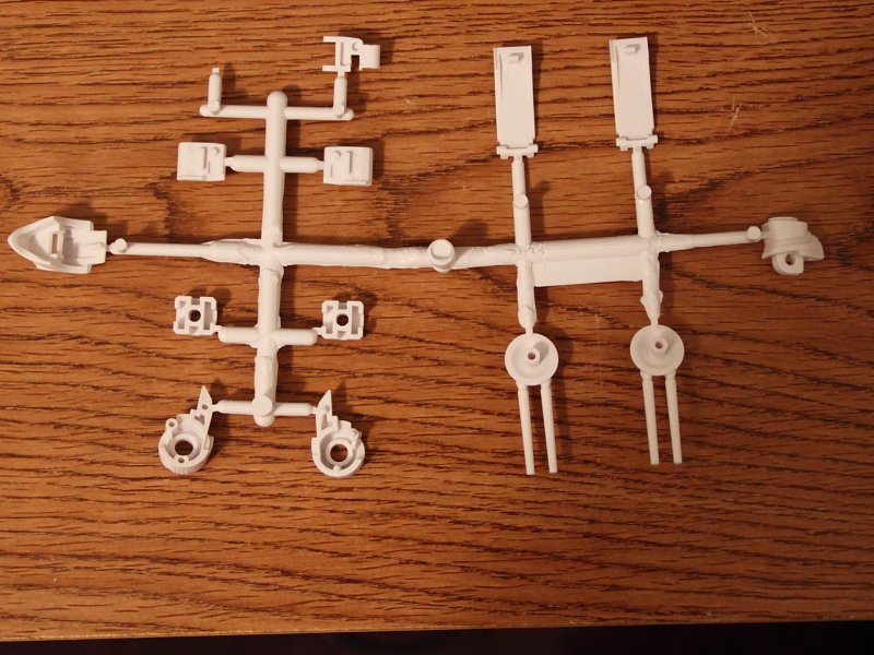

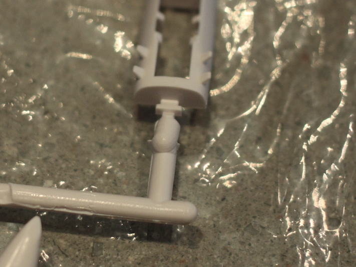

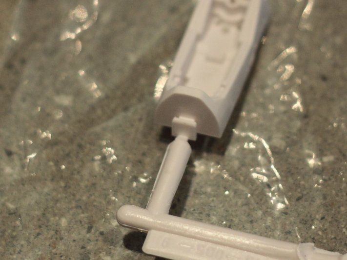

Here you go Lechuck.
post-10360-1272764556_thumb.jpg post-10360-1272764724_thumb.jpg post-10360-1272764745_thumb.jpg
post-10360-1272764762_thumb.jpg post-10360-1272764871_thumb.jpg post-10360-1272764887_thumb.jpg
Sorry about the focus (not sure why but everything was focusing closer to me than what it should have) and the less than perfect lighting. The white looks pink and it's not quite that bad in real life (even after I corrected my white balance).
Anyway, the hip joint/swivel is technically possible with this setup. But you'd have to replace that box setup with a cylinder one. I'm not sure how you'd get the pieces to do it and a metal one would be much better/more durable than the ABS. I thought of just rounding the edges of the plastic but I don't think there's enough material to allow for that.
Hope that helps!
By the way, these parts all fit very tightly. I think glue is not completely necessary for any of these sections.

Thanks for the pics MickyG.
The square fit for the two parts is a bit of surprise.
I think I could get the the square plate rounded, but the leading stem looks so short that there is hardly any room to work with.
Nah, I don't think I'll touch it. Otherwise it will just end in a botch job.
But it baffles me why Yamato omitted the waist joint, when it was working perfectly for the 1/48's?

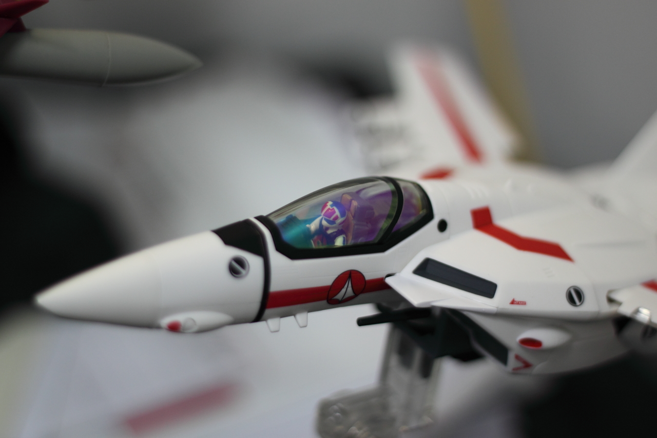

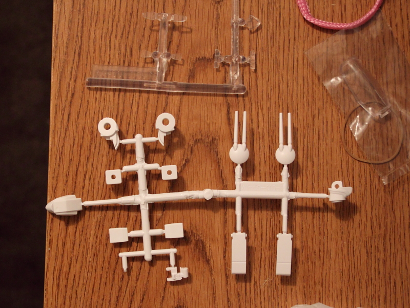

For Valhary:
These are resized WAY down so if you need more detail of any individual part, let me know and I can crop just that section out, but blown up.
I've included the clear parts to show the visor. No green molded clear plastic here.

I assume it was left untinted so people could go wild with their customs.
IIRC, the visors were never molded in color, they were always tinted in green. From the various 1/48 heads I've disassembled on three seperate occasions I was able to remove the green tint using "Simple Green" or paint remover for plastics.
