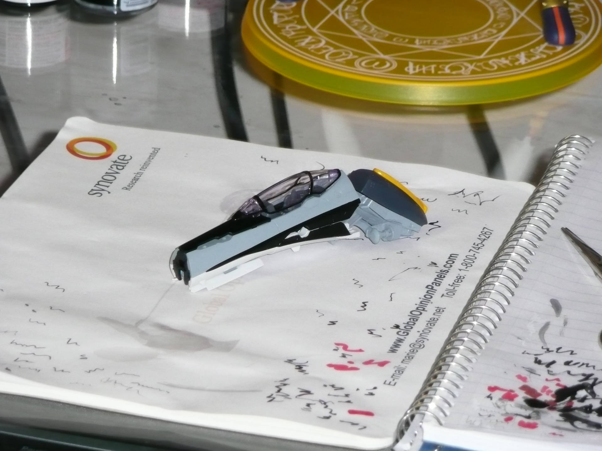

Update of sorts. I'm almost finished with the painting on the gun. There's the green to do, the lighter grey on the accents (clip, the "pump" on the front, etc...) and the red "lights" if that's what they are on the back of the gun. So nearly there! Of course, I'll then need to clearcoat it, black oil wash it, maybe a flat or semi-gloss clear on that (haven't decided on flat or semi) then the red the lights. If I do the red first, I'll need to mask it off to prevent them from losing their gloss. I haven't decided about weathering yet. I think on a part this dark, it might not be noticeable. Although there's plenty of opportunity for dry brushing - something I've never tried before.
Any tips for this particular piece? I was thinking the inner workings of the scope could use some sort of dry brush highlighting maybe? Difficult for me to say, because this stuff is all so small and I'm a complete newb!
Pics:
These first two show the tiny strips of tamiya masking I cut out with a hobby knife and a ruler. I guess they would have been about 1mm wide, as the tape is 6mm. 6mm is a pretty versatile size, in my opinion (plus it was the smallest HLJ had in stock when I ordered it!). I put down some future over it to prevent paint from seeping under - this wouldn't have been necessary had I airbrushed it but I was concerned that the thin hand brushing would just allow the paint to seep under. It worked, but as you'll see in some other photos, the darker and lighter grey is so subtle that I wonder if it was even worth the effort! I'm hoping a final semi-gloss or flat clearcoat will bring it out a bit more.
Some shots on my E71 camera phone. Not great but they show the rough first stage of the pinky-purple accents and especially the sloppyness of the oval, "eye" markings at the back of the rear tine housings. Yes, highly technical name!
And some taken with the better camera after I'd finished with the scope lens bits, and the final coats of pinky-purple. I used a hobby knife to gently scrape away any excess. This worked well, although it was a bit trickier on the eye markings.

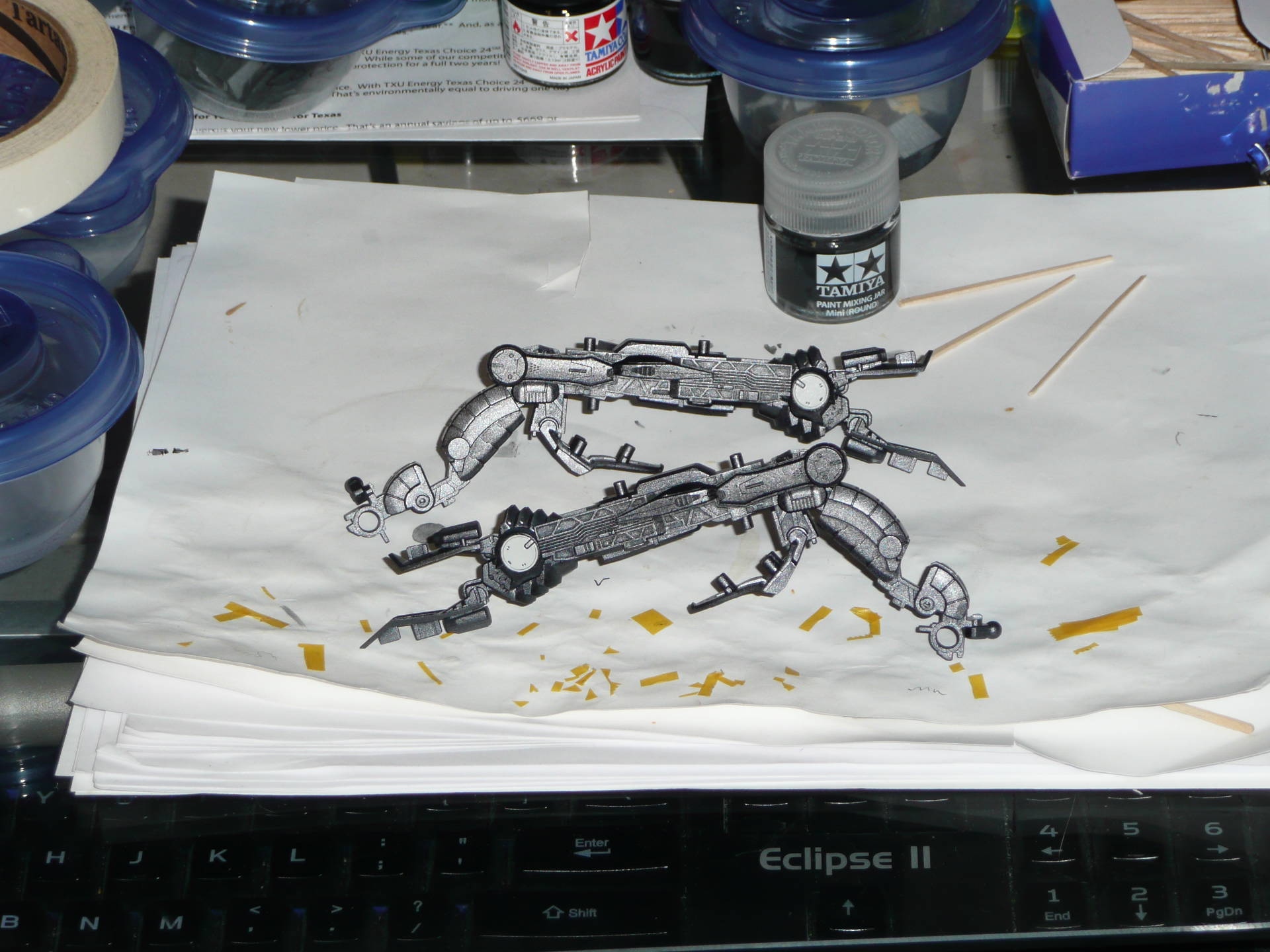

The lighter grey has been done now (sort of). As before, I went with a metallic interpretation of the colours that Bandai shows. So 90% RLM 75 + 10% Violet. I can't see that the Violet does anything at all, but it's in there, just the same. I then add a small amount of steel to the mix, which seems to darken the colour just slightly but otherwise leaves it about like it was.
I made the mistake of using a really fine brush this time around, the same one I used for the pink details. It didn't go so well. The small brush, the thin-ness of gloss paints (RLM is semi-gloss, violet is gloss and steel is probably semi as well) and the rapid drying time all conspired against me. In the end, I ended up with a finish that I might have to either sand a bit or just strip it and start again.
The Tools (just got the mat today - the black one for home, and now this one I can leave at work):
Some shots of the new grey. It's not terrible from a distance but won't look great unless I fix it.

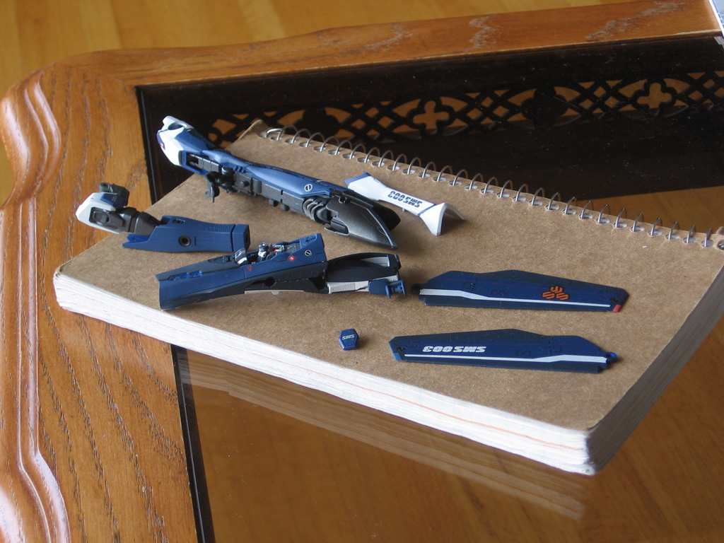

I haven't had a lot of time to work on mine either, but I I think I've deviated ever further from the plain blue standard design.
I've painted the rear leg vents black, along with the vents in front of those. Painted the white stripe and the rear hexagons. Masked and painted the kneecaps, the inner arm details and the outer body trim. Its a little strange to do the outside trim as a darker blue, but I hope it'll work. I guess I'll see in the end. A lighter blue (than the standard body blue) seemed a little off to me, and didn't go well with the wing decals.
Oh yea, the standard blue was gloss coated. Thats why it looks so shiny in the photos. I gloss coated them because when masking over them without the coat, the paint had a tendency to peel a bit. Thats what I get for not using a primer. I'll still have to gloss coat everything again before applying decals, but I'm still a ways off from that step. I'll need to matte coat yet again at the end... I've lost track of how many coats I've done now.
Next in the things to do is to attempt to put tiny rivet depressions in the panels... However, considering that I've already painted it, it may be a bad idea. The rivet indents cause the plastic around it to bulge upwards, which is usually sanded down again before the paint process begins. If it proves to be too troublesome, I will probably just skip riveting and proceed with the gloss coats. I'll have to save the rivets for my VF-25S armored kit... Which is really what all of this experience is leading to anyway.

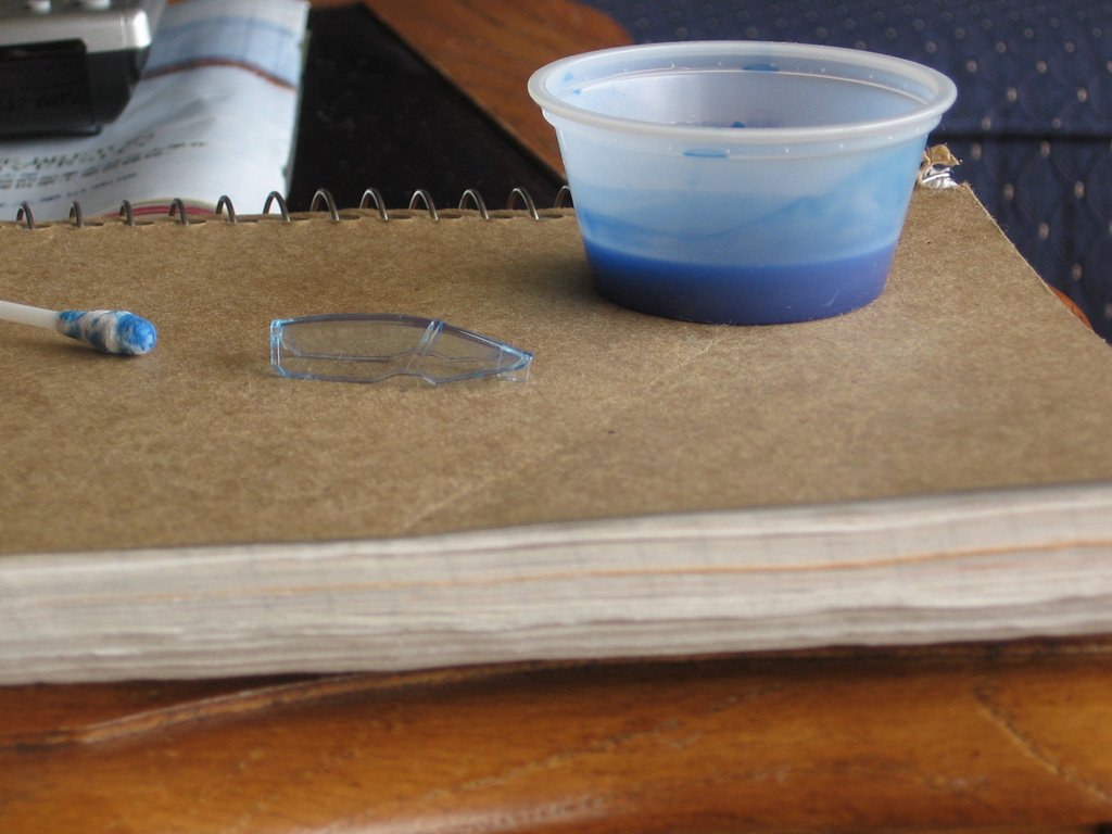

Not to steal thunder from your 25G but I figured I'd share some of my experiences. I'm working on my Armored 25S currently, though a 25G with Super Packs is next on my list.

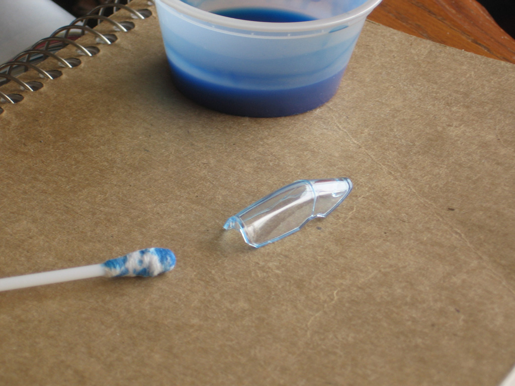

After seeing wm cheng and your metal finishes, I decided to try that. I used Tamiya Gunmetal and then did a simply acrylic wash (my first attempt at washing) before covering it in a semi-gloss clear coat. Came out okay, though I definitely need to work on my washing technique. I kind of made a mess of things and ended up spending a good deal of time cleaning it up and the recesses aren't quite as dark as I would've liked. Ignore the electric bill I left lying around. :rolleyes:
Switching to an oil wash after this; picked up some oil paint and turpenoid to try it out later. Acrylic paint dries far too thin and "powdery" for my taste and I end up having to lay on more wash to compensate.
I also revised my canopy tint technique... well, more accurately, I threw mine out the window and adoped wm cheng's instead. :lol:
I remember you saying the Aussie equivalent of Future sucked and messed up the canopy finish. Have you tried Tamiya clear? From my experience it works just as well as Future, but it does dry quicker, meaning you have to be a bit more on the ball about wicking off the excess (i.e. not slow and clumsy like me) before it starts to dry and become sticky.

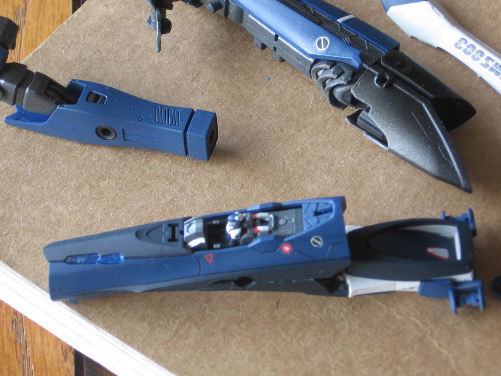

Some progress pics of the freshly painted (the green parts) gun. Apologies for the lousy pics. I borrowed an old fujifilm 2mp camera. They're clear but the colours are terrible! I've adjusted them to give a better idea of the colours but they're probably a bit too blue still.
First with flash, the rest without.

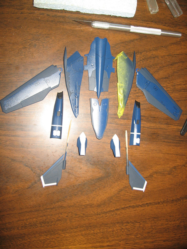

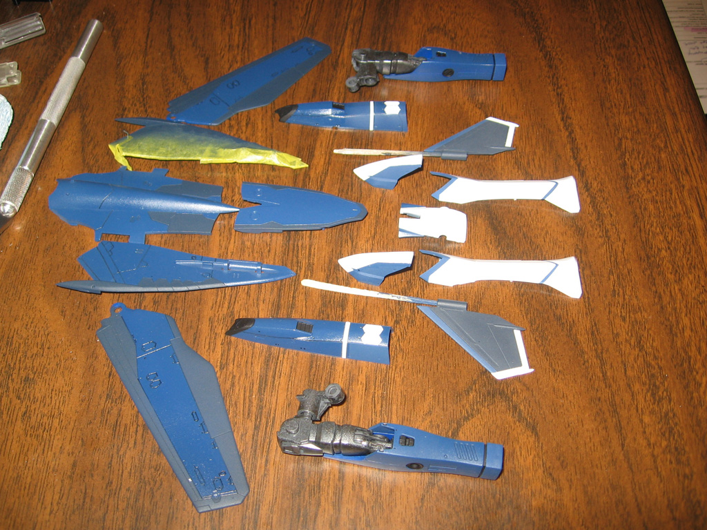

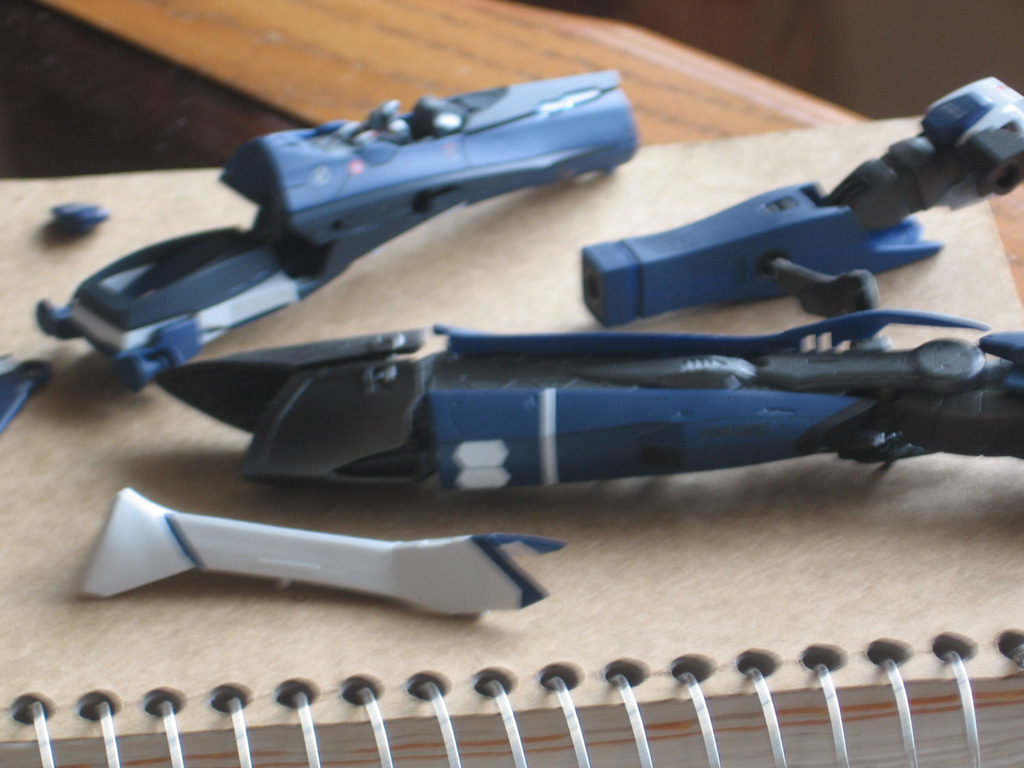

So that was the bad news. The good news is that I had a win with the blue paint and majority of the blue parts (not that I lost on the rest of the blue parts, just didn't paint them :p). I got the tail fins and the stripe on the shins done, plus painted all the other big parts, to cover any plastic swirl marks or sanding marks. I'm still amazed at how spot on the colour guide is for matching the plastic. It was hard to tell where I'd painted, in fact.
Masking these areas was tedious. I tried a few approaches and finally settled on using the panel lines as a guide to cut the tape, after it was applied. So you line up the flat side with a feature on the part that doesn't need cutting, then cut against the panel line on the other side of the tape. It worked really well.
All the parts painted. I used blutac to hold everything down and a bit of it to mask areas off on the cockpit top as well. Versatile stuff! And who knew a huggies box would come in so handy!
post-10360-1249862936_thumb.jpg post-10360-1249862947_thumb.jpg post-10360-1249862992_thumb.jpg post-10360-1249863005_thumb.jpg

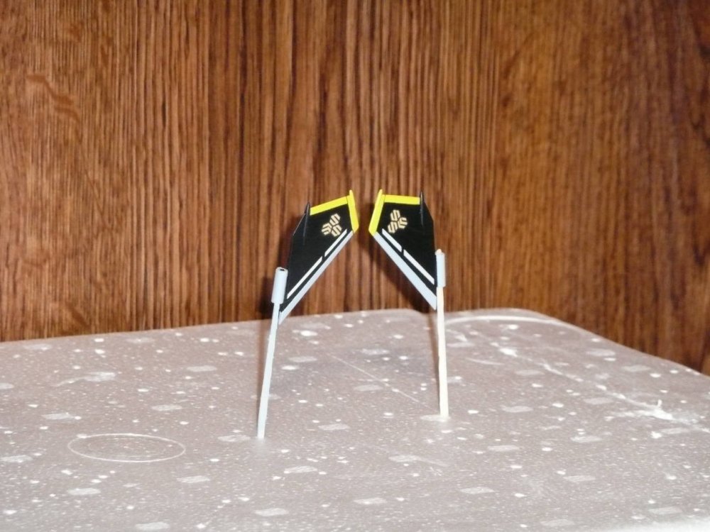

Wow. Funny you mention that Testors Lacquer Dullcote. I used that on my VF-25F, and only lightly! Ended up with a bunch of watermarks and speckling just like yours. It wasn't that bad, since all the white on my VF-25F was unpainted, but even so.. I've had bad experiences with that spray, but I don't know why that happens either. I've heard that putting lacquer or enamels over top of acrylics is a bad idea, but at the same time, I've also heard its fine. -_- I'm totally stumped, and I've just decided to stick to mixing Tamiya Flat with Future for my matte coats. Even Createx Matte coats work poorly (too glossy).

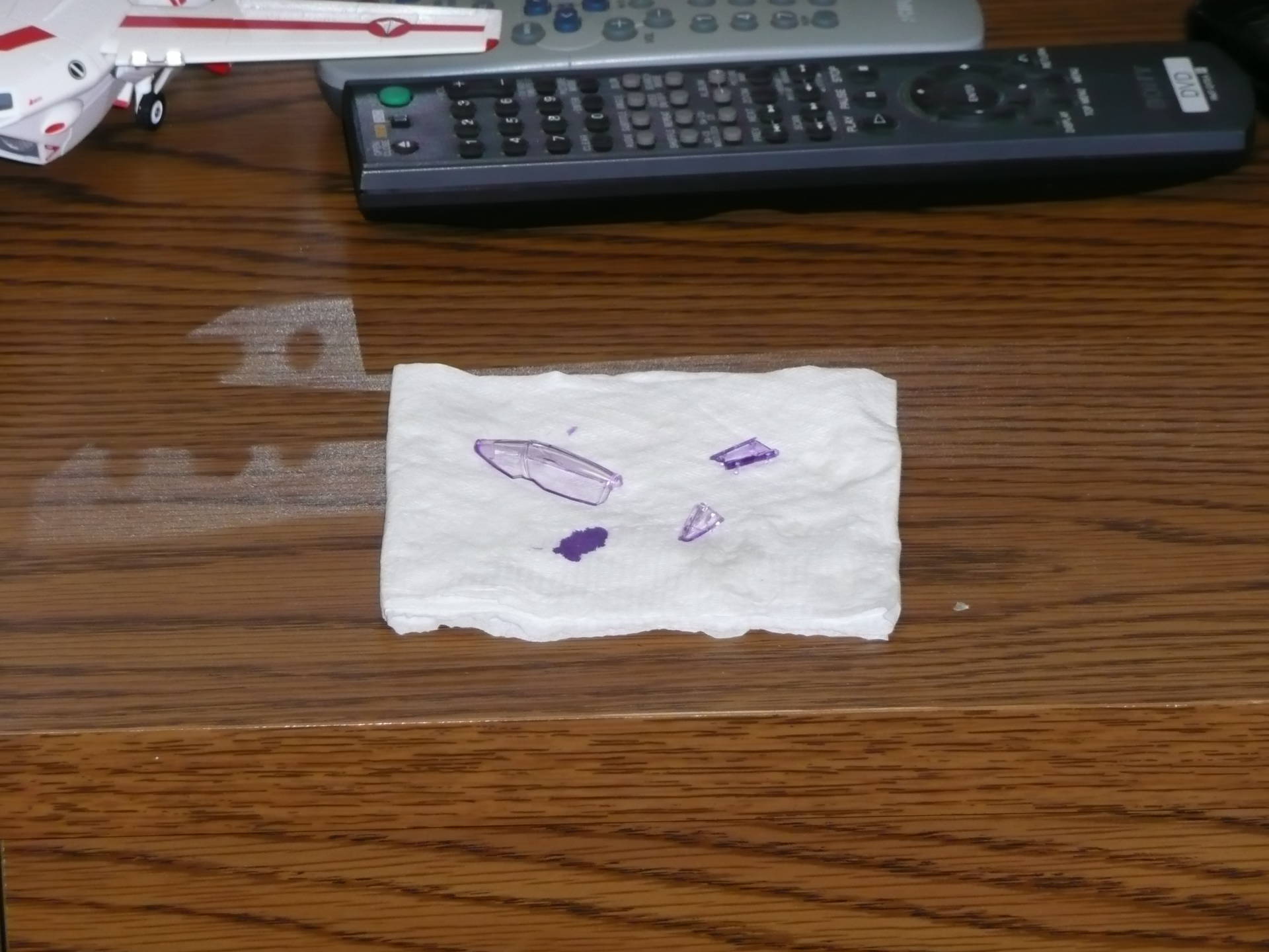

Oh btw, I was using Acrylic Tamiya Clear Blue for my canopy. When I tried to mix that with future to tone down the blue, I got this stringy mess. For some reason Clear Blue does NOT mix well with Future. It was almost the same as when I tried to water down decanted Tamiya Airsprays. Also disaster. In the end, I had to dilute the Clear Blue with Tamiya Clear and a bit of water. Having too much clear makes it really thick, yet having too much water has the blue solution just not stick at all to the canopy, so a good balance had to be achieved.
Also, the decals are a pain in the ass. The rear foot cover decals (the horseshoe foot cover with the white decal stripe) are terrible. You can barely get them in place without having them wrinkle left and right. I don't even think they follow the curvature correctly, resulting in the wrinkles. The front decals fit perfectly though >_>. I was seriously contemplating just painting these decals on. Bandai also has huge decal borders, often oversizing the decal, or giving it contour issues. I think I'd have been seriously screwed without some decal softener. I'm working on the underwing edges right now, painting the white stripe and the red/blue light decals instead of using the provided waterslides.
Below, I masked and airbrushed the hexagonal bolts on the wingtips, airbrushed the canopy frame, and painted the remaining inner blue stripe on the vert. stabs. Pic qual sucks though.

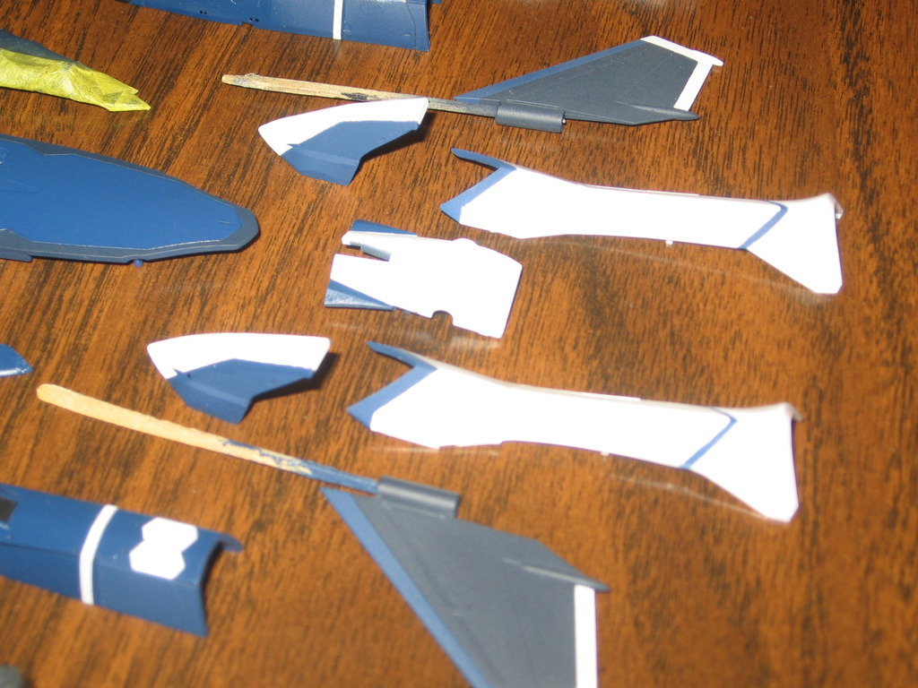

Looks great! Did you use the decals for the white parts of the stabs or is that paint? Either way, it looks really good. I figure I'll paint mine but am a touch worried the white won't match. I'm thinking the little hinge pieces under the nose (the ones cast in blue for some unknown reason) are going to be a pain to colour match. I'm going the lazy route for the white parts and will just clearcoat the white plastic. But for areas that should be white and are cast in another colour, I'm going to have to do something that will match. The colour callout sheet lists white with a hint of gull grey. I'll try that on some white sprue to see how it looks. The hinge parts I mentioned are ABS (I think) and will likely need a primer first (will use mr surfacer 1000 white, airbrushed on). If I'm lucky, maybe that'll match, but I doubt it.
I'm not sure I follow exactly. I thought my dull cote was OK, but the gloss one, not so much. I do wonder if the gloss overcoat reacted with the dull though. Perhaps it hadn't fully cured yet? Mine had sat for 3 days so I figured that would have been sufficient.

I did paint all the colors on the fins, and while it is difficult to color match, I wasn't going to be too worried about it anyway, since I much preferred them to matched decals anyway. However, it worked out well, since the flat white paint matches the white decals very very closely. As for the 2 shades of blue used on the fins, those are matched with the 2 shades of blue present in the body of the plane. Since everything was repainted, everything matches. The only issue then is to paint instead of decal every place where there is a blue decal present. Honestly, that won't be too difficult to do, I'm just wondering if I'm going to be a little lazy or not. If the colors don't match well at that point, then I will just paint it, and color wont be a problem at all.

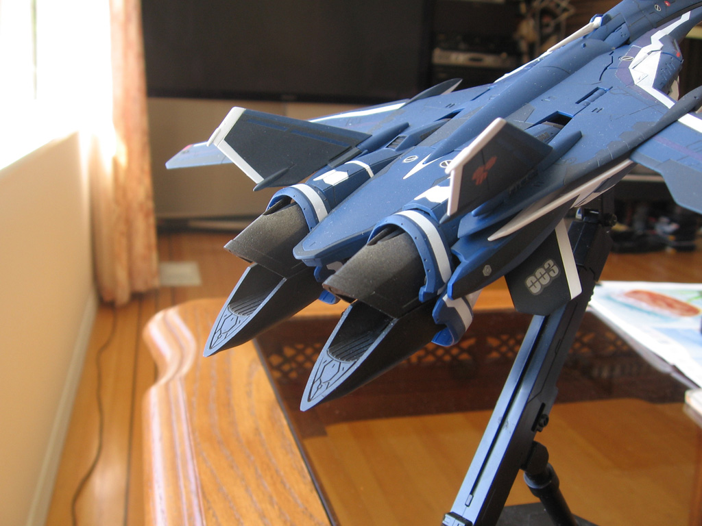

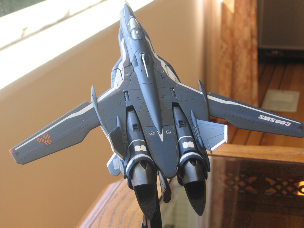

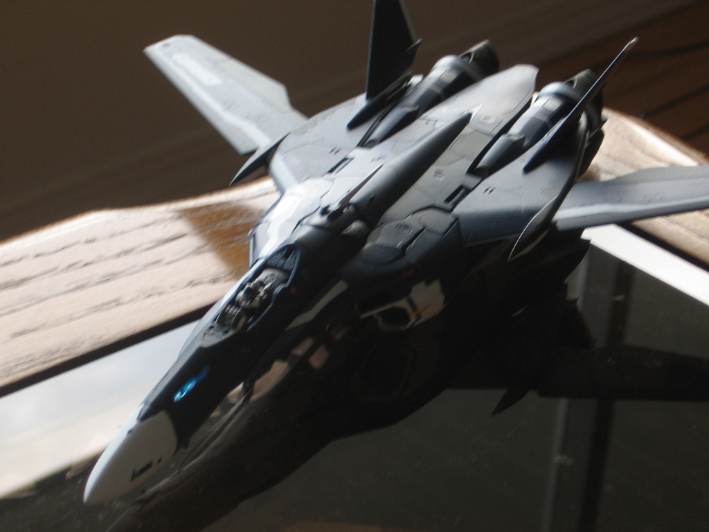

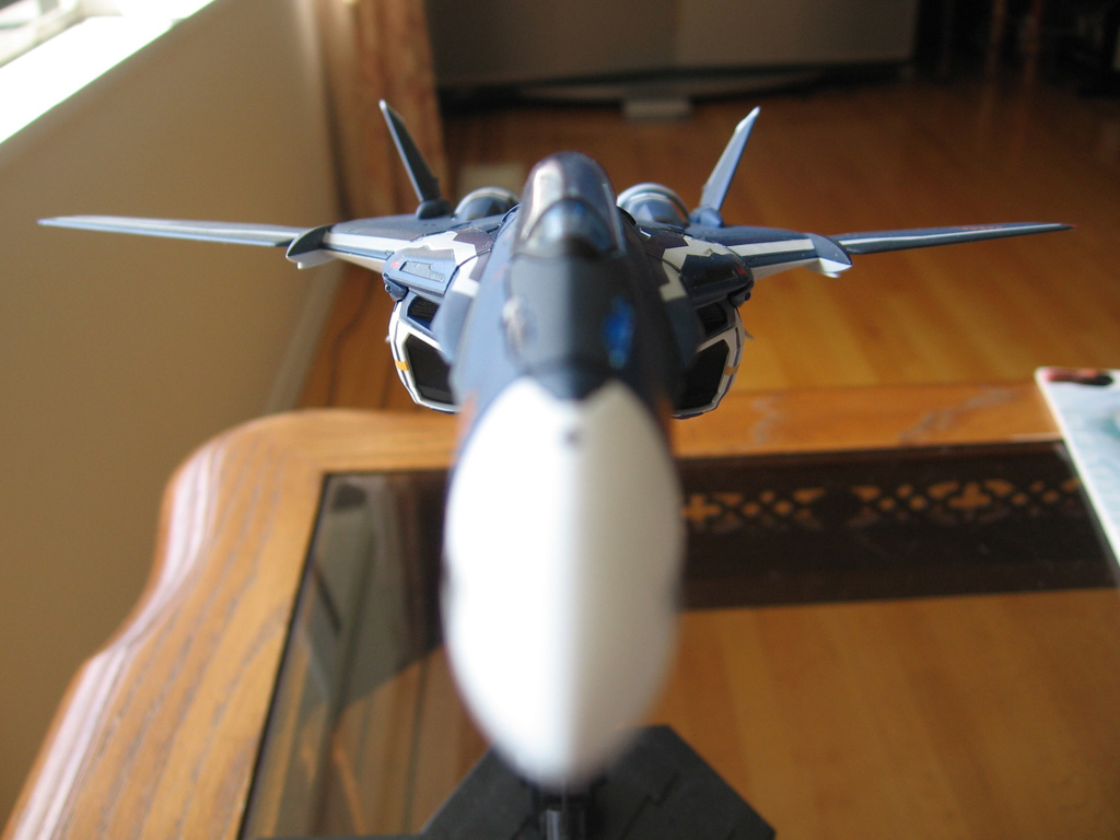

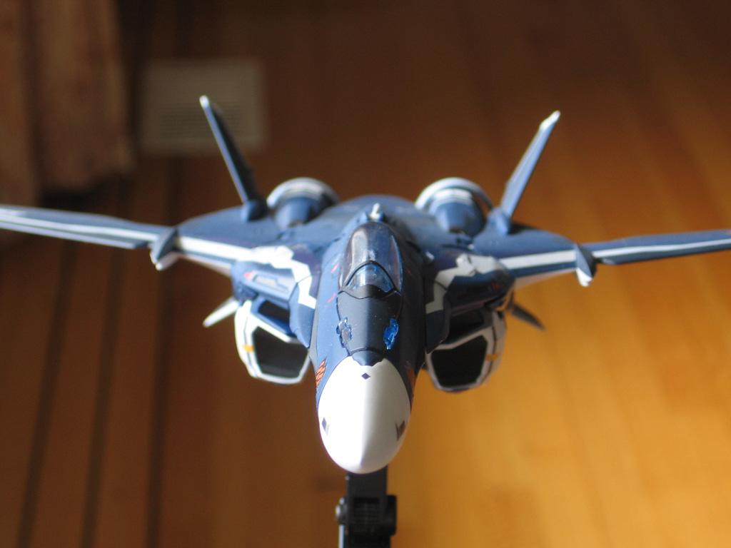

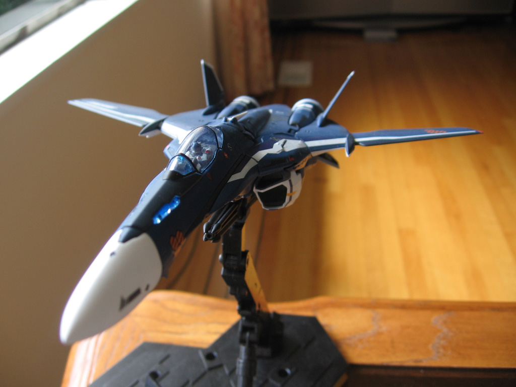

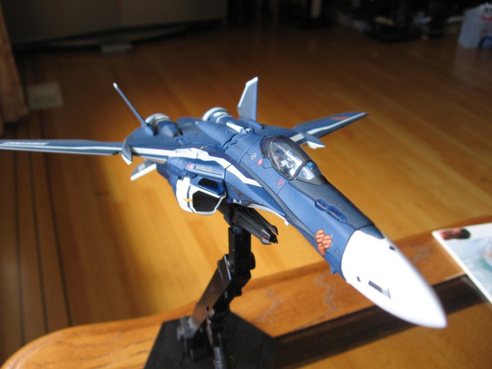

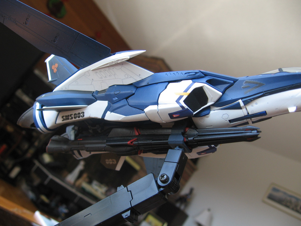

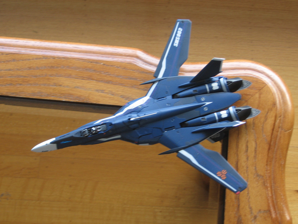

Nearing completion. Placing down final individual part matte coats and then I have to finish the decals on the front half of the plane after fitting the pieces together. One regret I have with this kit is that I used a gundam marker near the beginning, and it just looks terrible. =/. I'll be watering down some black acryllic for the panel lines next time.
Painted the red/blue lights on the tips of the wings, and the white stripe on the underside. Partially assembled legs, waiting on some remaining parts to dry. The shoulder hexagonal decals had to be sliced up into tiny triangle pieces, but I got it fitted together pretty well. Excuse the layer of dust >_>
Edited by Cent

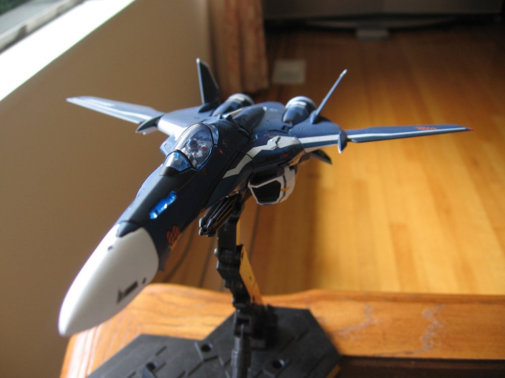

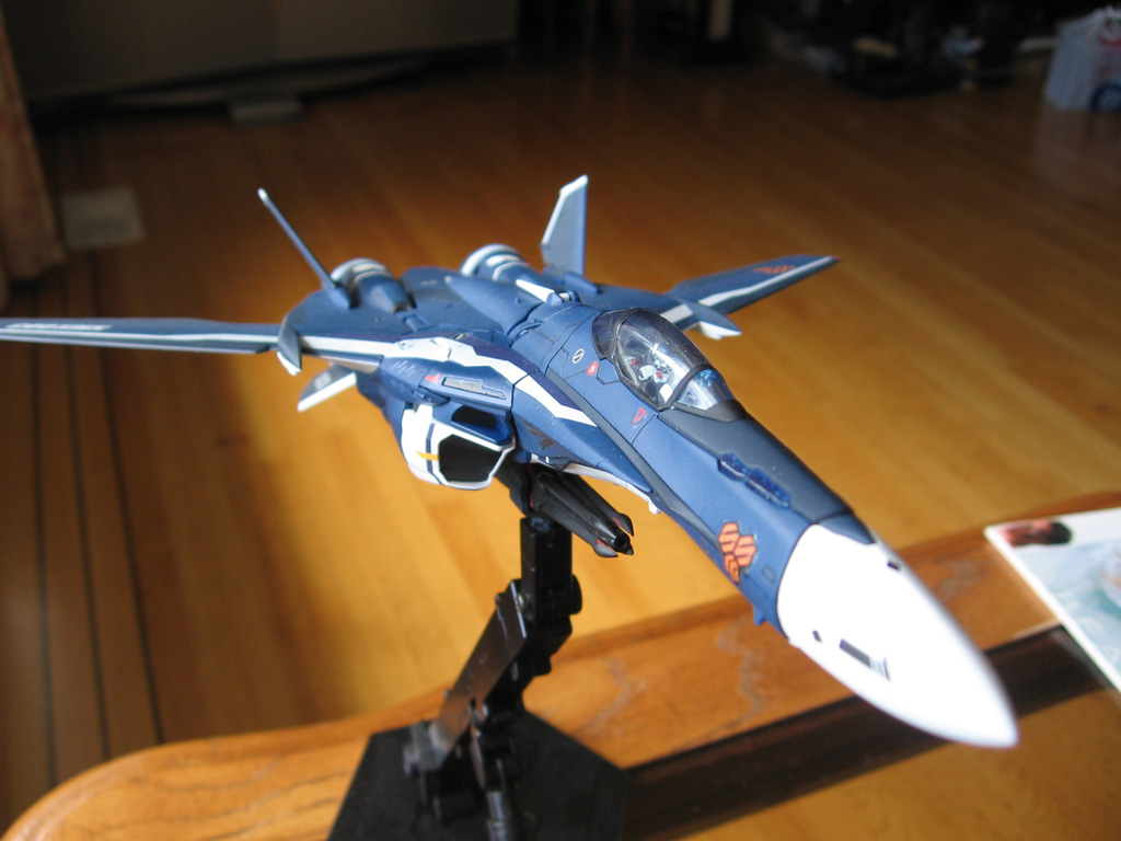

Okay, well I've just got to do the forward red lights on the sides of the fuselage, and to dab in the paint for the vents along the plane. Here's where it is now. Placed it on the provided and hastily-made stand from the armored VF-25S. to take pics. You can see in a few pics that assembly has gotten some of the white paint to rub off onto the blue >_> FML. I'm still thinking of adding weathering... But I usually don't like weathering. So I guess that will have to wait.
