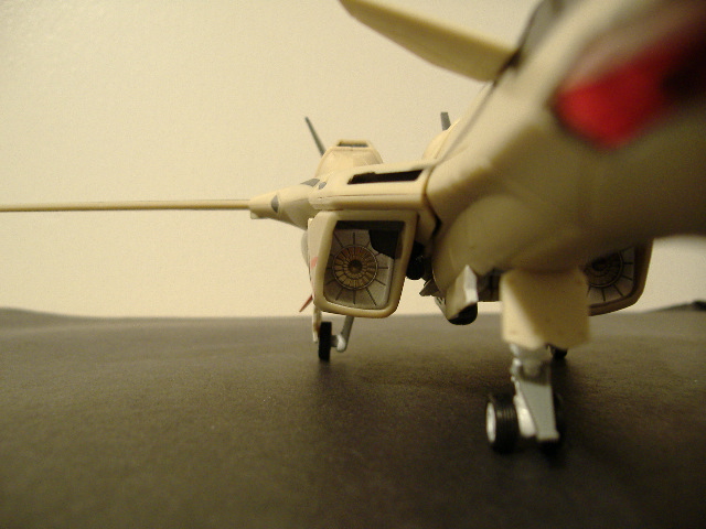

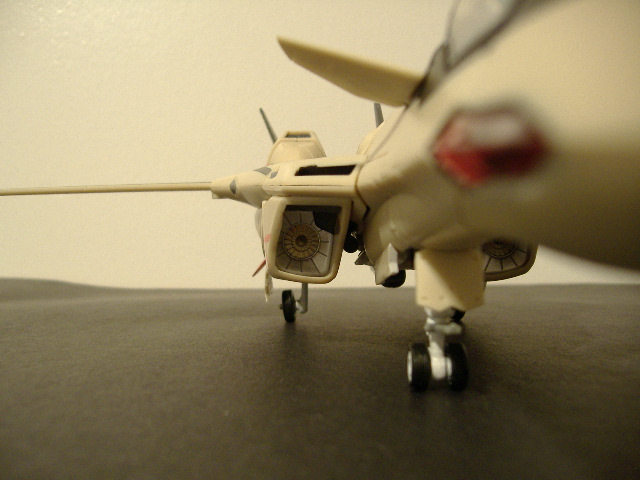

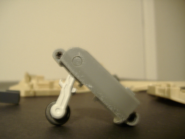

Hopefully anyone who has issues with their YF-19 finds their way to this thread. My issue is with the landing gear. MW member Hayao Kakizaki posted a couple of pics of the problem and fix (see page 11 of Graham's review thread), but here's a step-by-step for those who are put off by tearing into their new, expensive toy. The good news is that fixiing this annoyance is not difficult.
The problem:

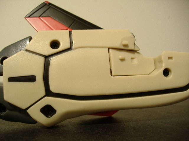

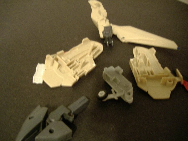

Tear-down: three screws hold the lower leg together. Note: be careful when separating the lower leg halves as there is a peg just forward of the vertical stabilizer (or tail) that can be broken off if you try to rip the halves apart at an angle.
Edited by Wicked Ace

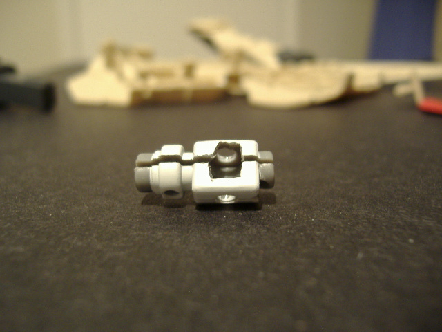

After removing the landing gear bay from the lower leg, the two screws holding the bay together can now be accessed. The part requiring the modification is simply sandwiched around the landing gear strut and can be separated by an exact-o knife fairly easily, as there is no glue to fight with.
Link to comment
Share on other sites

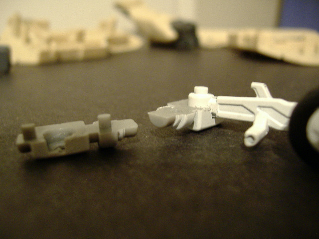

This is the part that requires modification. To put it simply, Yamato did not make the rectangle big enough to allow the strut to lean out to the side. To fix this, make the rectangle bigger -- taking material off, using an exact-o knife, a little at a time. The second picutre shows one half of the part in question with material removed compared to the other half as it came from Yamato.
Note, if you find that you took off too much (the landing gear leans too far over), don't worry, because the wheel axle will make contact with the landing gear door, preventing too much outward movement.

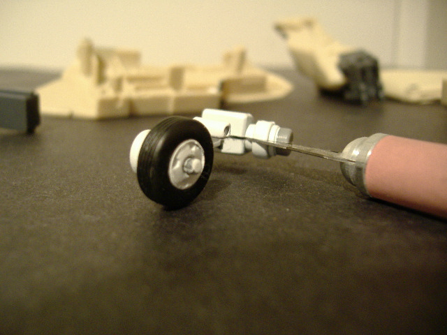

The only problem I could see with modding the landing gear strut without taking apart the leg assembly is the somewhat fragile nature of the strut pivot sandwich. I've attached a pic of member Hayao Kakizaki's fix (using a drill bit). Apparently, the pivot piece has withstood drilling and your hobby knife use, but I am inclined to think that you and Hayao got lucky. As you know, the pivot piece plastic cuts away pretty easily with the hobby knife, which shows how potentially fraile the piece is.
True, correct sized screwdrivers aside :p , taking apart the leg involves risk of breaking the peg mentioned before; however, tightening the screws up firmly on reassembly remedies the gap -- worst case scenario, you use a dab of model glue at the peg. The potential downside to modding the landing gear strut without taking apart the leg is breaking the strut pivot piece, which would be a real nightmare that would involve a lot more than a dab of model glue. Check out the line (or gap) between the halves that sandwich the strut -- I think the sandwich pieces could crumble with use of a drill or long hobby knife (i.e. using a lot of leverage on the part).

On the rear landing gear, all I did was force the rear landing gears outward more and they are fine now. :)
No drilling or anything! So now the only "issue" with my YF-19 is the gunpod and to be honest, it doesn't really bother me enough to even worry with.
