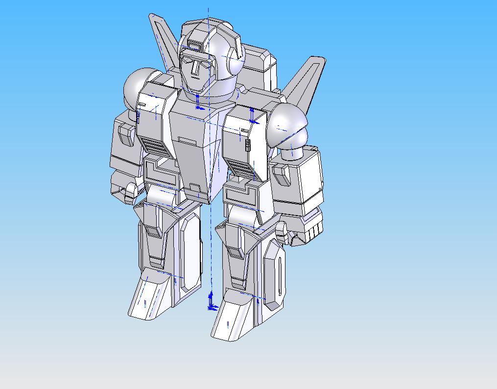

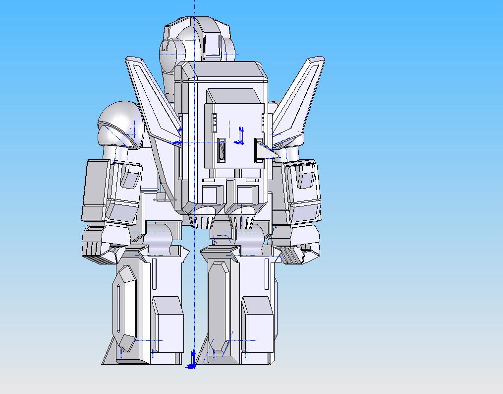

this term we have a rapid prototyping class and the project is robots.
PERFECT!!
i winged my presentation and sold my instructor on the idea to make a transforming skyfire, the whole twist on it would be it was super deformed so i wouldn't be straight copying somebody elses design.
when complete it will be printed out in 3-D with ABS plastic using a FDM (fused deposition modeling) machine.
the due date for a fully painted and detailed model is in 7 weeks.

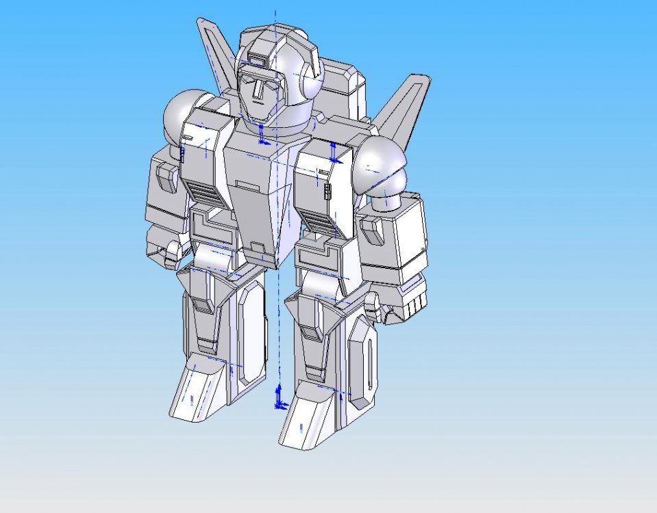

these are the current solidworks files, i still have to do arm and shoulder joints, work on some tolerances and its ready to print!!
the cost for printing is a horrible $11 a cubic inch and i'm going to be setting up a paypal account to accept donations for the printing. on the title page for this class i will be making a "contributors" section with your name/handle but ahhhhhhhhhhhhhhhh have to finish the model first.
my question is if this sort of thing something you all would donate a couple hard earned dollars to? if not i'll try going around to some hobby/toy shops and getting some donations in exchange for some advertising in my presentation/portfolio....the owner of giant robot magazine/shops will be at our final.

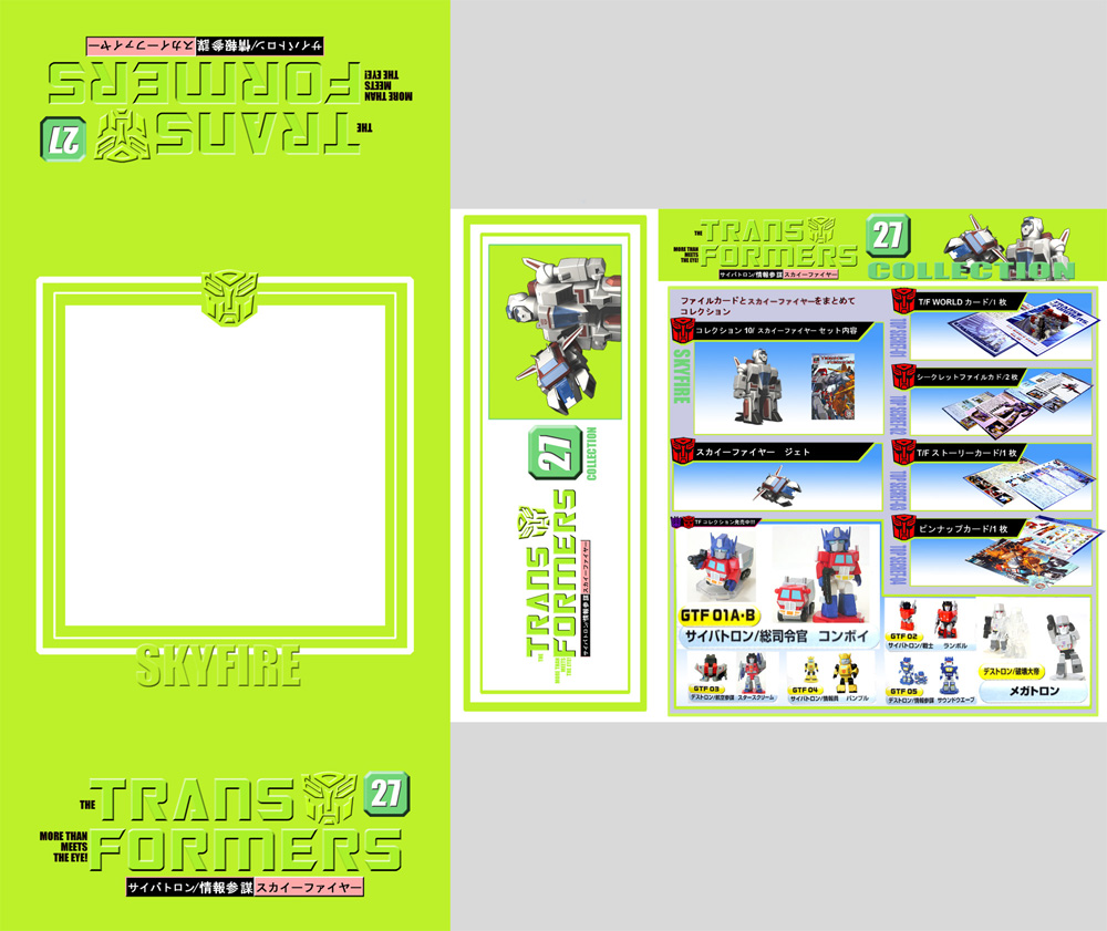

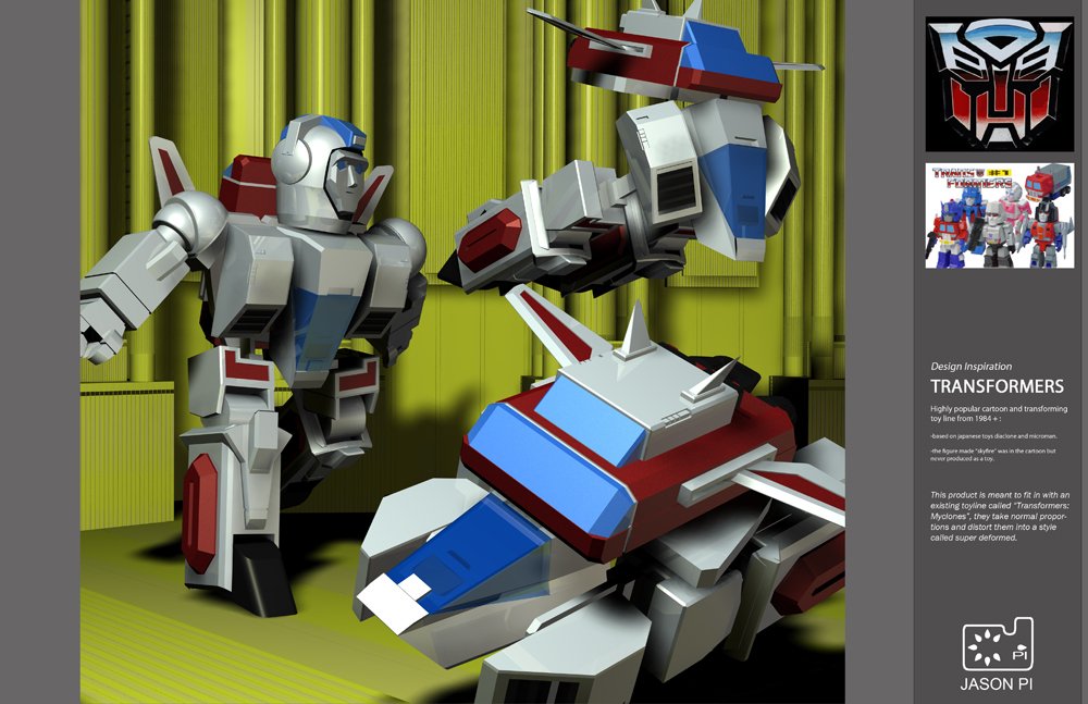

Cool box art KK You do realisee you now may have to SD all of them.

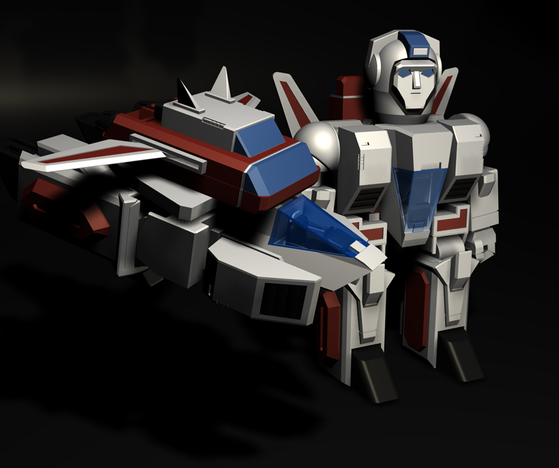

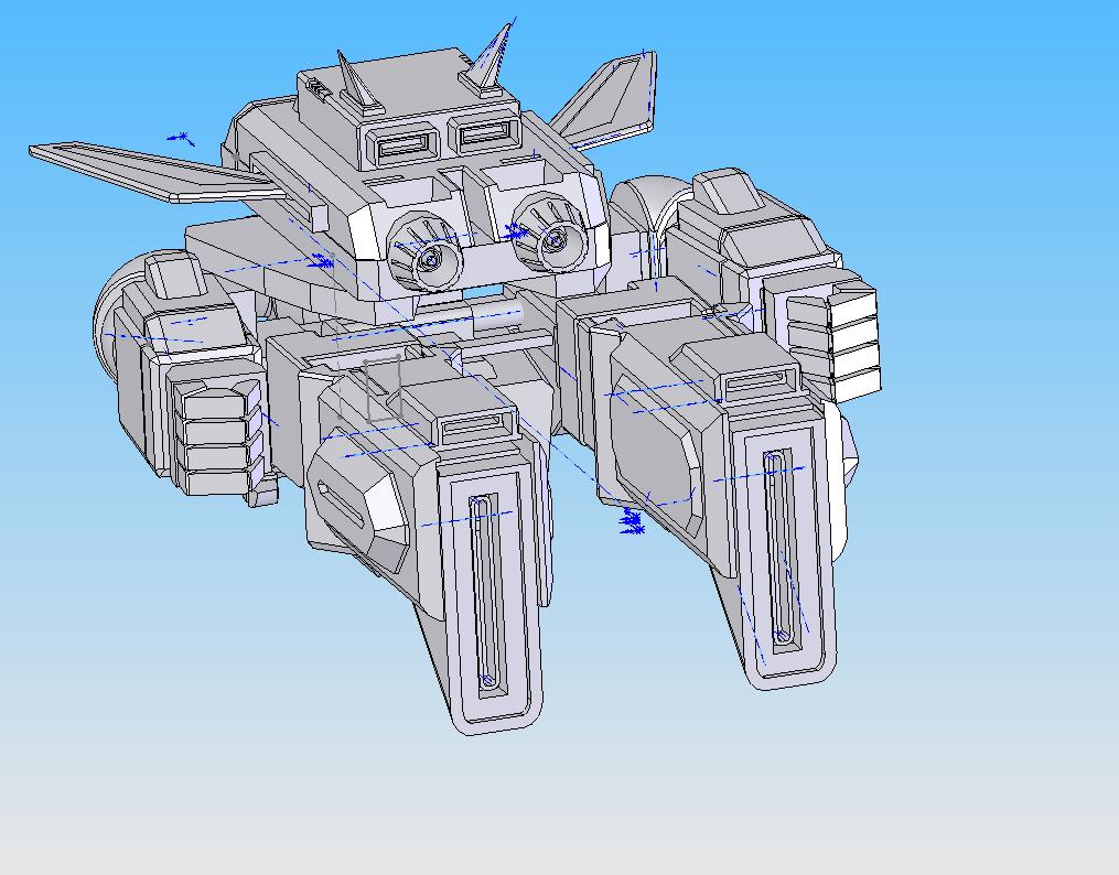

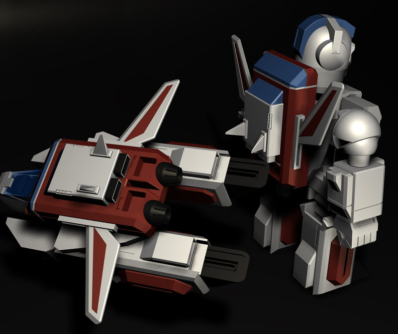

for the jet mode i got as close to the cartoon reference as i could while maintaining the SD look and making it transformable.
today i figured out a way to make the chest intakes face the correct directions in both modes wihtout having to pull them off...but because of the proportions the arms and head have to be removed for jet mode.

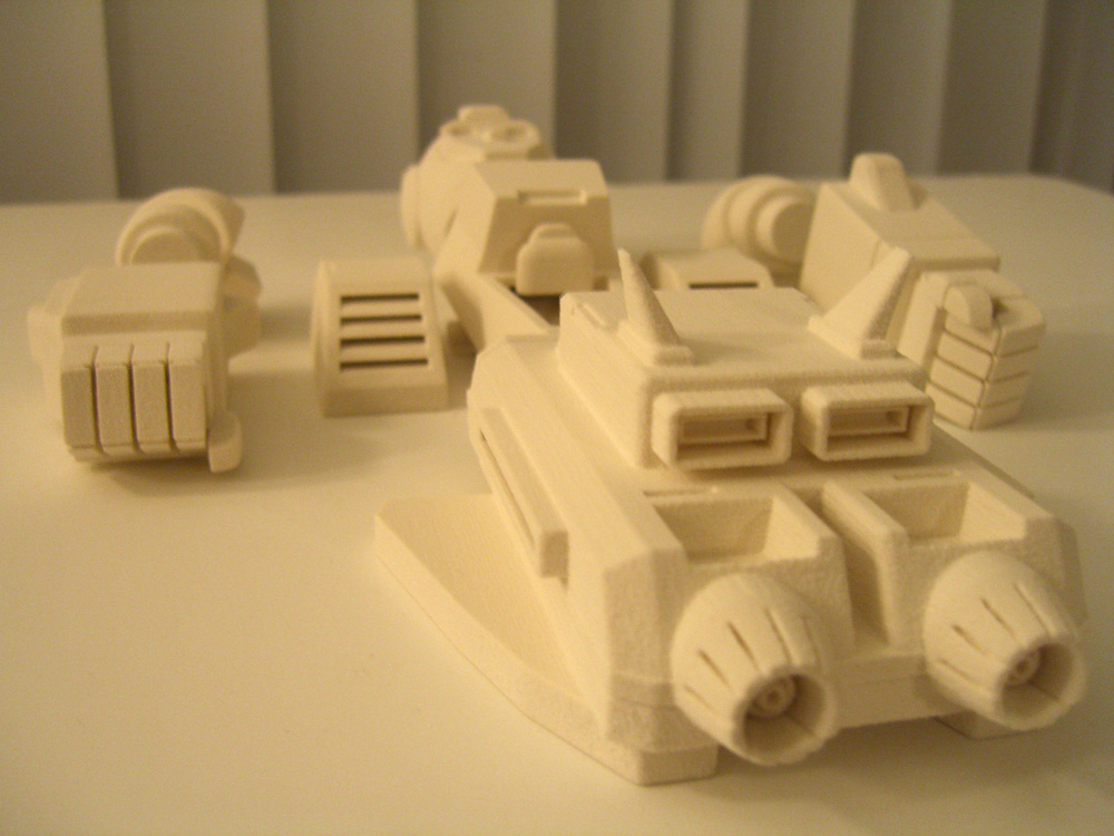

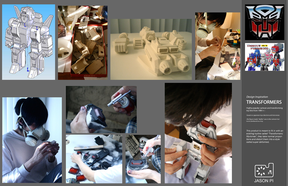

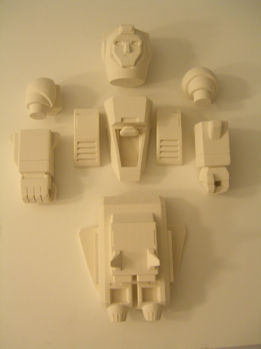

for recasts i don't think anyone would want to pay the $190 bill. thats the price at no profit and it comes out as plaster of paris, very fragile and it IMPLODES when it comes in contact with water.
it needs about 4 hours of finishing with CA and a good 15 hours of sanding before its a decent part ready to be painted.
since i have the solidworks file and i'll be in asia for winter break ill see if this can be made for much cheaper.

Holy crap, that toy is huge!! At first I thought it was going to be as small as a JM, but now it look as big, if not bigger, than a 1/48. Do you think you can take some comparison shots?
Great work KK, good to see you're still into Macross...and uhh Jetfire :p
Will if Im not mistaken I see a part of a 1/55 bootleg (the part that holds the wings on to the backplate).
With that in mind you should be able to guess at the size. Im thinking somewhat shorter than a 1/55 but as wide in the chest area. kinda 1/55 with its limbs hacked off.
Im sure KK can fill in the details
Link to comment
Share on other sites
i measured it off of a jetfire so it's the exact height of jetfire minus the antennaes but much bulkier, lol.
working on the styro, inserts, and packaging now. all nigghhtterrr time.
the clear thing in front is a laser cut autobot symbol with the details rastered in....the teacher wanted us to laser cut something.
the "styro" is 6 lb. yellow foam painted with fsc.

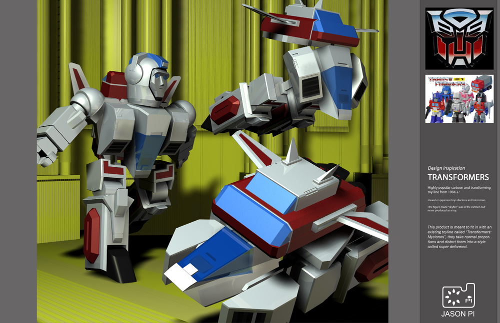

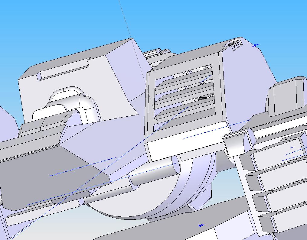

thanks nick for the template, i FINALLY figured out how to flip the chest vents the right way..instead of mounting onto the chest i mounted the hinge onto the hip bar so when you swing the legs back they face the cartoon accurate way...i did all that AFTER the god-awful-long alias renderings.
wish me luck guys! F, i heard today that the owner of giant robot is coming to our presentation.
