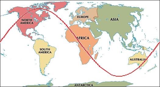

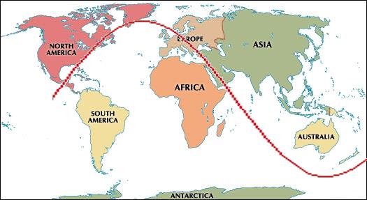

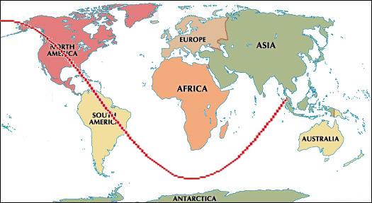

I watched the landing this morning and you guessed it. I've got another question. You guys have been very informative so far so I thought I'd try you again.
This relates to the animation that was shown that shows the orbit of the shuttle at 57 degrees in relation to the equator and explained why there was a small window where the shuttle could actually land in Flordia. The Earth is rotating under the orbit and one must wait for Flordia to rotate under the orbit.
Actually this is two questions...
(1) Am I correct to assume this orbit was significantly different then the last shuttle orbit? From the animations that were shown it sure didn't look like the shuttle would have flown over Texas on the way into Flordia this time.
(2) All the landing windows that were shown were from the part of the orbit where the shuttle is gaining latitude (i.e. heading away from the equator). However Flordia would later rotate under the part of the orbit where the shuttle would be losing latitude. They cut the animation just short of this part put you could see it coming. So on Monday when they missed their opportunity why did they have to wait a full 24 hours? From the animation it looked to me as if Flordia would have been crossing the orbit again in something like 8 or 10 hours just that the orbiter would have been traveling south on that part of the orbit instead of north. Was there a reason they wanted to land in the dark or some reason they don't want to enter the atmosphere while traveling south in their orbit?
Just curious again,
Carl
Edited by wwwmwww

I agree with and understand all of that but the last statement. The wait was because of weather, correct. The reason it was a 24-hour wait is because there is only a window of opportunity in the shuttles orbit where it can land at Flordia (or Edwards, or White Sands). If it missed that opportunity say due to bad weather it must wait for the Earth to make a complete revolution below it before that window returns and that revolution takes 24 hours. For example you couldn't land at Flordia if the orbit looked like this.
You have to wait till the next time it looks like this (or atleast closer to this).
Atleast that is the way it was presented on the news this morning. However my question came from the fact that the orbit passes over Flordia TWICE a day, not just once a day. Something like 9 or 10 hours after the first pass the second pass would look like this.
But to my knowledge they've never come in from that direction. Why? Is there a reason they have to come into the atmosphere flying north?

But again I'm back to my first question ALL those deorbit paths show the shuttle coming in from the south (flying north). I'd like to know why they can't land while the shuttle is flying south. If they could, they'd double the number of possible landing windows.
My question about orbits went back to flight STS-113 that fell aboart over TX. Both of these approaches...
show the shuttle flying south of TX. What put STS-113 as far north as it was? Was it's orbit much different from STS-114? I'm guessing it was but I don't know that.

A guess (and a guess only!) is that if they had came down North to South, it would be difficult to have a contingency airfield of sufficient size to accomodate the Shuttle. Flying southwards would mean a big turnaround at low (relatively - I'm thinking after reentry) altitudes should anything forces the airfield to be closed. The Shuttle may not have the luxury of making a big detour.
Flying South to North though, gives more options; First, less of a detour to another field. Second, overshooting US would be less of a concern, because the track would be more towards Canada and Europe -- countries traditionally friendly to US. Not to mention, more land under the orbital track.. otherwise, the Shuttle will be over water for quite a while.
EDIT: After reading David's post, I would like to clarify I'm thinking more of the flight between "after reentry" and "getting feet on the deck". Shuttle ain't powered, they can glide for a long way but there's essentially only that much they can do, so setting up a path that gives the most options makes sense to me.

Think I understand what you're saying now.
And I certainly know the answer to the last sentence:
They re-routed the re-entry because of Columbia---if something went wrong, they didn't want it to shed parts all across the Southern US, or any populated land. Thus, it's over water for as much of re-entry as possible--both the Florida and California approaches are over water for 90+ percent of the time.
They especially want to avoid being over land during the most dangerous part--by the time it's over land it's done with the actual "firey descent" and is simply gliding around. I believe this is also why they waited for 24-hours etc between approaches---it's not simply needing a window, but a window where they can also avoid flying over populated areas, which is now more of a concern that before.
