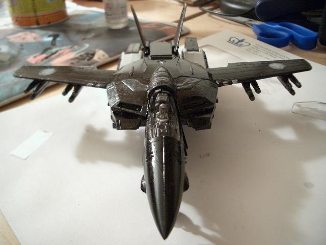

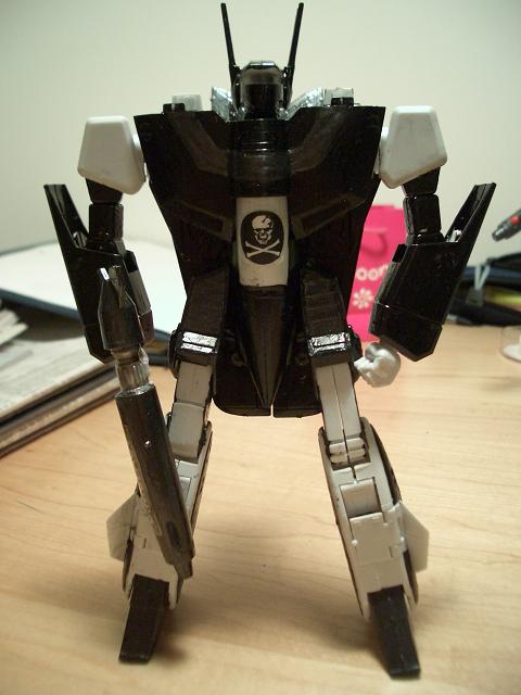

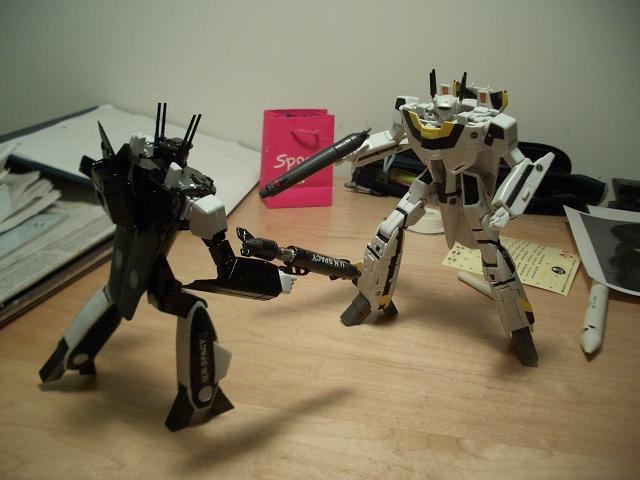

Here are the results of my first attempt at constructing a model kit ever: a Bandai 1/72 Variable VF-1S Valkyrie. Loads of errors, and I don't just mean the paint job.

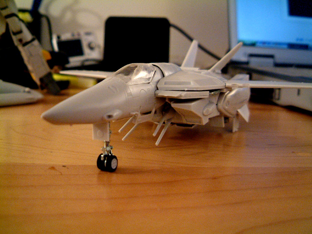

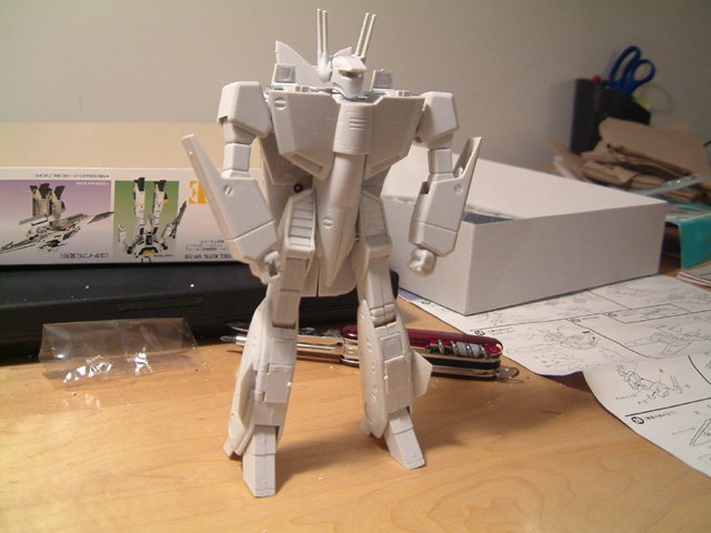

Here it is, pre-painting:

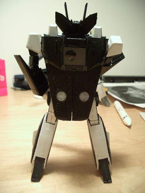

Well, see if you can spot all the errors I made.
I would also greatly appreciate painting feedback, positive or negative. Should I have painted the individual parts first before sticking it all together? is painting without an airbrush just stupid? will i die if i paint indoors without any windows open?

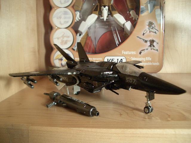

I'm not trying to be mean or whatever but I cant say it looks good... but you can probably do a lot better than I can so who am I to talk? <_<
I just recently got an airbrush and was testing it out and imo the control and the smooth coats that its able to do is a billion times better than anything else I've tried. Just my 2 cents.
I like the black scheme at least. :)
Seriously, dont worry about it. I can probably do worse. :p

I hardly paint my models nowadays, unless they are really special ones ;) and if your preparation and sanding skills are good, a pre colour-molded kit can look fab without any seams or whatsoever!
The trick is to glue the parts with model cement until some glue oozes out (the cement actually works by melting the the plastic pieces). Then start with sanding from coarse to fine and finish off by using polish paste, again from coarse to fine. The end result will actually look really great!
Btw, your attempt on the transformable valk is quite good, since it is a hand job and not a blow job :lol: If I can choose, blow job is always my favourite!

I'd say when it comes to painting, you should do the peices individually, but first you have to have them ready for fitting... or you're gonna end up sanding and glueing over the paint. Not all peices have to be painted first, but things that you can't mask should get paint.

First, thanks for having the heart to post your model, like the others said, lots of people are afraid to.
Hand painting isn't a complete no-no, I mean, painting by hand is what humans did for centuries before air comressors and spray guns, but it takes a steady hand and a lot of patience. It also takes a good brush (Not those course bristled, white handled Testors things they sell at most hobby stores) and a paint mixuture that is at the right viscousity. Most of those Testor enamels right out of the bottle are too thick to lay down smooth. It may seem like a waste of time, but what I suggest if you are going to work on hand painting again get some thinner for your paint, invest in a few nice brushes like sable or synthetic hair from an arts and crafts store, practice thinning your paint out enough to where you get good coverage and the paint does not want to gob up on you. Practice on the inside of a model kit, or on some sprue plastic. Just laying some paint down with different amounts of thinner will give you some practice and show you haw the thinner affects the paint.
As far as assembly goes, I am not a huge stickler for seams, but one of your legs has a little gap you can see right through the model :p
I like the paint scheme, black Valks are cool, I think if you take it a little slower you will be much happier with the result.
Thanks again for posting, and I hope I didn't offend you, definitely keep building, it is fun and you get better with every kit.

Also remember no matter what you are using to paint with (brush or air) several thin light coats are always better than one thick on.
Your prepainted shots of that old model bring back so many memories, I'm gonna have to build one of mine now. :D

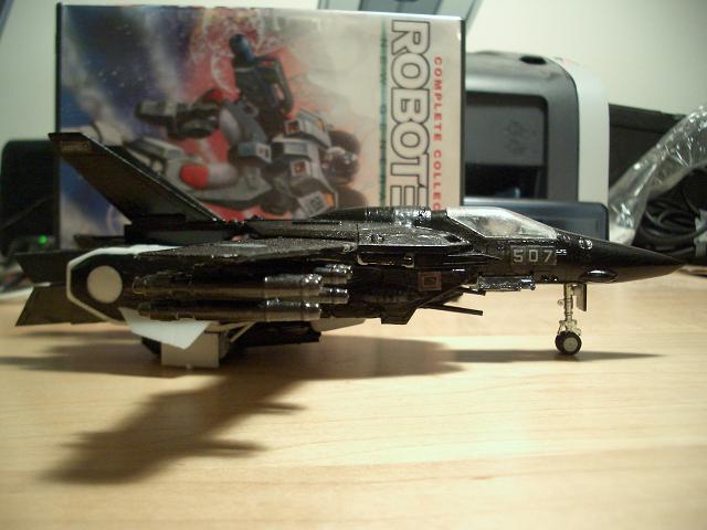

Thanks for posting pics of your kit! You've really done a fine job with this kit considering it's your first model and it still is able to transform! :) Those kits are not exactly easy to build especially as your first attempt. :blink:
I have to agree with everyone else here that the number one thing to do is slow down. ;) When assembling the kit, try to make sure that all the sprue attachment points are cleaned up before you assemble the pieces. Use a sharp hobby knife to gently scrape or cut off the little nubs that are left after you remove a piece from the sprue. That will result in a more realistic look, help with seams and will definitely help with the transforming and articulated kits.
When you have a few pieces or a subassembly together or even two major parts glued together, look over them and check for any misaligned parts or anything you are not happy with and fix it now before you go farther. This will stop a small error from becoming a major one down the line.
Ghadrack gave some good advice on brush painting. I have painted plenty of models without an airbrush and although not as smooth as an airbrush finish they can still be respectable. Painting before or after assembly depends on the situation. I often spray some kind of a primer coat while the parts are still on the sprue, but I find that I end up scraping and sanding alot of it off during assembly. Still, it gives a nice surface for the finish coats to adhere to. Make sure you have plenty of fresh air when painting. I do a lot of painting indoors and I think I've escaped brain damage.(my wife may disagree) :blink::p If you start to get dizzy or light headed get out into the fresh air right away and see what can be done to alleviate the problem. Maybe use a fan if needed to keep the fresh air flowing. Stay away from open flame while you are painting too!
One more thing I would suggest is to work on a couple of simpler models before trying another variable or expensive model. The work will be easier and you can get comfortable with the basics of assembly and painting without worrying about producing a model that does justice to the complexity and cost of some kits. I highly recommend the 1/100 valk fighter kits. They can be found pretty cheap and build up into a decent looking valk. Or you could try some 1/72 scale modern fighter jets. You can usually find some Revell or Monogram kits for low prices in your local hobby shop or at some online retailers like http://www.squadron.com/ or http://www.greatmodels.com I would stay away from the 1/144 scale airplane kits or 1/72 armor kits as they can often be hard to work with with many very tiny parts.
Good luck, and don't get discouraged! The purpose of model building is to have fun and it looks like you are doing that now. You show a great sense of humor and willingness to have fun with the hobby so go for it. We all aren't going to be model masters,(lord knows I'm not) but everyone can have fun with this hobby. I look forward to seeing future models posted here by you.
WOW! this turned into a huge post! I hope some of this helps. Just keep practicing and having fun! Thanks again for sharing!

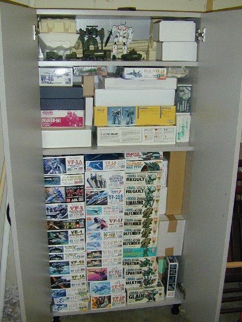

Grayson,
That's a great cabinet! I can relate. I've got one set of shelves, one cabinet and kits are starting to overflow! And that doesn't count built up models either!

Grayson,
Heh, thanks, sad part is that's an old pic, about 10 models and several hundred dollars ago, the collection is even worse now.

Kinda sad when about ten models adds up to several hundred dollars isn't it? I remember when $10.00 was a lot for a model and that was probably a very large kit at that!
