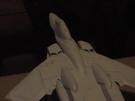

Well, Got my kits today! I've been looking forward to these for a long time. Major props to Myersjesse and MSLZ22 for picking these backup after the initial project.
The kits are a little intimidating at first escpecially if youv'e never worked with resin before. It's not that bad though! I can see were mechamaniac was complaining about vacuming resin dust. I'm going to be coughing that poo up for the next week.
The Yf-21 and YF-19 are simply beautiful. Though both kits need some major clean up. There is alot of flash to sand away and like every one has seemed to say, the pieces just don't automatically fit together. The 21 alone wil probably take a tube of putty to fill in the gaps. Not knocking the work that went in to these though. These kits are simply amazing! Also, huge to say the least. The 21 dwarfs a 1/48 Yamato.
Well This is going to be my first buildup on MW so any suggestions are welcome.

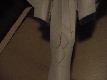

More cleanup.
Pretty much all of the pieces have alot of flash like the piece below. One thing I found though, is that the resin is real easy to sand. Suprisingly, It holds up very well too! It's nothing compared to working with a Hasegawa.

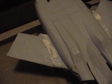

I've done a little bit more work. I decided to take the time to build the landing gear up. It still not the way I want it but it's coming along.
Heres a pick of the front gear doors close. I think after a paint job and a good wash these will look ok.

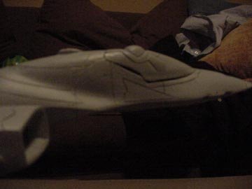

Try to use gap filling super glue or bondo. if that doesnt work try to debond the canopy piece and refine the fit a bit more. The problem using plastic model putty on a resin kit is that it will not bond to the resin. On plastic kite the putty is supposed to lightly melt the plastic and stick, thats why i use gap filling super glue and bondo.

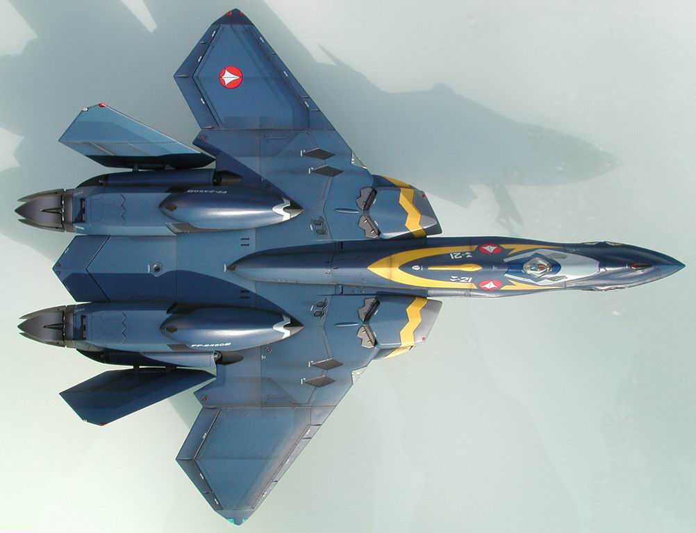

We are neck and neck on the 21. im going to start base paint tomorrow. I found the best example/guide to paint this monster is WMchengs build up.
Sean
Man, I so wanted to try that paint scheme out. I'm a little intimidated by it though. That is the best looking Macross Model I've ever seen! I've saved every picture to my harddrive of that thing. I'm still contimplating painting the recast that way.
