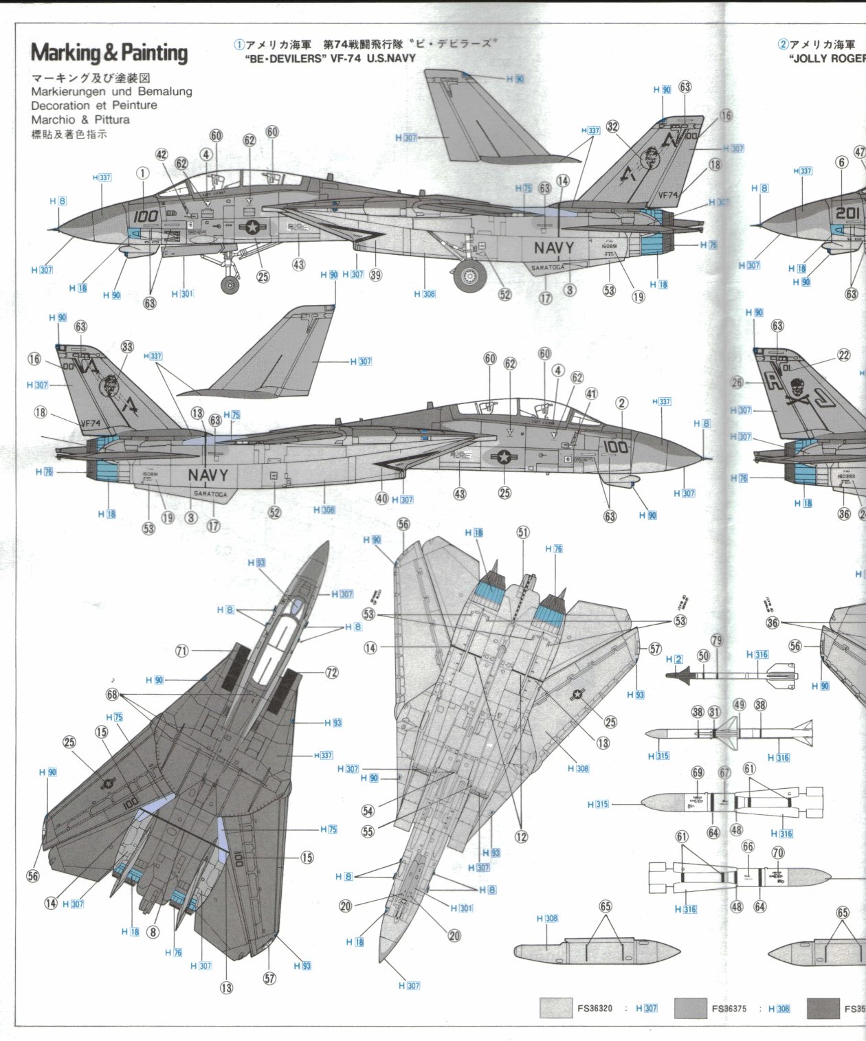

Hi folks, I`m the new one...;) I`m building a F-14 Macross Zero Tomcat. But when I wanted to start the kit it was totally sold out, so I decided to make one by myself using the newest F-14 kit from Revell. As I had the optional hasegawa decals for the Valkyrie I thought it would be easy....does anyone own the original one and can tell me where the military decals are placed...(the un spacey stuff...)??? It would be nice if someone could scan the sheet with the macross markings and mail it to me...!

Tuffskull---what kit is that Tomcatters F-14? Looks like a Hase 1/48 I'd guess based on intake/glove shape, but the rear fuselage is wrong (not that the Hase's totally right). And it looks like Gull Grey overall, which I wasn't aware was ever applied to an F-14D. Black-tail, especially on gull grey, is my fave CAG design, but I only know of a few squadrons that did that.
