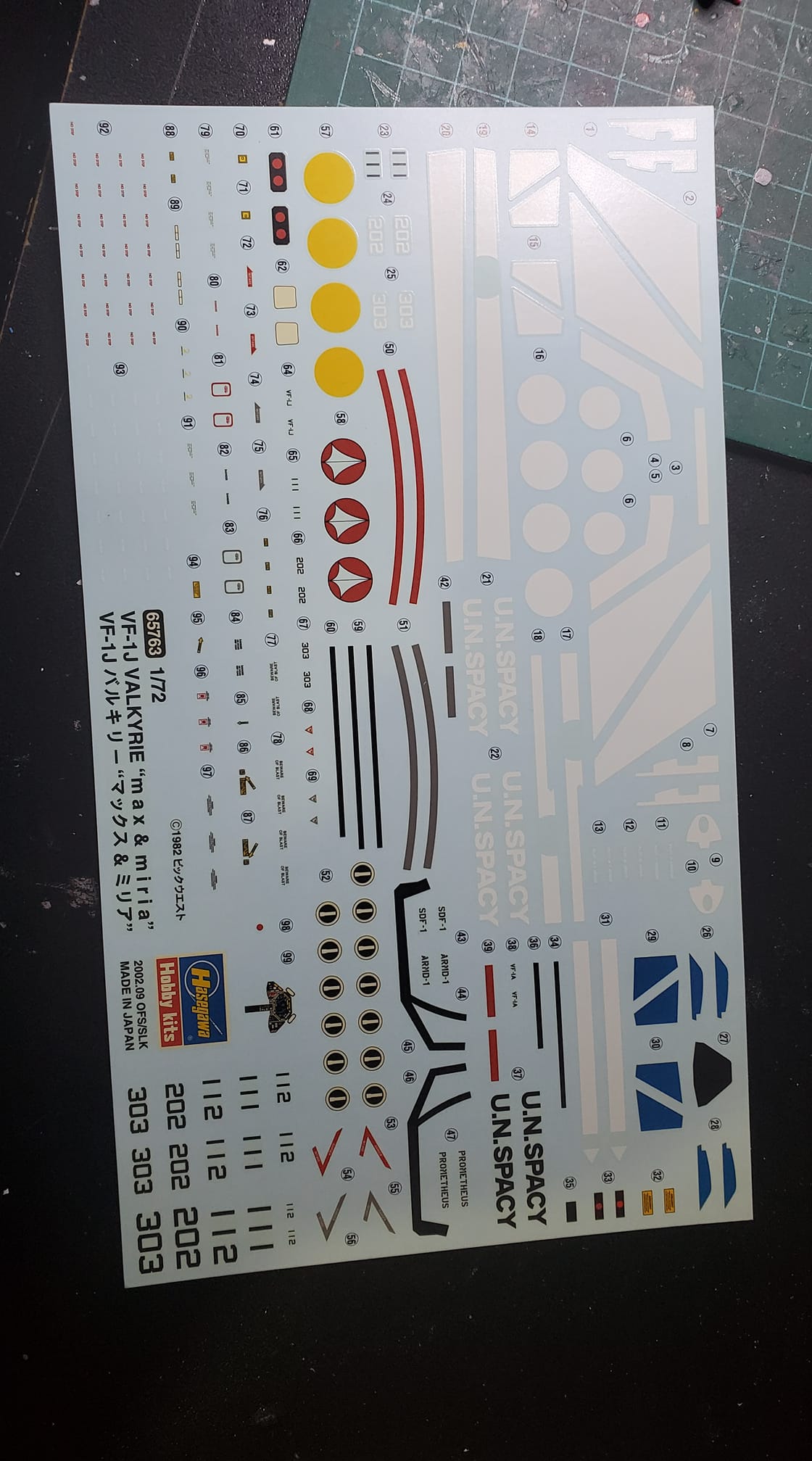

I'm looking for an actual copy of this sheet.
I know i can scan it and print it out on printer slide paper, but if i can find the original, id prefer it.
Link to post
Share on other sites
That looks like it's from the Hasegawa kit 65763 Macross VF-1J Max & Miria. I have it and could scan it for you but it doesn't sound like you want a scan.

13 hours ago, TMBounty_Hunter said:
Hmm I don't know how that came across but I meant the opposite. I've found manual work to be pretty much the only way to fix distortions. Automations seem to just amplify them resulting in more work than starting manually from scratch.
Maybe this has to do with resolution. It's very easy to use the printing pattern of the image to align things manually at 600dpi but maybe to machines that's just noise.
Depends on the nature of the distortion. The options available in Photoshop tend to be pretty limited, what I'll call "affine" because that is fairly common way to describe them. Essentially combinations of rotation, scale, and translation. That includes grabbing corners of an image and "stretching" them out to improve alignment. For flatbed scans, that's generally sufficient because of how the optics of the system work. A robust automated approach can nail that kind of task, but off-the-shelf graphics software generally doesn't excel in this area. The situation becomes way more complicated if you take actual pictures with a camera and want to stitch those together seamlessly. Goes from a two-dimensional problem to a three-dimensional one. :blink:
Link to post
Honestly that just seems like an exercise in self flagellation
Link to post
There are times when something like that makes sense, but not for decals or box art. Why punch yourself in the head when you don't have to?
Link to post
On 4/3/2021 at 5:32 PM, Anasazi37 said:
Oh good, I was thinking that it would be pretty easy to remove the alpha channel in ImageMagick, but hadn't looked into it. Graphic design, computer vision, photogrammetry, and remote sensing people all use different terms for pretty much the same stuff. You basically have to speak four different technical languages to find useful information online. Only 1 bit for the alpha channel? Interesting. Really must have been a binary mask (1 = use, 0 = don't use). You don't see that very often. Usually it's a gradient value between 0 and 1 or 0 and 255. I don't see a need to go beyond 24-bit for this kind of project. 16 bits per color channel is excessive and printers aren't really set up to deal with it. Keeping more raw scans that you can then postprocess in different ways is a good idea. I love that you're building enough flexibility into your scripts that you won't have to make changes each time you run. Command line options FTW. Bash, PowerShell, or something else?
Working in Windows, I don't have time to setup a Linux box at home, although I've been using Linux since 1993 so I'm one of the old timers on it, lol. So no bash for me unless I setup Mingw or something similar. Batch and Powershell seem to be working well for me so far. The merging script it just a batch script that I edit the filenames in each time, could easily be converted to take them as command line args. My powershell script is one I use to convert all tifs in a directory to have LZW compression so that I can get the decal scans down in side and not have 0.5 - 1 Gig per scan, lol.
Link to post
Nicely done :good:
