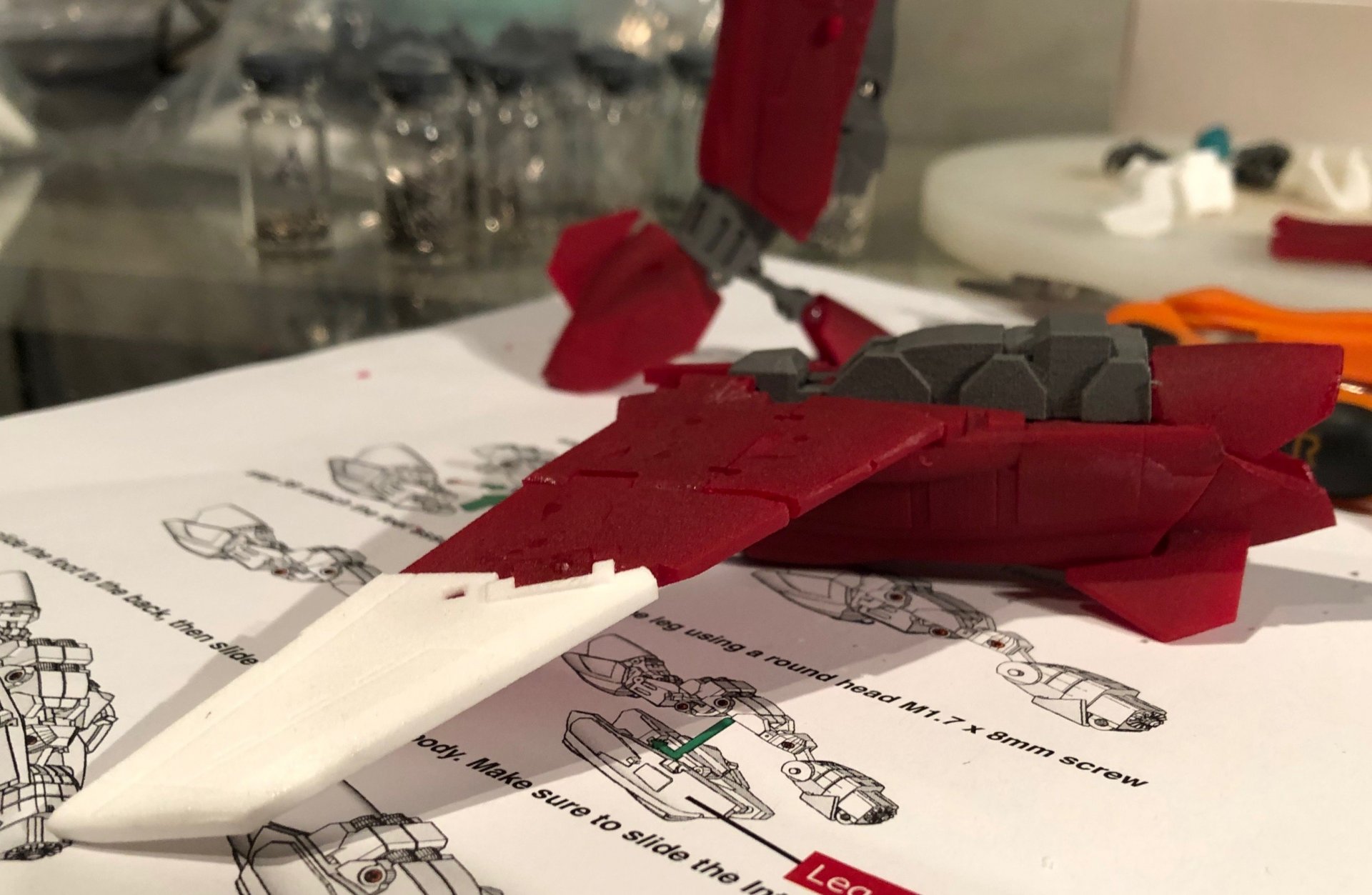

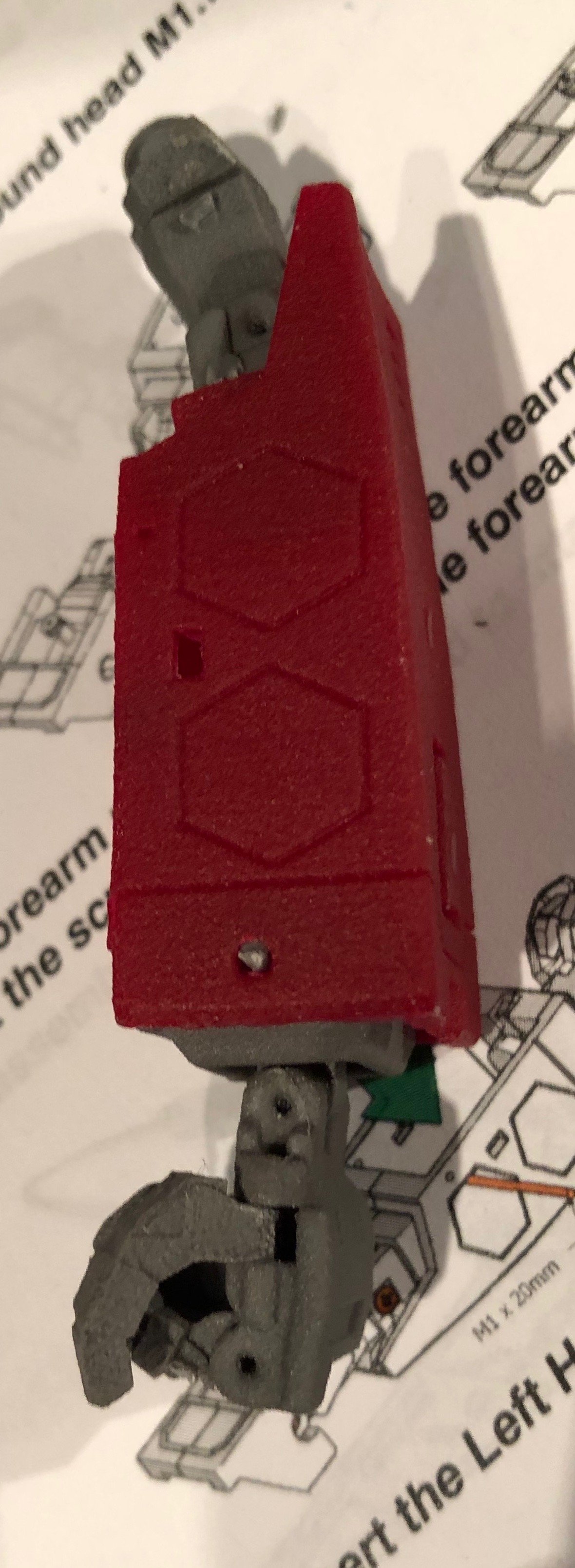

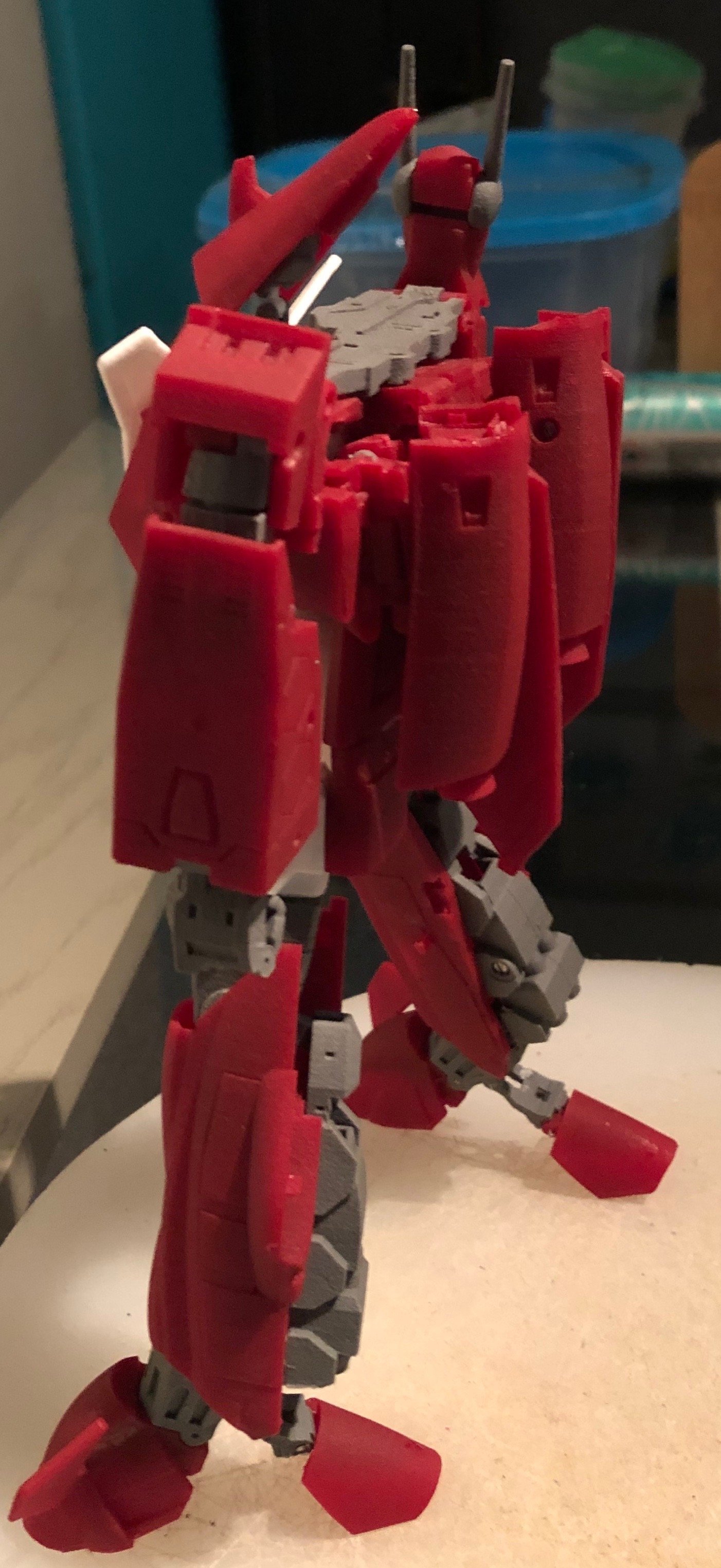

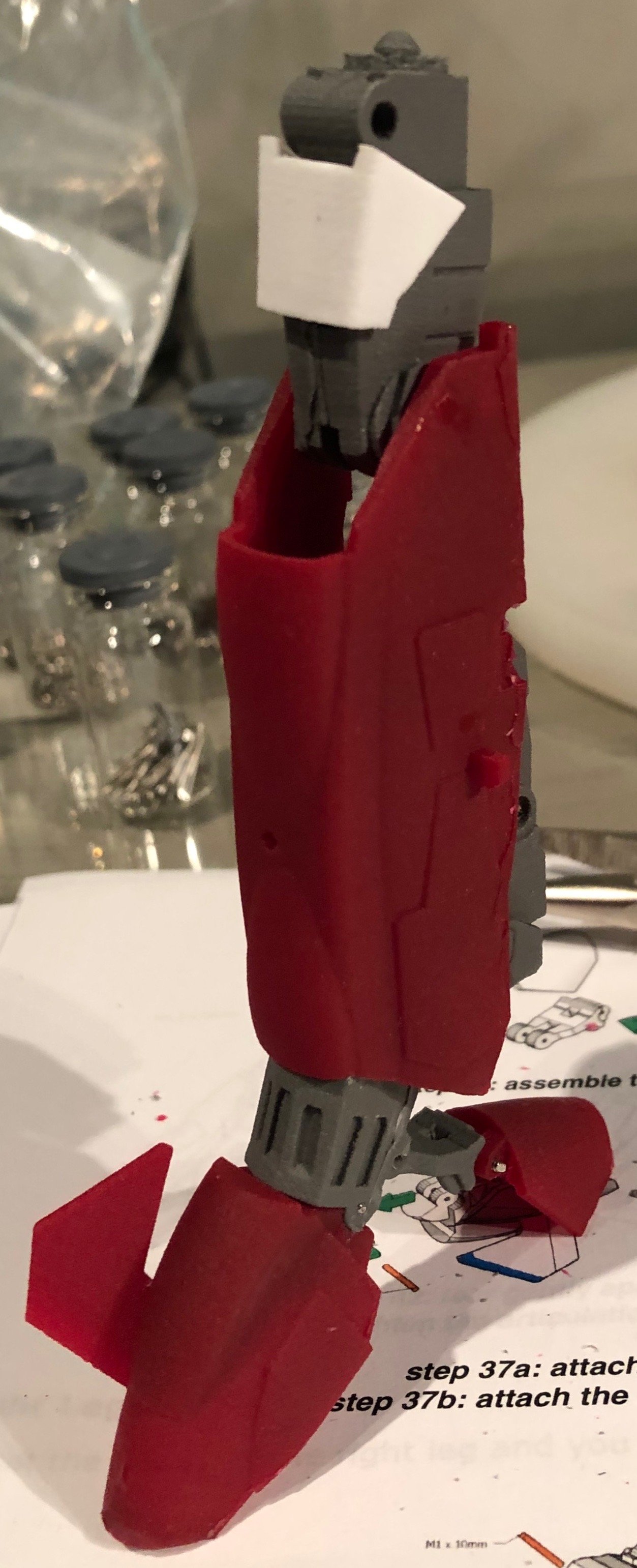

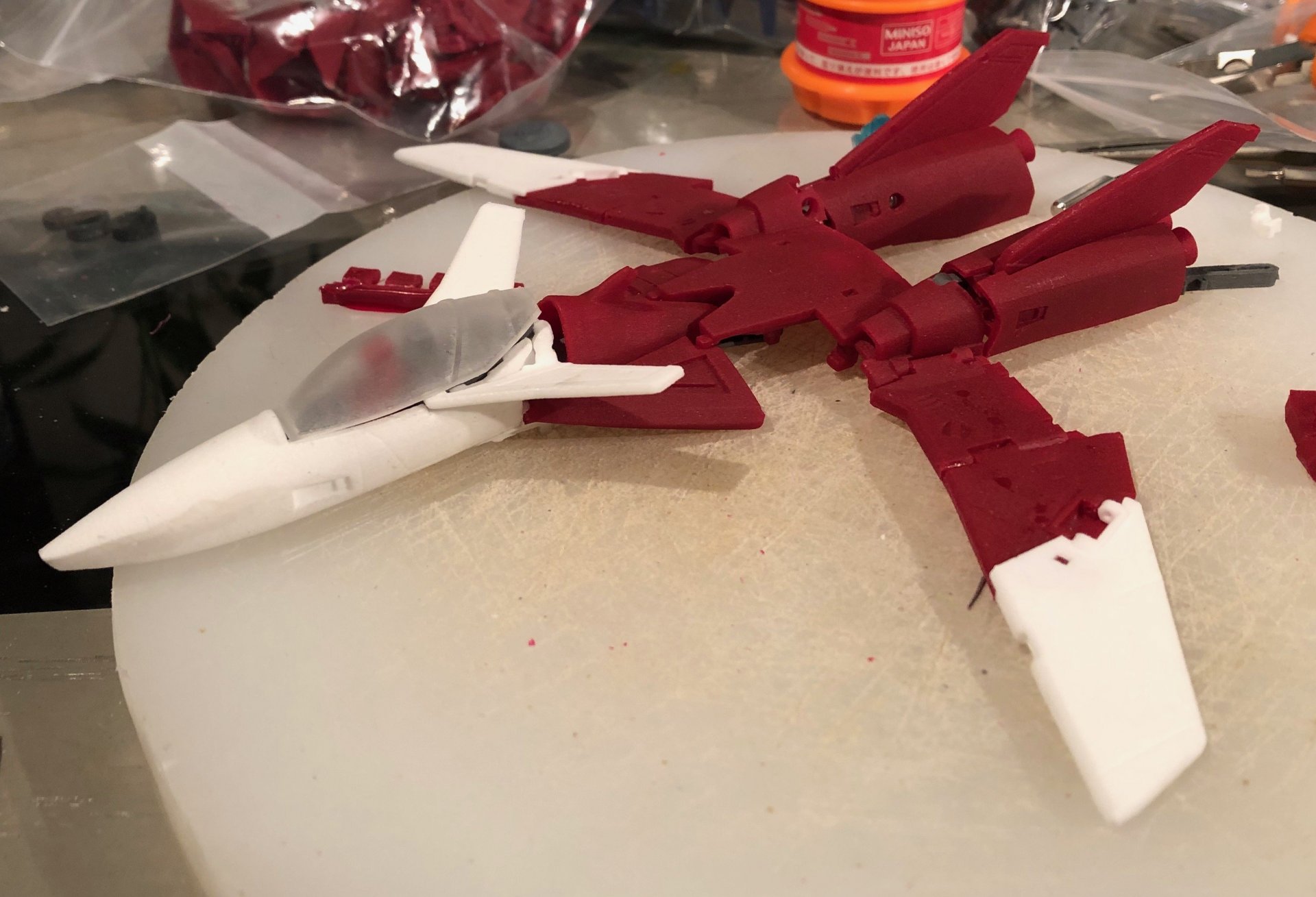

I did manage to get some of my resin dyes and managed to mix a red with warm water. I soaked a couple of the WSF parts in it, and they seem to be a solid red color (minus parts I patched and smoothed out. I think this might be something to look into if you buy the WSF parts. I'm going to try this with some of the other WSF parts I have and just sand them before putting them in a dye. If this works, this may be the way I go. The dye I used is called So Strong, which can be bought through Smooth-On. They have red, black, yellow, brown, and all sorts of others. I'm going to test this out longer.
Hi Jasonc, I am glad you like the gunpod too. Did you found the magnets in the end ?
I will be looking closely to your results with this dying method, just when I was convinced that I should stick to HP plastic, if this dying method works great, that would completely change my mind. I am very bad at painting the large panels, and painting only the detailing would be an absolute plus to me. One thing though, how would you paint the white portions ? I was planning to prime my both copies in white then mask and paint in red (classic you would say)

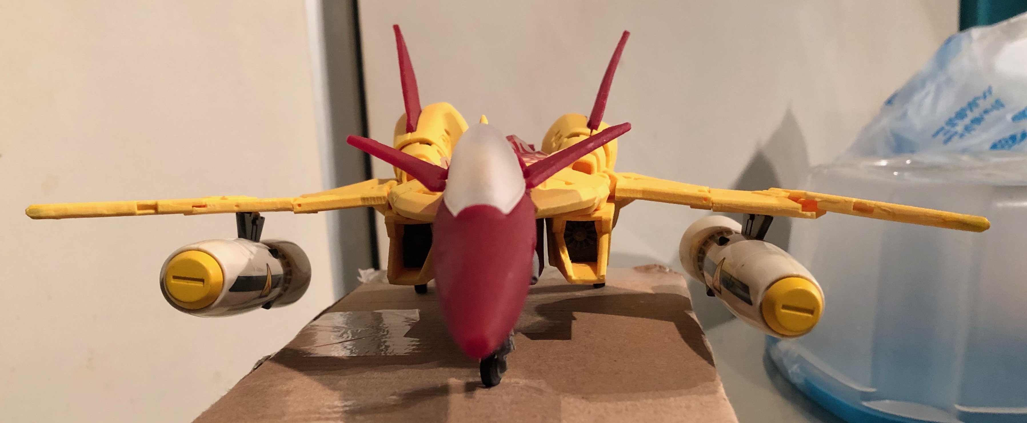

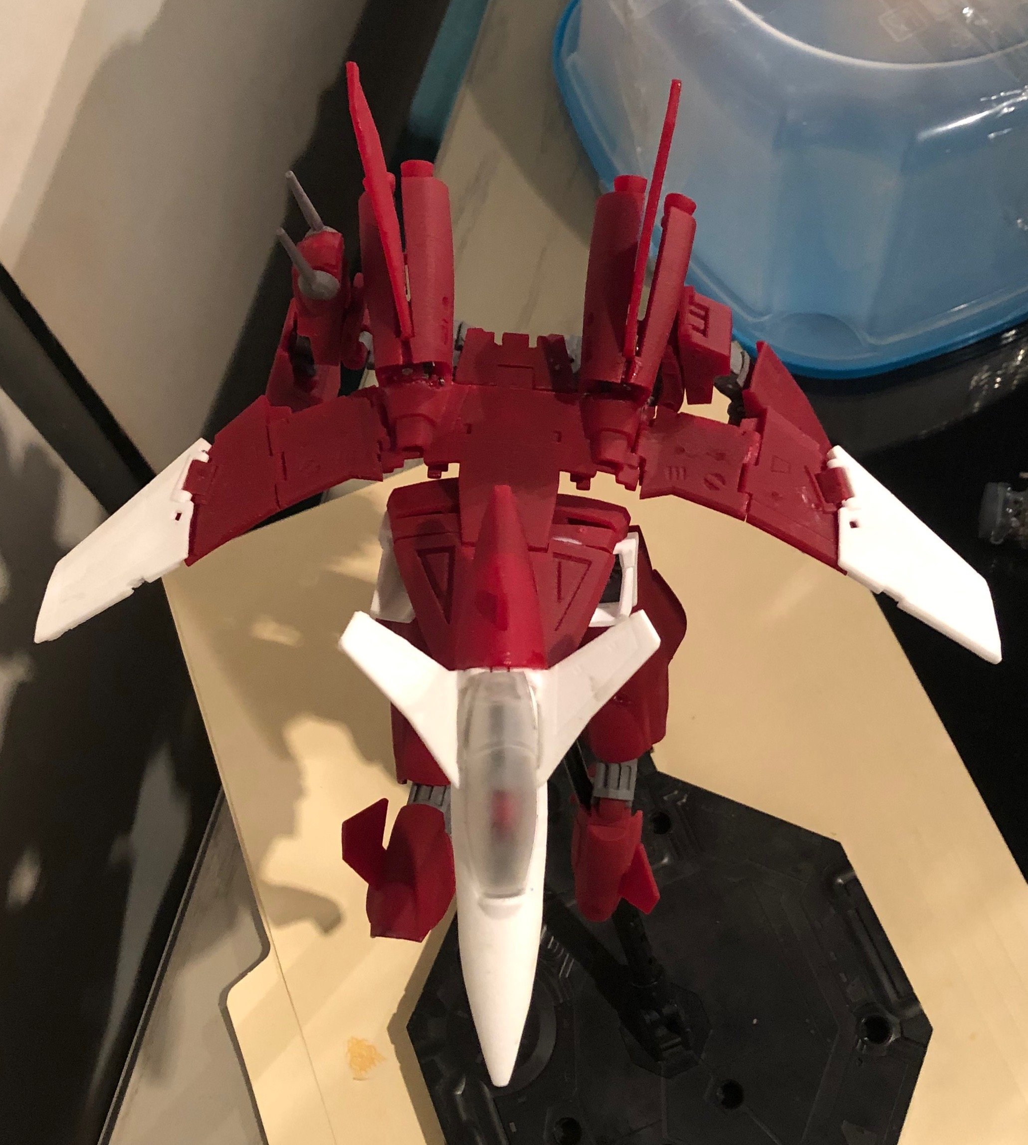

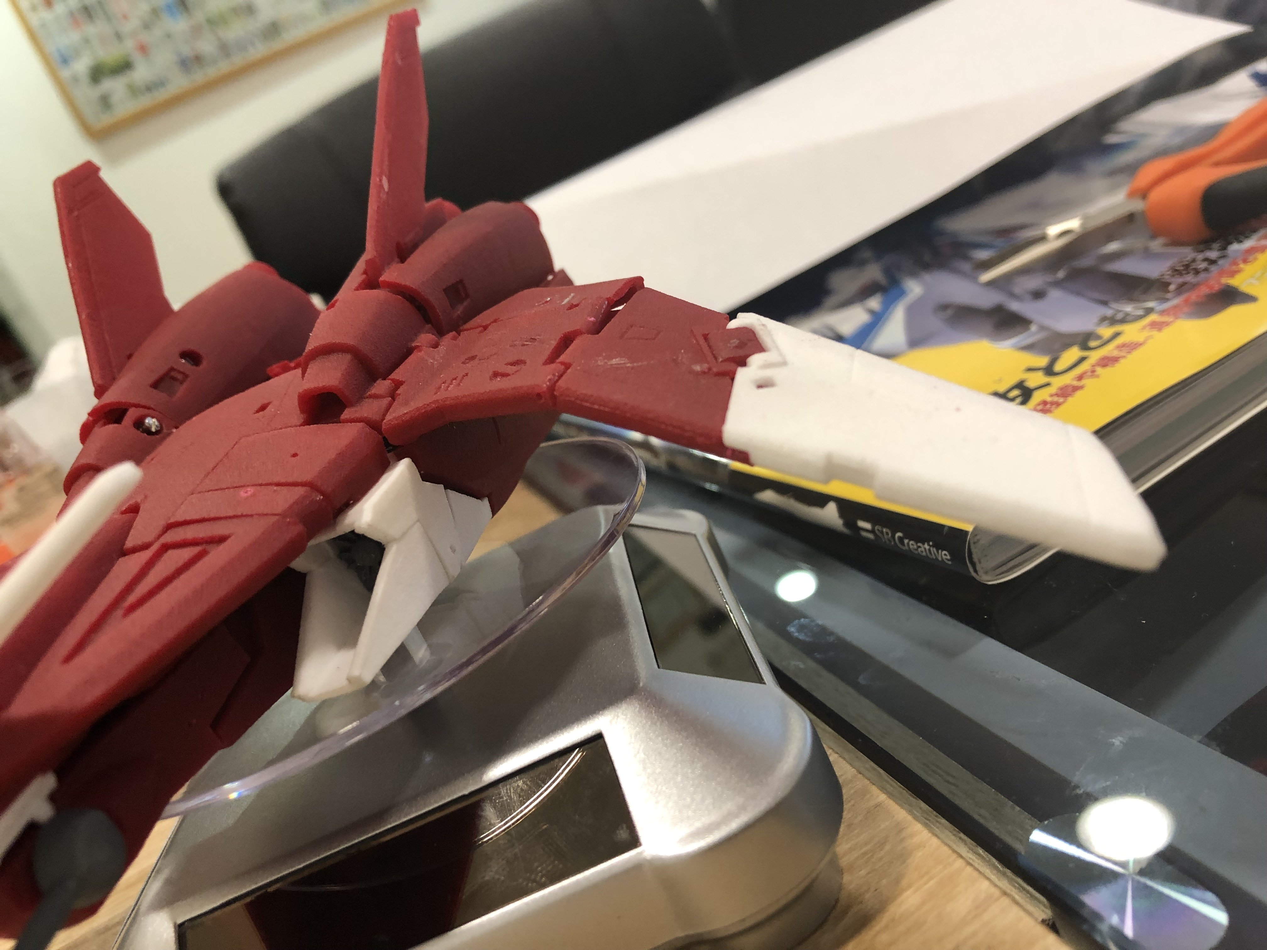

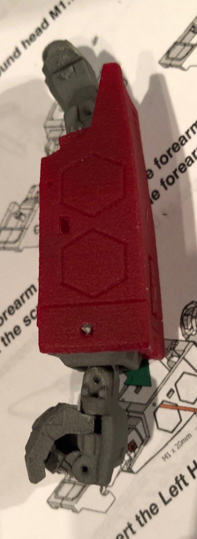

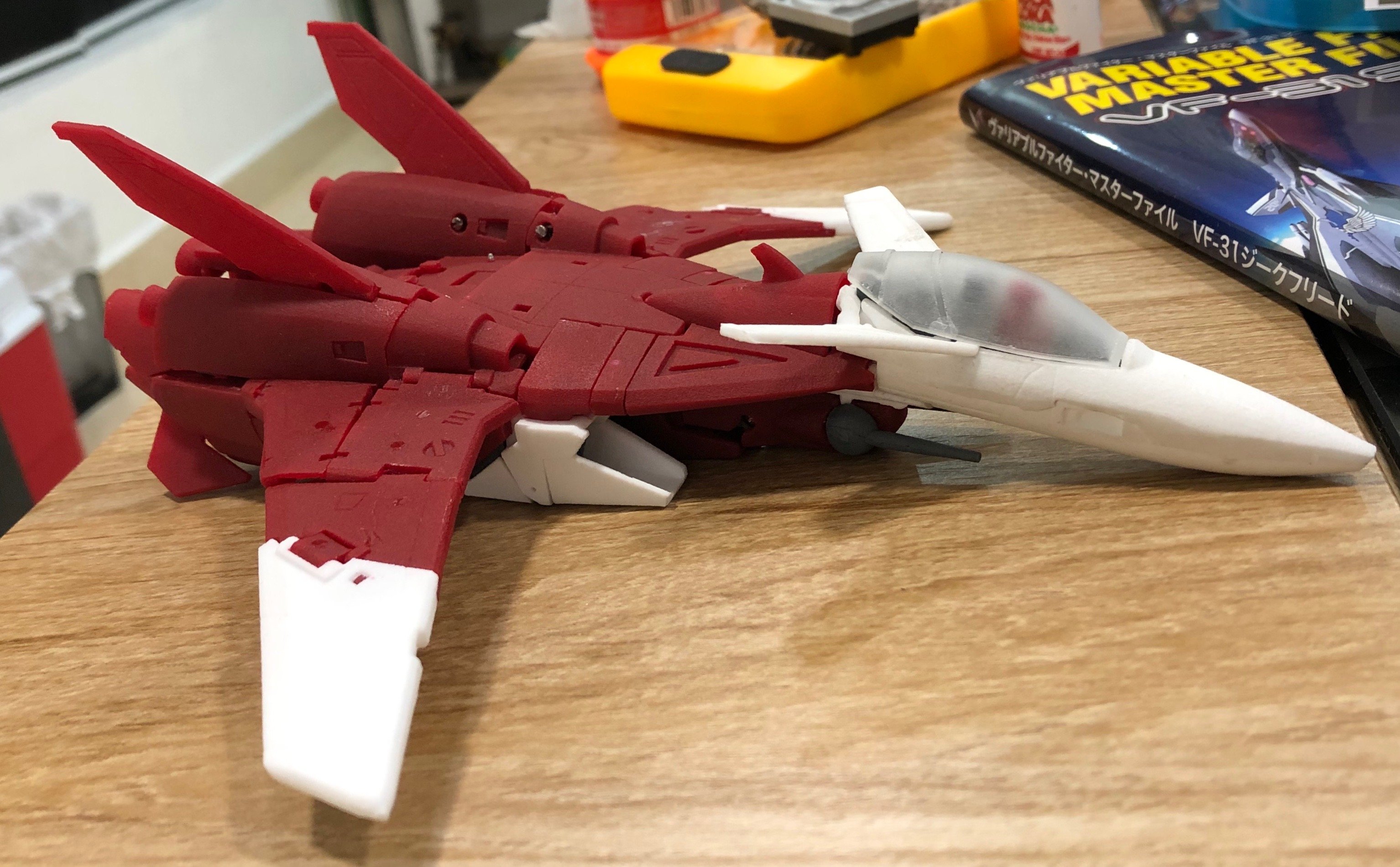

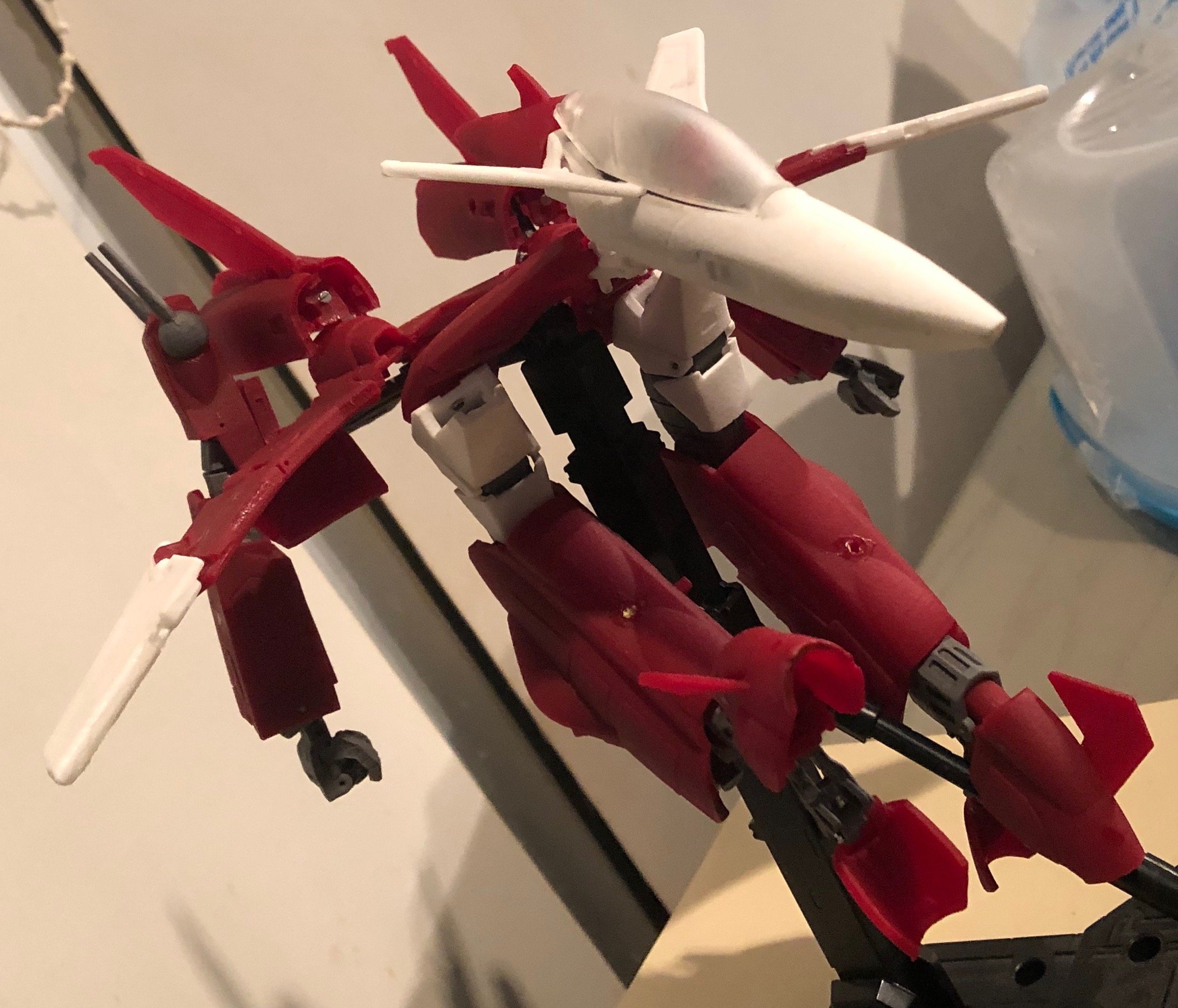

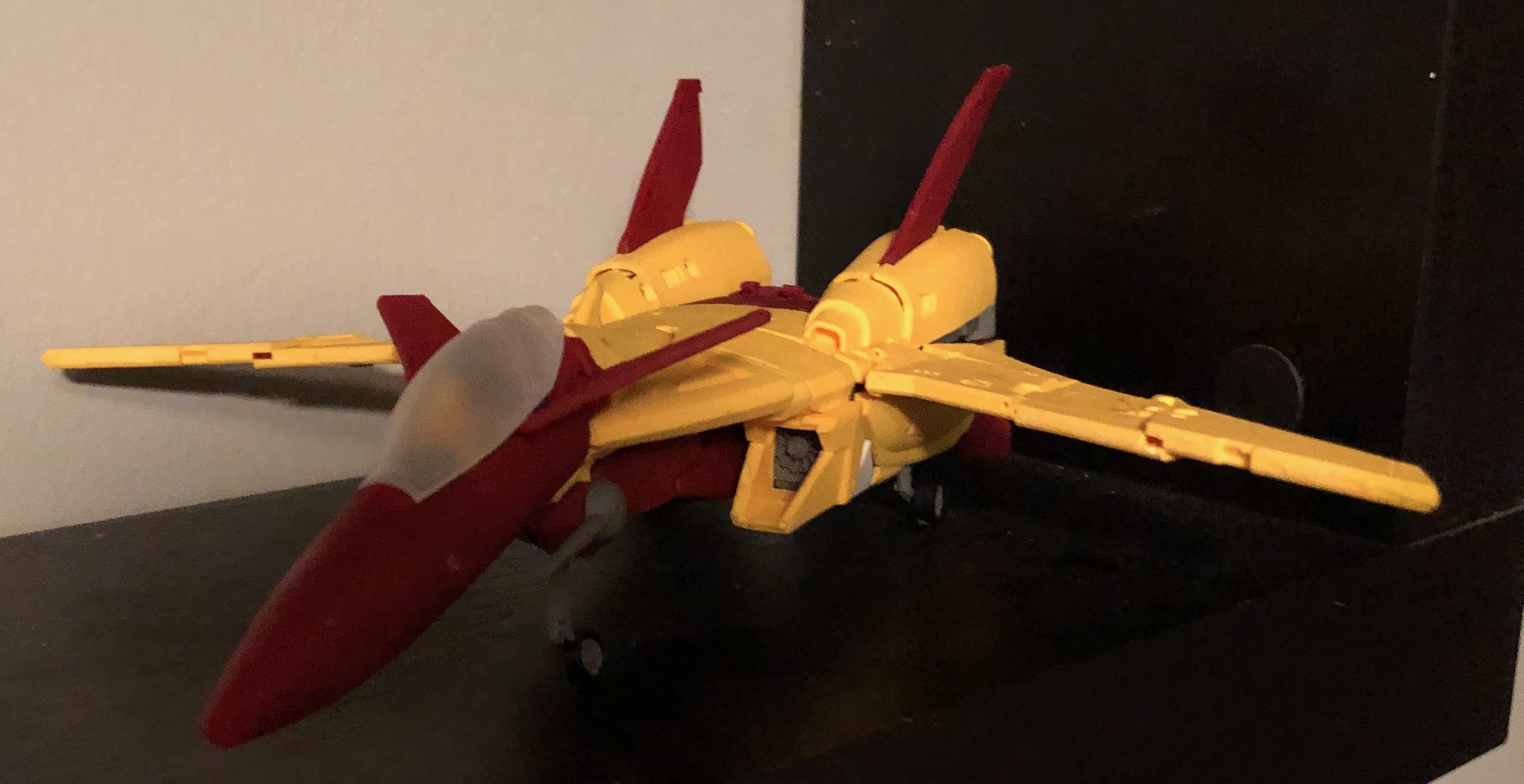

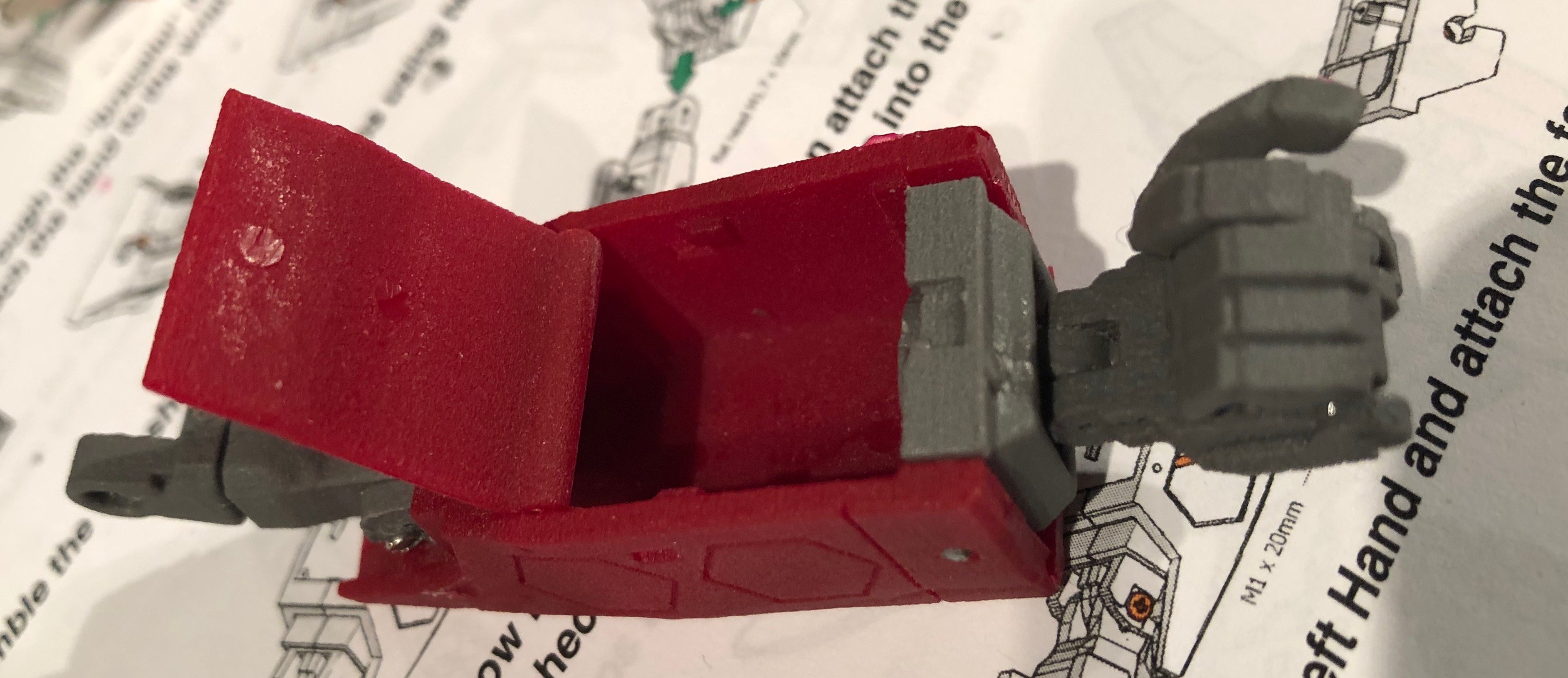

Heres how the dye came out. Mind you, I used putty on spots, so those are the off color sections, but it does work.20181123_154814.thumb.jpg.07cc6a7792f8175ce2eb42af2112c359.jpg

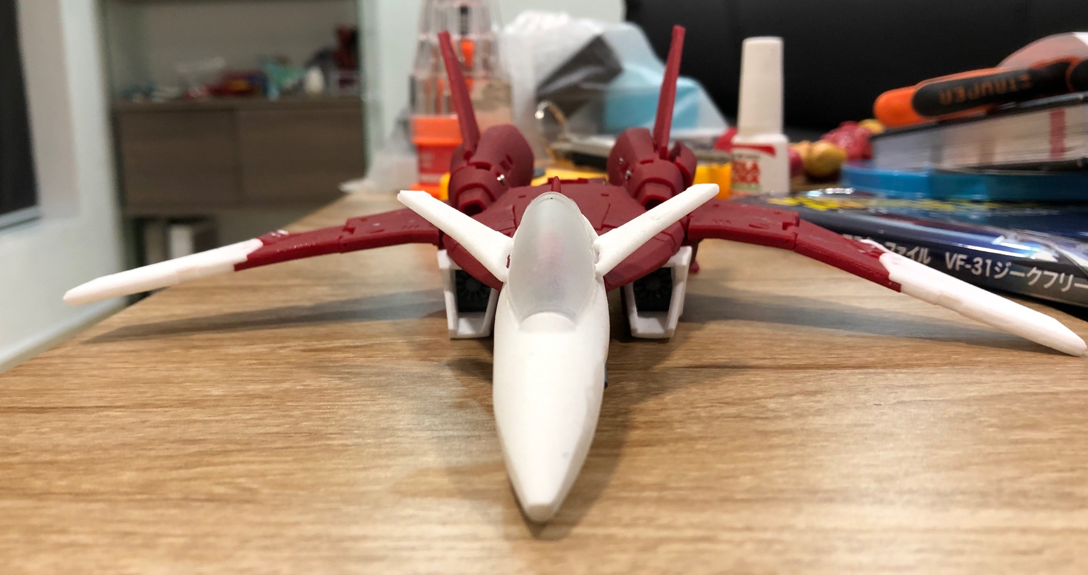

Hi Jasonc, it looks like it still needs an additional clear coat to obtain a great finish -or the focus on your camera was a bit off-. Otherwise it can also be a great base color for red painting.

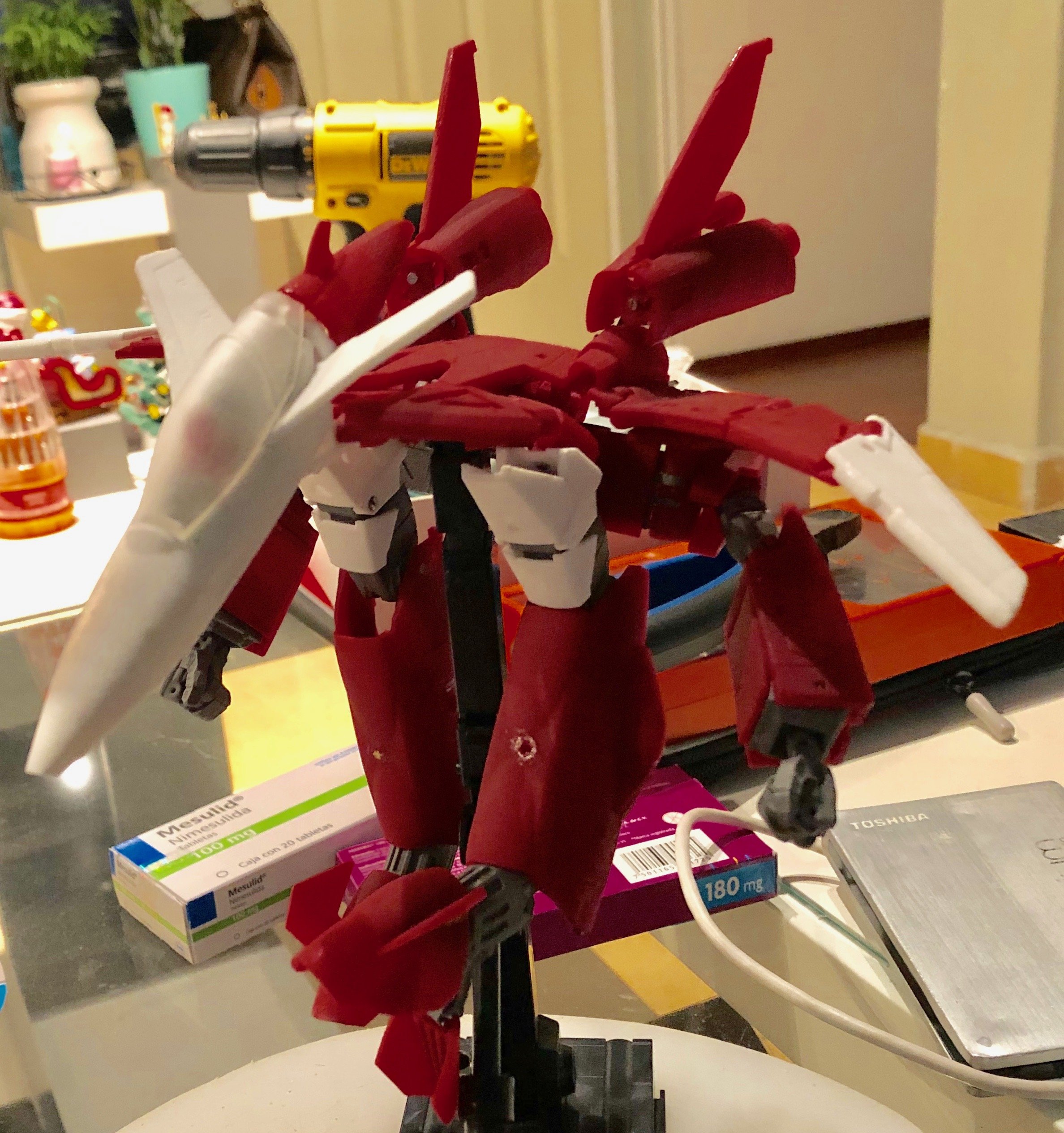

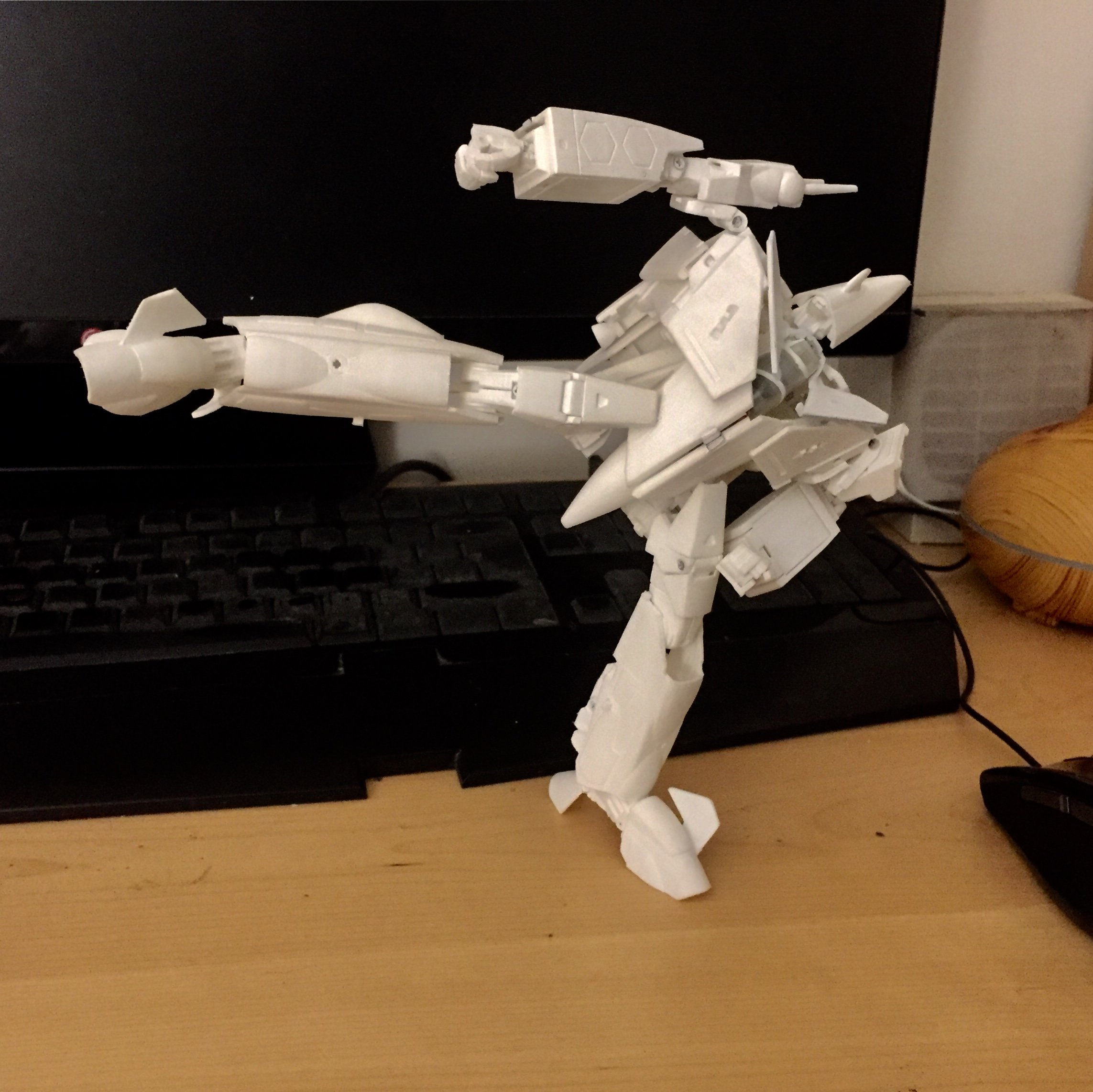

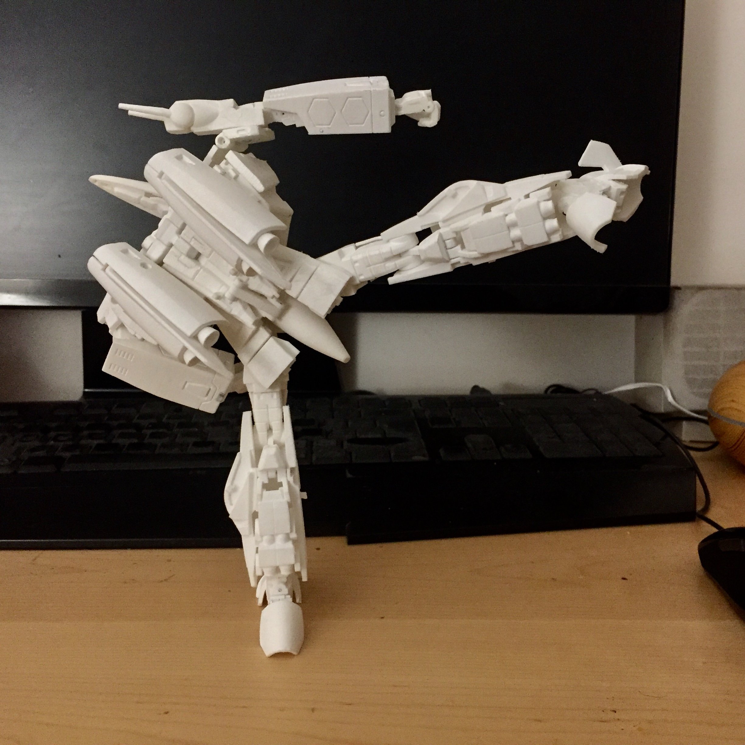

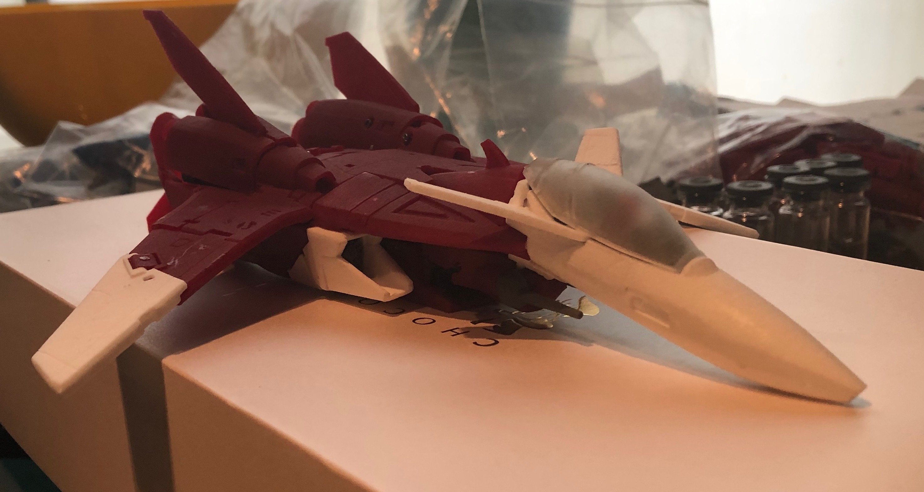

In the mean time, I have been lazy with my painting, pretending that I had to wait for the second V4 fins to install on my white VF-9 but managed to pose it kicking Kung Fu.

That looks great.  Is that a paint you put on it, or is it a dye? I looks very uniform throughout the parts. I can't wait to see an update on your work.
I started doing a lacquer primer on all the parts. Unfortunately, the dye didn't work as well as I wanted it to, so I just decided to sand the parts a little thinner, and then focus on a really good paint job free (as much as possible) of friction. I did decide to do the MtR version, although, still not at 100%. I'm not big on the character who pilots it in the series, and because I don't know it, I'm not sure yet. Maybe I'll do a second version, one with the early VF-9 Cutlas grey color. I had to order yellow and orange lacquer paint so I can mix and then pain the yellow and the red parts, so when that comes in, I'll start on the actual painting. Until then, just got a bunch of parts heavily coated in white primer to sand down and smooth out over several times. So far, the cockpit, and the leg section and head are ready for the colored paint. No pics at this time.

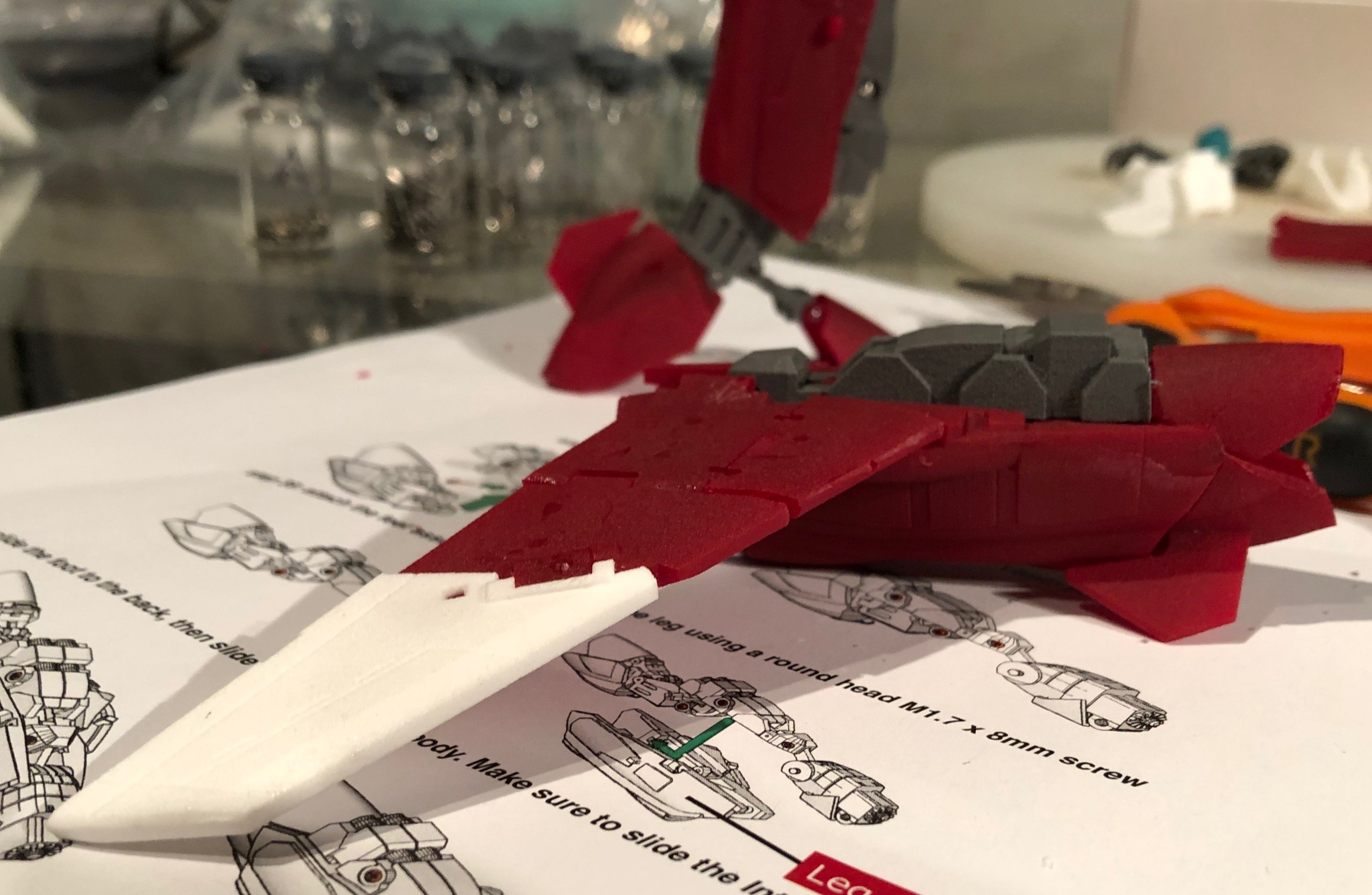

I'm building the one I have at a snail's pace. Mostly to make sure that what I do paint, stays painted, but the parts I have put together work very well, and seem quite solid. I've actually mixed the professional plastic with some of the WSF stuff, and it seems to work well. Where I need more detail, the Professional, and where I know I'll be moving a lot of parts, the WSF. I have to find where I put the gun though. I was finished with that part.

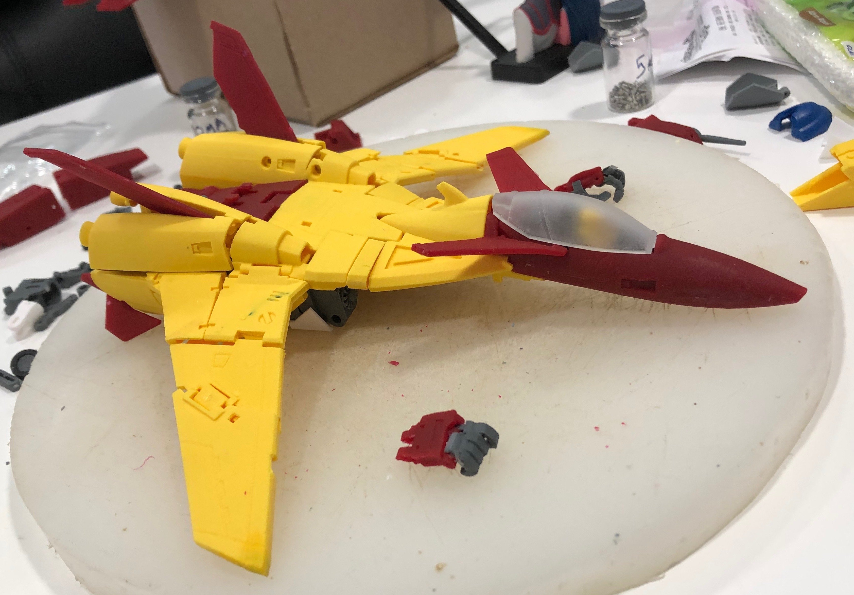

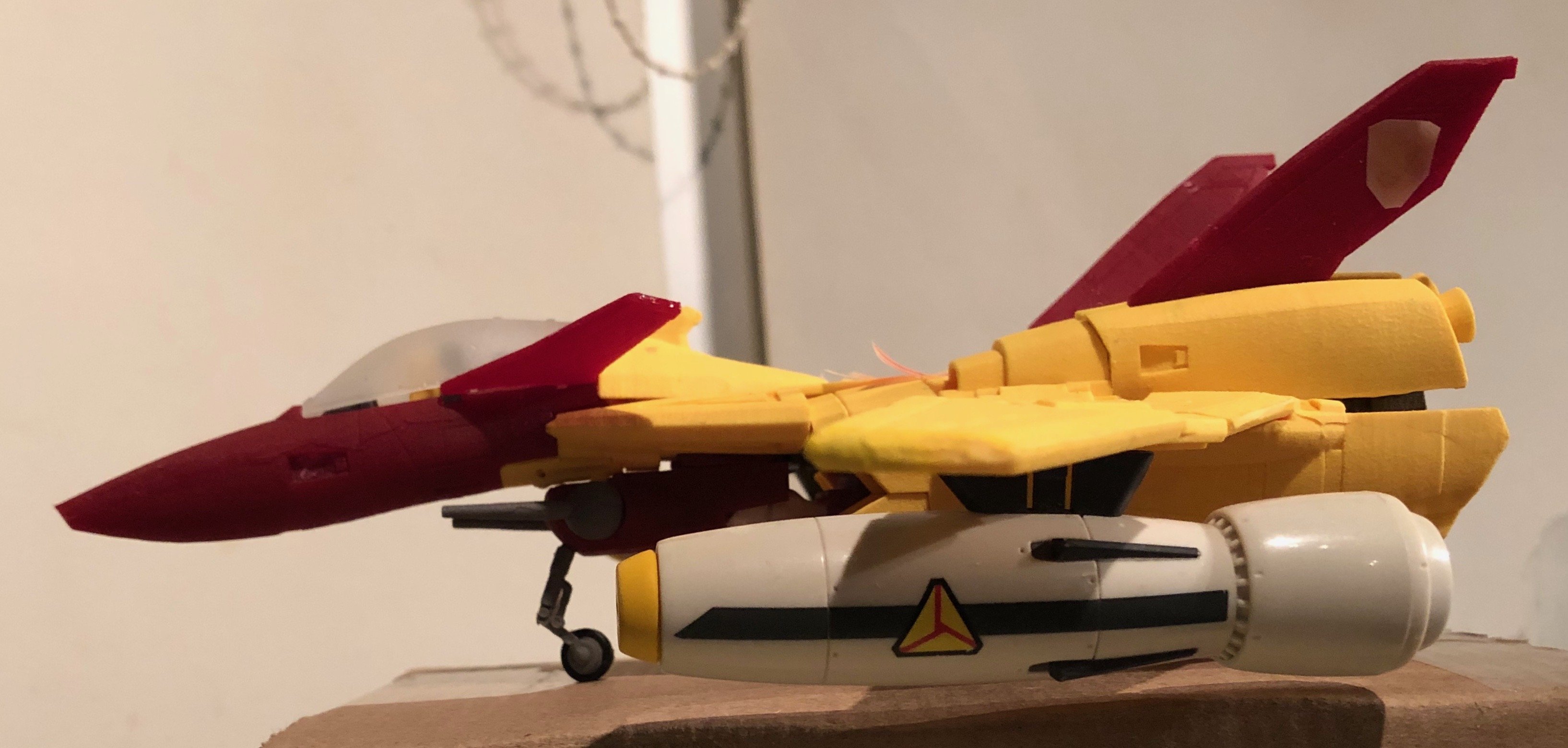

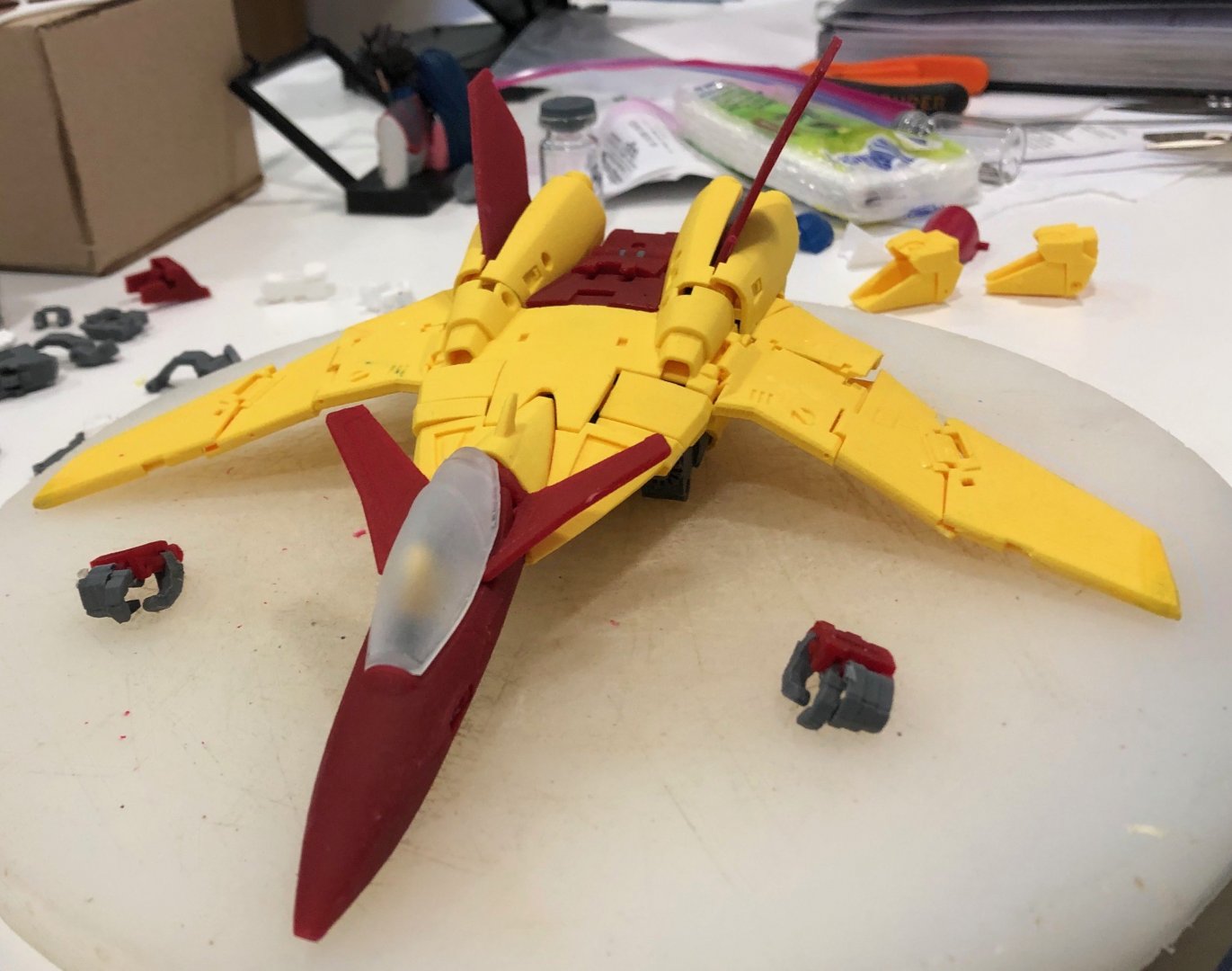

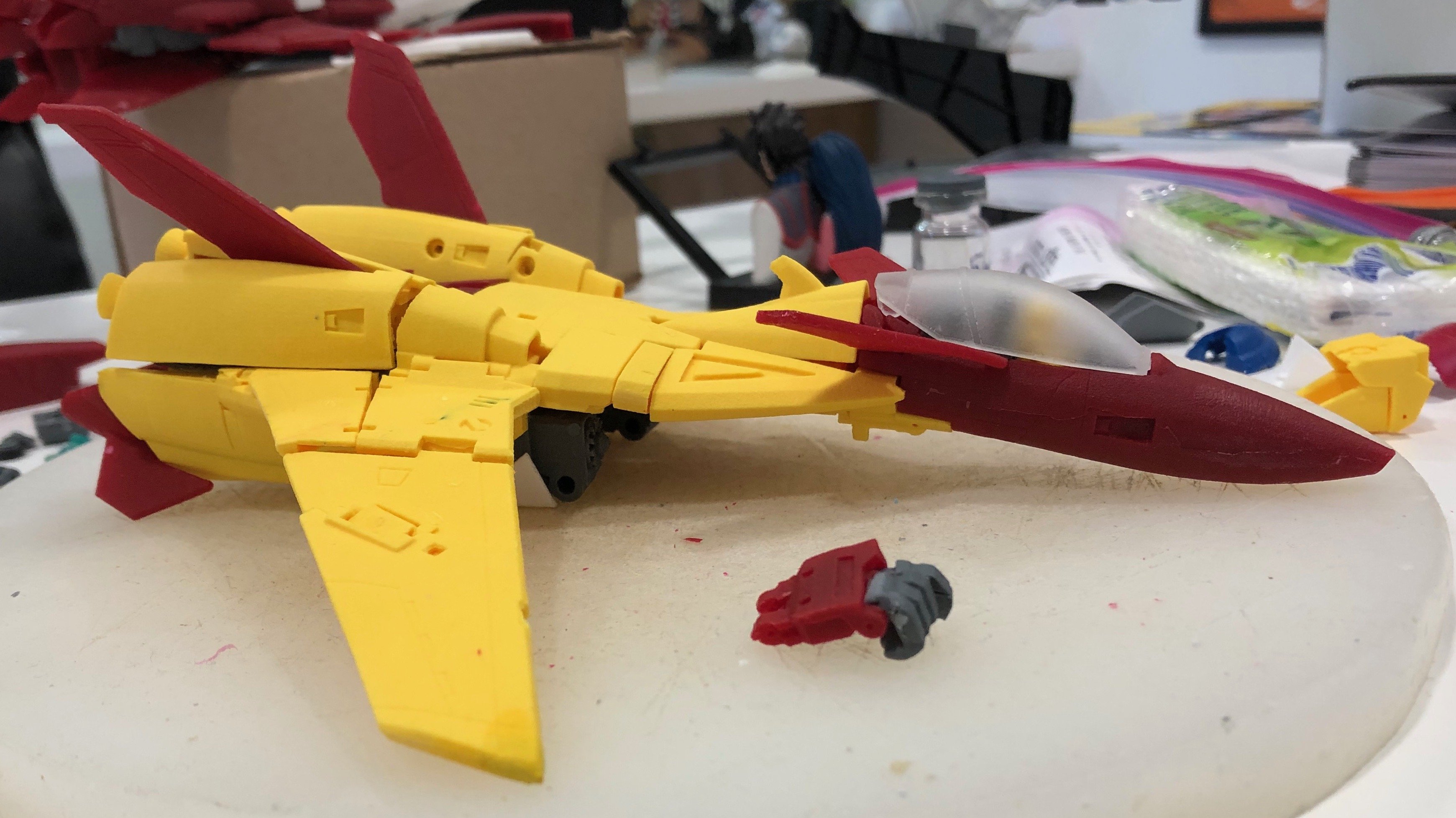

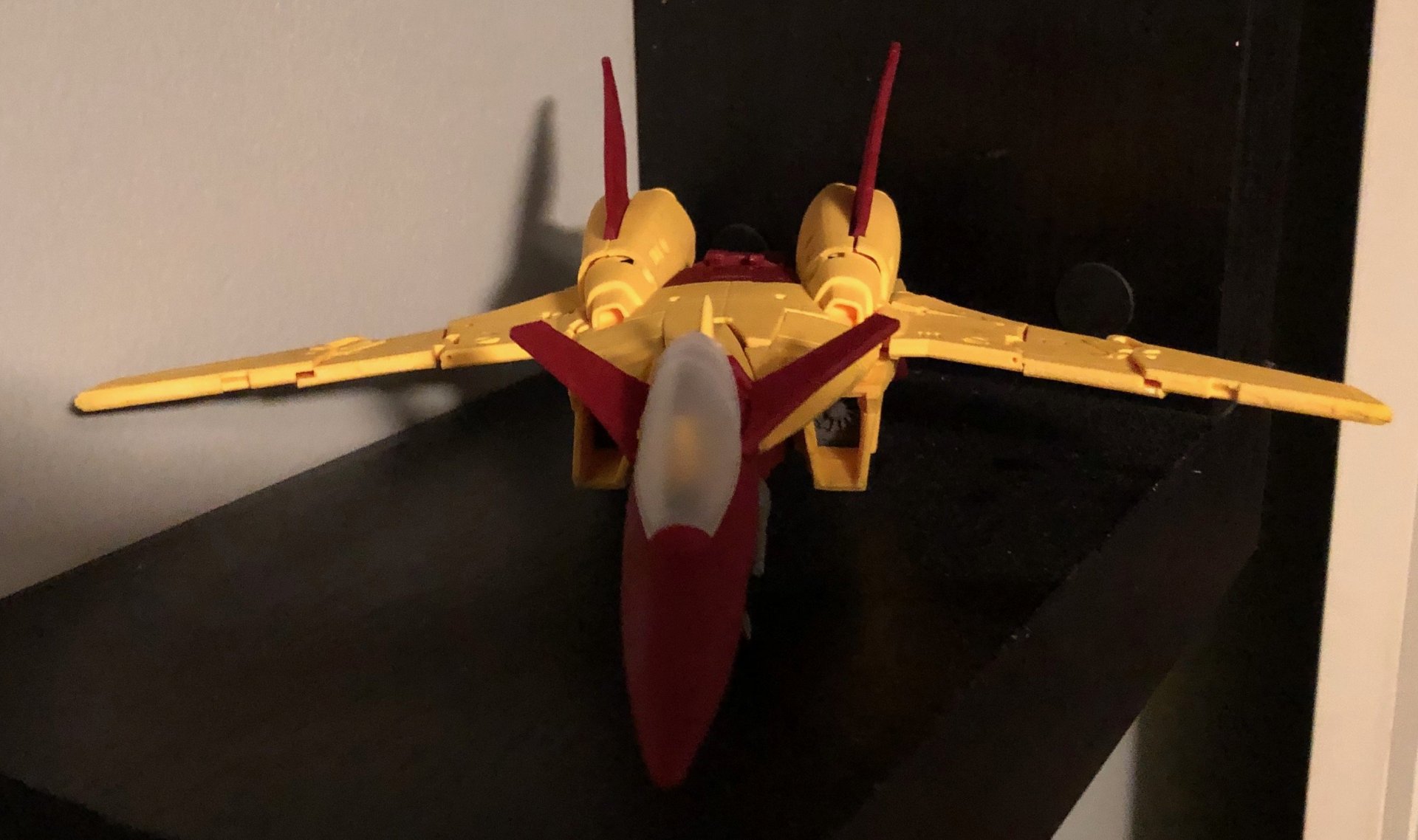

Thanks to Xigfrid we can offer a resin version for $120 USD (shipping not include) if are interested or have questions send me a PM
Share this post
Link to post
Share on other sites
Hey this yellow version looks great! I hope you will sell well these copies.
The resin material will be perfect for fixed pose, with little movements.
I can imagine these kits as a fighter only pose, but with the feet able to move and the canopy that can open. Or as a battroid with moving arms and fingers.

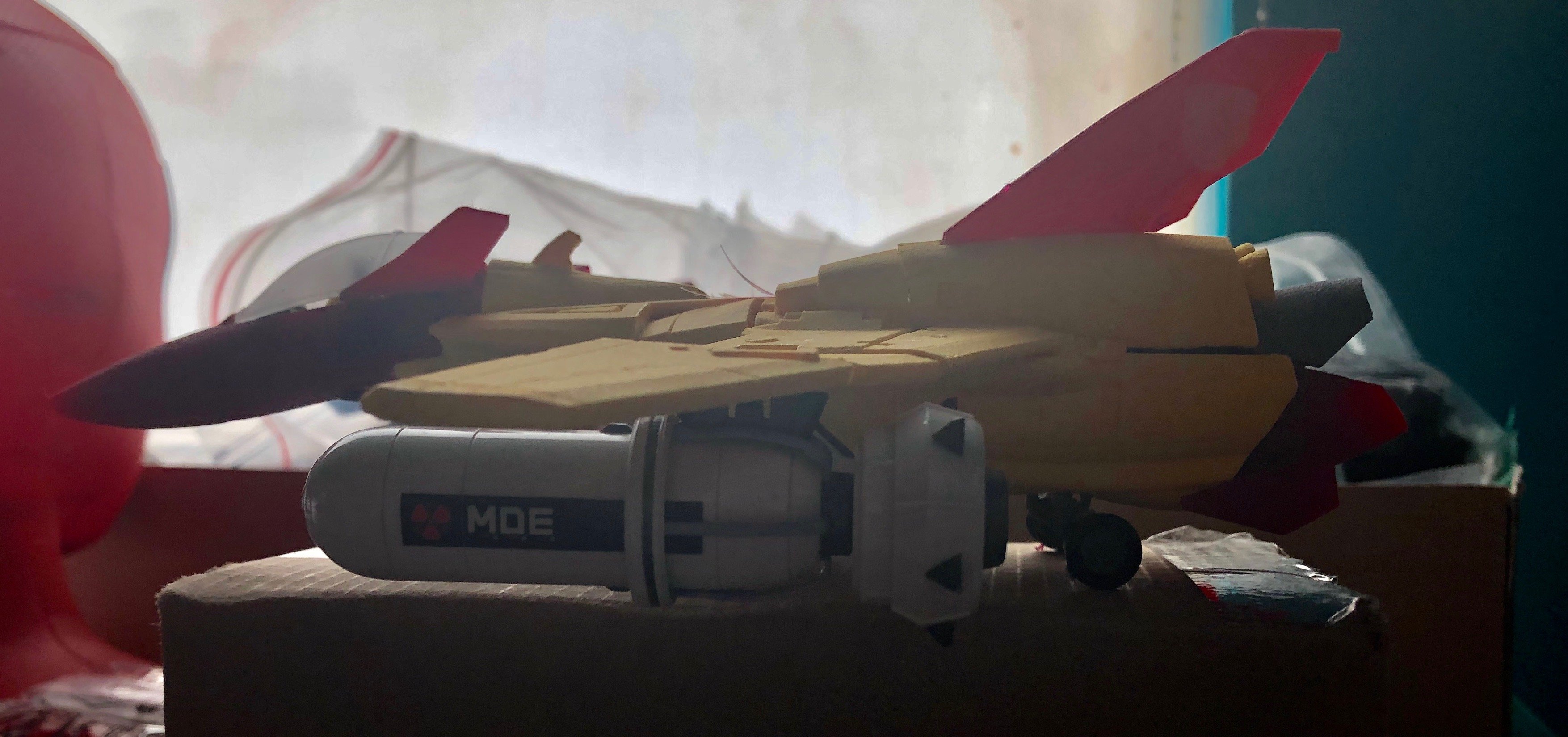

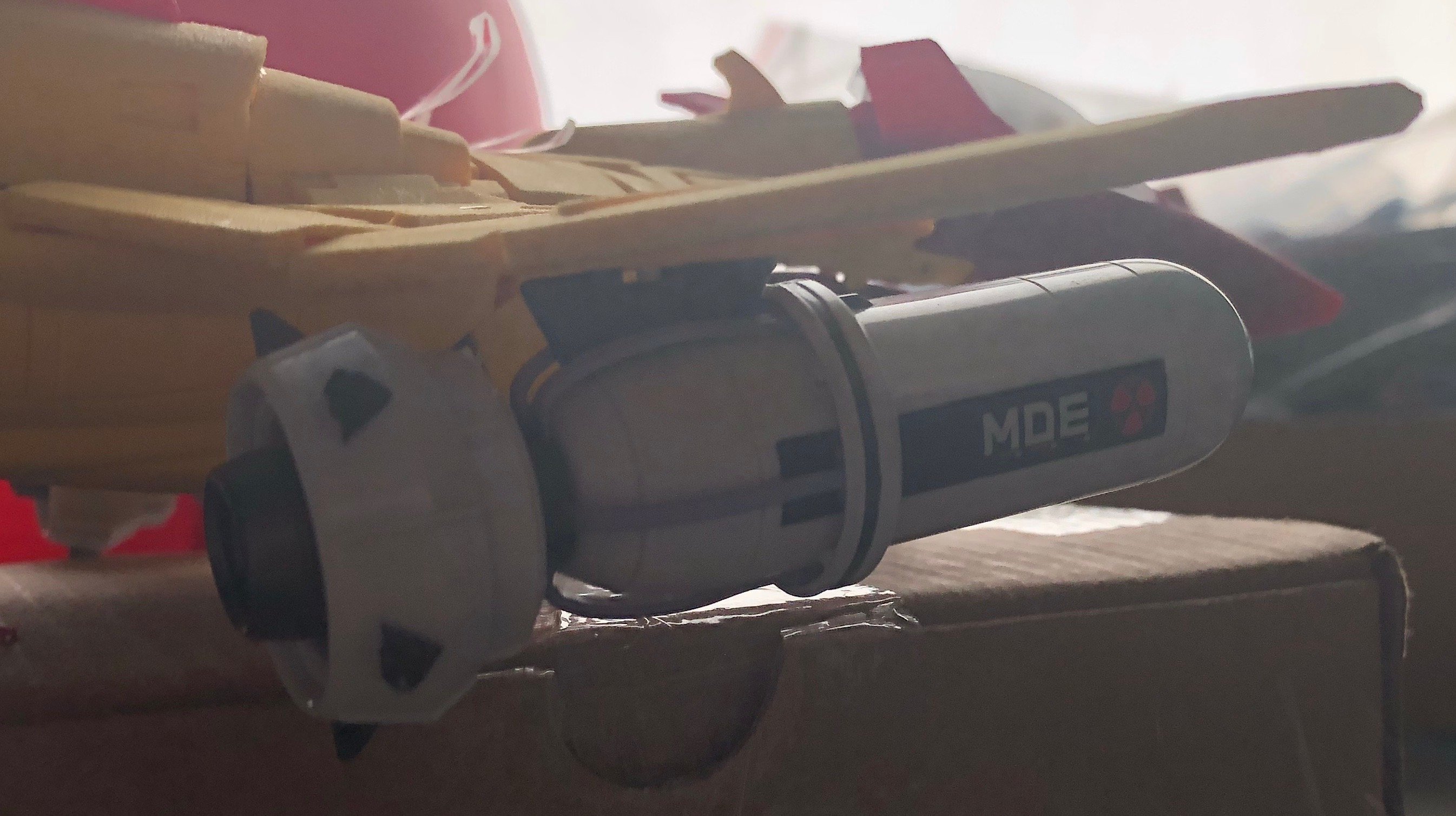

Also have tested the bandai missile and y see the battroid mode attach system Xigfrid engineering is amazing once lock in place is solid as hell (no pins or screws used)

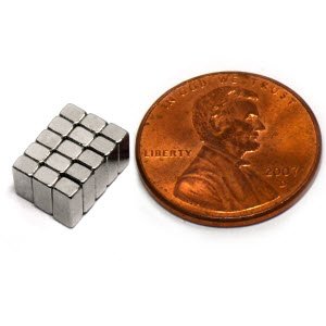

In other news, I'm getting ready to pick up the neodymium magnets. I bought a test sample from this US source last week. ^_^
https://www.magnet4sale.com/bar-block-magnet-neodymium-rare-earth-n50-5mm-x-2-5mm-x-2mm-15-pc/
The downside is that they are expensive here, so I want to make sure that I get the correct amount. Are 4 or 6 magnets required for the final assembly? In the transformation video I was able to spy 4 (and I was thinking of buying 8 to eventually build 2 Valkyries), but I understand that the design has had a number of revisions since its inception. I figure it's best to ask first.
Also, is there a recommended type of glue that I should use to attach the magnets once I get to that step?

For some reason, I can't open the link, but considering this is the correct size (it looks like), you need 1 magnet per wing, 1 per arm and 2 for the gunpod. So a total of 4 without gunpod or 6 with the gunpod.

They are small, but I was off in my post above with the numbers. One order is for a 15-piece bar/block of 5 x 2.5 x 2mm neodymium magnets.
The price isn't as bad as I thought.
