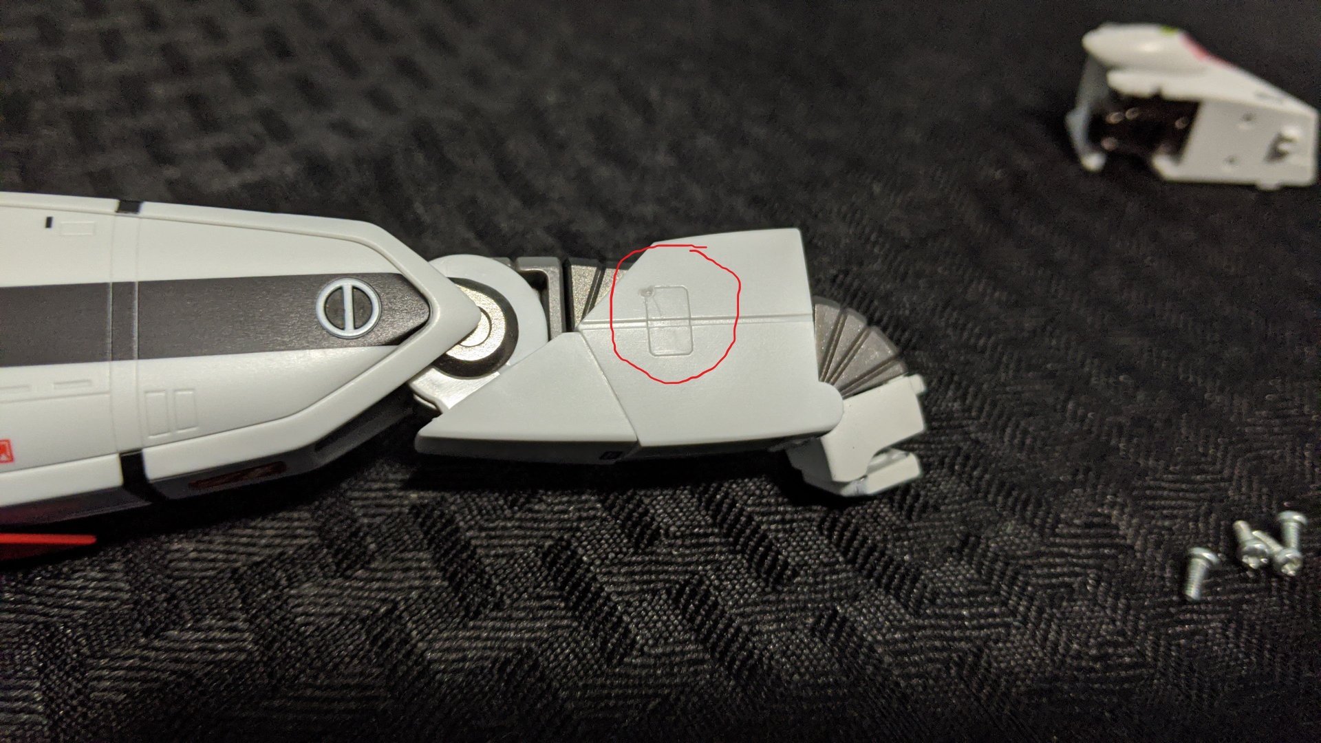

So has anyone ever had this happen to them? Got a sealed VF-1S from a friend of mine and the left leg came off. Any clue on how to fix it?

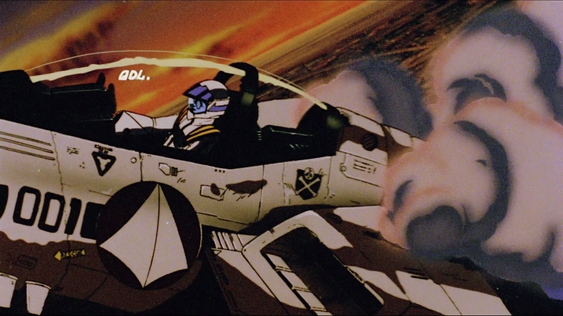

I just noticed DYRL Max is 001 in that pic.
That is Max right, and not some on screen artistic colour variation of Hikaru? I can't remember DYRL much at all, but the blue and glasses suggest to me that it's Max.
Link to post
Share on other sites
yeah max is 001 and black skull too
@Shogun93 yeah, that happened to the first one I got. I feel like someone did a writeup on it. It seems some come from the factory not quite screwed in all the way, and they work themselves out and fall off.
Good news is it can be fixed. Bad news is it is a pain in the ass! The first thing you need to do is track down a very slightly (1mm) longer screw to screw past any stripped part and hold steady. Then you have to disassemble it, then either dremmel the knob off the hinge so it can open all the way, or drill a screw access hole in the metal. Then you put on some locktite reassemble it with the new screw and put it all back together. Search for the writeup, and if you don't find it let me know and I can put more details and pics here.
Was it the left leg? I think it is always the left leg.
Yeah it is the left leg. I’ll look for the write up now but man that does sound pretty intuitive lol.
Edited by Shogun93
Link to post
6 minutes ago, Shogun93 said:
Sounds very involved* now I’m just using words that don’t make sense. What a night.
Well the good news is you didn't break the tabs on the upper part, so it should go back together and hold together forever after it gets fixed. I can post a full writeup tomorrow if you want. It sucks, but it CAN be fixed. I fixed mine and another person's off FB. If you don't want to attempt it yourself, I could even do it for you if you wanted to pay shipping both ways (and you would only have to send the leg). Always happy to help a MW member ^_^ that's what a community is for right?

@Shogun93 and @Red Comet - There is another member that also had the same issue to a degree, @SuperHobo on one of his copy of the DX 1s Hikaru.
Found it after some digging.
February 21, 2020 : Page 400 [almost to the same time that bbilly trolled us with the pic of a 1/48 Hasawaga kit of Hayao's 1a and not the real thing]
@SuperHobo: So I opened up my VF-1S and things were going well until I noticed the left leg jiggled a lot. And after doing a little disassembly I see that Bandai did not screw the hip joint in tight enough and it never quite met the other side of the joint. But in order to screw it back together I need access to the thigh via a screw, but this damn screwhole cover is not budging. Any thoughts on how to remove this screw hole cover? If only Bandai made disassembly easy.
@Lolicon: That cover is most likely super glued on, so there won't be any way to open it without breaking it. Bandai loves their super glue! Parts that I could open on the 1J can no longer be easily opened (or at all) on the 1A and 1S thanks to Bandai just going hog wild with the glue.
Bandai wants to deny you the color scheme you desire. Like a certain paint scheme? Bandai won't release it. Think you'll just make your own custom? Bandai will make it damn near impossible to do any disassembly whatsoever.
@SuperHoboUghhhh if I can't get the screwcover off, in order to screw in a loose screw holding the thigh to the intake, I might just glue the damn hip. Sigh oh Bandai.
@Chronocidal: So, as an alternative, what if you drill out the screwcover, just accept that the cover is a lost cause, and make a new one after fixing the leg?
Personally, I would try and cut the cover in half by drilling small holes down the slot in the center, then pry it out.  Then if the halves are still good, sand away what remains of the recessed slot, and glue them together around a thin slice of plastic to rebuild the cover.  The slot won't be as obvious if it's a slightly different shade of plastic.
@SuperHoboI was able to take the screwcover off via a super thin hobby tool. Only a tiny corner was glued in. Now, to fix the rest of the thigh....
After that post, I've lost track. Superhobo did end up fixing it and sold it for less than asking price for it.
