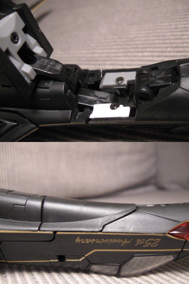

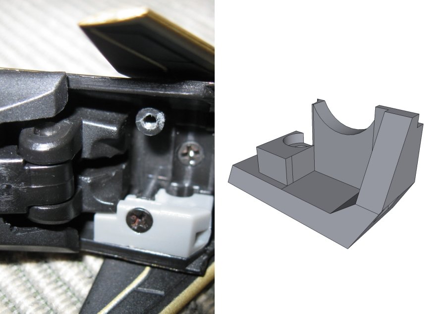

Back when the VF-1 shoulder replacements were announced, a lot of people asked if the YF-19 would be next. I tried tackling the tricky fuselage hinge part and have got something that is ready to be tested. If this works, I will make it available on my shapeways shop so you guys don't have to say how many you want.

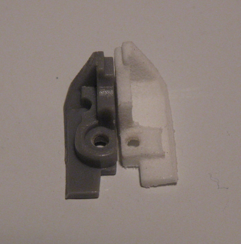

Neither of my YF-19s ever had a breakage so I had perfectly fine parts to work backwards from. My replacement doesn't match the original exactly because the stock part is designed to save on plastic as much as possible. My part will be done in White Strong Flexible so it should be plenty sturdy.
I'll update this thread when I get the prototype in for testing on a YF-19.

just wanted to give you guys an update. I got the part and it still needs some minor adjustments. The good news is I shaved off some plastic from it so the final piece will cost a few cents less :3

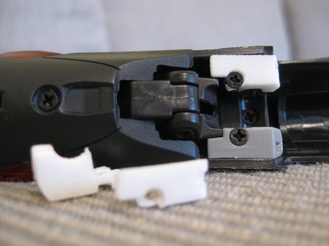

hopefully either this week or next week I will order up the latest revision. I shifted some things and deleted a lot of excess areas that aren't needed in a replacement made from Polyamide. I feel like I'm learning things as I go along.

I ordered up the latest revision. I know this is taking some time but this piece needs a lot of precision to work right so I have to test it each time.

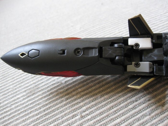

Just got revision 3. It's millimeters away from working perfectly but I insist on testing it before turning them loose.

Alright I think this is the final version of the hinge. Or the final version I feel I need to test. I increased the size of the area around the screw hole so it matches the original part and also prevents the screw hole from splitting.
This is at the point where any further adjustments are at the mercy of Shapeways' printing tolerances. With some minor sanding I was able to get the gullet plate almost perfectly flush. I did do some tiny adjustments after this but the final product will be mostly the same.
So my question is are you guys satisfied with what you see so I can turn these loose? They're going to be sold as a set of hinges.
