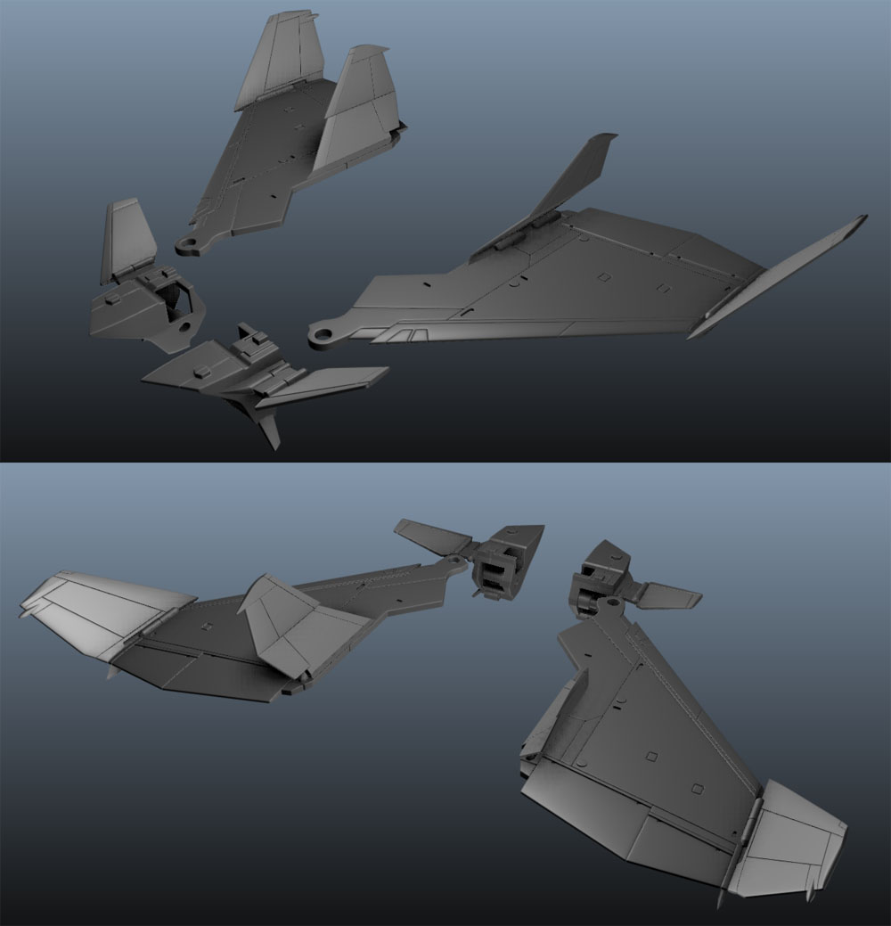

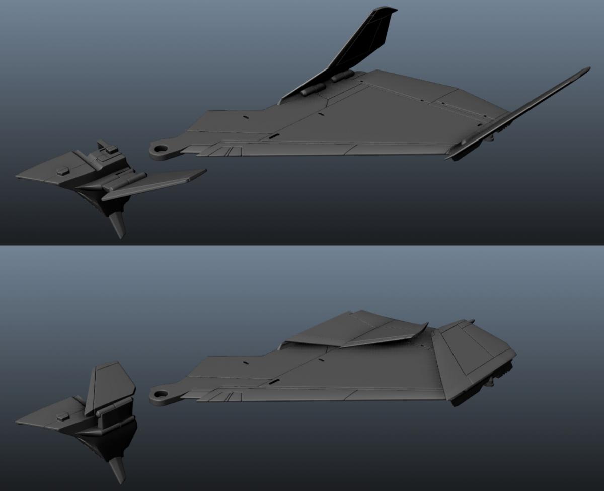

Ok fellas - its boiled down to this;
Due to the angle of the shins in fighter mode - I can't make the bridging plate that would cover the space between the delta wing and unfolded back-pack plate (my original idea was to make this plate to be glued to the back of the shin, this would lock the legs to the delta wing and also be the base of the v-stab). So my option is to make a new shin - which is a lot of work and I want to put this on shapeways ASAP (running pretty low on funds... I won't be even able to order this when it is uploaded :() - even though it may help later on down the track when I begin the leg armour for the PWS-0X. I also tried to angle the double-knee joint as the VF-1 does for FAST pack attachments - this makes the Zero floppy.
So - my solution (and it will rub a lot of people the wrong way) is to attach the the v-stabs to the inner edge of the delta wing, VF-25 style - it will fold and sit partially flush, I say partially - cause they're partly angled!
Pics up soon - thoughts on this?

Thanks Mommar! And thank you for the offer - it is really generous, but I couldn't accept that, that's asking too much! It does make me proud to be a member of this forum tho, this community is awesome. I'm just going to hope I can score some freelance soon! But in any case - thank you for the gesture, Mommar - lets see how this all goes ~ I may just have to take you up on the offer if I can't wait until March next year!

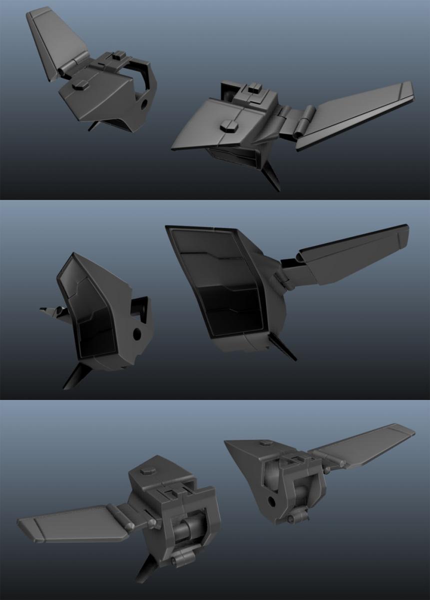

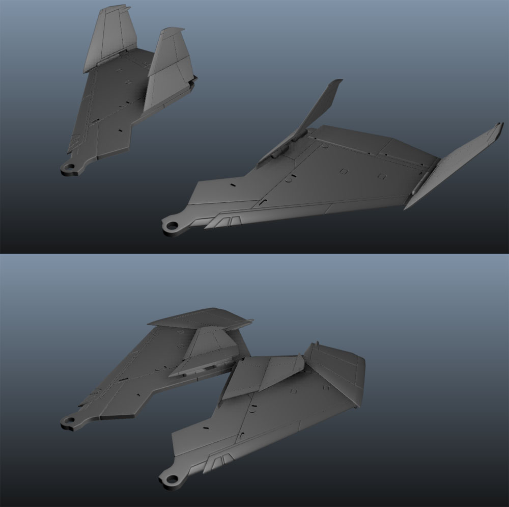

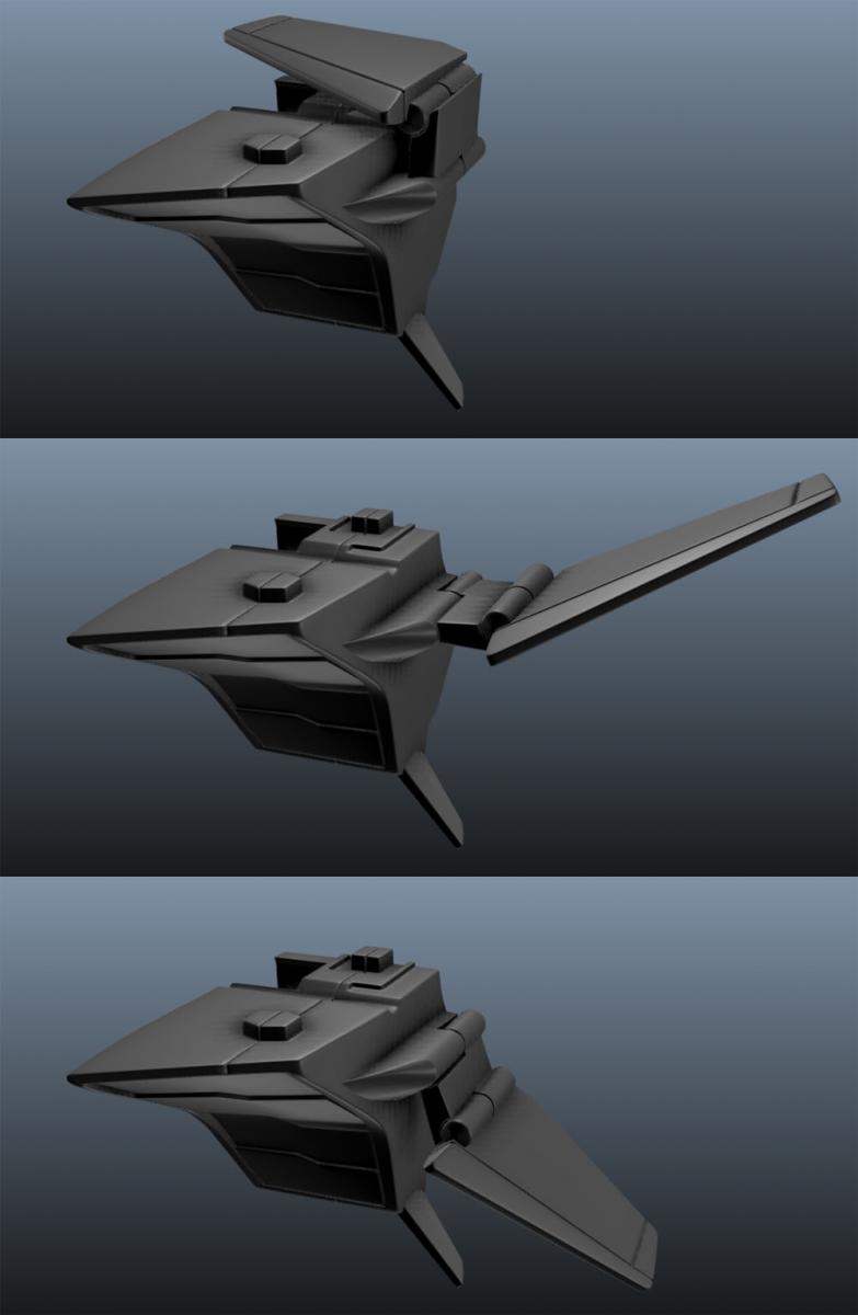

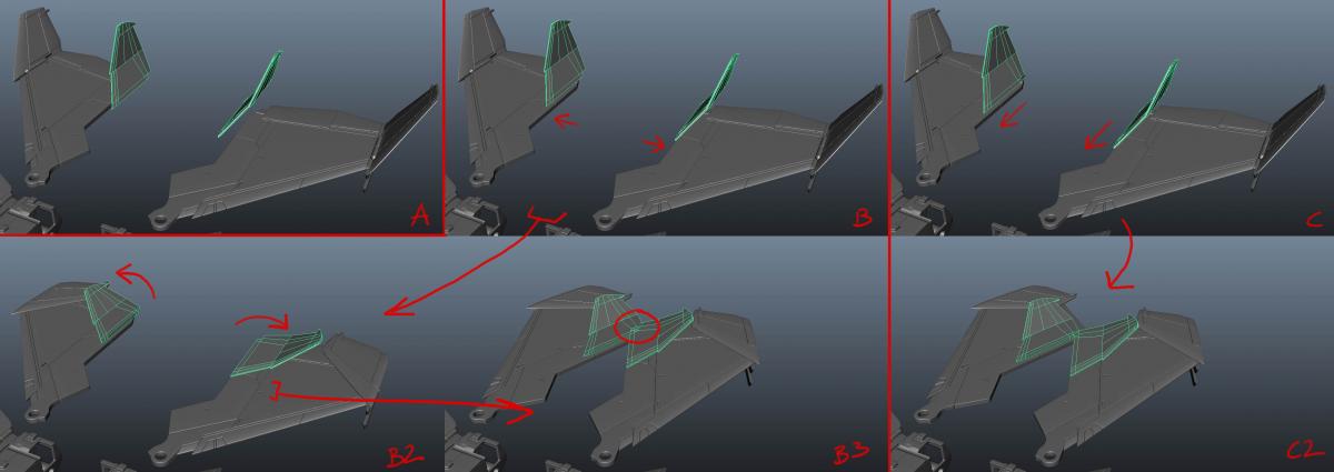

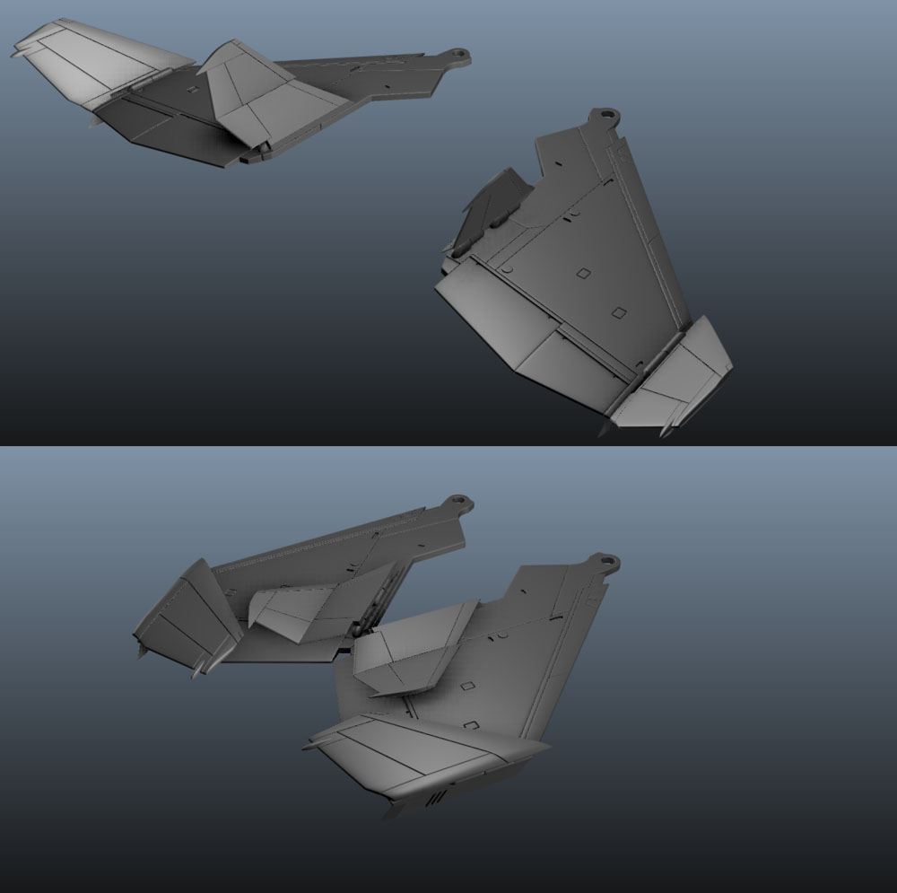

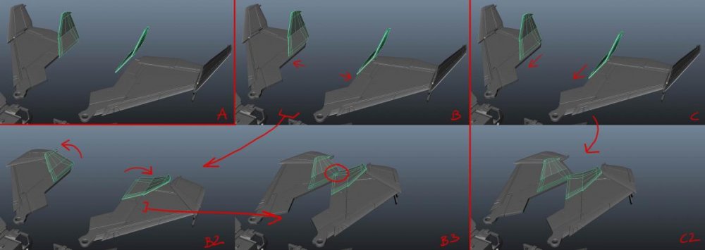

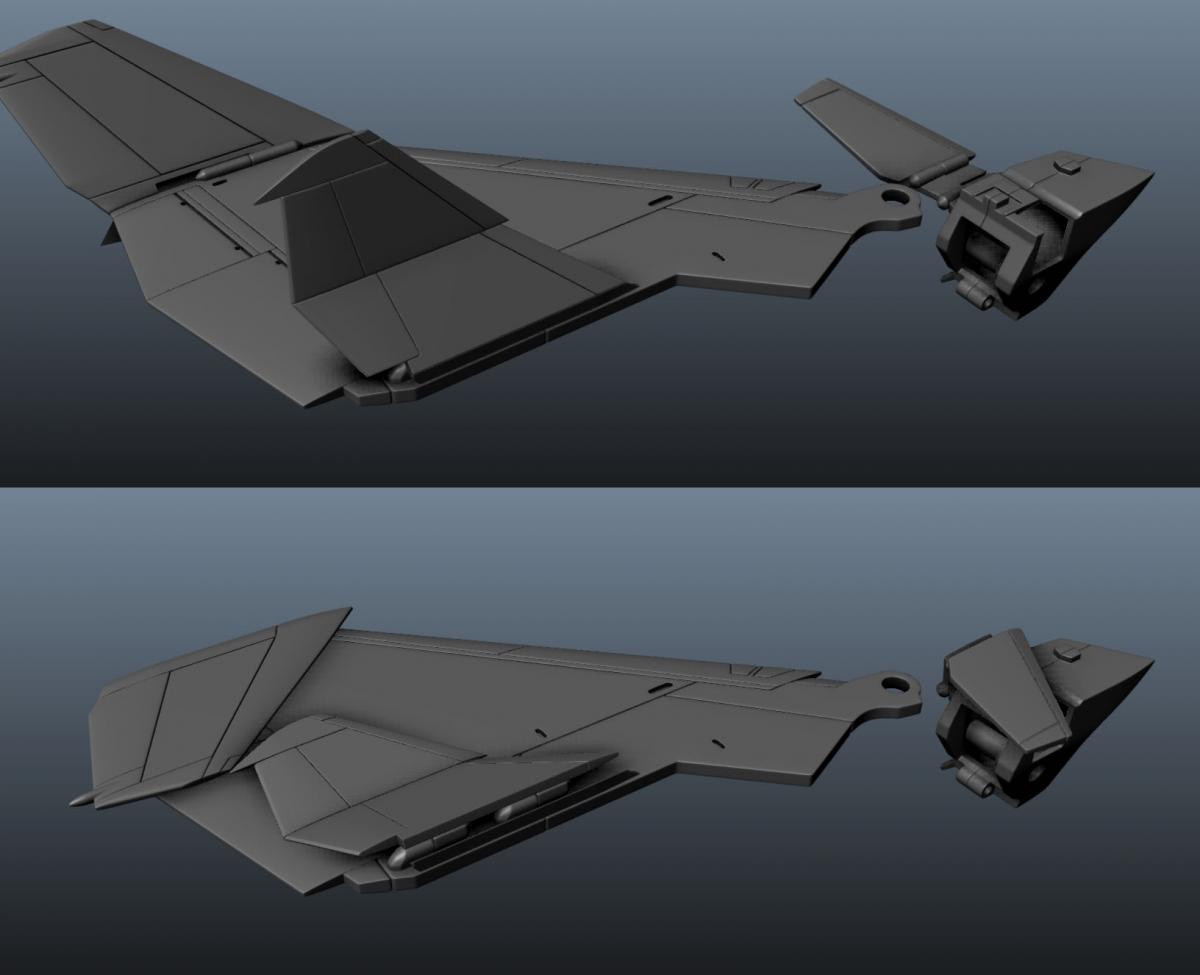

So, without further ado here is the v-stab wip;
Picture A shows the V-stabs in the position they should be in.
Pic B shows them moved to the side to in the approximate postion they'll be with the swivel component missing at the base.
Pic B2 shows how they'll fold down for battroid.
Pic B3 shows that the bottom end tips will intersect if they stay in this position - I could shave these tips off at an angle - but I'm already fudging line art here...
Pic C shows the v-stabs moved forward slightly to allow the v-stabs to not intersect when swung back, such as in Pic C2.
After adding all the panel lines and small details - I just need to polish the proportions and detail on the long-neglected head-unit!
EDIT; Why do all my pics get re-sized always when I post?

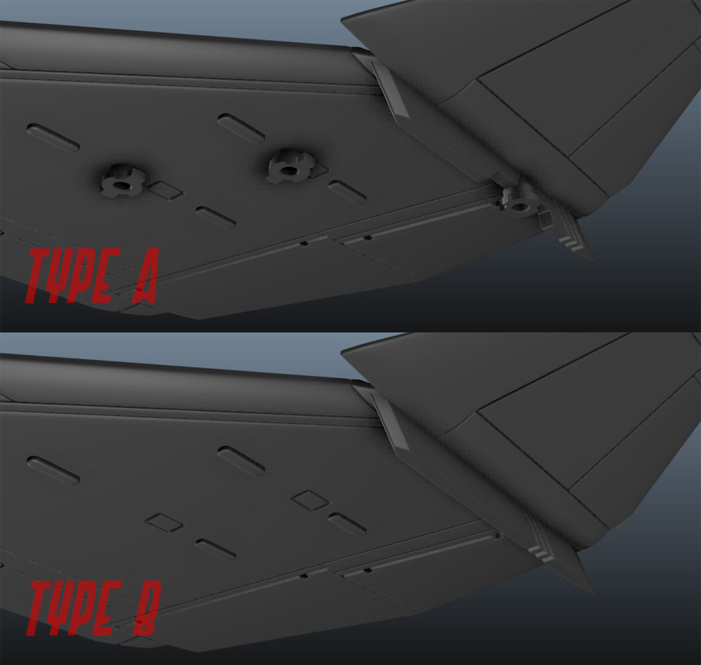

OK - here we go!
VF-0C Converison Kit type A; http://www.shapeways...oductBox-search
VF-0C Converison Kit type B; http://www.shapeways...oductBox-search
post-1623-0-74441600-1353047372_thumb.jpg post-1623-0-91518000-1353047362_thumb.jpg post-1623-0-97280000-1353047356_thumb.jpg post-1623-0-76837400-1353047360_thumb.jpg post-1623-0-68808600-1353047364_thumb.jpg post-1623-0-82452400-1353047369_thumb.jpg
These are of course un-tested, but they are up for order - so you may get to the point a few days after you order and it'll come back as 'un-printable' as Shapeways have tightened up their tolerances rather crazily. There are some pretty tight tolerances on this model - enjoy!

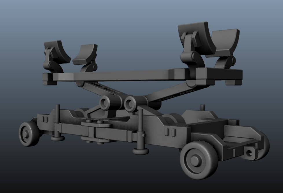

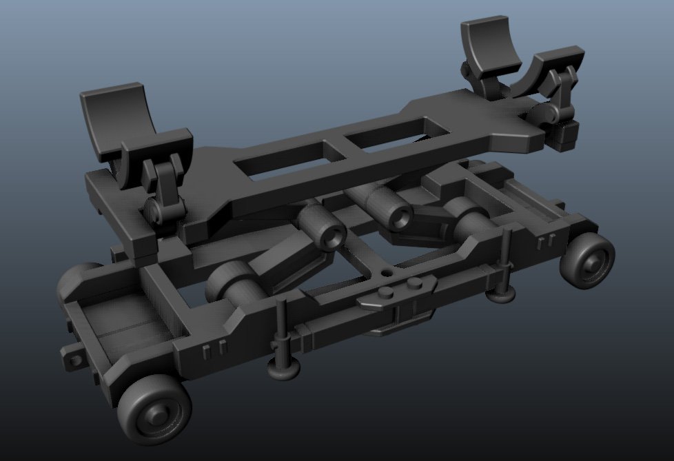

So made this today;
post-1623-0-45683300-1353417330_thumb.jpg post-1623-0-21837600-1353417336_thumb.jpg
Available here; http://www.shapeways.com/model/784295/gunpod-cart-fenix.html?li=
Made one for the VF-1's gunpod too; http://www.shapeways.com/model/784300/gunpod-cart-valkyrie.html?li=
