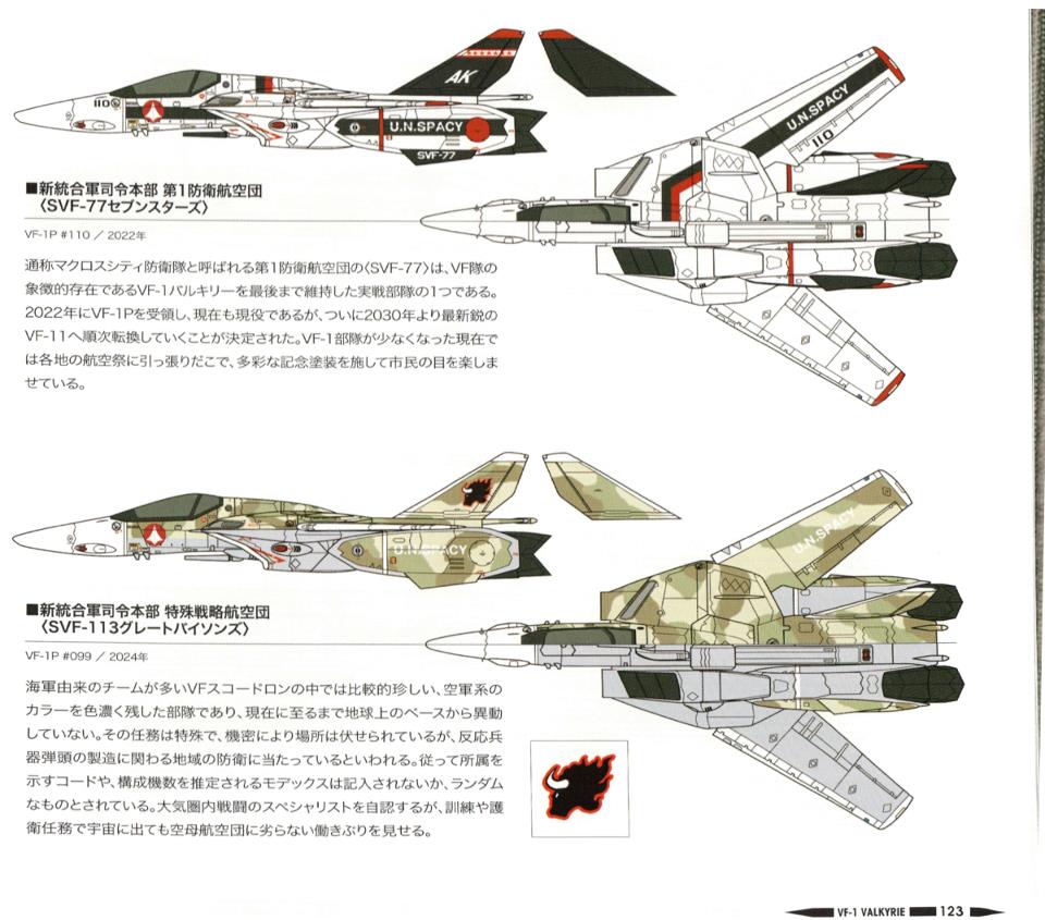

Also I'm still waiting on some suggestions for a paint scheme before I start priming and painting.

Well that's one for Alaska Base.

Theres the camo suggetion. Lets get a tie breaker and I'll get to work on it.

Camouflage
I did a VF-1 Battroid in this pattern.
Macross the First VF-1
Building right now, but at the rate I'm going, you'll probably finish before me.

For me it's now a toss up between "The First" and "Alaska Base". I'm not a huge camo fan with the exception of the Low Viz.

Decided to go with the Alaska Base scheme since it's more on par with my skill level. However, I will get a 1/72 Hasegawa and do a Macross the First scheme on it one day.
