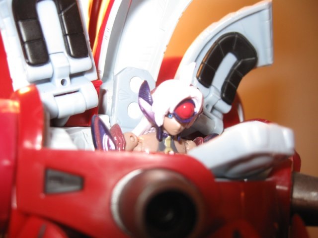

Here how the thing happened @ home:
those were playing gently together until...
And so...
U mad? LoL!
The offender was arrested and so began the fixing journey...
