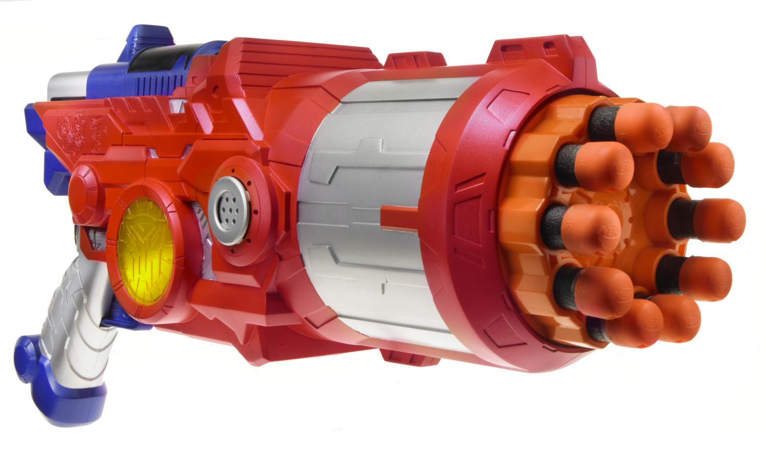

I was looking at a catalog of upcoming toys for Transformers: Dark of the Moon and saw that Hasbro will release a new Optimus Prime Nerf blaster. It's a 10-round pistol unit that looks like a modified Dart Tag Hyperfire with light and sound effects.
Hmmm, after buying some of the underpowered Star Wars Nerf guns, I'm a little leary of licensed Nerf spin-offs :)
