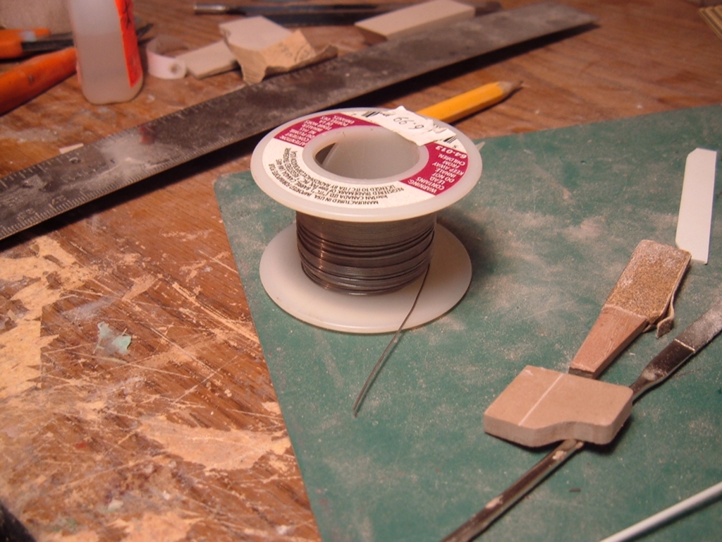

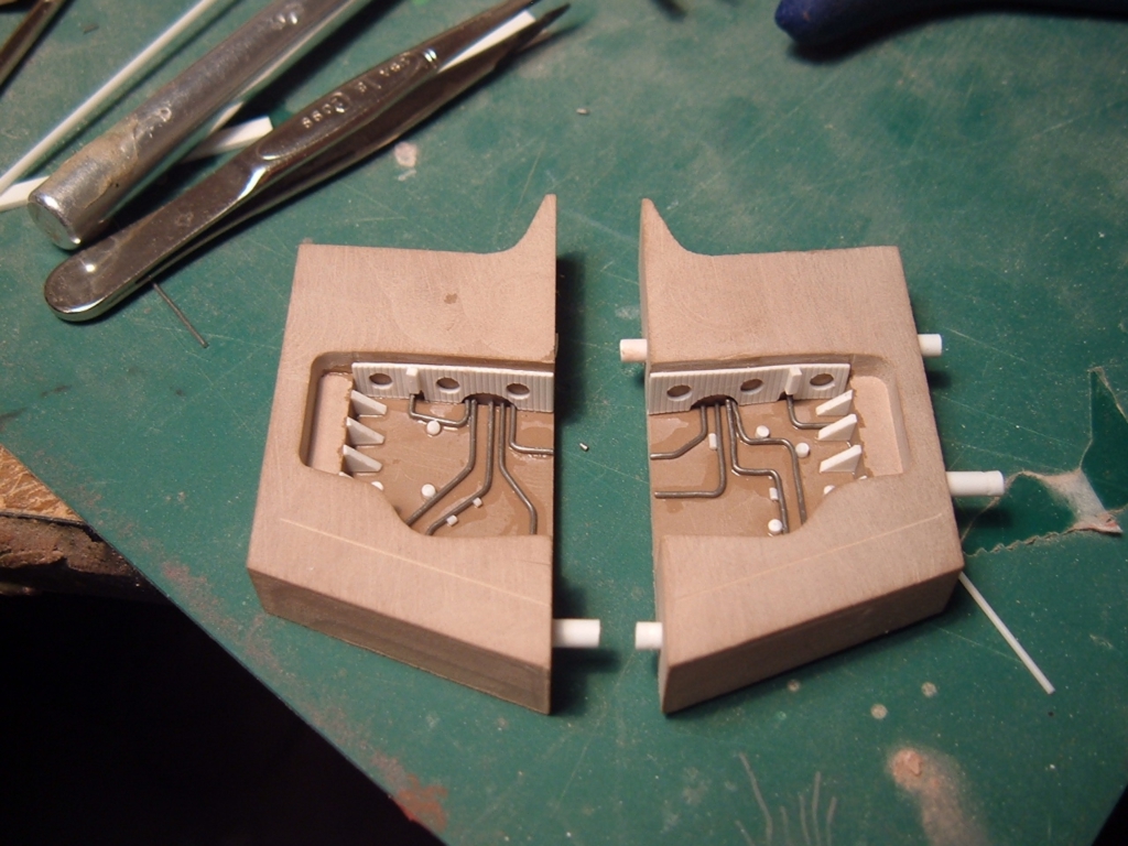

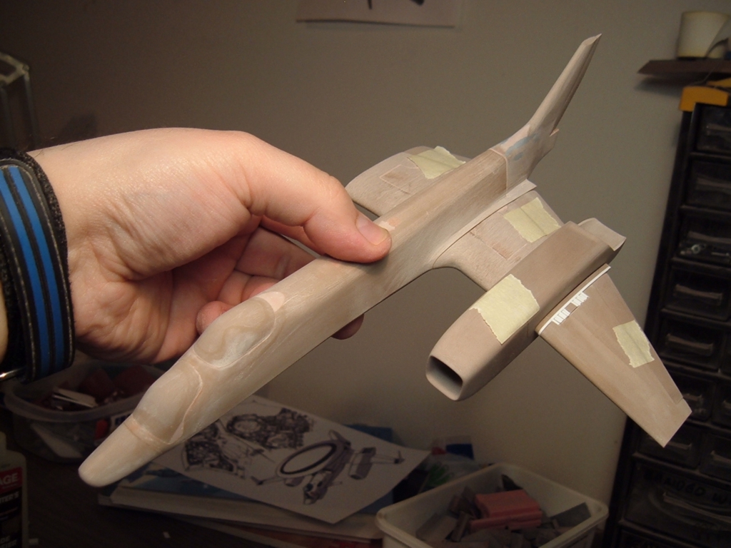

Pic 1: solder. It makes soldering possible. It also makes super-detailing possible—and fun! Its easily pliable nature and availability in several different diameters makes this a wonderful tool for adding wires or piping to a model.

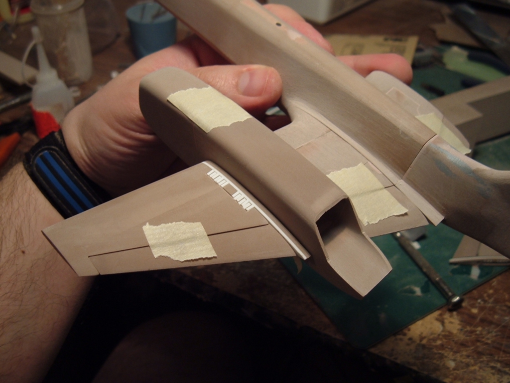

Pic 2: this is just one example of what solder wire is good for. The main gear bays are now starting to take shape. I don't normally get so busy with detailing so early into a build, but the nature of this project requires a much less conventional procedure.

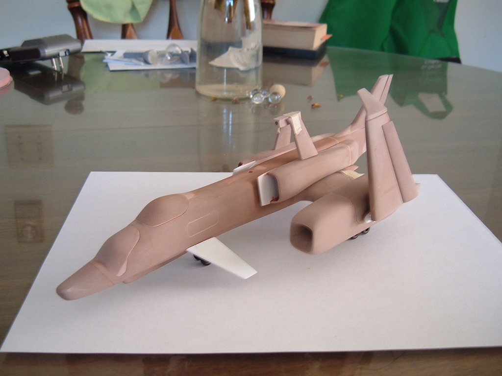

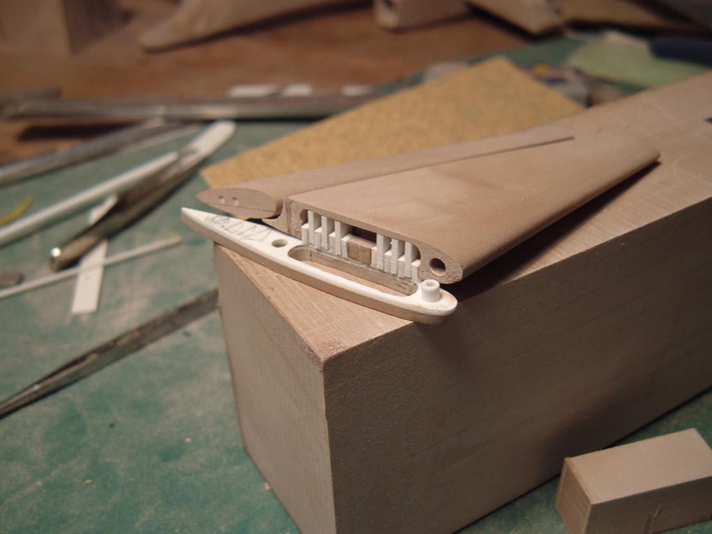

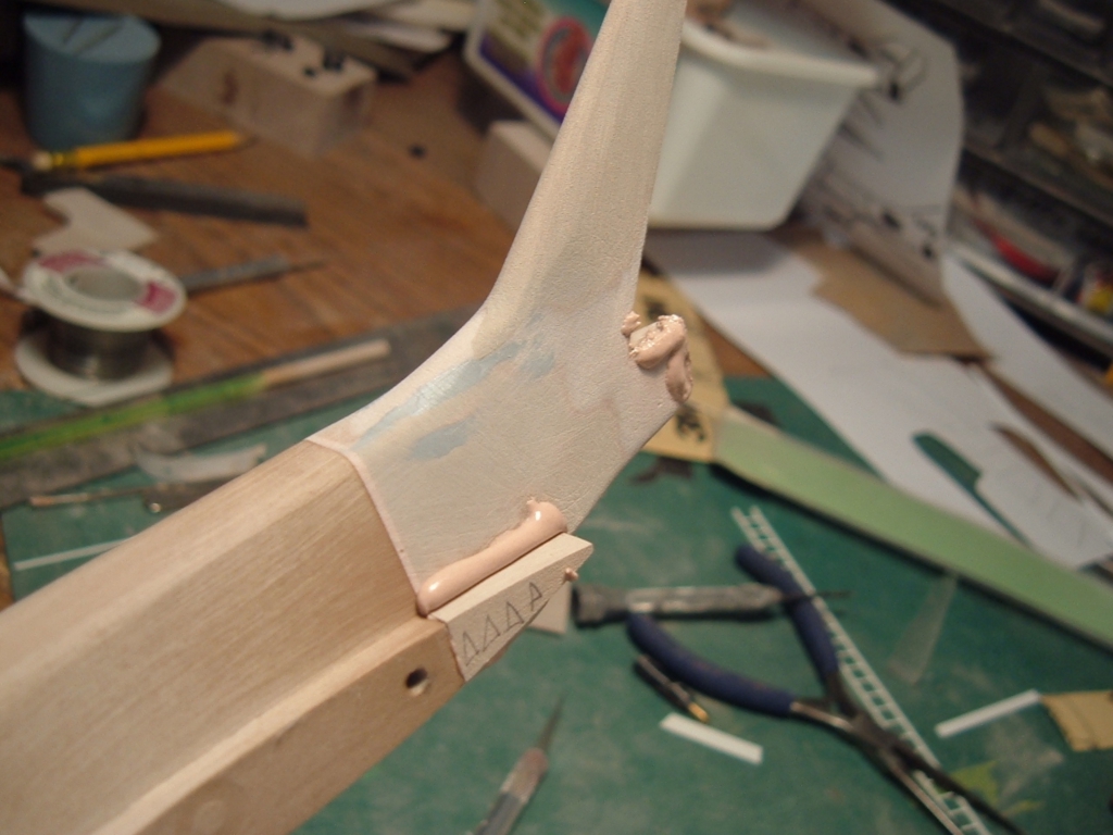

Pic 3: the aircraft's V-tail undergoing some spot putty repair. Due to the complex nature of the shaping of the tail, I couldn't just carve the whole thing out of one solid block, so certain structures are added gradually along the build process to ensure that the kit has a good foundation and good symmetry.

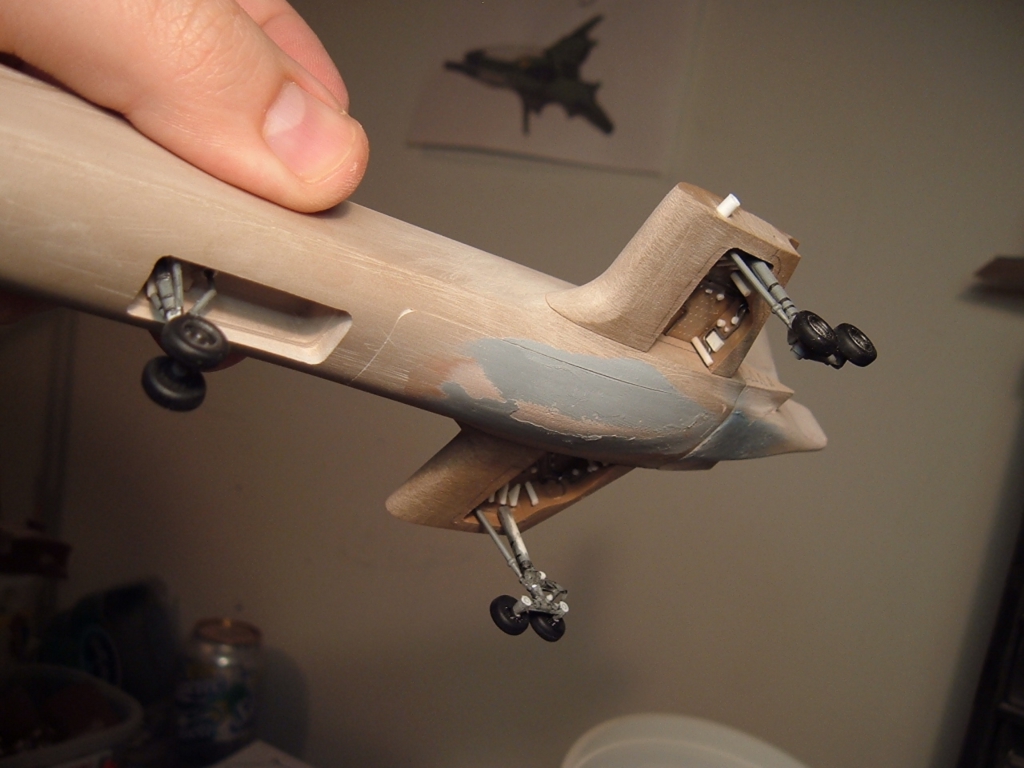

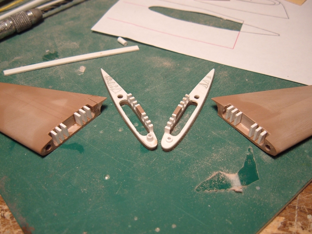

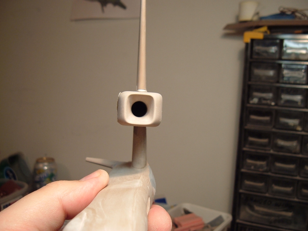

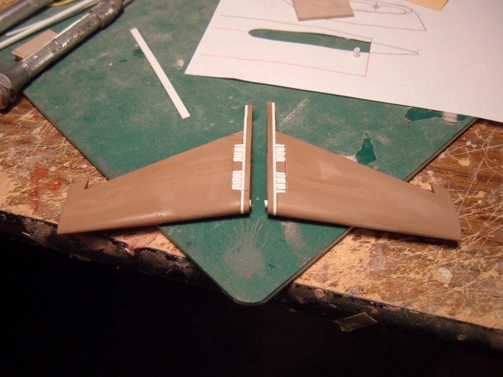

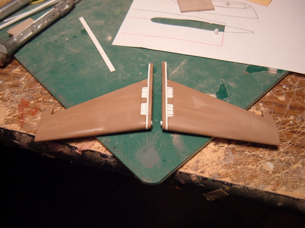

Pic 4: the aircraft's sto-wing folding mechanism. The interlocking teeth you see were all added one by one, by hand.

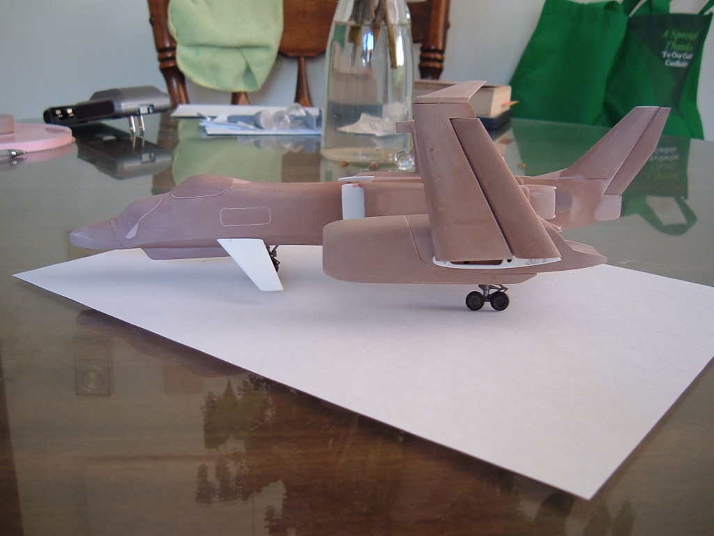

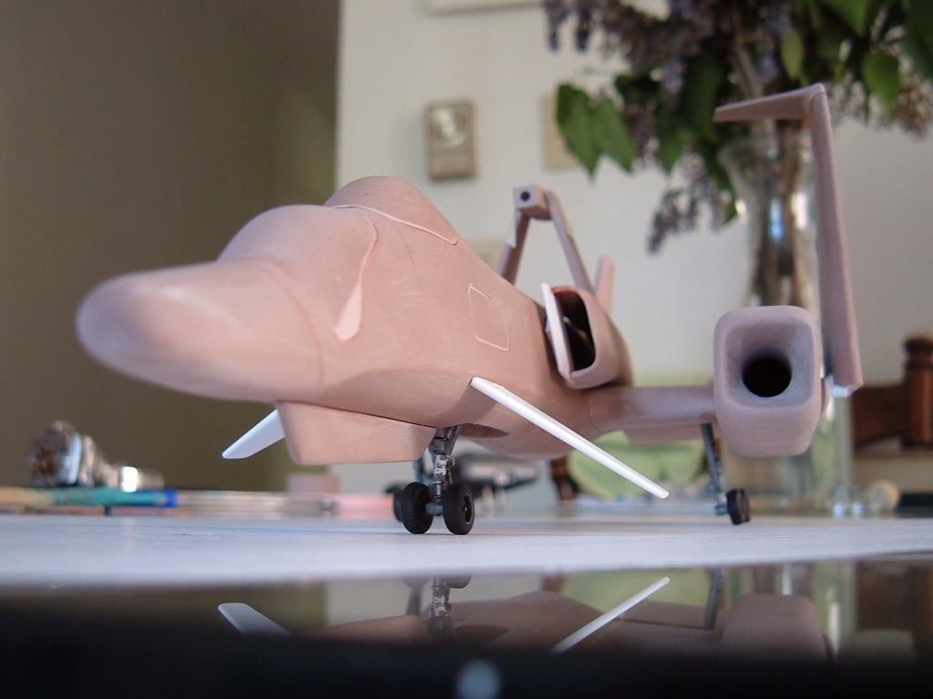

Pic 5: here, a more detailed view of the mechanism; the stub attaches to the engine nacelle. There will be a bit more detailing done to these parts, but not just yet.

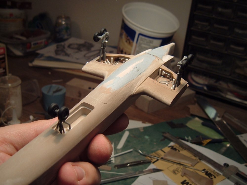

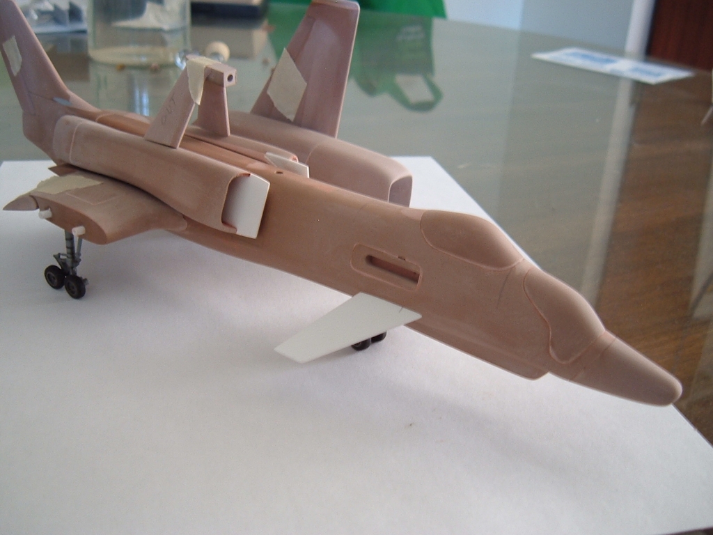

Pics 6 and 7: here we have the newly-converted double-bogey main gear and nose-gear being test-fitted. The struts themselves still need to have some parts & detail added, but for now I will content myself with the knowledge that everything fits.
Pic 8: once again, testing for symmetry and fit. A-OK so far.

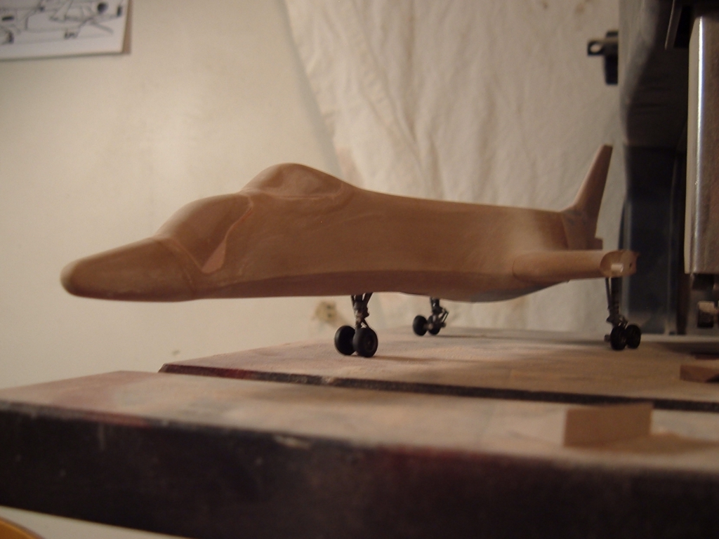

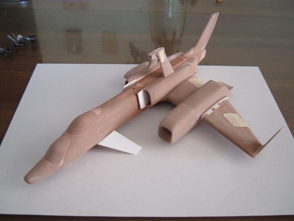

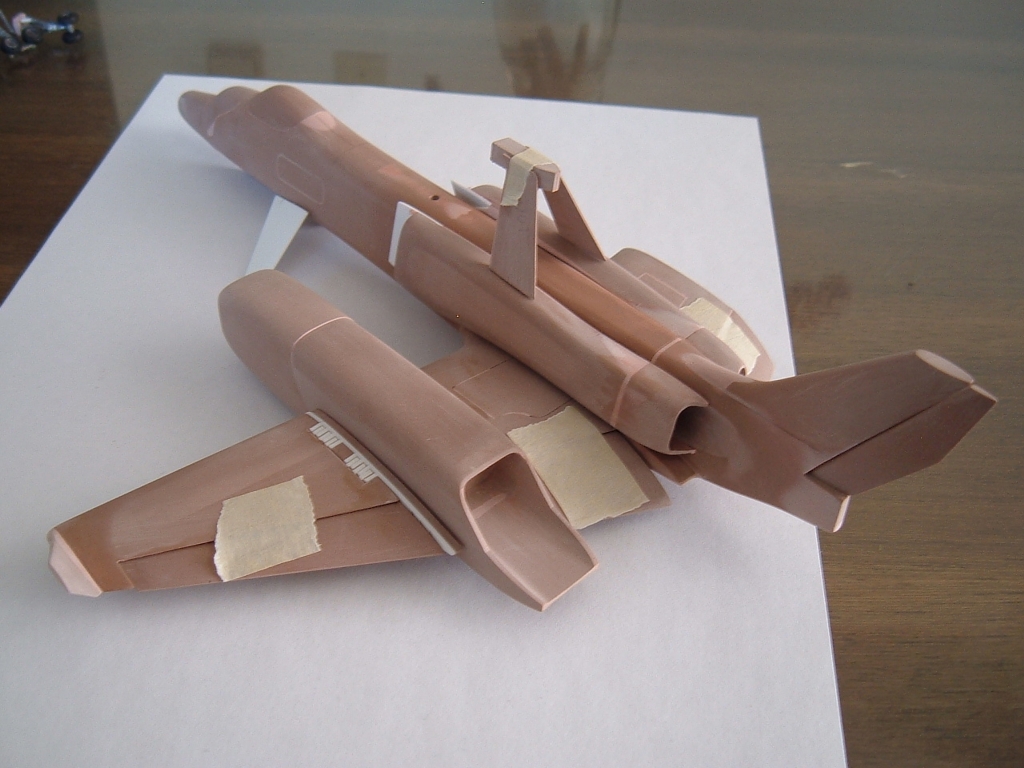

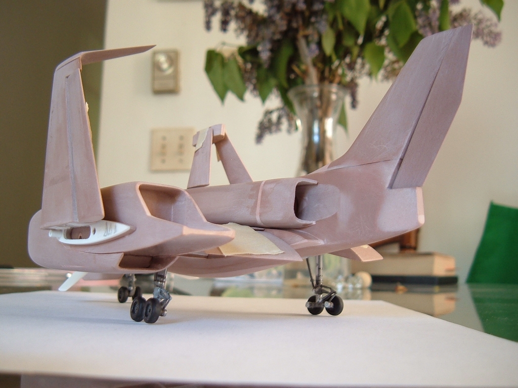

Pic 9: I'm test-fitting the main fuselage parts, and everything looks excellent! As you can see, the engine nacelle is now properly rounded. The main fuselage now sports the bucks for the canopies, and the wings have their trailing-edge flaps secured temporarily with tape. The rear V-tail also has a separate flap, so the builder will have the option to build the plane in flight (wheels up), on the ground with drooped flaps & wings extended, or on the ground w/wings in stowed (folded) position.
Oh, did I mention that I plan to add a mid-air refueling probe? Just seemed like a natural (if not critical) thing for a carrier-based bird to have, so that's just one more display option... Now I just have to find a place to put it (those mid-fuselage intakes prohibit putting the probe in a more “conventional” location.)

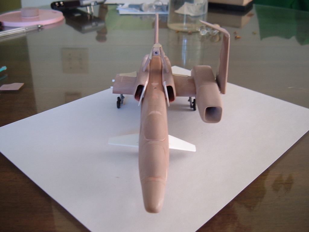

Pic 10: front view of the engine nacelle. I may still round the top & bottom slightly.
Pic 11: a better view of the flaps. This bird's wings have absolutely MASSIVE chord!! I was contemplating leading edge slats, but trust me, she doesn't need 'em! In fact, I have to wonder if the drag they produce doesn't outweigh the lift benefits...
Pic 12: here is the wing fold mechanism again, this time with the trailing edge flap attached. Not finished yet, but looking great so far.

Wing fold mechanism? I didn't expect that!! :o Awesome! This is a kick ass for Tanmen version!!

It seemed only natural, as all navalized aircraft have a Sto-wing mechanism to reduce their footprint shipboard. Gotta take into consideration that the Cat's Eye's wingspan is roughly 1.5 times that of the YF-23 :mellow:

ooooo since this bird is gonna be heavy I hope the gear is metal cast. I doubt wire re-inforced resin cast gear is gonna stand up terribly long....
I second this, but he may not have budgeted for it.
Anyway, amazing work captain. The detail on this bird is amazing so far, looking forwards to more!
Link to comment
Share on other sites
Brass rod inserts will do a better job than pewter any day of the week.
But you'll add a brass rod in the cast of landing gears of we should add it in the building? unsure.gif

Captain's log, Friday, May 21st. She's almost done! There should be another two updates left and the Kaa 'Tsai will be ready to mold. In spite of the fact that it looks like a drunken sailor barely able to stand on his wobbly legs and just looking like total @$$ in the photos, I assure you that this is because it hasn't been primed yet, but the shape of the plane is there, and it's a beauty!
Sadly, because of the delicate nature of the parts, it's rather challenging to get the whole thing to hold together without unsightly masking tape and a little drooping here & there, so I must ask that you bear with me just a little longer. I promise, it'll be worth it.

-As mentioned previously, the landing gear will be reinforced with brass bars.
