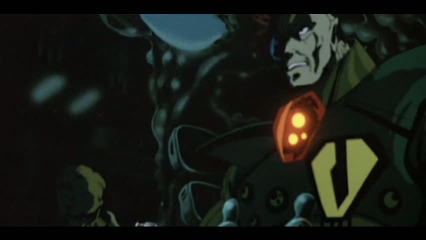

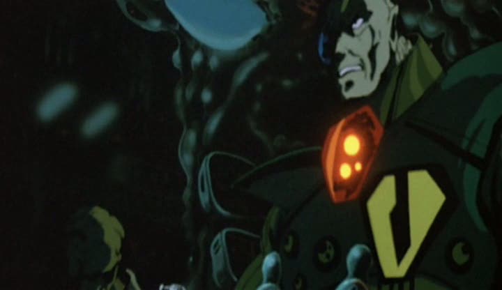

I re encoded the video with Tmpeg encoder software and then compared it to the remastered dyrl video. There is not much video quality difference between the new cotb and the remastered dyrl that I can see, so I would suppose that that tmpeg filters don't necessarily help the video quality. The tmpeg filters were most likely the cause of the gamma changes from frame to frame. But, I'm not a big fan of film grain, especially in the remastered dyrl.
Here are snaphshots of dyrl remastered with subs and the cropped cotb version of one zentradi scene.
So, it looks like I can plug this version of COTB into the dvd.

Here's a snapshot of how COTB will look like. Aspect ratio is the same as remastered dyrl and it looks like the film grain is back in.
I did some slight video editing to COTB 2.0. I took out the "boinger productions presents", redid the Macross Fan Edit logo, and stuck in my name and Gubaba as translator in the end credits. Looks a little nicer that way!

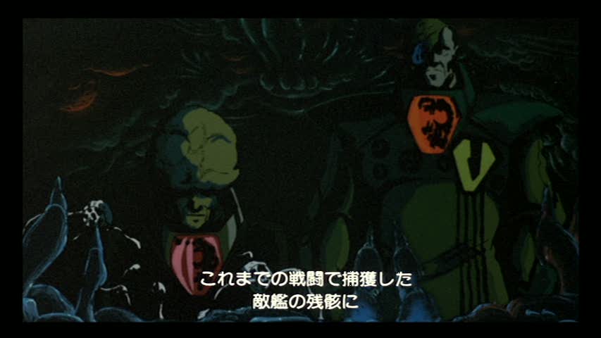

I indexed all scenes with subtitles and rough evaluate needed work to fix it.
So
80% can be repaired by simply copying from unaffected frames,
10% will require advanced mullti layer copying with zoom, resize, rotate
and last 10% need hand redrawing :angry:

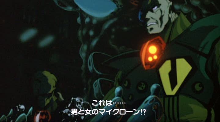

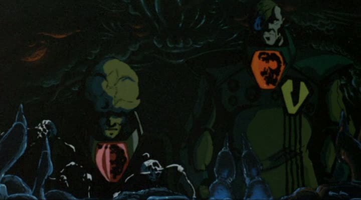

I think I figured out why I have had problems with the aspect ratio when encoding this movie to widescreen 720x480.
I remember that I had originally made an DYRL remastered .avi with AutoGk from the remastered DYRL dvd video. I picked out maximum resolution under AutoGk settings and AutoGk came out with an odd resolution of 768x432. So, I remade an .avi of remastered DYRL with AutoGk and the aspect ratio/resolution is now 720x400.
The original remastered DYRL DVD video has a resolution of 853x480!
I plugged in that new 720x400 resolution video through Tmpeg using settings 16:9 with Full screen (aspect ratio1). The bottom of the video is cropped to take out the Japanese subtitles. I think the video looks better.
Even if I do not crop the japanese subtitles, widescreen resolution is 720x480 though my video editing software. Tmpeg might have a custom aspect ratio/resolution. I'll check again.
Tmpeg has center custom display settings that can be set at 853x480, which still doesn't look right and the movie still gets encoded as 720x480. I'll keep trying different settings. I think I'm close

Hmm..
Looks like removing subs will take more time and work when expected.
Video ever with same content little shake, frames not aligned, but cloned patch stayed in same position, in play it look like cloned patch live his own life on video :angry:
Drawbacks of old film technology, but i need to carefully align patch on each frame, time consuming work.
VideoPaint have many limitation, so i found new proggy to do the job - TVPaint Animation, but i still learn how to use it.

Unfortunately, if you're going to literally crop out stuff, you'll need to resize the whole thing to maintain aspect ratio. You know, like using the fixed-sized marquee tool in Photoshop. You're going to be losing data if you crop anything, so, from my point of view, only crop stuff when absolutely necessary -- like when you accidentally get a tripod or light stand in the shot. Burned in text? I kinda feel like leaving it won't kill anybody. Or, alternately, you can always paint it out! It's only 12 fps max. So, you're looking at... a bazillion frames or so.

So, when I crop the subtitles and keep the aspect ratio, the scene has different sized top and bottom bars. It looks like if I keep the aspect ratio, crop out the Japanese subtitles and pan into the scene, then I would lose a lot more of the scene then if the aspect ratio is a little off. I tried panning into the scene with the right aspect ratio and the video editor started zooming in to the video with the right aspect ratio instead of making the video sceen size larger to match up with the other video. I haven't figure that out yet.
I have been cropping the zentradi scenes because that's how it was on Clash of the Bionoids and that's what I wanted for this fan edit. If you would like to extract the audio from the Clash of the Bionoids fan edit and put it to together with your version of DYRL, then go right ahead.

I was just thinking that if I remove the crop filter, zoom in to the scene to block out the Japanese subtitles and then make some adjustments by panning the scene, then aspect ratio will not be affected. I'll play around with that tomorrow and see if it looks okay.
Fixed the pop sounds in womble. The problem pop sound wasn't due to the womble update patch. I was re using the audio from the COTB 2.0 avi file, but Womble can't decode the sound from the .avi properly as a sound file. So, I extracted just the .wav audio file from the COTB 2.0 .avi and now the pop sounds are gone.
I tried zooming the japanese subtitles out, but when I tried to pan down to get a better view, the whole picture pans down insteand of just within the frame panning down. Maybe, if just use the pan function and skip the zoom?
Just before going to work, I tried just panning the zentradi scene while maintaining the aspect ratio and found that it was what I expected: too much of the picture frame is cut out . That's that.

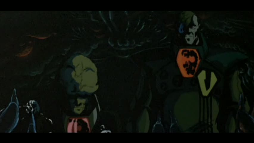

First result of removing subs. I learn enough TVPaint to do that.
At first look it may look as easy copying, but i need to align each copied patch to compensate frame jitter and color correct it to match target frame.
Archive had two video: one - only sub was removed, second - +noise filtered and zoomed to compensate black bars. Encoded with MSU lossless codec - included.
