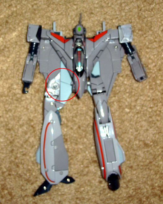

I don't know if this have been discussed here already, but I'm gonna give it a shot. My vf-11b hip and leg part are broken off. Is there any solutions which I can do to fix it? It would be nice if we can still order parts from Yamato, but that doesn't seem like the case. Anyways, I've provided a pic of what I'm referring to.
to177
There's lots of posts on the subject, and a search will find you the good details, but the long and the short of it is:
1) Open up the leg, so you can remove the hip peg.
2) Using a brass pin, and perhaps a pinvise (a small hand operated drill), drill a hole into the piece that's broken off. Glue the pin in place using either epoxy or superglue (your choice)
3) Make a corresponding hole in the proper place on the VF-11 (where the peg broke), and after test fitting and cutting of the brass pin, glue the broken hip piece back on. If you're using epoxy, it might not be a bad idea to let it ooze out a bit, you can sand the excess off later.
4) After the glue is good and dry (24 hours to be safe), put the whole thing back together again.
