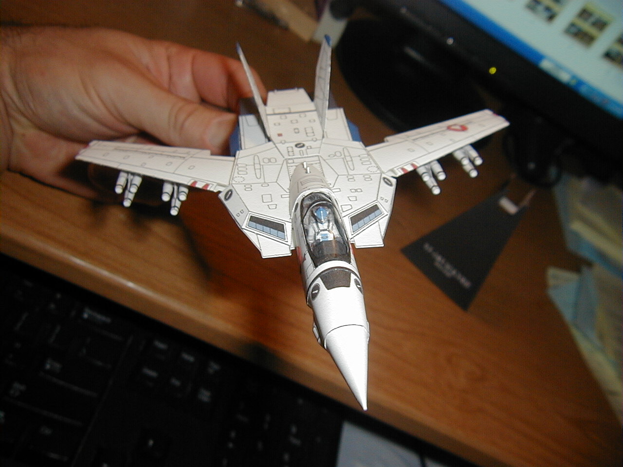

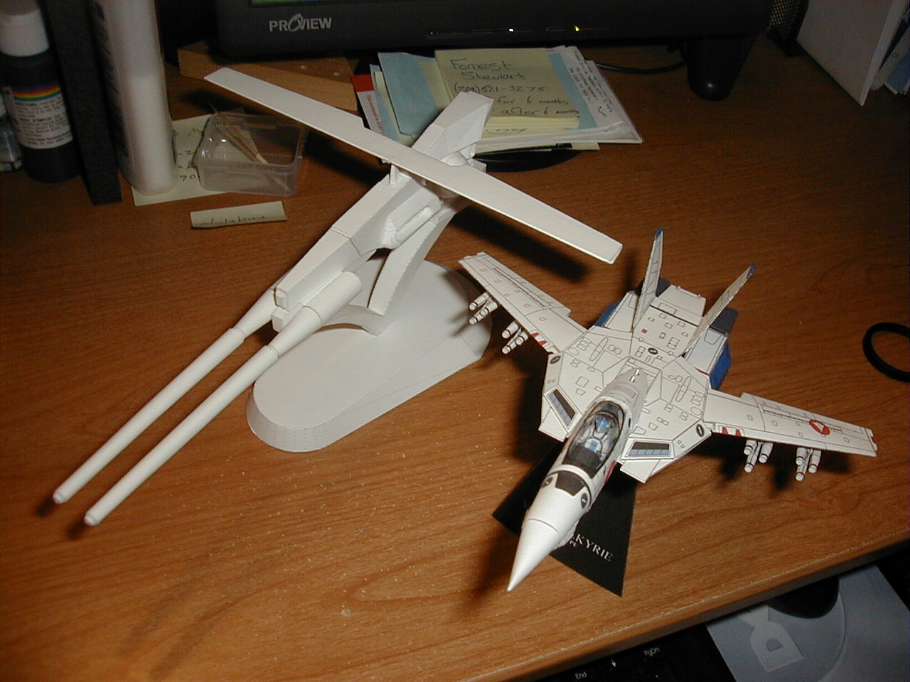

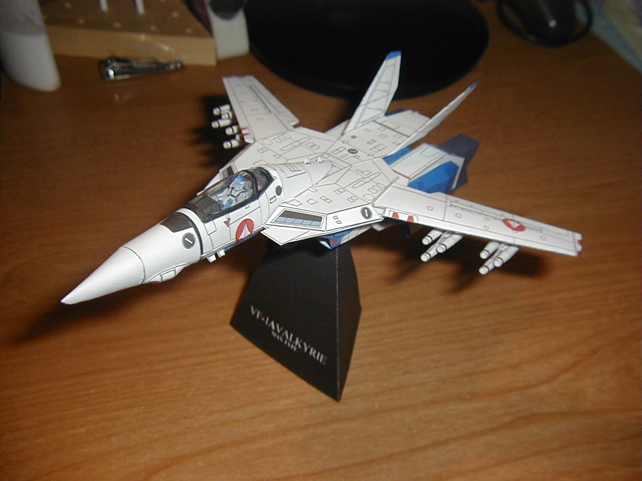

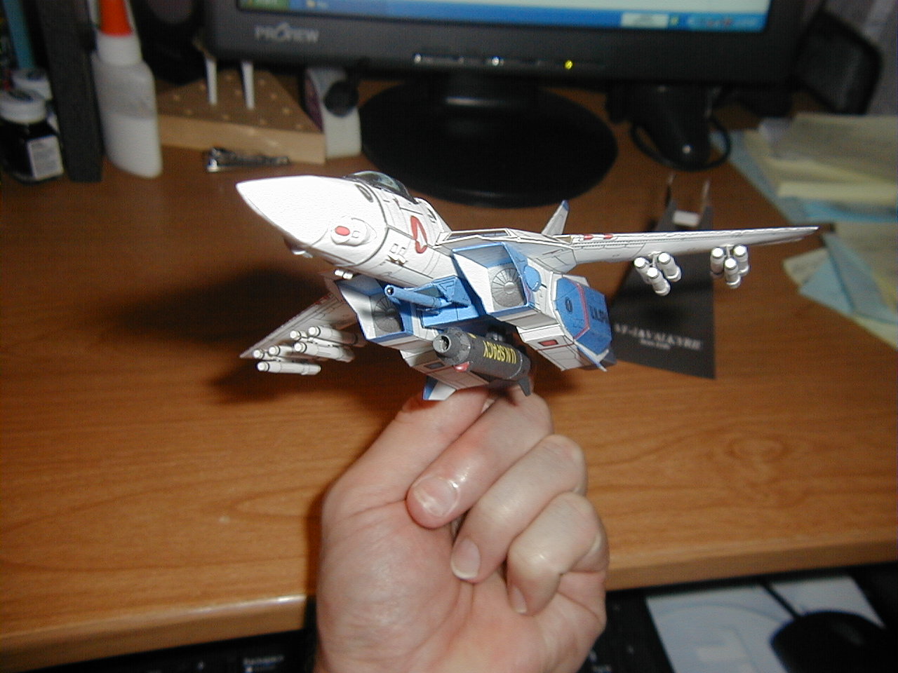

Hello All,
I would like to invite all here to visit the card modelling forum in the link below,
http://www.zealot.co...ad.php?t=164968
There you will find a thread of a VF-1 Paper Model I have been working on along with another member there. You will have to join to see the pictures and download the model files.
I hope you all enjoy the models you find there.

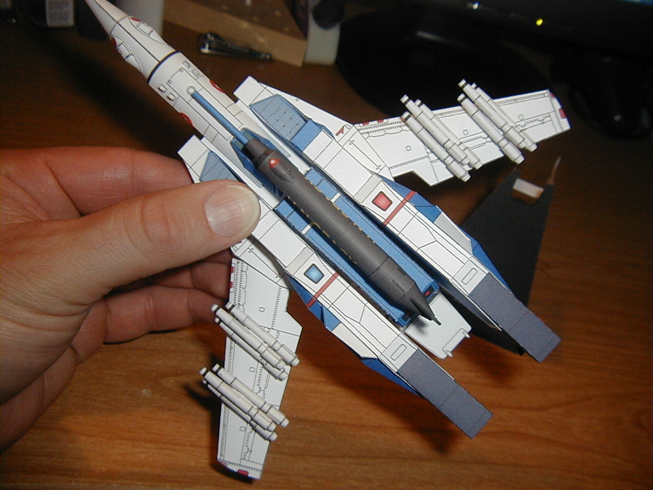

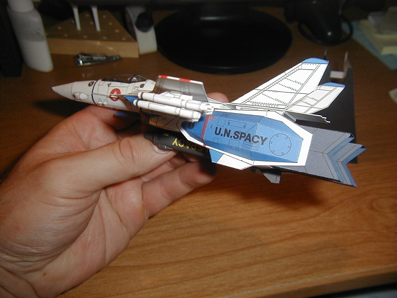

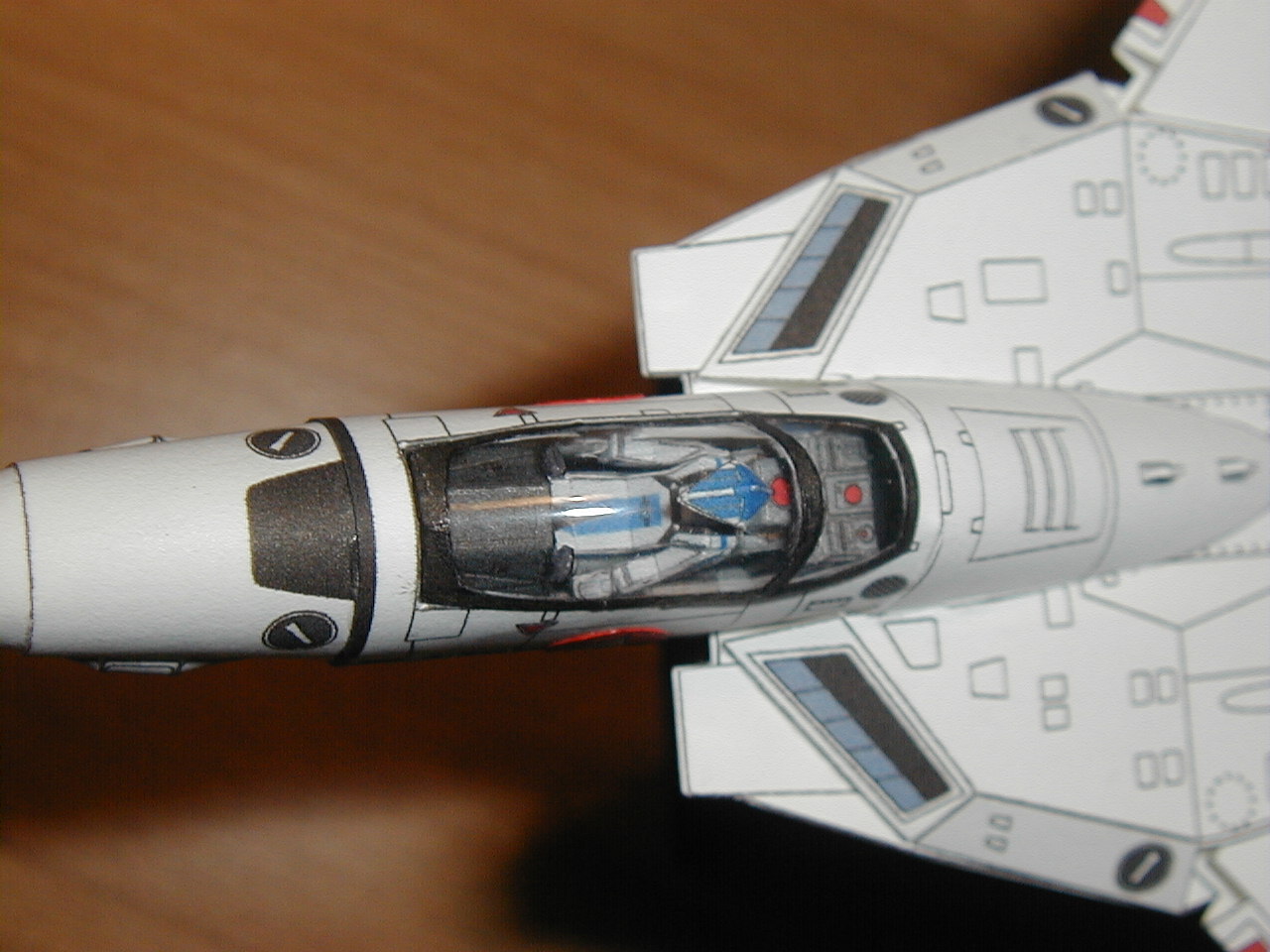

Here I give you a peak of a VF-1A Max Type to show you how one of the Fighter mode models appear.

Hey, I have 3 of these little guys (2 Roys and an Angel) on my shelf! Not to mention the upscaled, 1/42 Roy I did.
(Excuse the mess. I had just finished the big one, as well as reassembling Annie (25th 1S), and I was really thirsty for Orangerade)
Pretty nifty, little bastards. Don't think I've ever seen the missiles before, although I know there's a FAST Pack out for it, as well as a GERWALK by the same originator and a Battroid reverse-engineered from it. I've always wanted to make a PT from this...

Wow Getter1, what a way to make a first impression. Fantastic work. My very first models were all paper ones. I really appreciate the art, even if I don't participate that much anymore.

I just noticed that that has 3D FLIR pods (THEY'RE FLIR, DAMMIT!) and a Pilot... Damn, that's intricate.
And, I've never been able to close up the nose, no matter how many times I try. How the hell did you do it?

SchizophrenicMC,
I re-worked the entire kit originaly designed by Shunichi Makino. I added landing gear, a cockpit, I even made the parts for a Battroid mode along with many many many others things biggrin.gif I made many changes to the Gerwalk kit as well.
One of the other features I made is the Battroid seat riser as seen in the TV show when Hikaru exited the VF-1D and met Minmay.
My partner Janx (he's a member here to) made the Fast paks, and weapons as well as a few of the upgrade parts on the base model. He also made a basic pilot figure for the cockpit. He's currently developing the Battroid armor.
We made all the TV and DYRL color schemes as well as some others in the works. I even did the Robotech Battlecry schemes but I never heard back from Harmony Gold for permission to release the schemes so they are not avaliable ATM. I recently did the Jetfire Transformers scheme but Janx has to do the resizing of the files as I use MS Paint and the BMP files are huge. He re-draws everything in Vector and makes em into PDFs to enhance the grafix and greatly reduce the file sizes.

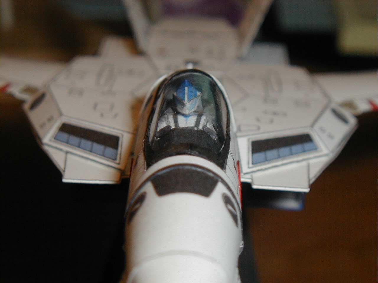

I altered the nose cone as the old one was too much of a duck bill effect.

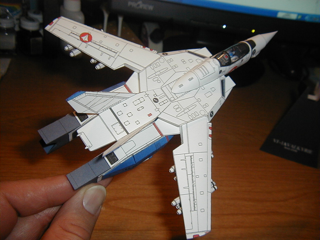

Hello All,
If you want to see the full evolution of these models development you can visit the link I put up in the 1st post here. I'ld put the pics up here but as long as that thread went on it would take me forever to do it all over agian. You will have to join that forum to see the pics. There are more models avaliable there other than the VF-1. A Zentradi Fighter pod and an SDF-1 for example.
Hope to see some of you folks over there. Hee hee I guess this is an introduction bring gifts. Oooo or is the saying "beware of geeks bearing gifts coming to mind" tongue.gif
At 1st I was very skeptical at how well a paper model could look till I got into the hobby further. I do plastic kits to but haven't been too active on them in a while. Now that I'm more settled after my cross country move I'm wanting to do some plastic kits again to.
I wanted to post more pics here but I'm on call for work and got called away for an emergency and now it's getting late.

I love you... 0_0
I suck so much at papercrafting, relative to you that I'd have to upscale that to at least 3 times original size to make that.
A little note on the canopy: Whenever I wanna make something transparent, I print it out on an overhead projector transparent sheet. It's a bit harder to work with, and sometimes the ink doesn't like to stick, but I get some pretty good results...
Unfortunately, all the models I've ever attempted with transparent parts have ended up going wrong. *Cough* DeLorean, Mach 5, that plane from Sky Crawlers*/cough* However, the parts, themselves, come out nicely.

SMC,
That is the 1st time I ever sucessfully made a transparent canopy. I have tried many time on other models and failed miserably.
On this I made the paper canopy (tabs outside) and filled it with epoxy. When the epoxy cured I soaked tha paper off in a glass of water. I then sanded the ridges out and smoothed the curve of the canopy (the biggest problem with pape ris compound curves). I then sanded it down with finer and finer grit paper and polished it off with newspaper.
Oh forgot to mention before filling the paper canopy I extended the mold with masking tape all round. That left a small step ridge when the paper was removed making it easy when trimming the clear one.
Now I've gotten molds made before and all but here's where I figured out I was messing up. I would always use clear acetate sheet from Evergreen. I would heat it up over candels or a stove eye and just as it began to sag I tried to pull it over the mold. It would always cool too quickly and not give me a full stretch over the mold sad.gif Ok I guess I didn't heat it up enough tongue.gif I would wait a tad longer and boom! It melted in the center. I burned up (litteraly) a whole pak of acetate and I tossed the paper Grippen and the mold in disgust sad.gif
What I discovered in this one is I was using the wrong plastic. The acetate was too thin. A buddy of mine suggest plastic from a blister pak like a pak of batteries. That's what I did and what do you know, it heated up well and pulled right over the mold biggrin.gif
I had ran a pen over that step ridge I mentioned before so I had a visible line that I traced with a pen on the clear part and cut with scissors along the oultine and walla my 1st clear canopy biggrin.gif biggrin.gif biggrin.gif

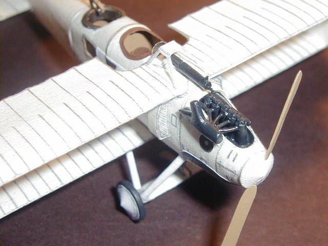

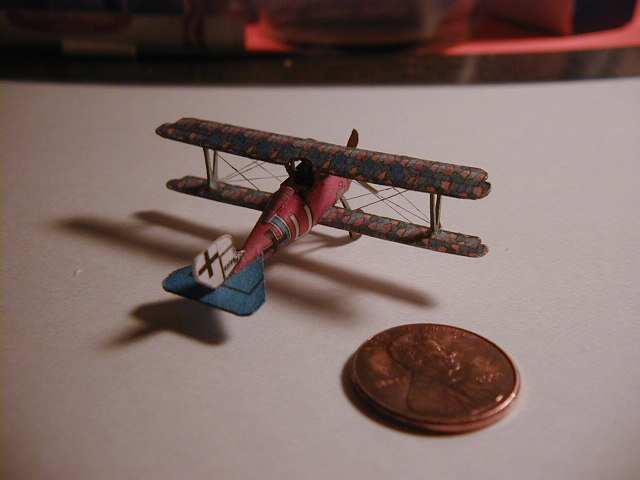

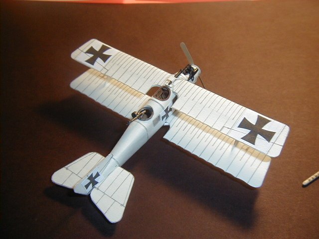

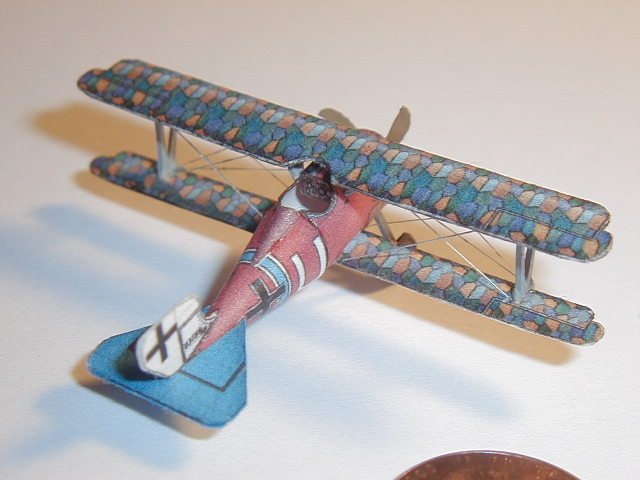

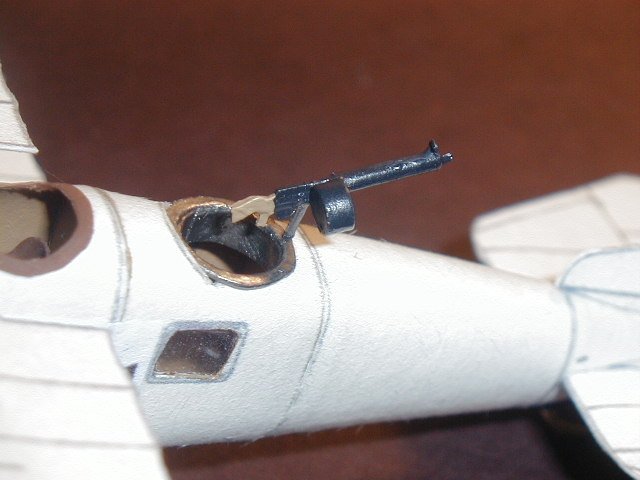

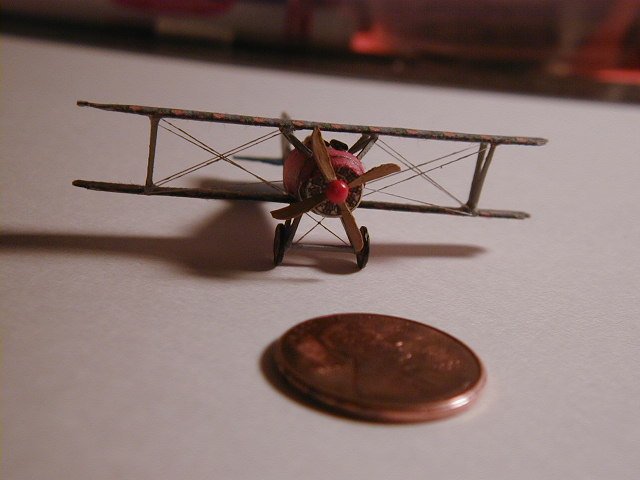

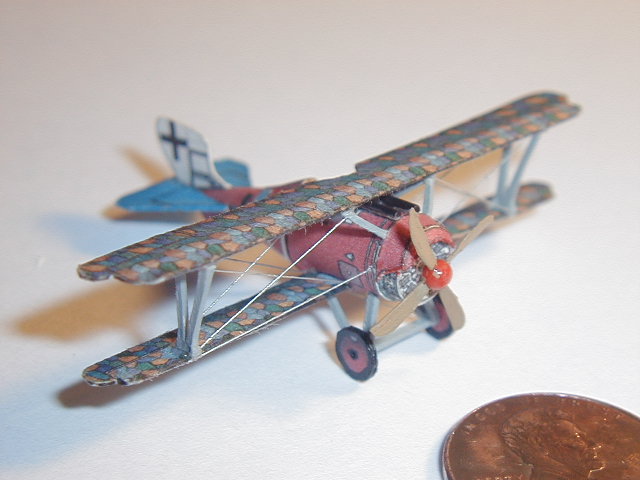

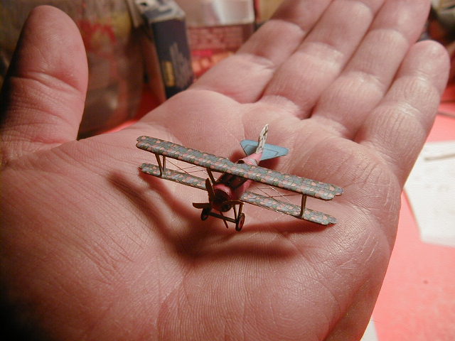

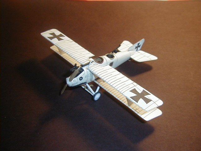

Here's some pics of a couple WW1 biplanes I did. The 1 plane is a 1/72 Roland C.II I designed (it's avaliable for download at Zealot). This is the final prototype build with a full edtailed engine, cockpit and the guns look better than most plastic kit's of the same scale. The 2nd is a simple kit I purchased that I re-size to 1/144. I added rigging wires to it also.

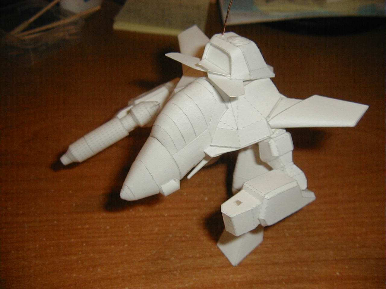

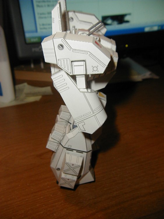

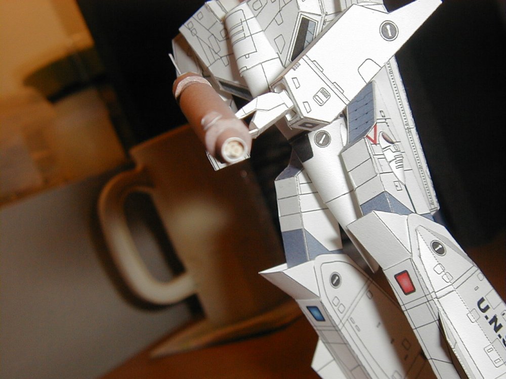

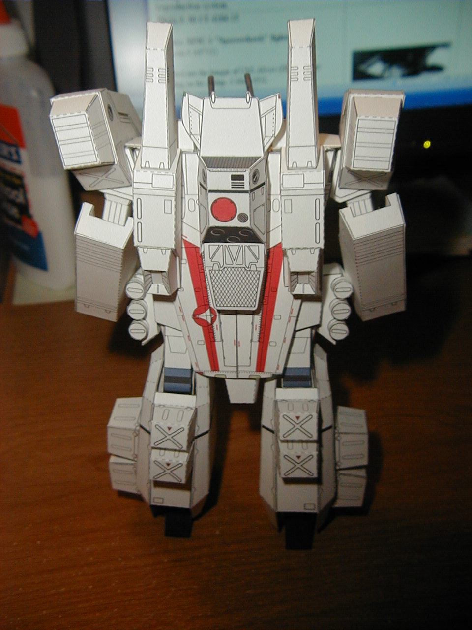

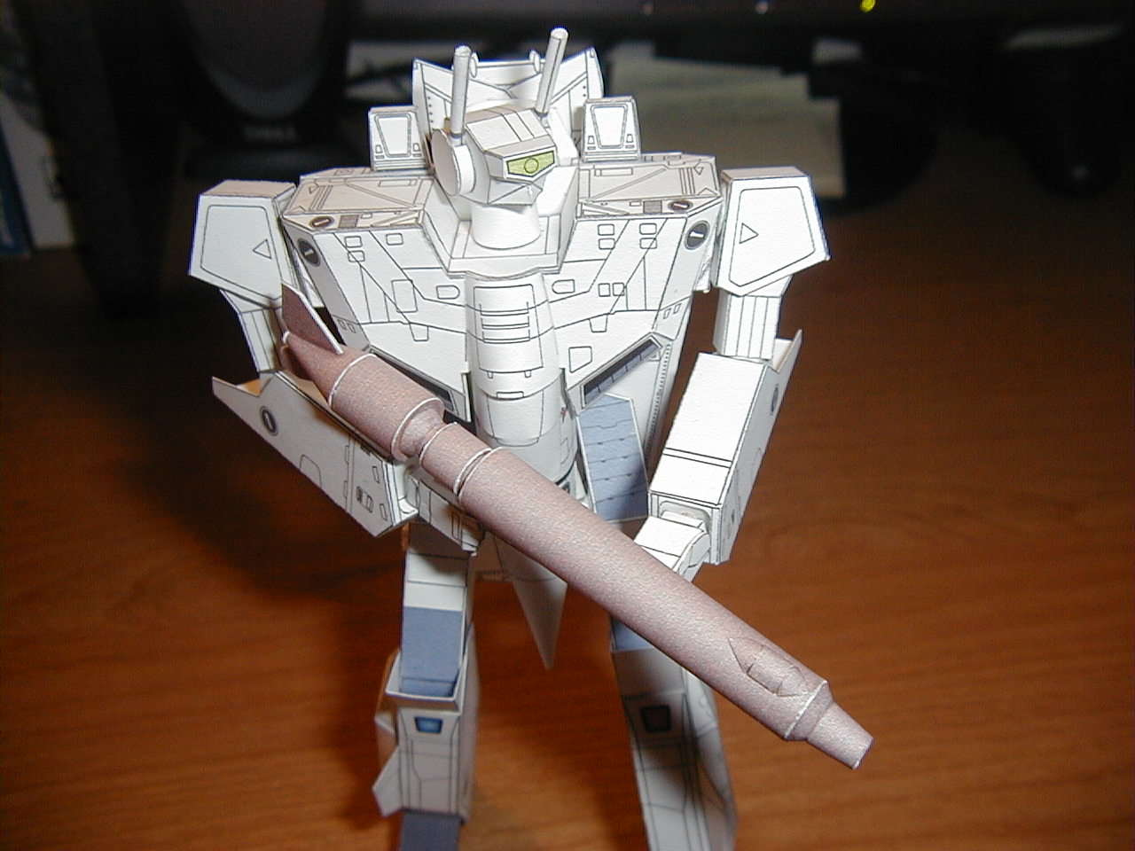

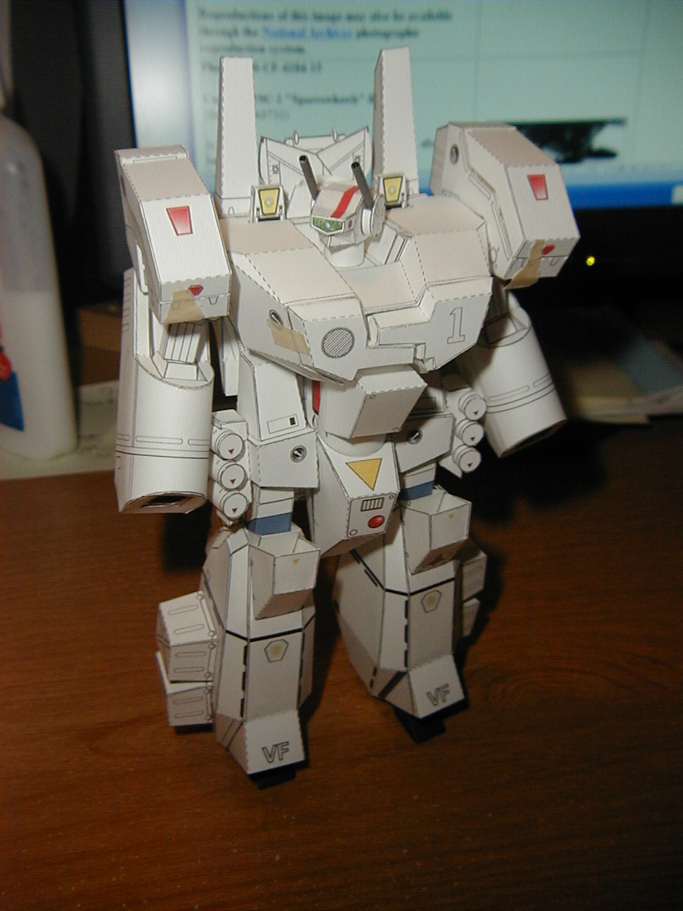

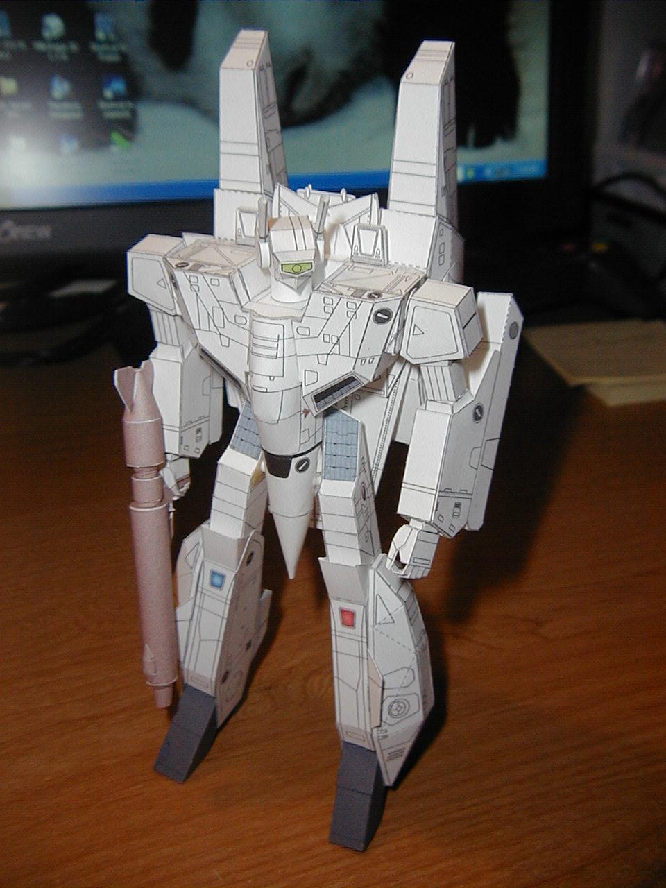

So, what kind of range of motion we lookin' at in this guy's joints?

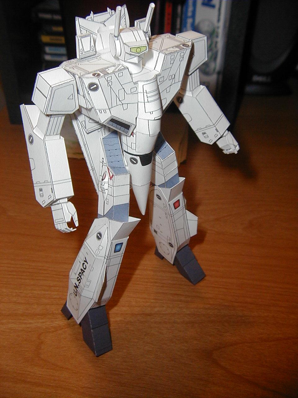

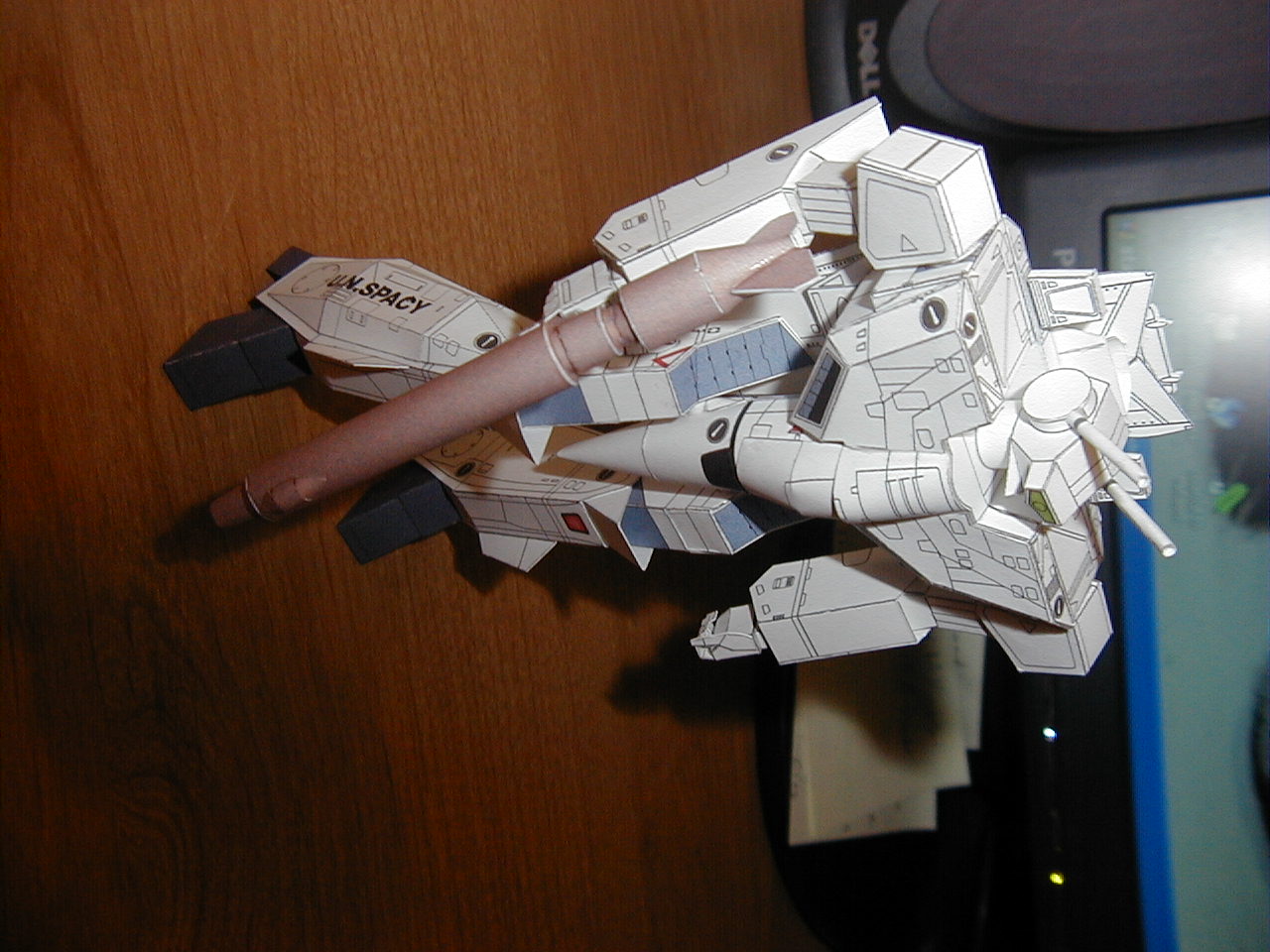

The range of motion is fairly good actually. The head is just a snug on the neck tube so it has a full range of motion.
The arms are fully articulated and can move bout as good as the Hasagawa kits do.
The legs are pretty good as well. The feet only move forward and back however. The hips underwent a change since my last Battroid prototype. Janx made a modification that will greatly improve the Grewalk legs as my originaly Gerwalk ones were stationary. His improvement is intended for Battroid as well but I have yet to try it. From what I saw on his Minmay Guard Gerwalk build with the new knees/hips they will have very good posability.
Now keep in mind paper posables are cool but have an inherent weakness of paper fatiuge. I usually reinforce the joint holes with super glue to prolong the joint life but they will get floppy after time if it's posed too much. Also the Super paks added a lot o weight and the arms had a hard time holding up the GU-11 with the forearm armors on.
Here's a shot of the Prototype Battroid in a pose. Note this was before I added a new part to improve the hip's forward motion. Those prats mentioned were never tested before Janx's new parts so these pics won't give a good idea of the leg's current motion.
G1

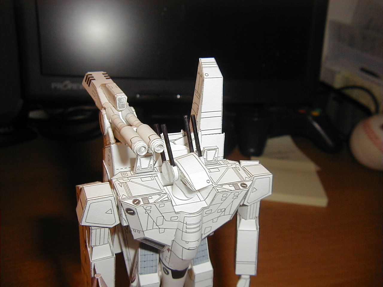

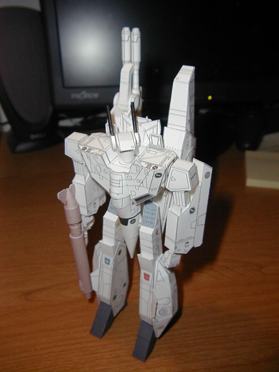

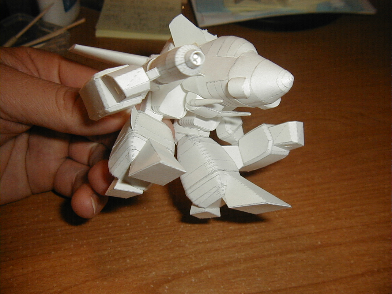

It's not avaliable yet but Janx has developed the Battroid armor for the VF-1. The pix are of the test build I did for him of it. Note it's removable to and the missile hatches open biggrin.gif The pix of the SD and the Lancer II are white models for testing reasons (ink conservation). The avaliable models are fully textured. Note the SD currently is only avaliable in the VF-1D colors
