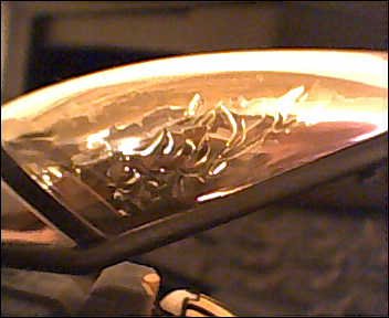

Hi all,today I discovered that my yamato 1/60 vf-1s dyrl (V2) has also the problem with the canopy.that effect on the canopy that i dont know how to describe is falling too.I noticed it today also when transforming it back to fighter. Apart from the problem with both shoulders which need replacing now also the canopy adds to my list of problems this valk is cursed.

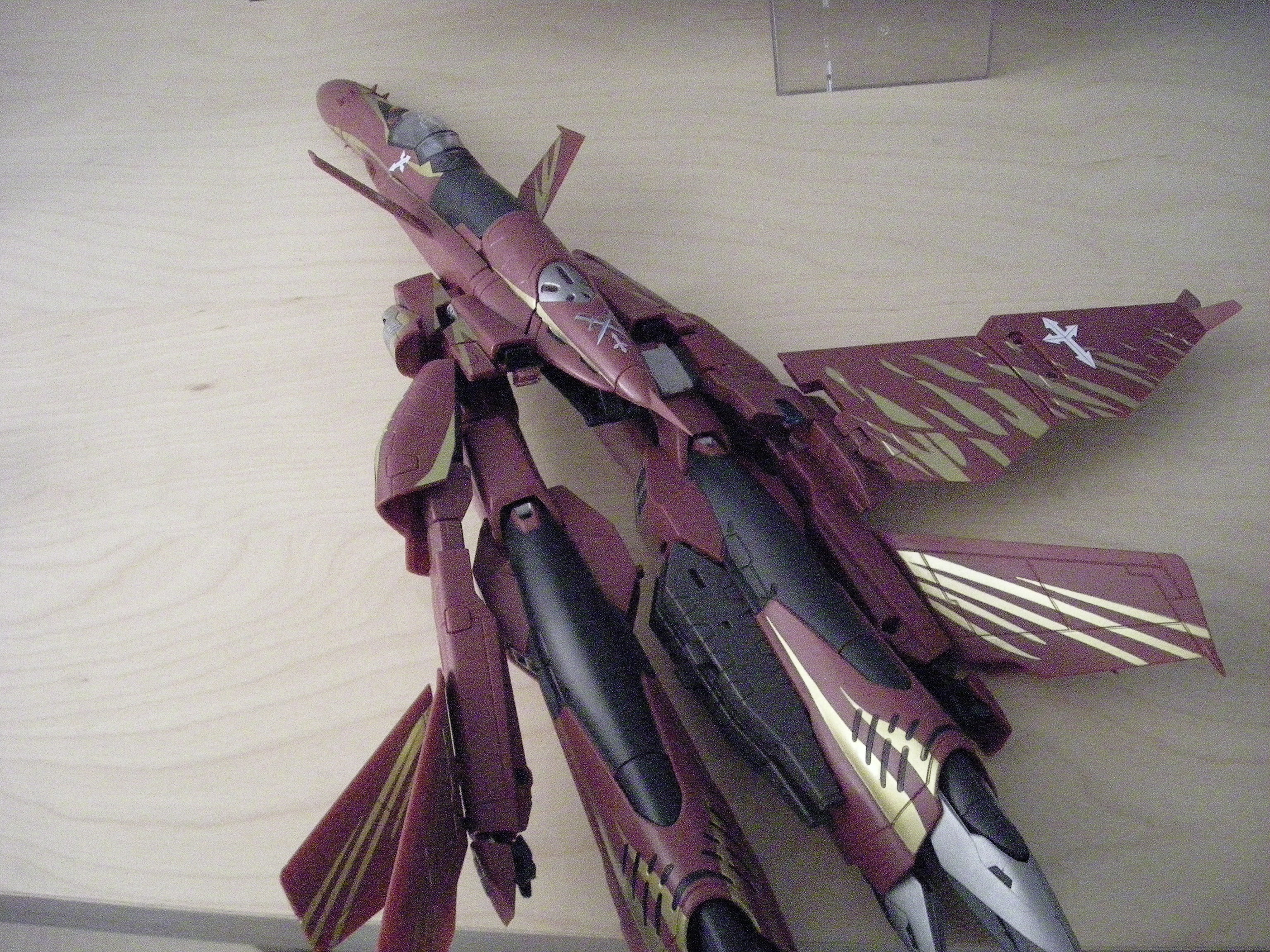

My vf-25s armored developed cracks through the hinge where the back folds. This would be the ones at the very 'back' of the shoulders where the back plate hangs off of in battroid - the one with the big metal circles in the joint. So far it's holding steady, but it irks me that such an expensive piece developed damage (note that I said I'm irked, but not really surprised <img src="http://www.macrossworld.com/mwf/public/style_emoticons/<#EMO_DIR#>/rolleyes.gif" style="vertical-align:middle" emoid=":rolleyes:" border="0" alt="rolleyes.gif" /> ).
It looks pretty secure still, with no stress marks other than the crack. Should I just leave it alone? Or should I try layering it with cement just to join it again? Any tips on this would be much appreciated. I've read that ABS really has to be welded back together instead of applying superglue. This doesn't guarantee that it wouldn't happen again though, hence my apprehension.
Could it be due to the weight of the boosters hanging off and stressing it? Improper handling during transformation? I've never transformed it much since I got it (having the armor on pretty much killed that feature), but I have left it on the stand in fighter and battroid modes for some lengths of time.

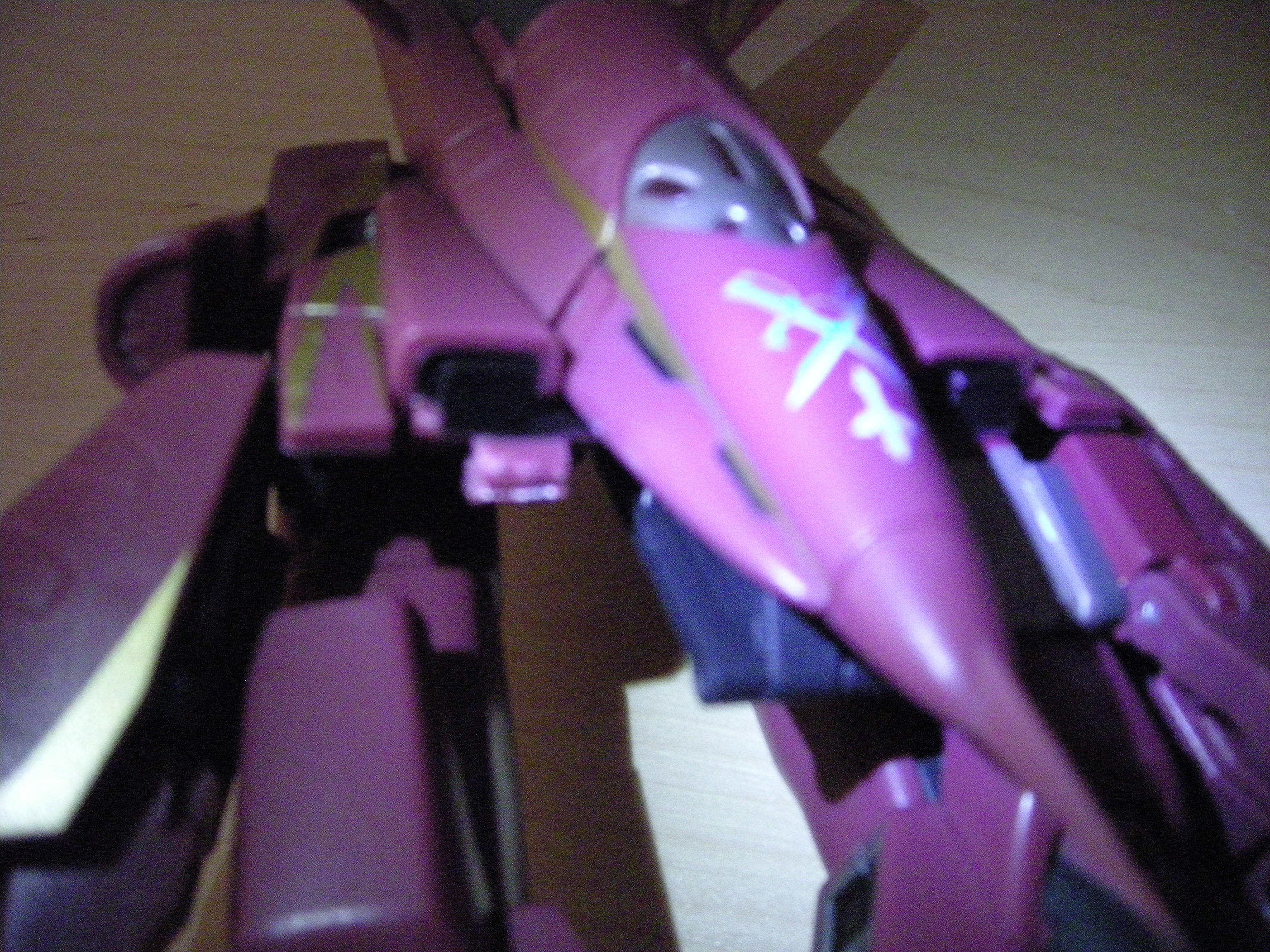

One of the backpack / thrusters broke on my 1/60 YF-21 in the transformation. Looks like the screw that holds the thruster with the 3-flaps to the backpack sheared off. It mostly holds in position and stayed on long enough to get it back into fighter. Wonder if it's worth the trouble to try to get that broken screw out or if I'll just leave it there.
This is the same YF-21 1/60 where I the T-bar got a bit of the left "hoop" that goes around the pin sheared off.
there seems to be a defective batch of 1/60v.II cockpit canopies out there.
my VF-1J Hikaru T.V. is the old hip-latch version, and I've owned it for over a year now,
with no problems developing on the canopy to this day...

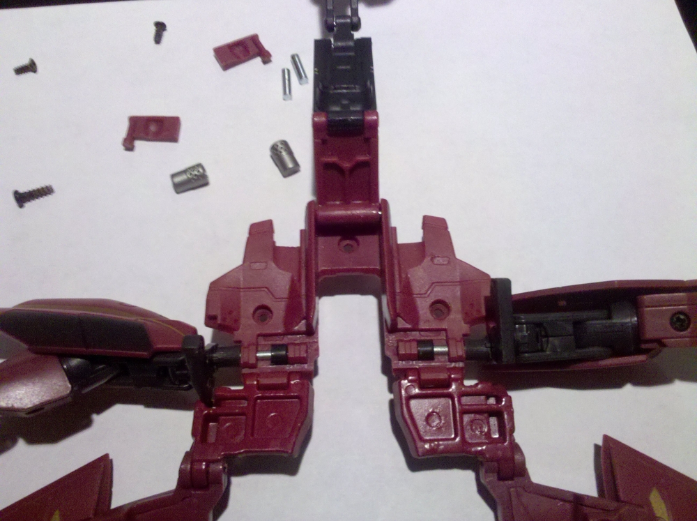

Ok, The good news is, you don't need an entirely new valk. But for all the parts swapping you'll need to do to replace the broken piece, you almost may as well get a new one. huh.gif
To start off, you need to work on this in some place you're not going to lose small pieces. I found this out the hard way.. when I got the screws out, little bits started dropping all over the place. I'd recommend a drop cloth or something.
The first thing to do is pull the legs off. blink.gif Well, maybe. I'm not sure you have to, but it helped me to see better what I was doing, and made the plane easier to deal with while fiddling.
Second, look underneath the plate where your hinge cracked, and you should see two small screws. Take those out. You shouldn't lose any pieces here.
The magic happens when you take out a third larger screw that is underneath the pink plate that supports the head. You'll probably have to partially transform the torso before you can fold the head at an angle that will let you see it. Remove that screw, and the whole thing should come apart.
What happens is, this releases the upper chest plate. This plate holds down the pins that support the nose section rotation, as well as the small flaps plastic flaps on the shoulders that move around, and the silver gun barrels. When you remove the nose, you should be left with the following pieces.
What you'll see is pretty much a mess. You've got the three screws, the two metal pins for the nose section, the two gun barrels, and the two plastic flaps.
Now, as far as the repair is concerned, my best guess is that you need to replace... well.. everything that isn't the nose section or legs. Technically, yes, you can take apart this section further.. but all it amounts to is disconnecting the arms from the shoulders, and the wings from their hinges. For all intents and purposes, the section that holds together the wings, arms, and head is one big unit.
At the bare minimum, you're going to need to replace the main plate that the head hinges are connected to, which will include the head (since it's prety much permanently attached to that plate), the shoulders (since they are attached by a press-fitted pin that you do not want to remove), and the plates with the blue lights that the wings attach to.
If you know what you're doing, you might be able to transplant the arms starting at the second shoulder joint, but there's no clear division in sections until you get to the elbow, and a sinle screw that holds the lower arm to the upper shoulder (actually, the third screw up, starting at the hand).
In any case, it's ugly. I get the feeling that this entire assembly might be treated as a single part in the assembly line at Yamato, similar to how ordering a new set of shoulder hinges for a VF-1 got you the full arm assembly.
At the very least, you need that lower half of the chest plate, and any pieces permanently attached, which will include the upper shoulders, and anything up to the screw joint on the wing plates (the ones with blue transparent lights).

Well, if they actually do offer to replace the broken piece, take that option (duh :p). It wasn't that painful to take apart.
The only question is how much of the figure you might get attached to that piece. Odds are, you might get new arms and wings. You will have to reassemble the plane by reattaching the nose section, but aside from the small parts, it's not a difficult thing to do.
When I took mine apart, the only hinge pins I had to fiddle with were the ones that hold the nose to the chest, and those are a free-spinning type with no friction, so don't worry about any stress from that. They just slip through big loops on the nose piece, and get sandwiched in a slot between the halves of the chest.
The arms have the potential to be a little tricky, but only because the shoulder pads get in the way. If you tweak them enough, you can unscrew the arms at the shoulders without a huge amount of trouble. You just wind up having to reassemble the thing, which can be annoying because of the small parts. If you have to replace just the lower arms, things are much easier.
I'll be glad to help out where I can, but I'm going on a business trip for 2 weeks to vegas, so I won't have my SV-51 with me to provide any pics of assembly or anything.

Forgive my posting here but I was hoping to get some help with my vf-22 since I don't think it's gonna be sold any time soon. Just wanted to know if the leg is in right because I just can't get it back into fighter mode.
http://img.photobucket.com/albums/v146/SD_Jetfire/IMG_0490.jpg
http://img.photobucket.com/albums/v146/SD_Jetfire/IMG_0491.jpg
I own a VF-22S Gamlin and YF-21, and from the looks of it, I think you need to turn the leg leftward 90%, so that the tip of the foot faces inward, and the broad side of the leg lies flat against the "roof" of the fuselage.

Ocunt me as one of the folk with a Canopy issue. I too have had the wrinkled thing happen to the coating. I rubbed it and most came off, so it's not super noticeable now, but its still there alright :(
Does it have something to do with leaving the Valk in Battroid for so long? if so Ill have to check my other one when i get home :(

i still have not had a problem with my 1/60v.II -1J Hikaru T.V.
so this canopy problem surely must be a production batch issue.
is there any way to get YAMATO to supply you a replacement canopy?
