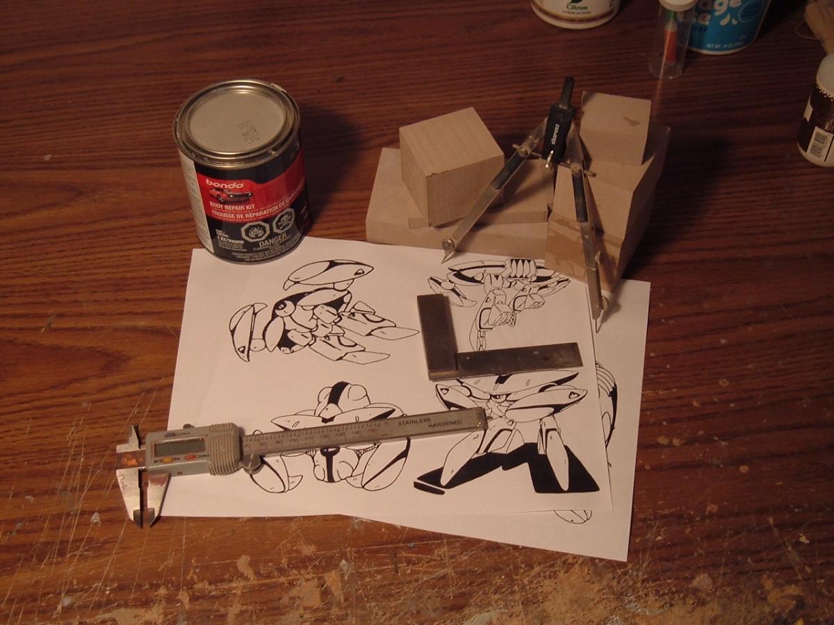

So here we are once again, at the very beginning of another sculpting project. As per tradition, my very first task was to go and collect as much reference as possible on the Inbit Eager and thanks to teh interwebs, the task is a fairly simple and straightforward one. That being said, I always keep my old Palladium REF Field Guide book handy, as it has a wealth of drawings and sketches, some of which aren't so common online. Very useful indeed!
Once that is done, I sit down and draft some rudimentary plans for the larger shapes and components, so as to make construction easier and more precise. Once those have been printed to scale, I can now dive into the fun stuff!
DSCF5197: some printed line-art, tools, modeling board and putty: these are the building blocks (much pun intended) from which the itty bitty baby crab will emmerge.

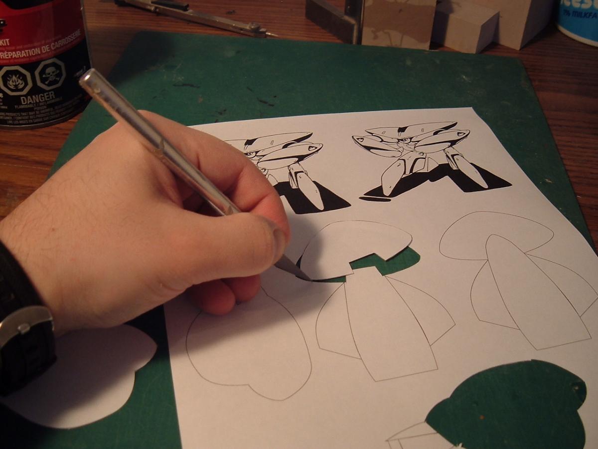

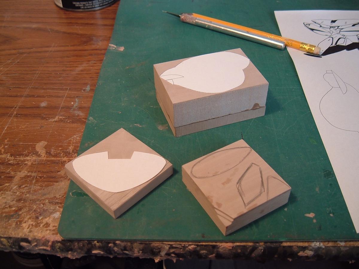

DSCF5198: paper stencils are carefully cut and will be glued to modeling board, it just makes my life so much easier.

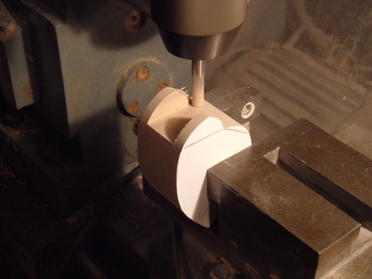

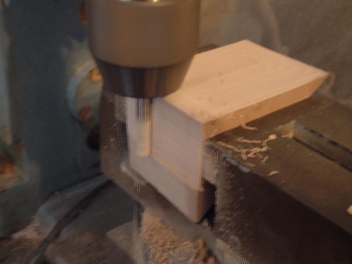

DSCF5200: before I can glue the stencils to the modeling board, I have to machine my various bits of it to properly squared shapes, which is where the mill comes in handy.
DSCF5201: so now that some blocks are prepared, the paper stencils are affixed with spray adhesive. You might notice that some blocks are cobbled-together with smaller bits, which I can get away with on certain things thanks to a good CA glue. Planks of modeling board are costly, so I try to waste as little as possible.

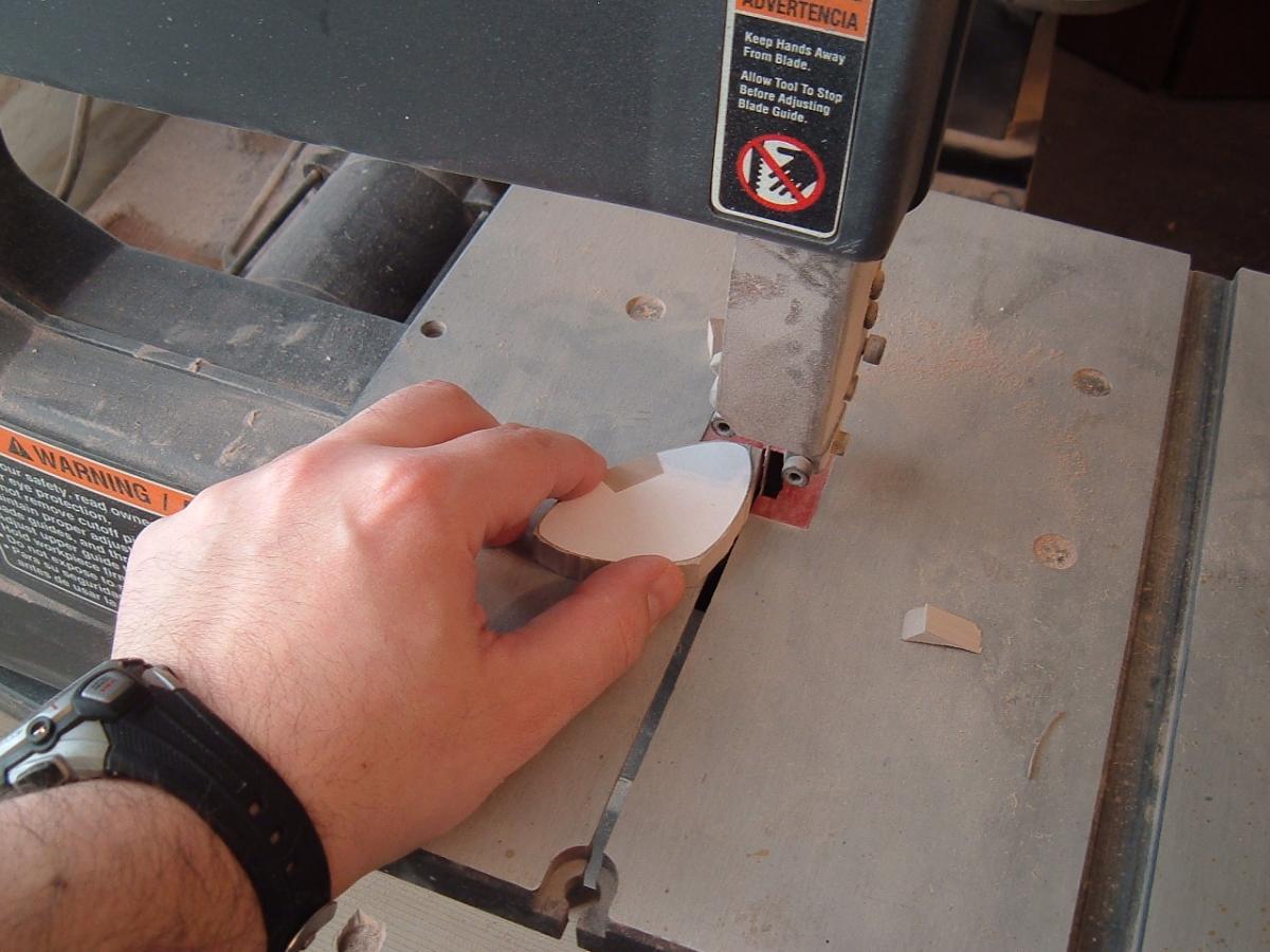

DSCF5202: using a band saw, I trim away as much excess material from the stencil as possible. I generally leave a little excess as it's easier to remove less at a time than repair a block.

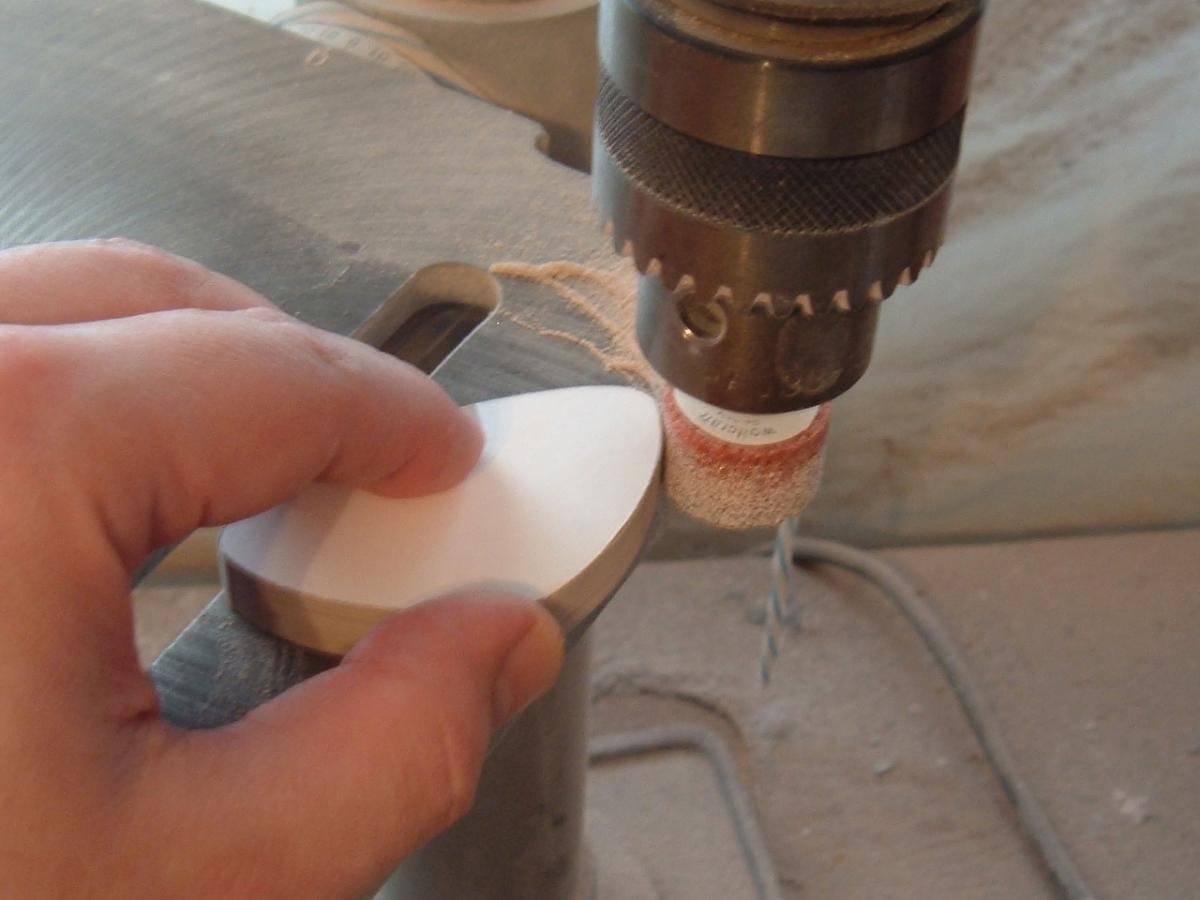

DSCF5203: whatever the band saw doesn't remove will be ground-down with a large polishing stone mounted to my drill press. this is great for fine, precise work.

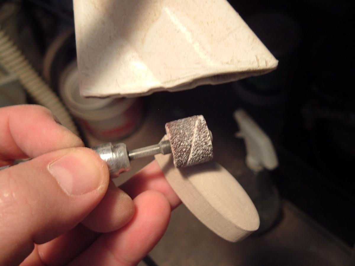

DSCF5205: speaking of Dremel, here's where the bulk of the important but thankless work gets done. Even with a vacuum to suck away most of the dust, it's still extremely messy work.

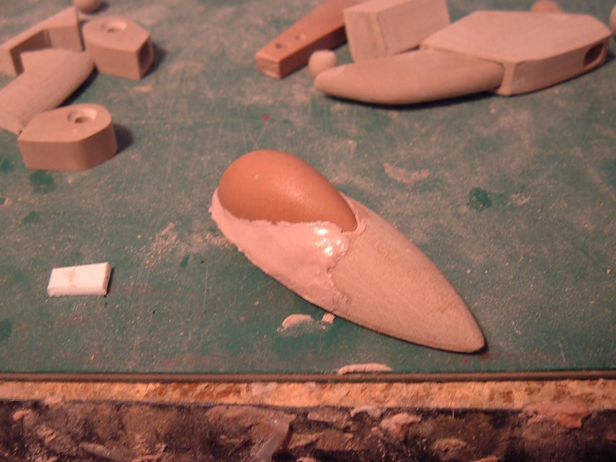

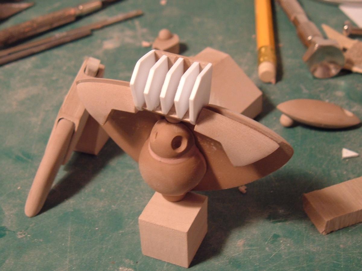

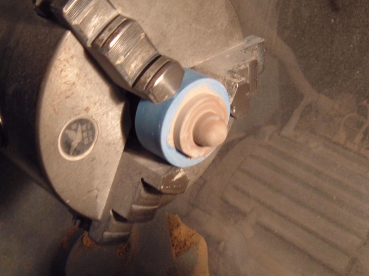

Speaking of balls… In pic 01 we see one of the spherical thrusters that replace the legs in booster mode. I'm shaping it on the lathe along with a number of other ball-joint parts.

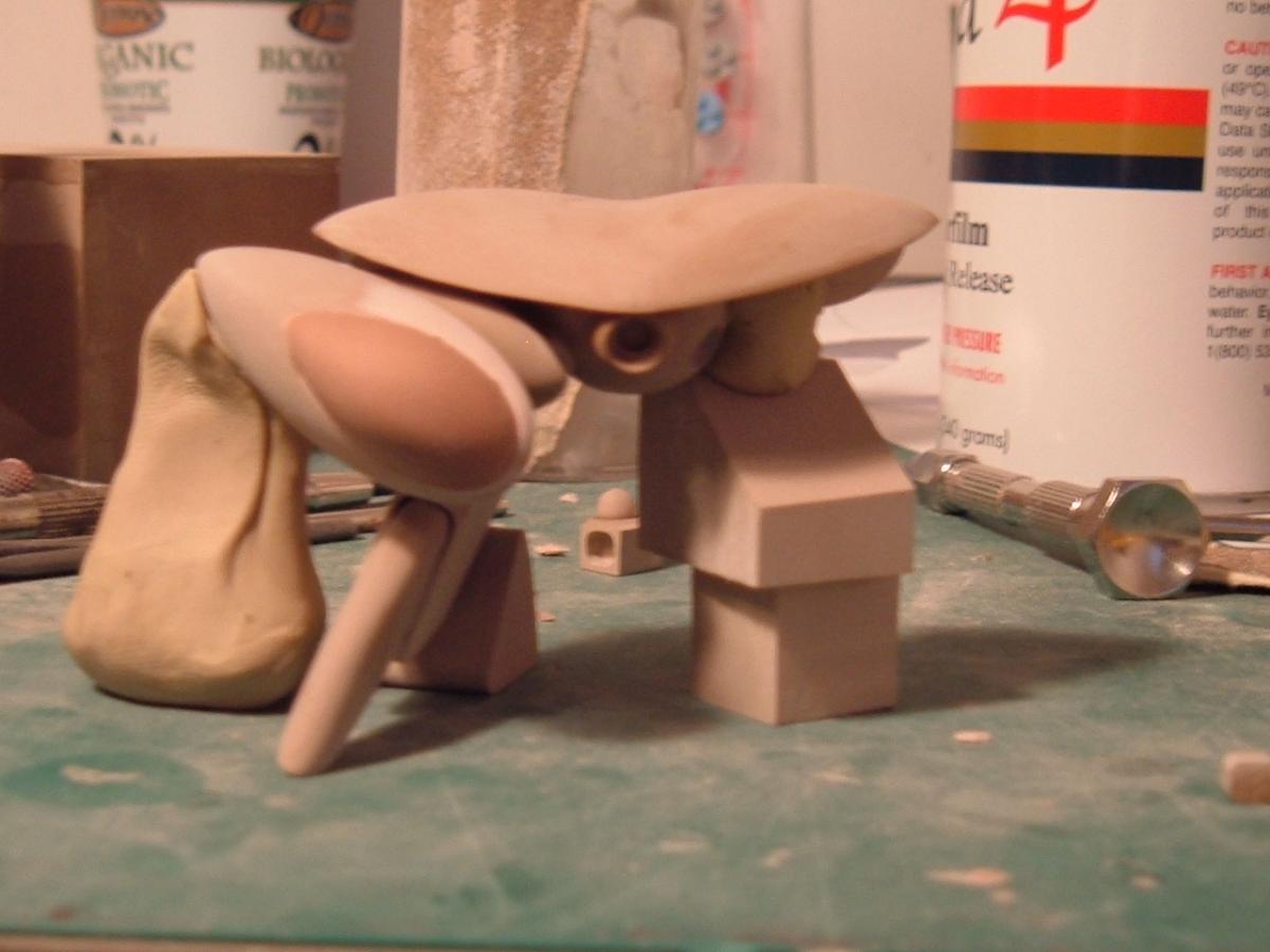

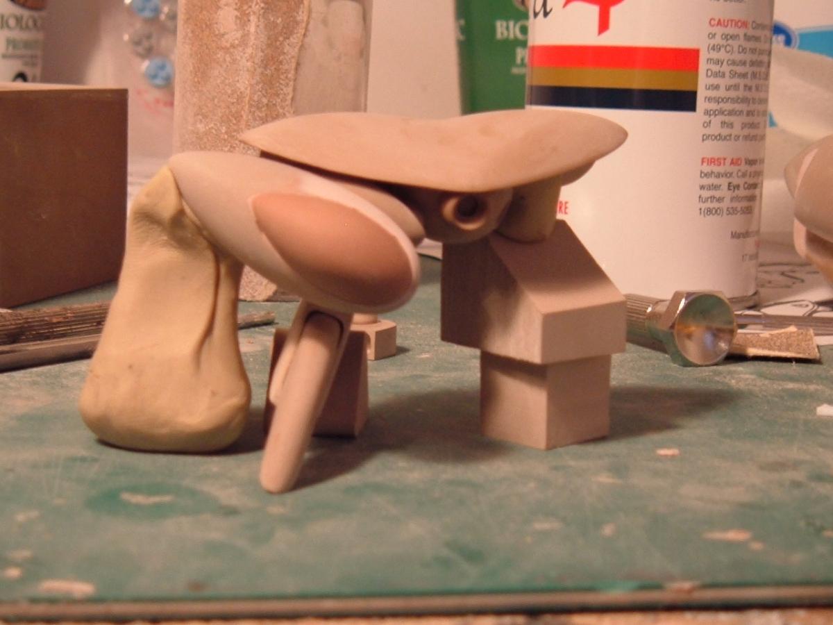

Pic 2: the ever-faithful putty smash method in use to shape the lateral thrusters on the booster. This is the best way I've found to get truly great fitting parts on complex shapes, just be sure to use a good release agent.

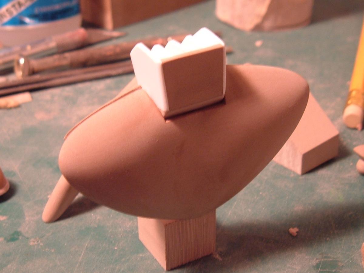

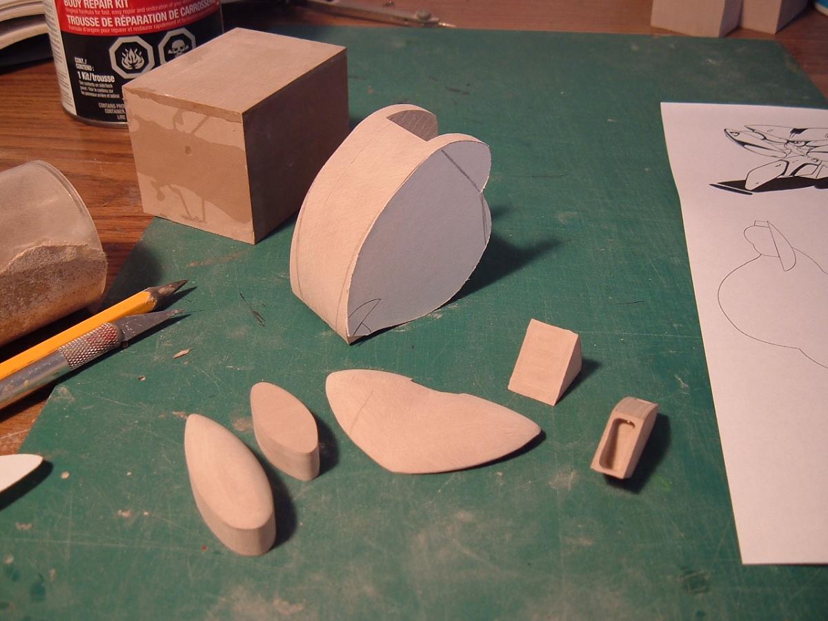

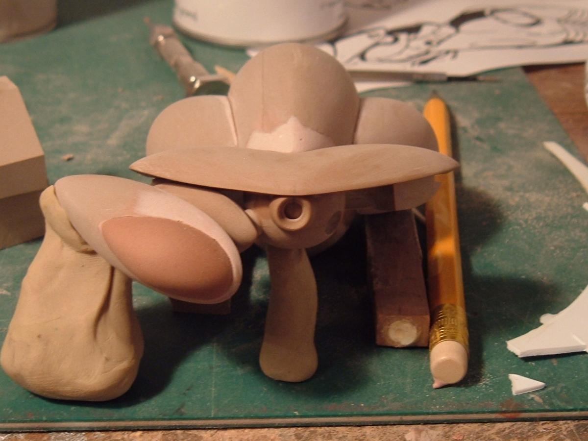

Pic 3: the forearm pincer undergoing some fit adjustments. While it was sculpted from two pieces, it will be molded as one, with the claw/finger molded separate.

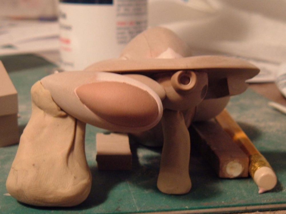

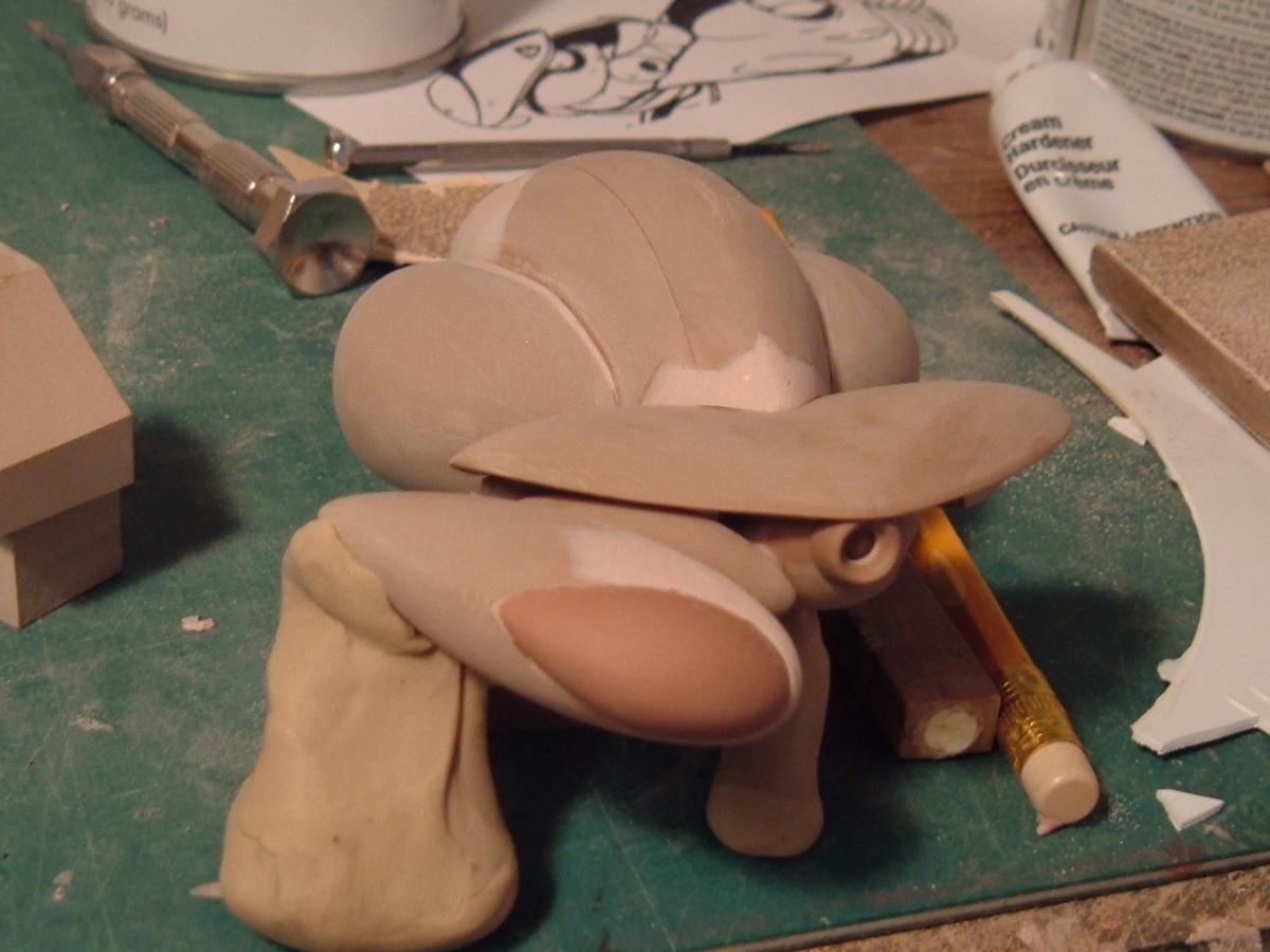

Pic 04: the main crab shell as seen from below. The thruster will be on a ball-joint as with the other appendages. Pic 5 offers a top-view.

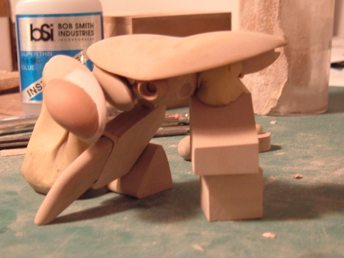

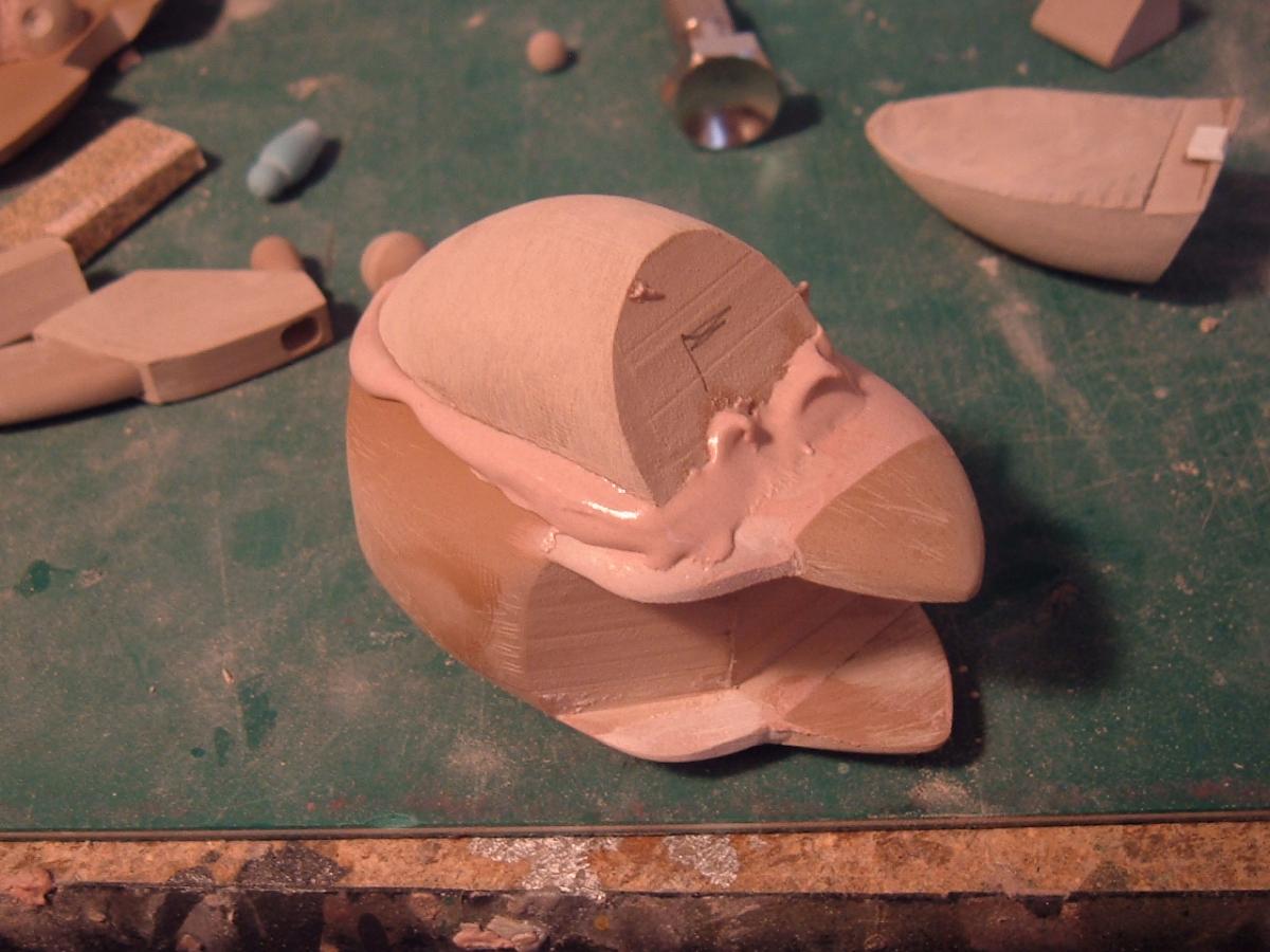

Pics 6 to 8: the pose is crudely held together, but we can see the Baby Crabb taking shape and the overall proportions look great.
