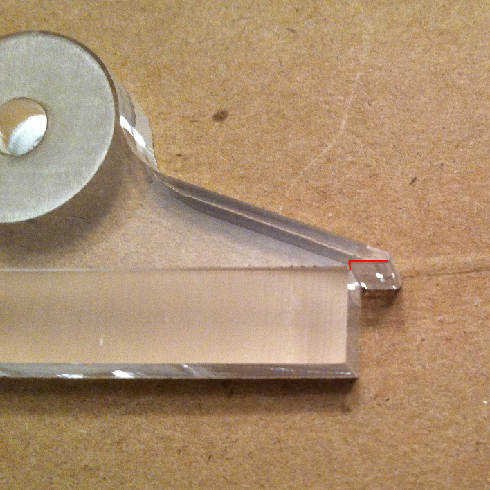

I found Plastruct Plastic Weld at my local hobby shop, which is Methyl Ethyl Ketone. It was right next to Tenax-7R and came with an applicator. It is also marketed as a plastic solvent cement. For the life of me, though, I cannot get the acrylic adapters to sit flush like the 3D printed ones. Here is a picture showing the source of the wobble I noted earlier:
I've been sanding them a bit at a time in the hope that I can tame the lip that I highlighted in red, but I'm in no rush now that the printed versions are giving me a working solution. Knowing myself, I might break something before figuring out how to fix it right. LoL! Oh well.

Sorry about that. This all has to do with the way the acrylic was originally laser cut. To fix this, I took random samples of the base pivots and bases when I was determining how much to route off. Once it seemed like I had the right amount, I just pushed all of the base pivots through the router.

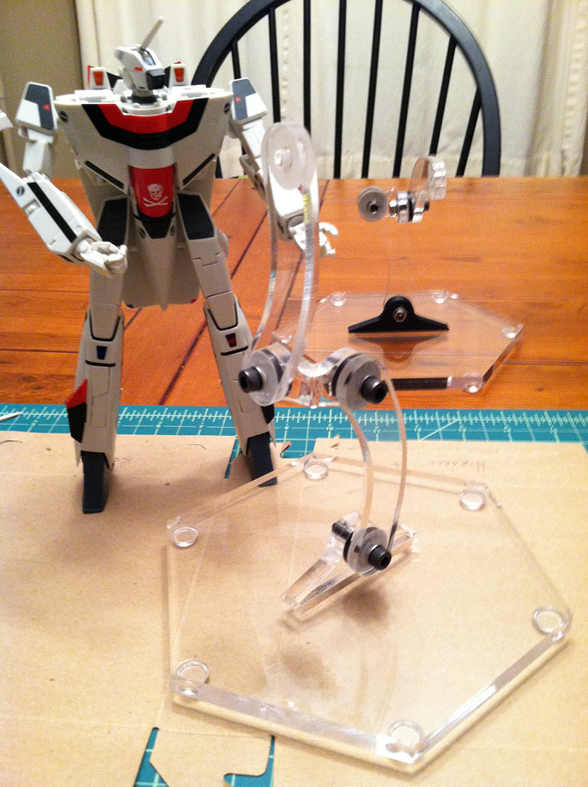

I followed Saburo's method using the solvent that I picked up today. In order to carefully apply it, I used toothpicks and made sure to add one drop at a time to the smooth face of the adapter, which cut down on my mistakes. In the end, I think Hikaru approves:
Once I applied the solvent correctly, the acrylic bonded really fast. I waited about 15 minutes before attaching the adjustable arms. I'm going to let the stand sit over night before adding the weight of a Valkyrie in case there is a cure time. You can also see the 3D printed adapter in the background. That piece fits nice and snug on its own.

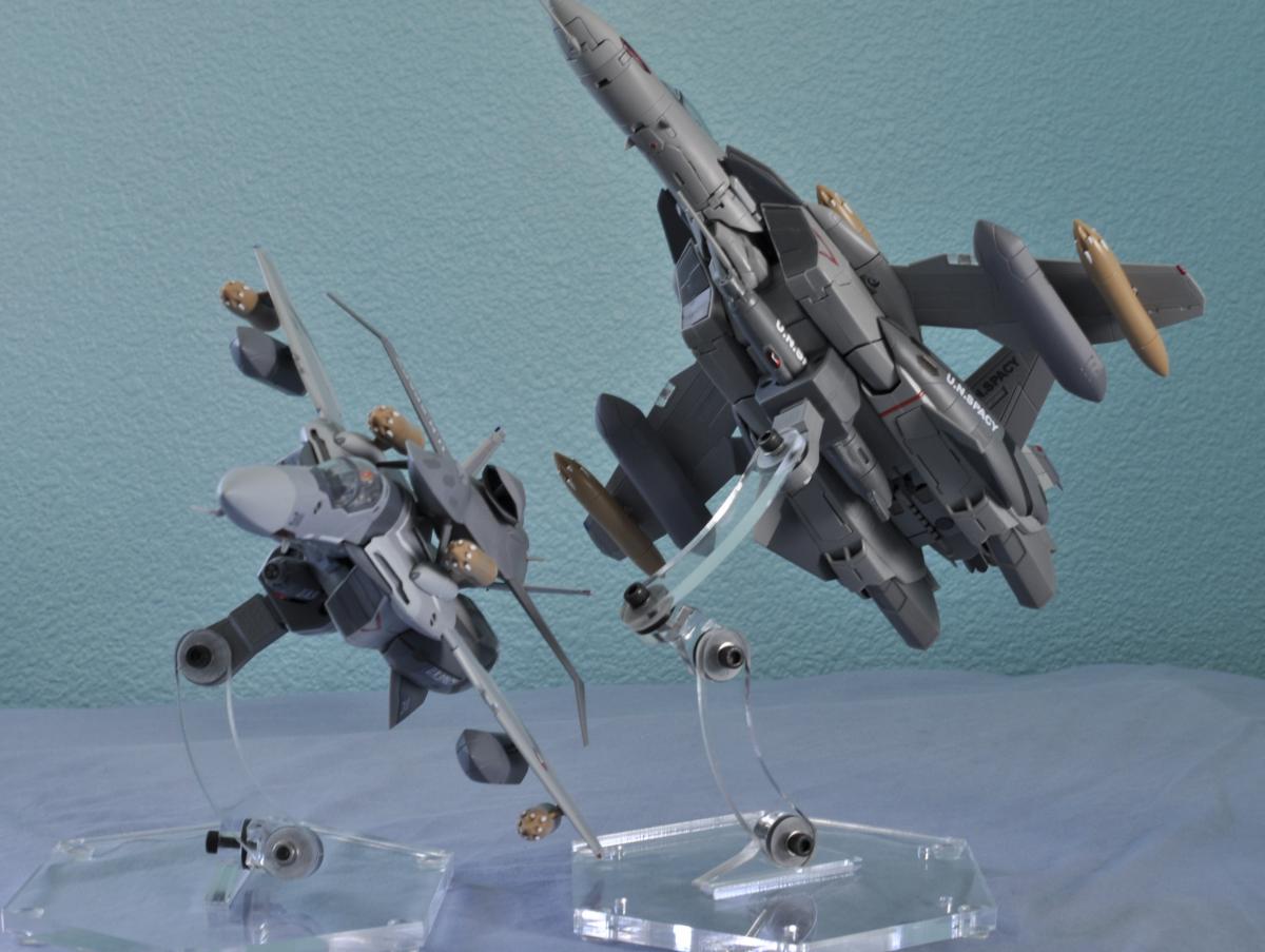

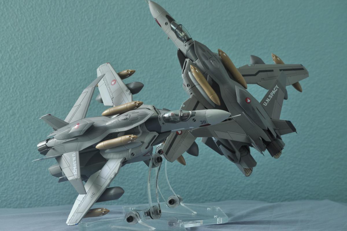

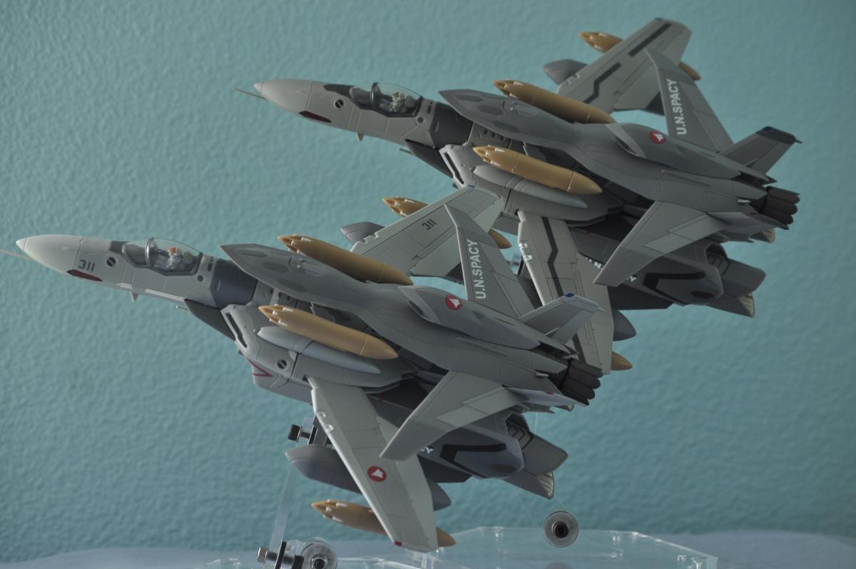

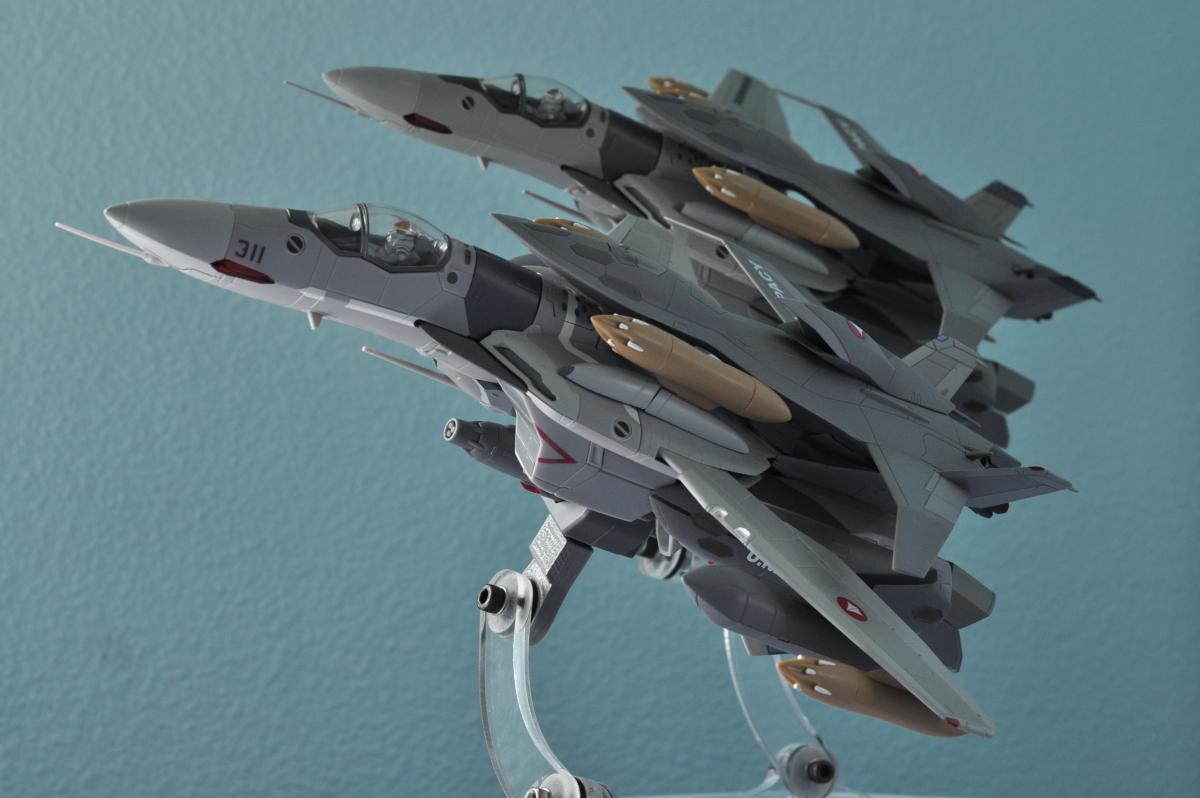

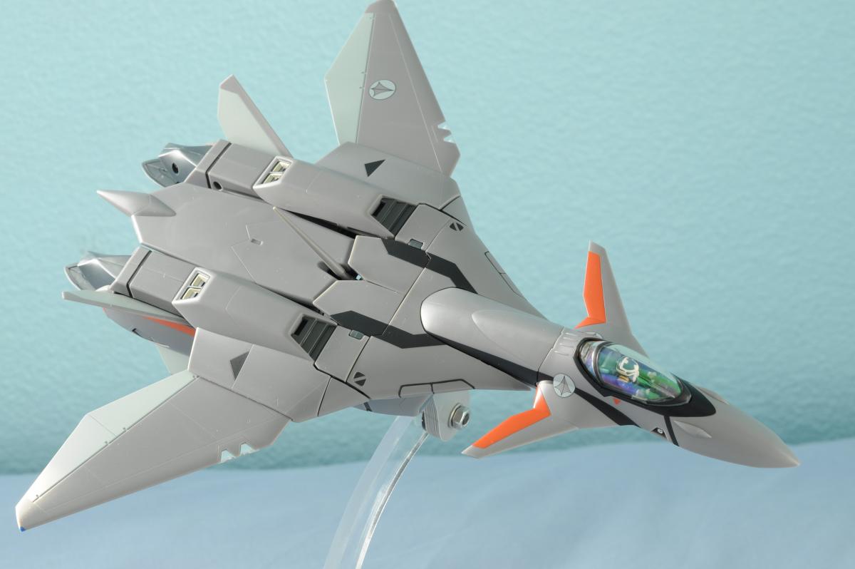

Did more testing of the stands. This time I used the VF-0 with ghost to see if it'll hold. Both bases are not fused to the base but hold the valks fine but in the 3rd pic the Valk on the right had the base attachment jutting up just a little but should be okay when I actually fuse it. It holds the VF-11 fine. Like it says in the instructions, use common sense and adjust for the center of gravity. I'm just experimenting to see how far I can go with these.
Nice poses and shots! The VF-0 looks good with the booster, I might have to track down a booster for my VF-0S...
